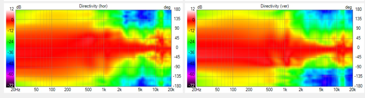

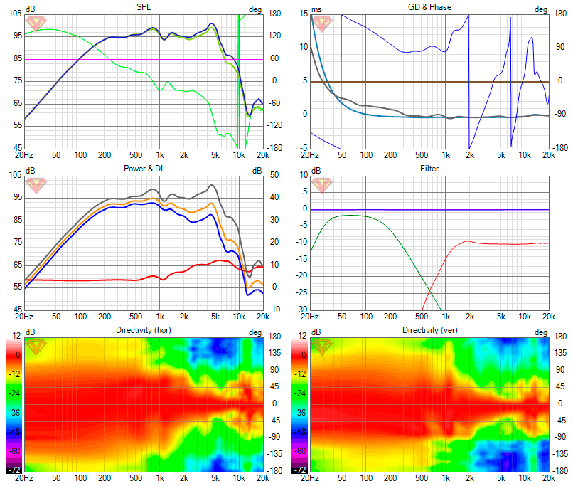

Attached is blast from the past. Normalized measured horizontal and vertical responses of huge (1m scale) asymmetric enclosure with asymmetrically placed midrange. Showing the midrange data only. Well, there is some difference but it is a mess all around so I'd just do better structure and measure again The frontal sector -90 - +90 seems to be roughly the same on both. Not sure how much error would show up in the power and other calculated responses if either was used forboth. This could be easily tested as well, but have to do it some other day and trust your word on it.
What the heck, was only few minutes so don't have to come back to this later Second attachments shows difference if the vertical measurements was removed from the driver.
Thinking of it more on a 3way monkeycoffin with drivers on the center axis there would be some error on the mid and tweet, mainly diffraction from the other drivers but that might not be too much. Diffraction doesn't affect the crossover work much since there is nothing one can do about diffraction in the crossover. I've been using the Vituix sims to evaluate the acoustic performance over all instead of concentrating just to the xo so feel vertical measurements are important. well I need to reconsider this especially with big stuff and situations where error should be insignificant, would save some time. I think this is easily evaluated by comparing measured vertical and horizontal responses.
edit.
I just follow Kimmo's instructions. He says horizontal, from 0 to 180.
I believe what VituixCad does is it uses the simulated baffle response to extract a 2-pi response from all the horizontal measurements... then it applies the simulated baffle response in the vertical direction to approximate the vertical polar responses.
I really believe it is close enough. Afterall, we are using that data to approximate the sound power response and the early reflections response... There are a LOT of assumptions that go into those two calculations, particularly the ER. If I was concerned about errors in the VituixCad process (which I am not), it would be in the simplifying assumptions used to calculate an ER and predicted in-room response. But as I said, I am not concerned.
I think so too the error using only horizontal response is not too big. As long as relatively small speaker in question there shouldn't be too much of an error with circular source. Error demonstrated with the directiva data by kimmosto in vineethkumars link is roughly 1dB and quite uniform for the most part. This would yield error only in level, not too much error in the filters otherwise I think. Verifying by measurement and listening this error is easily fixed after the fact if it bothers at all.
Observe how the error flips around the 1-2kHz in the directiva data though. Also my "extreme" case in previous post seems to have most difference here in similar region, around 1kHz.
I don't know if this is a curse or blessing that the stuff is wild roughly around 1kHz, on the midrange. I've observed all the problems I have tried to tackle accumulate on this area. Be it trying to compensate for vertical reflections in the room or cone edge resonances or box issues. Hearing is most accurate there as well. Errors in the simulation data seem to land here.
Maybe the stuff averages out due to all "problems" accumulating on the same range or maybe the secret sauce to better sound is addressing this region as well as possible. Knowing the error at this region would be paramount I think, or just doesn't make any difference because there is just too much to take account?
I think the issues accumulate there just because physical objects are that size, the speaker boxes, the drivers, the head, the wavelengths. Almost all instruments we hear have output there (harmonics at least) not least the vocals. 300Hz is ~1 meter long, 3kHz is ~10cm long. 1kHz is ~30cm long. Drivers from 15" to 3" correspond to frequencies 900-4500Hz. There is going to be crossover somewhere here if any.

I've observed that once you have a dedicated direct radiator driver ( iow a threeway) to this range ( from ~800hz to 4,5khz in my case) you gain in what i would call 'transparency' ( you can 'read' deeper and with more 'accuracy' in the reproduced message).
As i tried to expand the range i know i prefer if i can lower to 650hz and go upper to 6,5khz but you start to introduce other issues related to directivity in the high end ( with the drivers i experimented) and compromise on spl the design can reach too.
Some other food for thoughts for a preliminary design criteria choice ( as drivers choices will more or less dictate the xover points and thus the box volume and shape):
Design-Criteria
Design-Criteria
Yes, the issues with >4.5khz xo might not matter if this important region is fine. But now you might have so small a driver SPL might be limited if stretching out full decade of bandwidth, unless
There is also possibility to use one driver all the way from the mentioned 650Hz to the top. Compression driver with very good waveguide. The waveguide ends up pretty big and big woofer is reguired as mid below. Or another big waveguide.
Crossing around say 700Hz most probably means at least two more ways below, midwoofer and a sub. In case of full range mains maybe there is woofer and mid woofer, no sub, making three way system. But it is gonna be big. And will have SPL capability, wide bandwidth, high sensitivity for lowest cone movement and amplifier watt requirement.
This is Audio quality with trade-off in size and cost, just like the best speaker possible would have But if application is family living room this might not be best possible for that. Or if goal was to go by easy and cheap.
