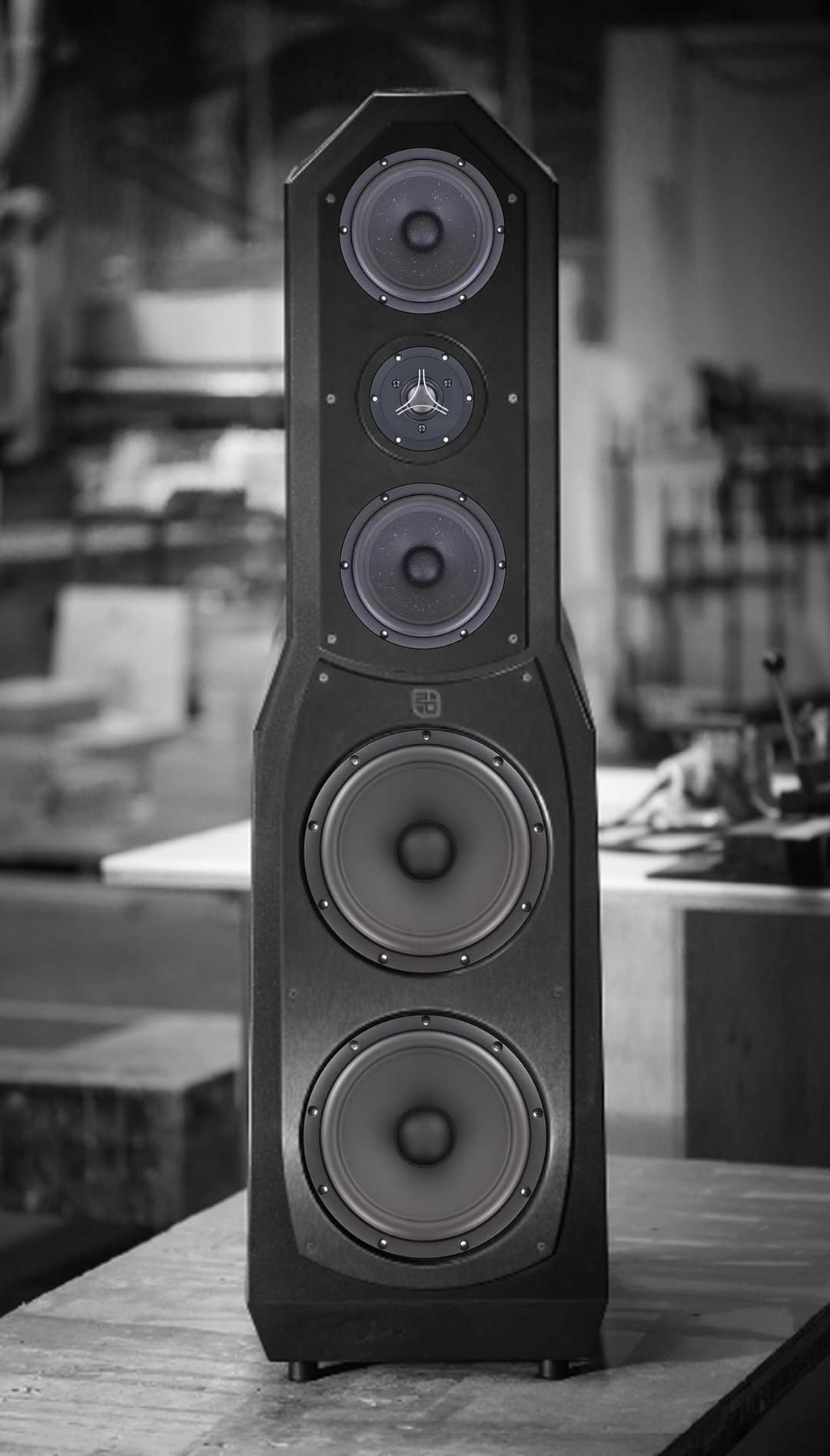

Since you got a subwoofer, why not go for the smaller SATORI 7.5" MW19TX-8 TeXtreme Cone Woofer instead of the WO24P. The timbre of the woofer will match the MW13 midrange better too.
The MW13 is limited to about 3k while the RAAL likes to operate above 5K. So you might have to choose another tweeter. SB's folded ribbon (Satori AT60NC) is also effective only above 5K. The TW28TXN, however, is a good choice.
thanks for your input, i will go with full Satori driver since it's originated in my country. inspired by Eaglestoneworks Viginti, configuration as below:
MR16P-8
TW29BN-4-B
MR16P-8
WO24P-8 x2
the option for midrange can be MR16 / MR13 or switch to MW series, i'll have to test later which one will match. i have a friend who has collections of Satori driver on his build, i will ask him to build the cabinet and borrow his driver for testing
I can use passive XO for mid-high where there are already many project outhere that can be used as starting point, and utilize my minidsp 2x4HD for woofer and upper section
