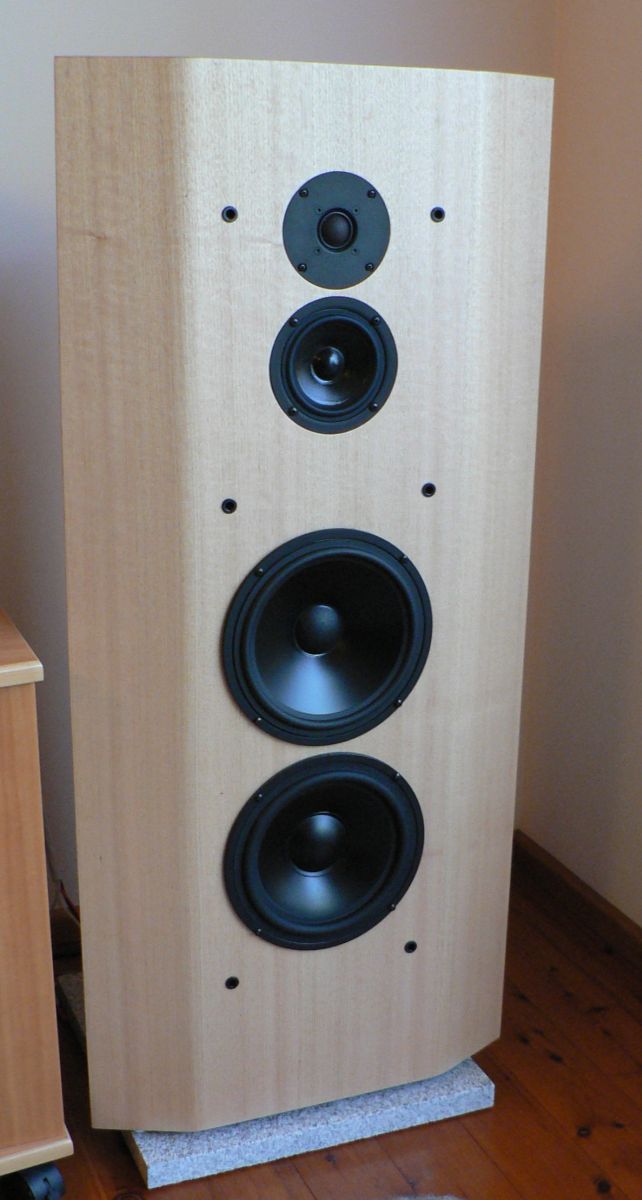

Seas 3-way wide baffle

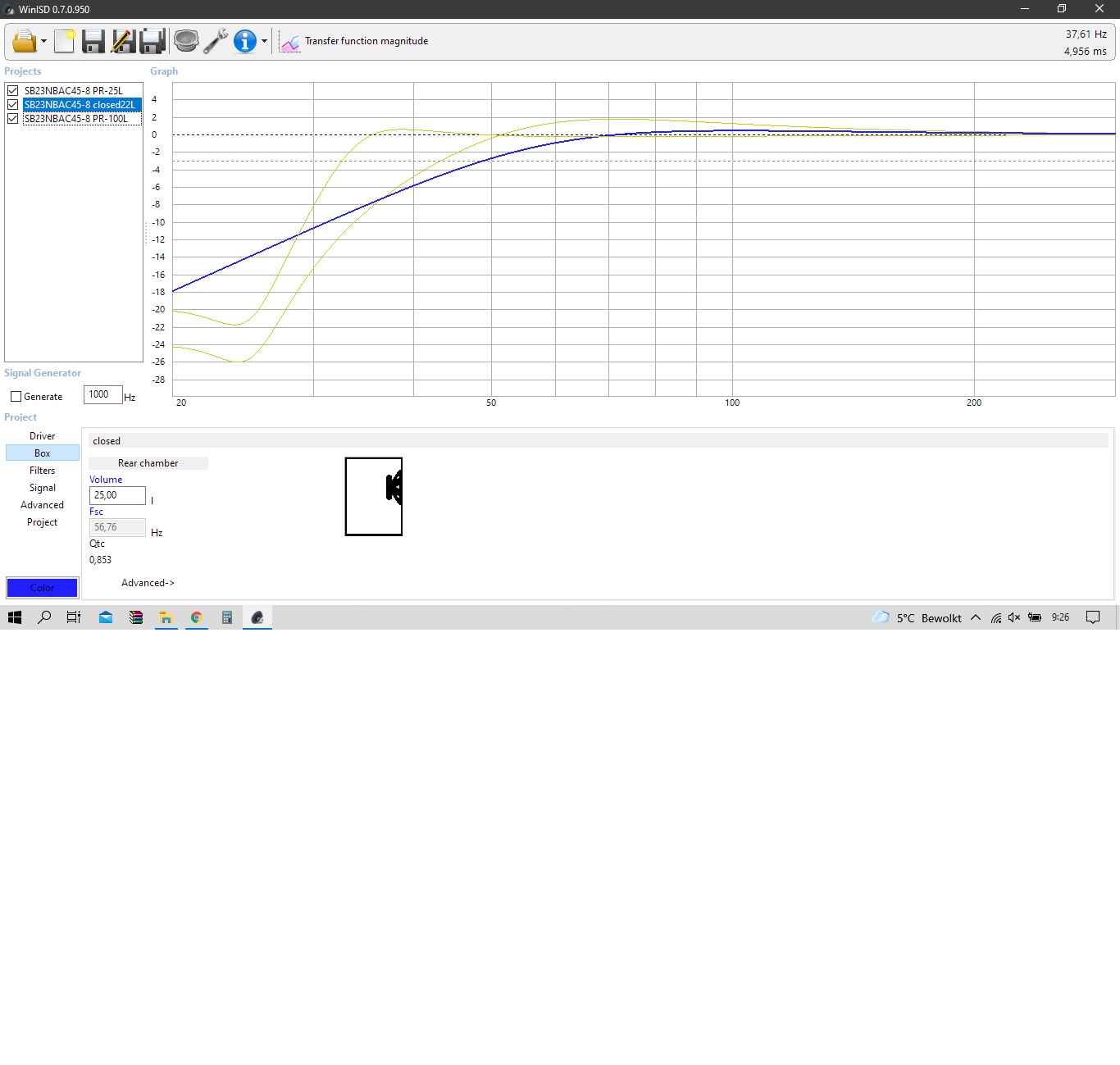

I did a sim of the sb23nbac in a 25l and it seem to work sealed.

I made some sim with WINISD and SB23NBAC-8 seems to go closed into a 25L box. Maybe it is better choice then the MFCL version.

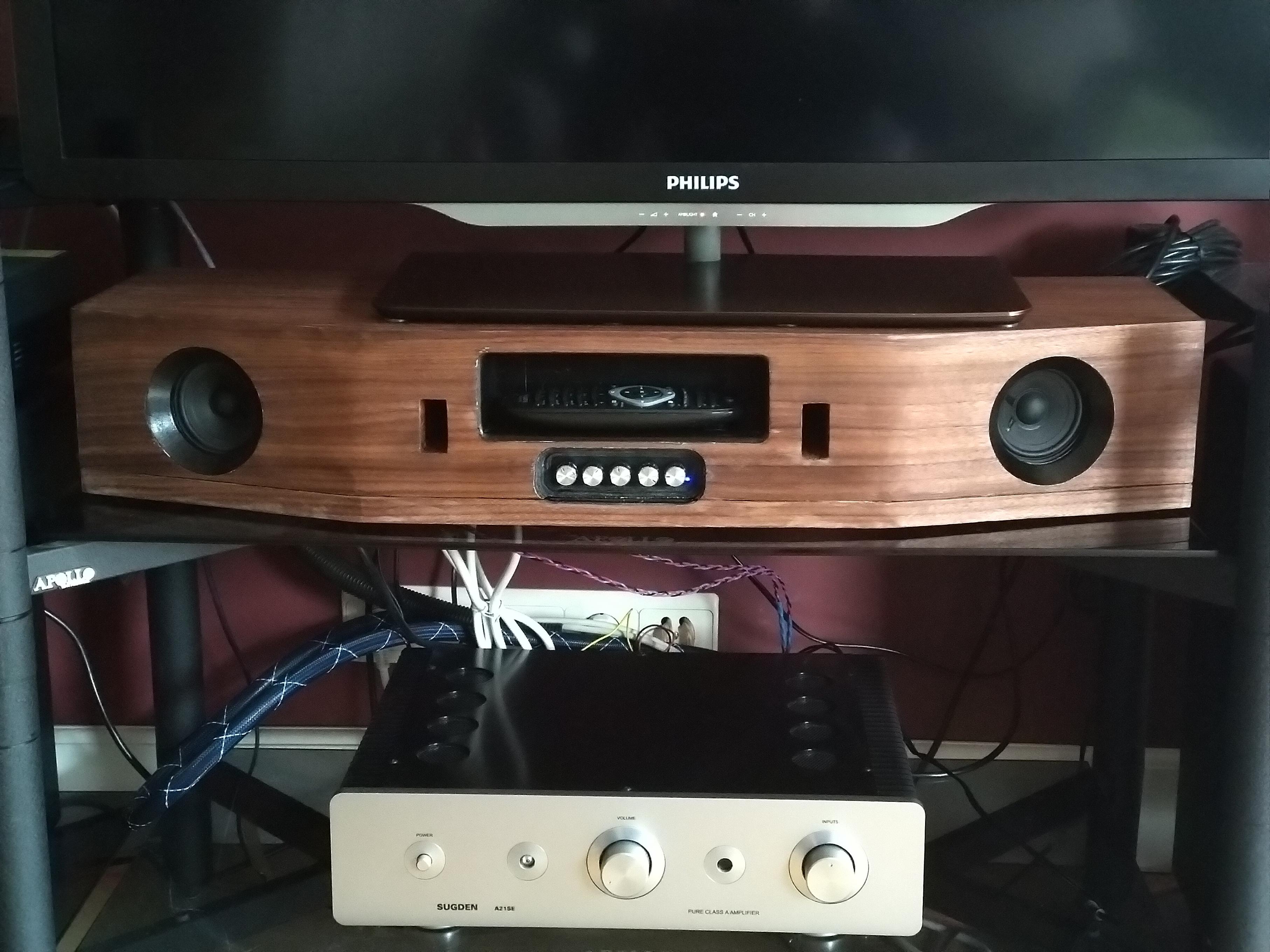

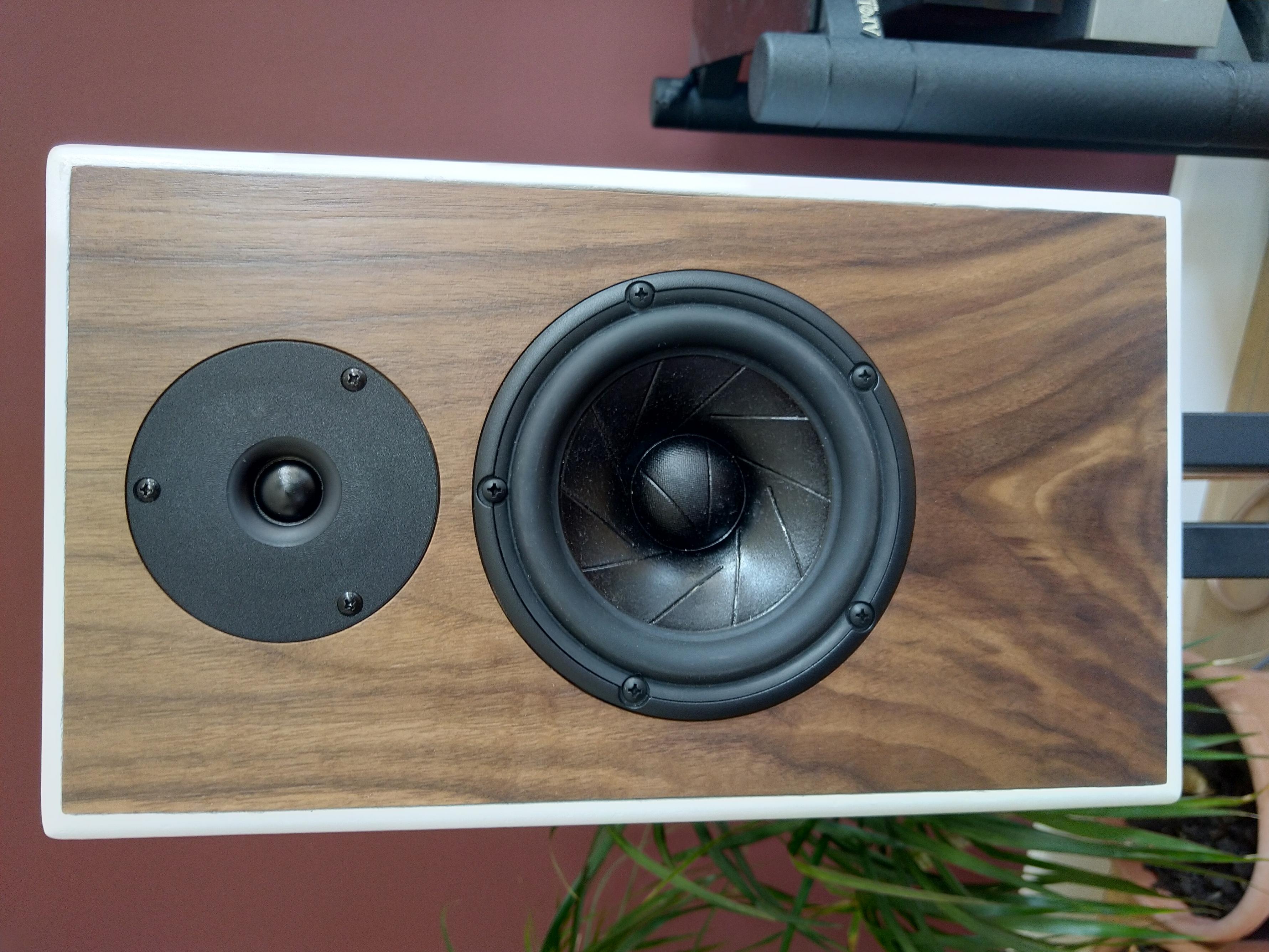

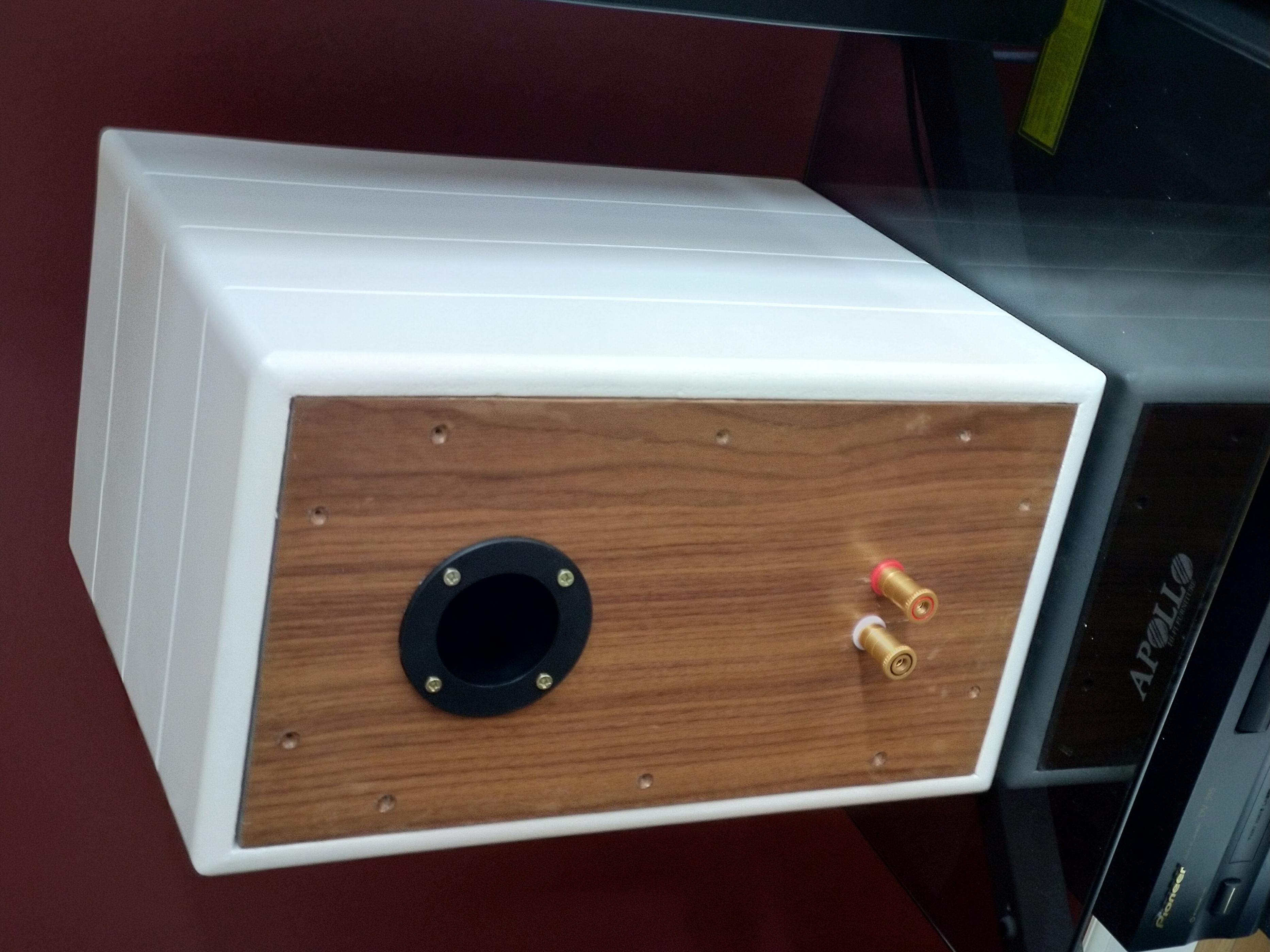

Peter, I never go the chance to upload my CARRERA build. Here some pic's. And the soundbar FR at the front and woofer on each side.
your design look very similar then the one I would like to build. Idea is to have some kind of closed panel speaker. wide, thin and high.
The 2way would be a good learning tool and you can compare to the Carrera as you go along. I didn't do a AR Series xo for that combination but have used both drivers. A good starting point would the the xo I suggested in the Tributes thread. Even though it shows different drivers, the SB26ADC works in the same xo with a slightly smaller resistor and the SB17MFC has similar behaviour so shouldn't vary too much as a starting point.

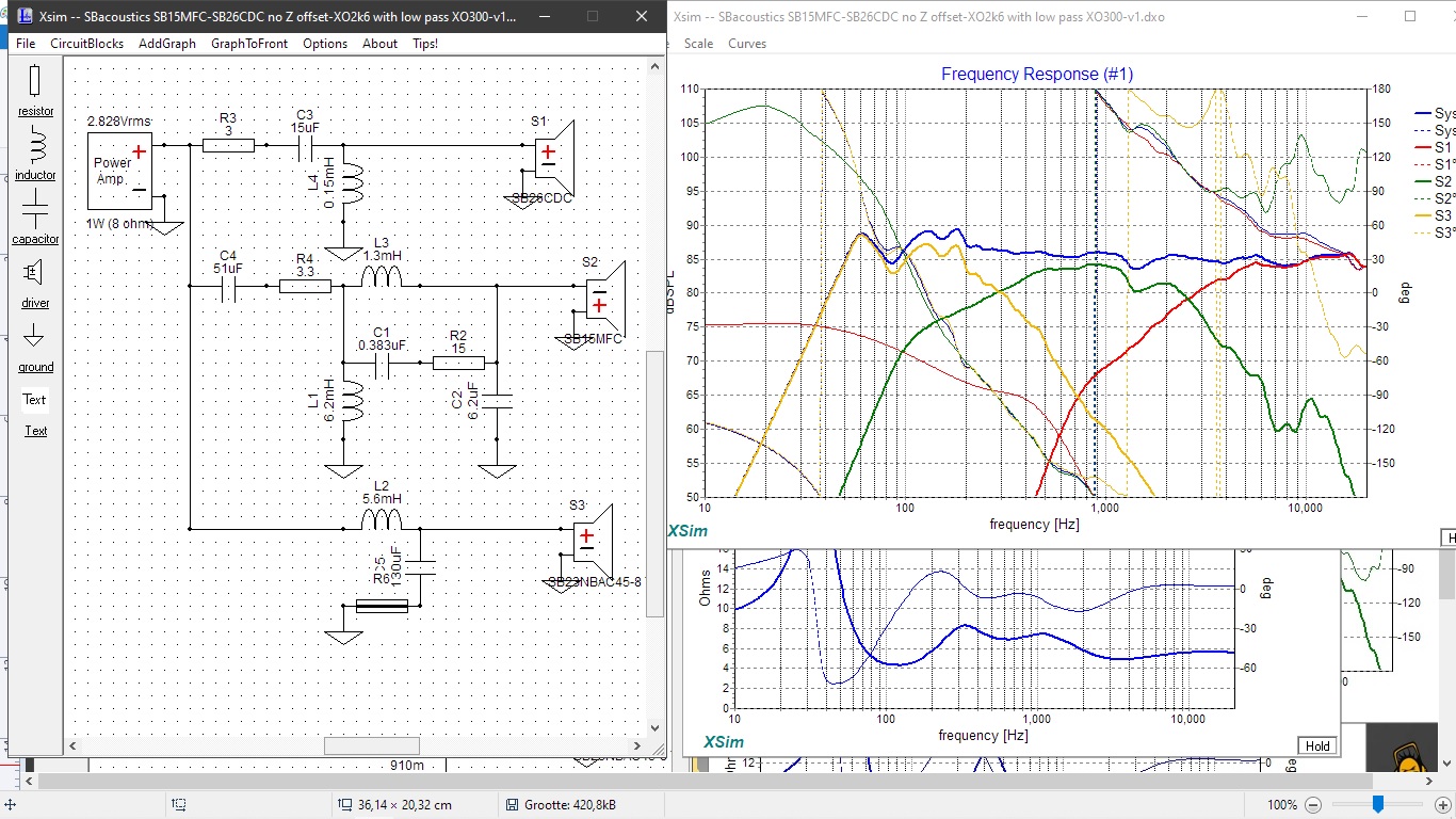

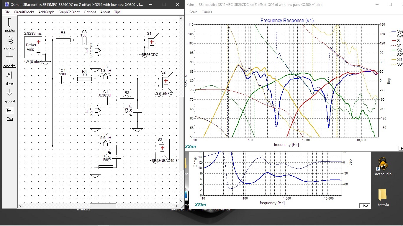

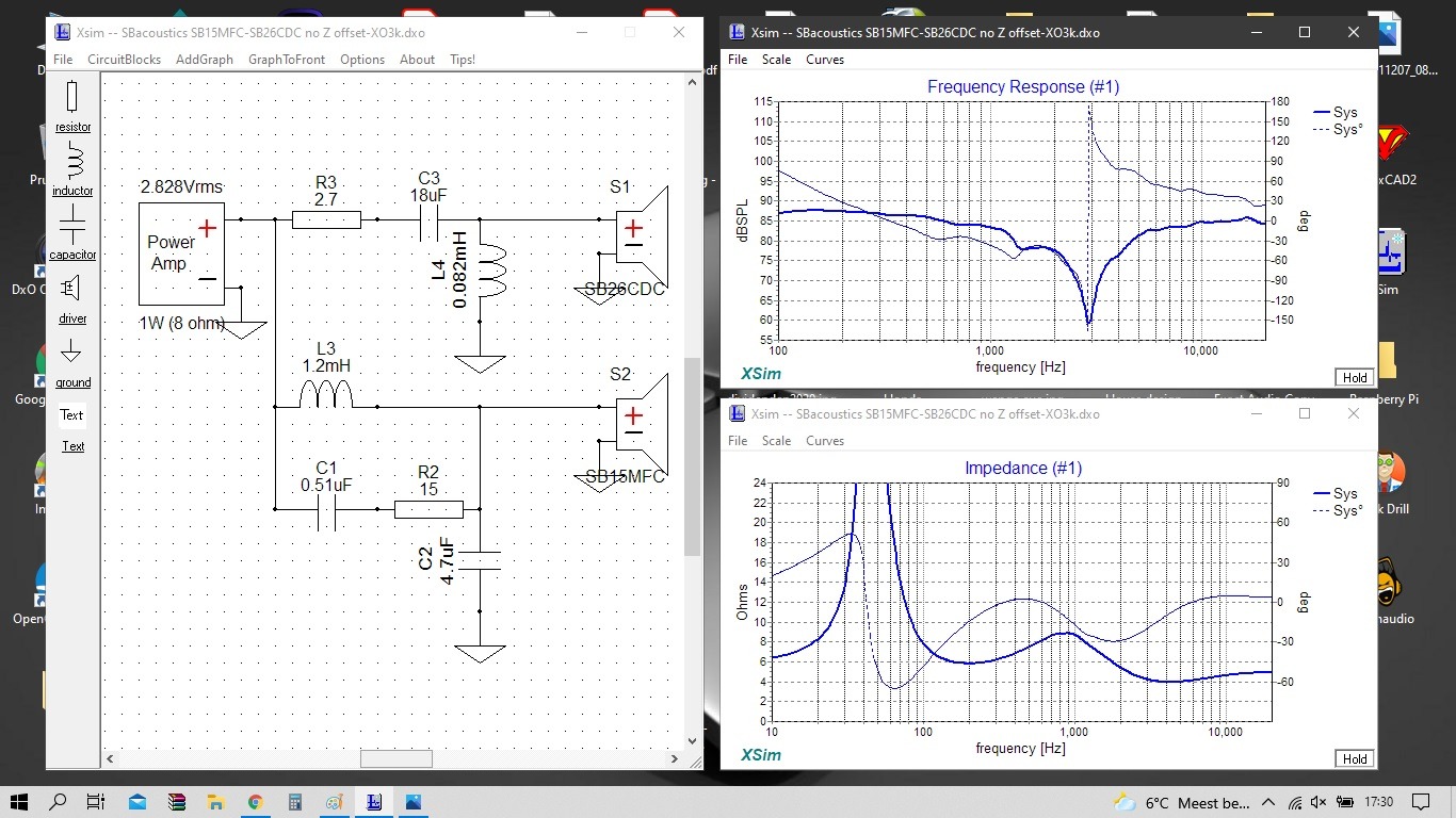

I tried some XO designs. Dont have the drivers yet, so I used existing measurements on infinity baffle. I assume a wide baffle of 40cm will not be much difference for mid and tweet.
So far I came up with this for 2-way and 3-way (couldn't find measurements on 26ADC so used 26CDC instead. Dont think they are much different. Didnt find any measurement on SB23NBAC either so didnt add it, just make some estimate to cross around 300Hz)
I guess it's sufficient for first sim. When I can do measurements I can go further.
Anyone have any thoughts suggestions on the XO?

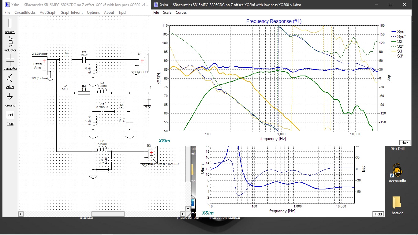

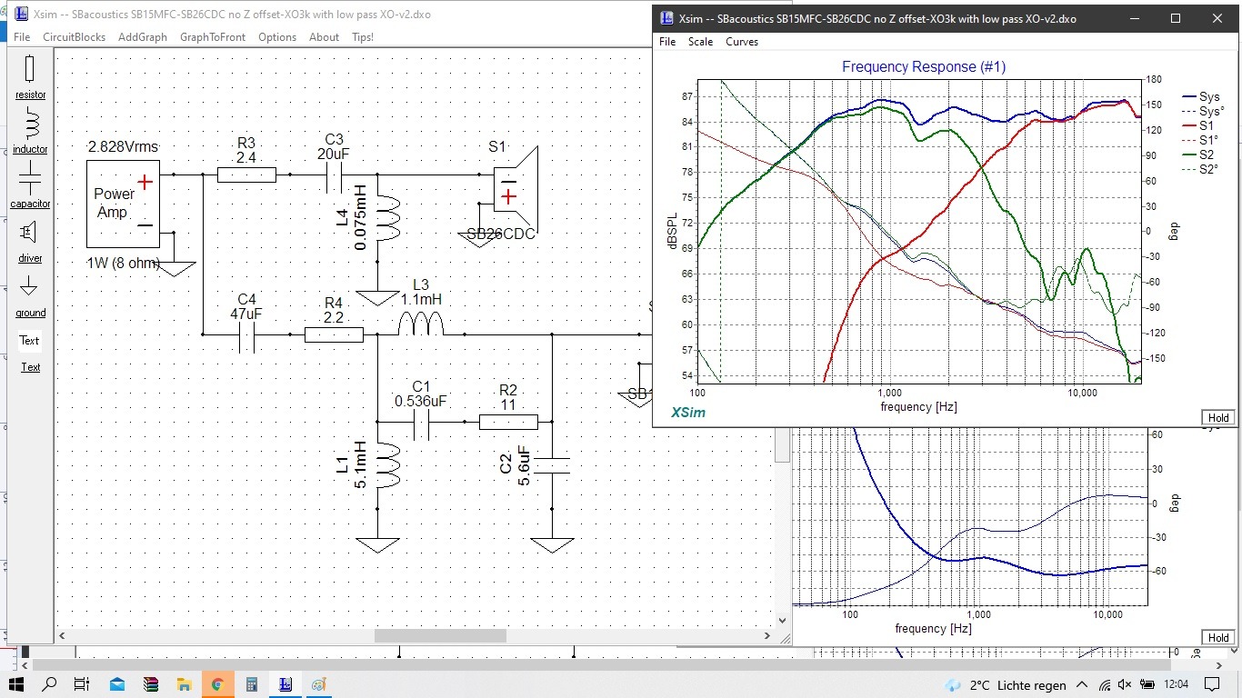

Fddled around a bit. Made trace in vitiuxCAD of SB23NBAC45-8 and added it to my XO. Made some small adjustments. This is what I came up with so far. XO @300 & @2k6
Any comments/remarks/improvements/suggestions?

I did my own version of the PMS too, reusing some Vifa paper bass and mid and bought new DXT tweeters. Good time alignment between mid and tweeter since the DXT is waveguided. I have never seen such smooth FR graphs as with this wide and rounded baffle (I made the rounding smooth). Almost textbook perfect LR2 acoustical slopes. Keep the baffle smooth, I did several iterations, tried some stepped baffle version first, but everything came together after I changed to the DXT tweeter and flat baffle with smooth rounding on the sides.When you come to the point where you stop feeling disconnected and everything falls into place?

Looking at your graphs above, I think you have some resonance phenomena happening on the HP slopes of the mid and tweeter (impedance peaks at driver resonances?). Maybe try a resistor (maybe 15ohms) in parallel to them and compare the slopes. I'm also a bit concerned about the breakup on the mid, could C1/R2 be adjusted a bit to smooth it out?

Notch on mid try to lower the peak at 6k. It is now 17db down. I tried to play a bit with C1/R2. But needs to make tradeoff in bringing the region of 6k and not bringing the 10k region to much up. maybe it still be fune-tuned a little though.
Would really appreciate if you can make things clear for me. Im still learning and need a lot of advice 😏
The fs of the tweeter is around 700Hz. That point is brought down 20db.
Maybe it would be better to make a separate thread for your project?
There are some 'knees' on the slopes, around 100Hz for the mid, which I think would be close to resonance for the mid, and therefor the cause. If you 'hold' the slope for the mid and add a 15ohm resistor in parallel with the driver for comparison, and the knee flattens out, it's a resonance. In that case you can do some tuning of the resistor, or ad a RLC to compensate for the impedance hump for the mid. Same goes for the tweeter.
Even if things like this are not visible on the summed FR, I found that they can color the sound. Many times you have some ringing going on at that frequency. I generally prefer FR curves that have no 'kinks/knees/bumps etc' just smooth rounded curves. You can try listening to the drivers one by one to hear 'colorations'.

Can you explain why? I see many post it to show phase integrated between the drivers.@MrHifiTunes, there is nothing to be gained from showing your crossover with reversed polarity.
The only reason to do it is when your crossover simulator doesn't show phase. It may also be done when you are in the process of measuring drivers together and can't see their separate phase.
In addition to that, while phase is important, the idea that it has to be exact enough to give a sharp null is a myth, and has no basis in fact.
