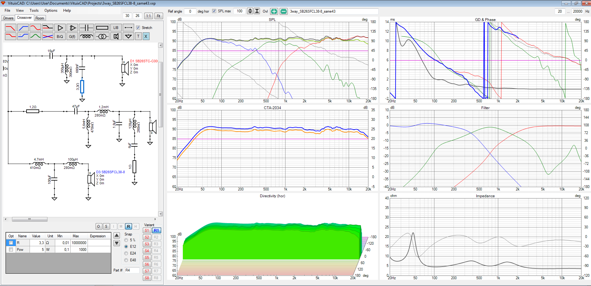

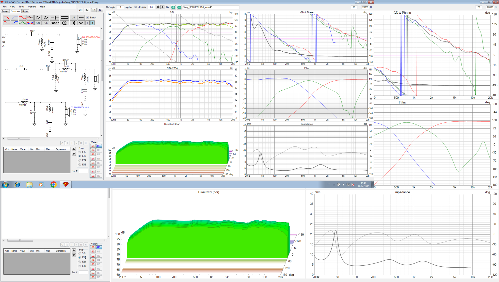

That's your filter, not the one in post #40 where you altered the notch from my suggestion.
this is the result with values suggested by you
I suspect you are tired of trying my suggestions by now. It's OK if you want to stop. That woofer that you are using as a mid has really bad breakup, I didn't look at the factory files till now.
One last thing. You never tried the .3uf cap in series with the .8mH coil. That may reduce some of that breakup. You might also want to cross lower than 2k.
No I'm not tired of trying. Any tentative to find a better solution is ok.I suspect you are tired of trying my suggestions by now. It's OK if you want to stop. That woofer that you are using as a mid has really bad breakup, I didn't look at the factory files till now.
Playin a bit with values I have now this result.
do you mean always in the notch filter?One last thing. You never tried the .3uf cap in series with the .8mH coil. That may reduce some of that breakup.
I tried to cross around 2000Hz (as my original project).You might also want to cross lower than 2k.

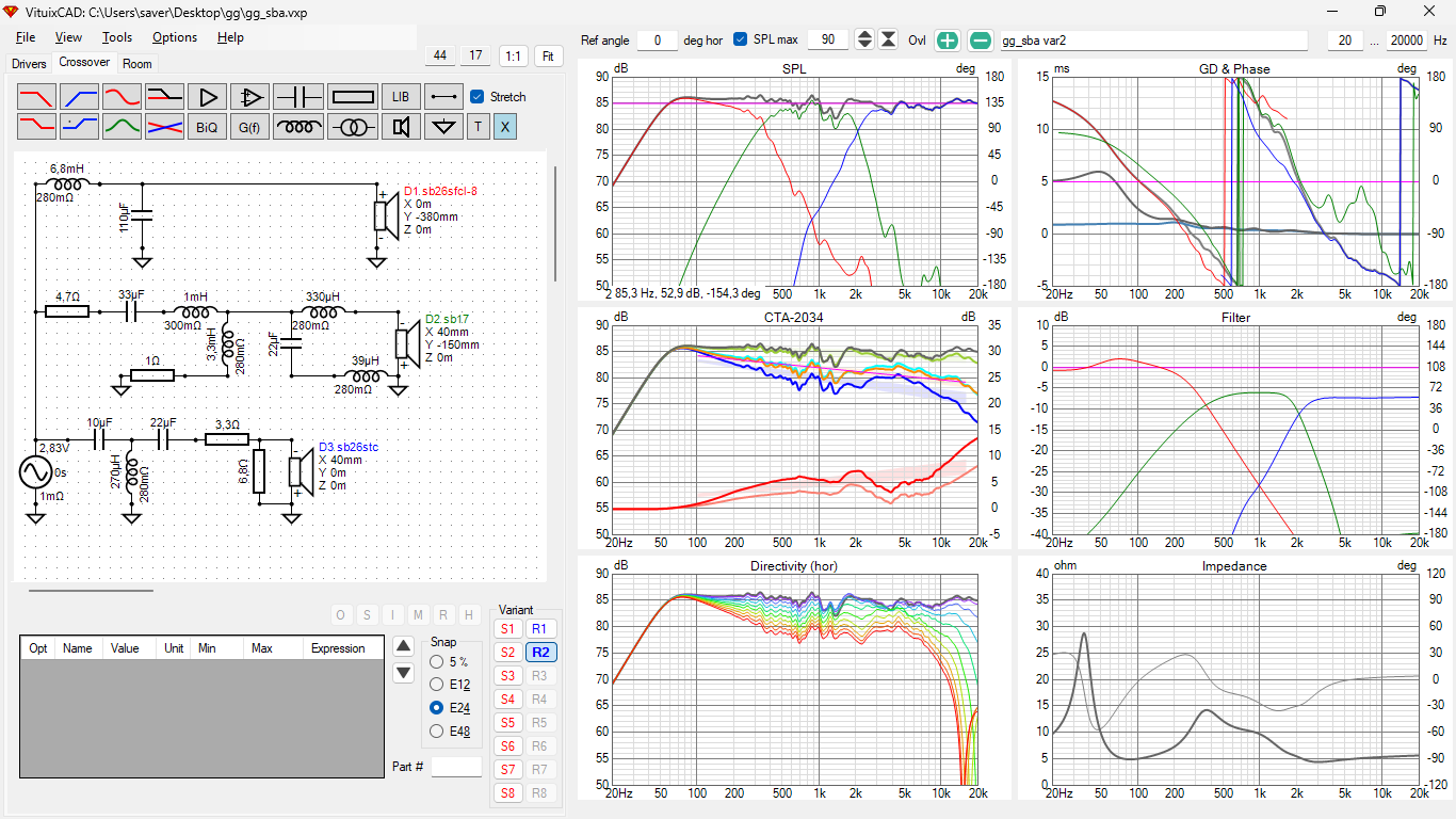

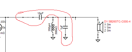

Hi, just a comment: why this 1uF capacitor to ground? In high frequencies you are basically shorting the amp to ground.
it is to control the impedence and compensate the effect of the 15uF cap. If I remove it then we the impedence will decrese to less then 2 ohm between 4 and 10kHz
I would put a least a resistor in series with the 1uF. You can try 4.7ohms for example.
Something like this?
In the solution I've shown on post #76, impedance is always above 4ohms and there is no direct capacitor path to ground.
This might cause issues with your amp.

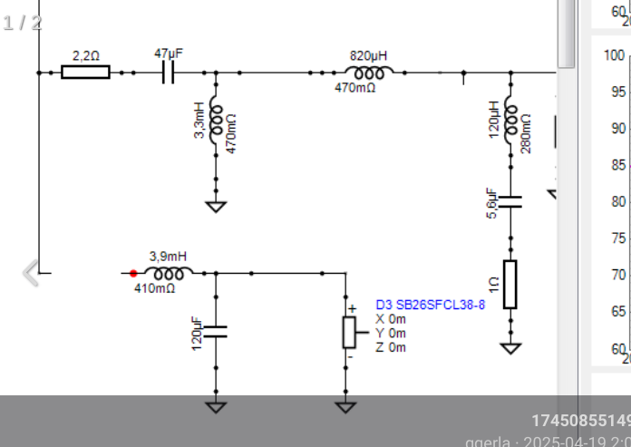

I tried to replicate you r schema but it seems based on datasheet graphs there are not similar to enclosure and diffraction simulations.

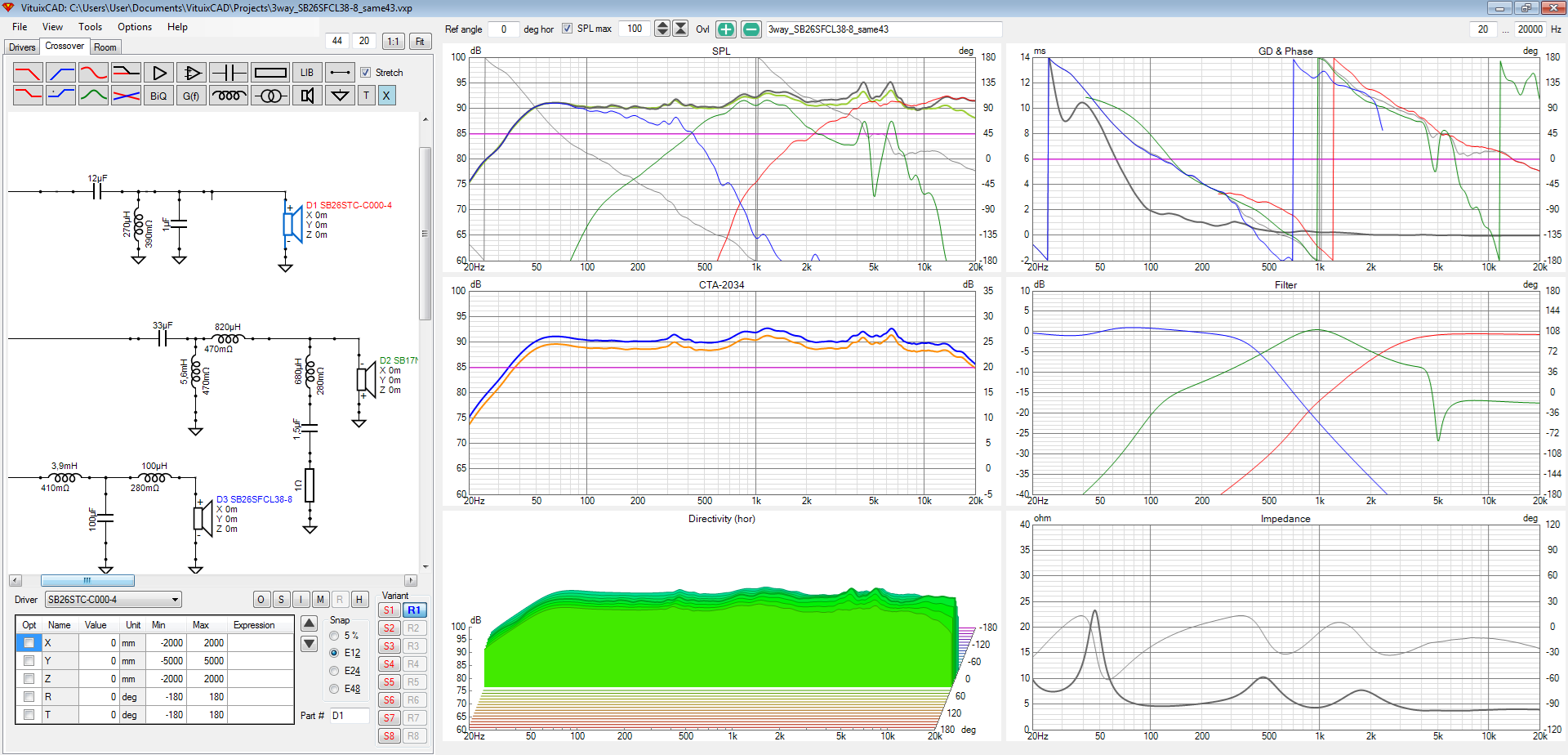

A cap in parallel with the 1.2mH coil can make a notch. Try some very small values, and observe the effect. Sometimes a notch like this is very helpful. Other times it's not a good option. The response above the notch tends to come back up, so it's a juggling act. A .3uf cap on the .8mH in the other Sims would be tuned around 10k I think. It will be lower if added across the 1.2mH. You will have two notches to play with. Could be an advantage, but who knows. Try a few common values. (.22, .33, .44uf) If it doesn't work, you will know pretty quick.No I'm not tired of trying. Any tentative to find a better solution is ok.
Oh I'm so sorry. I previously said to put the cap in series with the coil. I guess I was having a senior moment. I used the wrong word. You put it in parallel with the coil.
Hey, I think it is a good idea
Yes! If this meets your other requirements, I think it's better to keep this resistor.Something like this?
In terms of a flat frequency response and sensible Impedance and phase that does look nice.

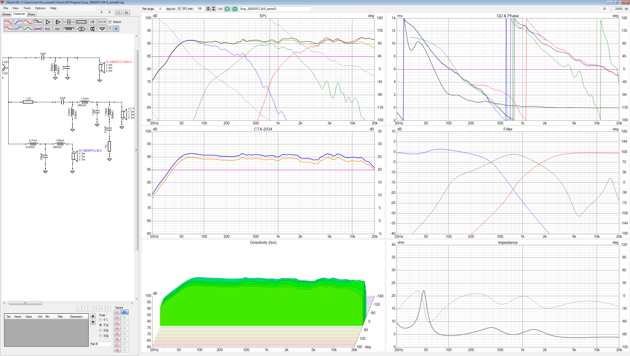

I think the two crossover frequencies are too close, 450 and 1800Hz roughly. And that when it is made it will not be so beautiful. I believe that without measuring the drivers in the boxes and new simulation, he should not buy parts for the crossover.

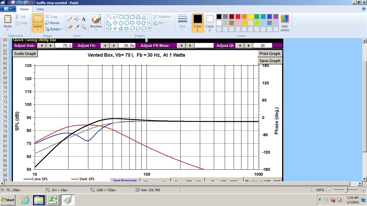

This should help the situation. I initially took for granted that your bass sim was OK. It's not. If you have included room gain, maybe it is.
This is the woofer at 1w. Sealed, and ported shown. Ported changes nothing above 100hz.
Baffle loss is 6dB, and depending on baffle dimensions, it's about 5dB at 100hz.
So, if you sim for no BSC, you would be at 88dB for the speaker. If you sim for 4dB of BSC, you would be at 84dB for the speaker.
Unless I used the wrong data, you're not going to be even close to 90dB.
If I'm wrong, I apologize in advance.
In a typical room, 3-4dB of baffle step correction may be sufficient. But it is still necessary to have some correction. This means that the mids and highs have to be muted by that much. It's not even bad, because he can raise the impedance a bit on the tweeter part.

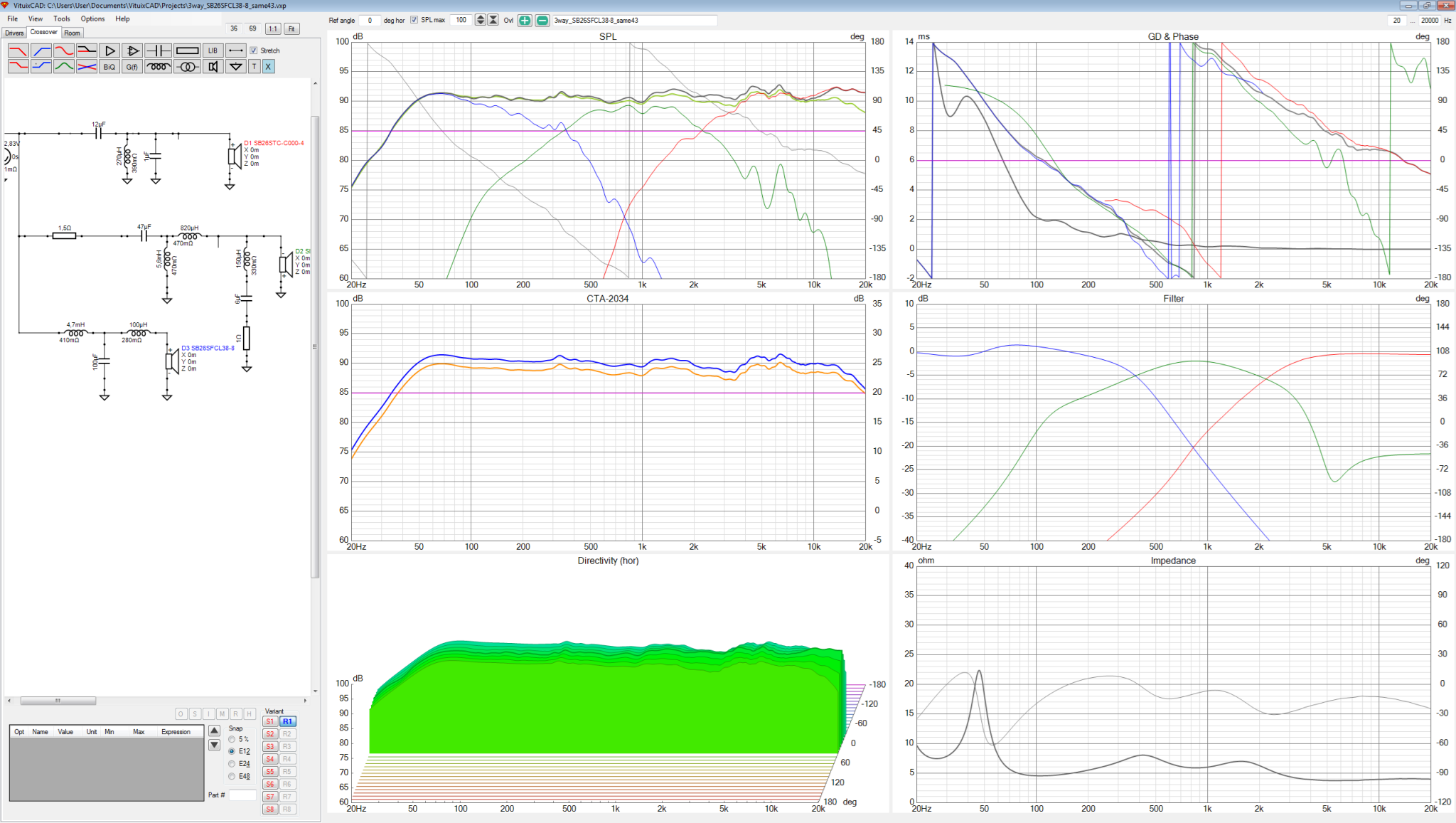

I do not like steep slope but that's what I came up with: on-axis FR is a bit rugged, but off-axis, PIR and SP FR are quite decent, at least in simulation.

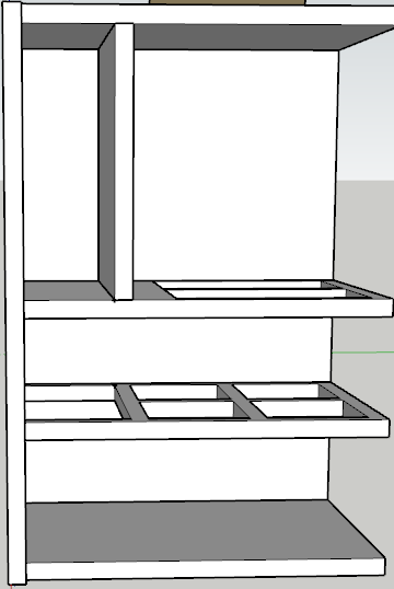

Baffle is 38x63cm and the woofer enclosure is a closed box of 70L (full stuffed).
Mid and tw have 4cm offset to the right.
Woofer is 17cm from the bottom.

So the cabinet should have external size heigth 63cm, width 38 cm and depth 45 cm. I would use hard plywood (or MDF) of 19mm. For the midrange and tweeter the idea is to have a "mini room" of height 24,5 cm, width 34 cm and depth of 12 cm, something like this

Then I simulted the diffraction.
How can I simulate the BSC?
