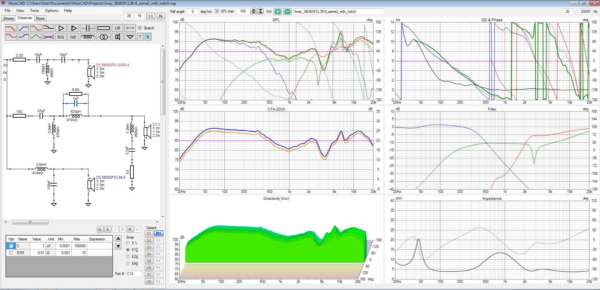

mmm adding the notch there doesn't seems work. I tried several values, but the result is bad. In my schema there were also another coil after the notch.

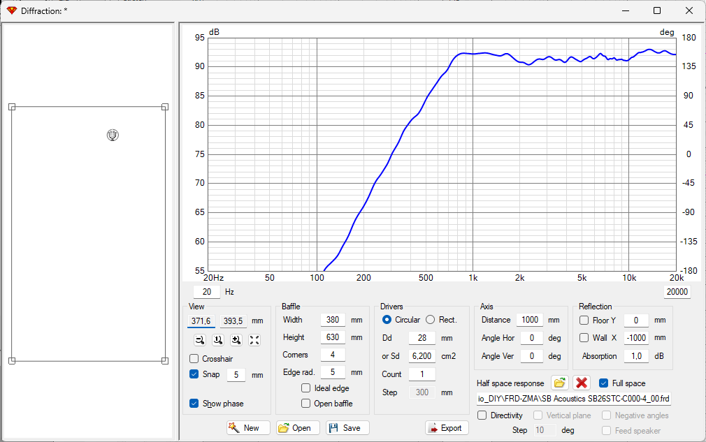

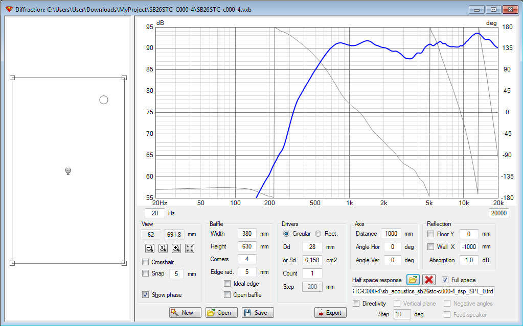

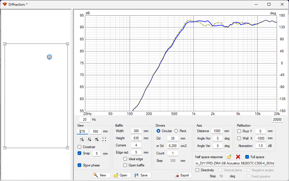

this is the response simulated with diffraction I'm using for the tweeter
it is not the filter that is reducing 5db at 4kHz. It is the diffraction.

You didn't try values below 1uf. Put a .3uf in there. And get rid of the 5.6 ohm resistor.mmm adding the notch there doesn't seems work. I tried several values, but the result is bad. In my schema there were also another coil after the notch.

The filter is also reducing it 5dB. Look at the red line in your filter transfer functions.mmm adding the notch there doesn't seems work. I tried several values, but the result is bad. In my schema there were also another coil after the notch.

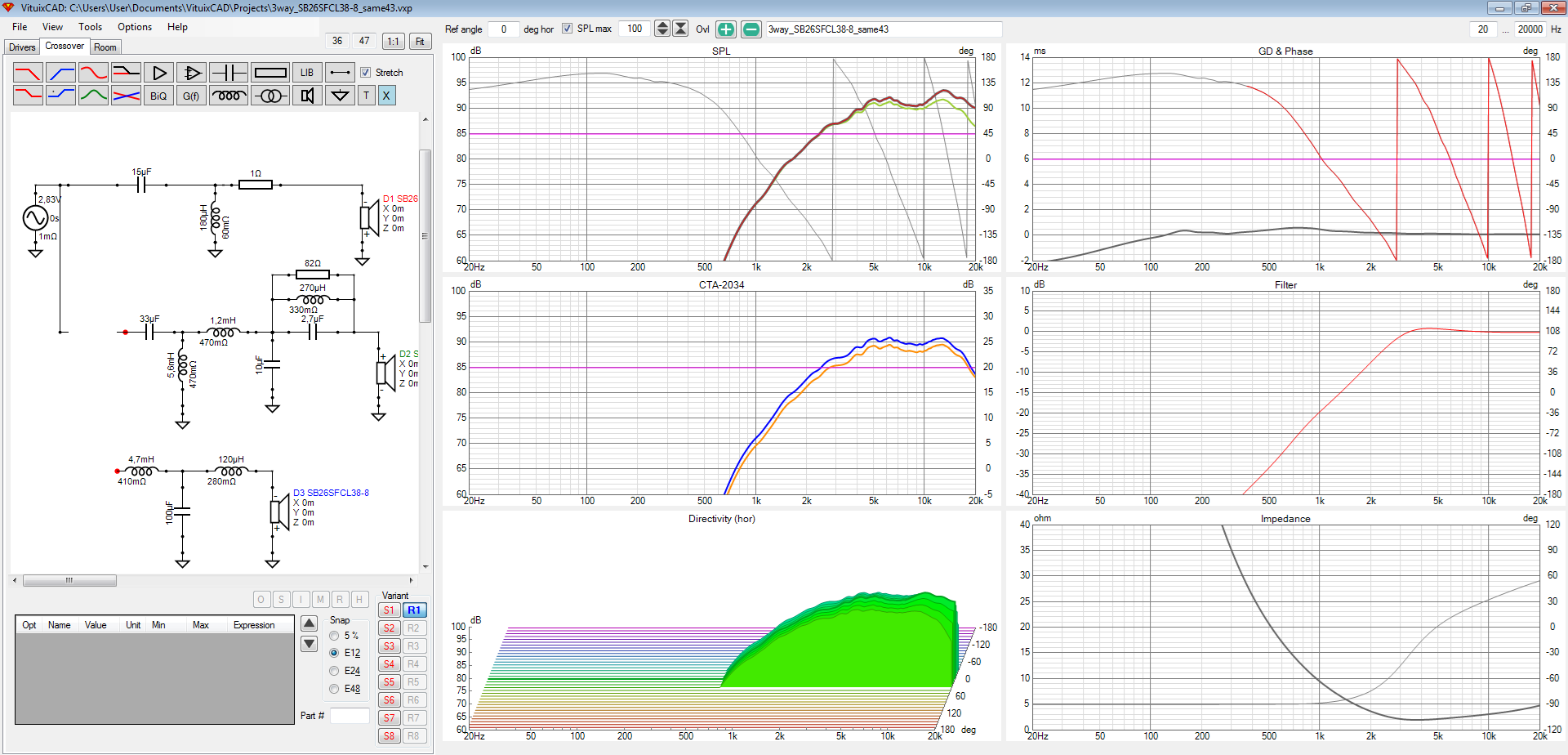

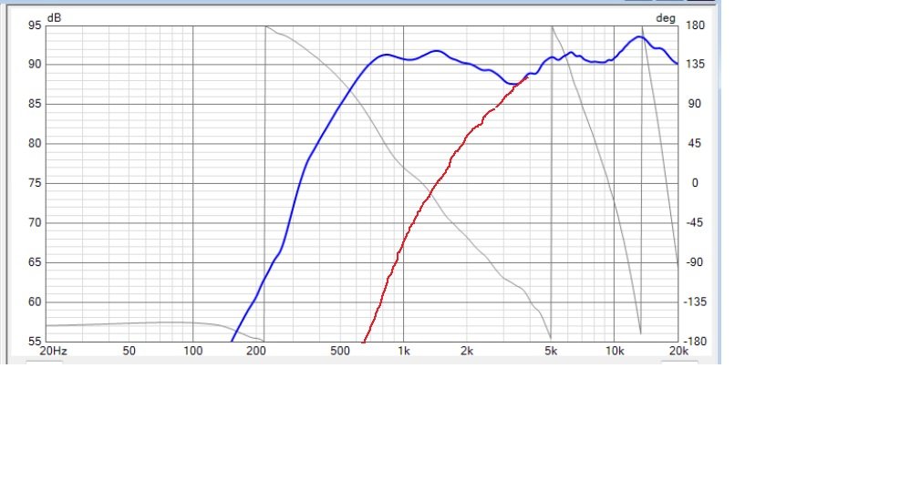

Filter the tweeter to be flat at 90dB, and -6dB at 3k. Should be doable with a 2nd, or 3rd order filter. I just did it in 2 minutes on a sim. I suspect third will sum better, but also try 2nd.
Sometimes filters don't cooperate. The impedance makes a difference.
You want to turn the raw response into something like the red response I added in Paint.

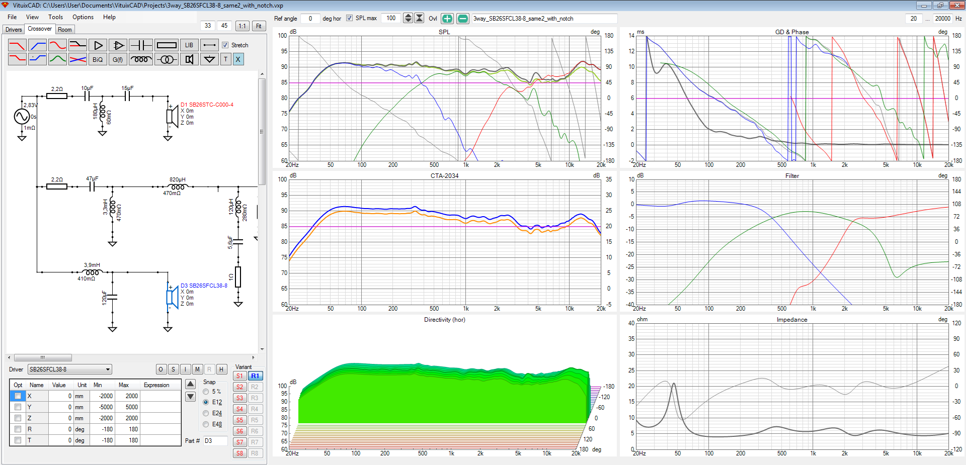

I designed the cabninet, all SPL response and the crossover. My only problem is that the final impedence seems too low (about 2 ohm expecially at high freq) and I'm not able to adjust it. I tried with LPAD, but I'm not so familiar and I was not able to reach good result.
Can someone help me?

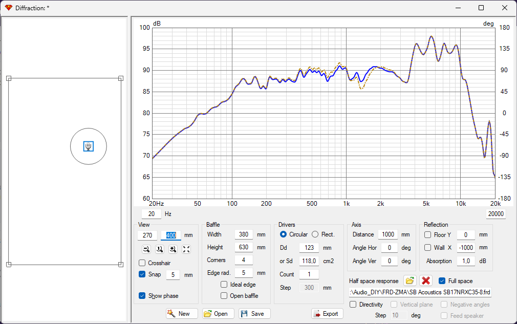

How did you get this risult?If the distances of the driver centre from the edges of the baffle are different, you can get a better FR.
I'm not able to replicate it
I have not saved the DT project, but generally i set the TW at 7-8cm from the top and then I move the driver to the left/right till I get a good FR.
Consider that you have to move your mid too so you cannot go very close to the edge.
Tw (270-550mm, centre position is overlayed)
Mid (270-400mm, centre position is overlayed)
something like this?
the impedence is still low...

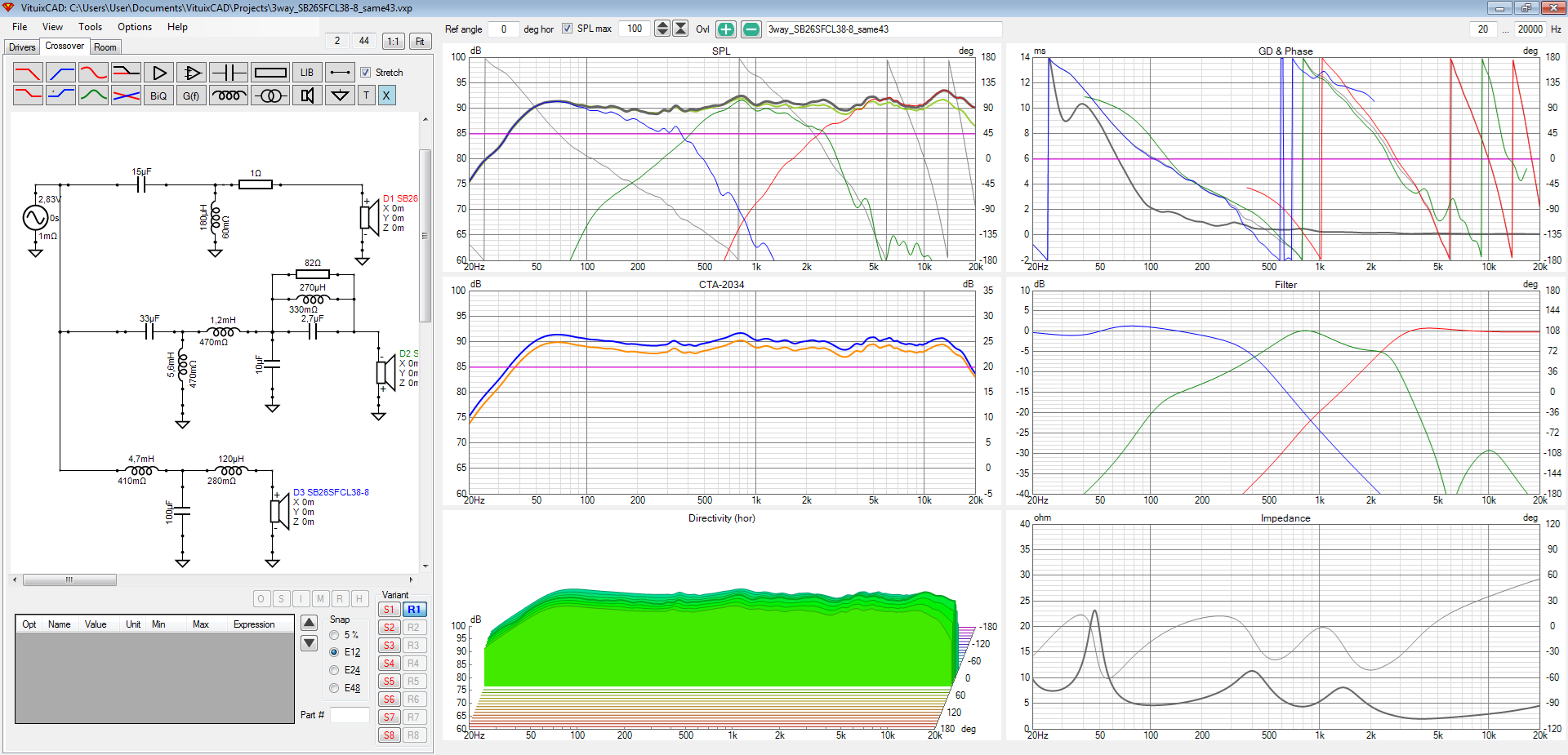

in any case with this configuration, enabling the mid and woofer I obtain this result
I think we are using different .frd files, because at the same XY i have different results.I have not saved the DT project, but generally i set the TW at 7-8cm from the top and then I move the driver to the left/right till I get a good FR.

Your tweeter cap is too large (15 uF) and the coil too small (180 uH).the impedence is still low...
That essentially shorts a lot of energy and reduces impedance to unusable levels.
You could start with standard filter calculator values to avoid this error.
You could also put the resistor before the shunt coil.
