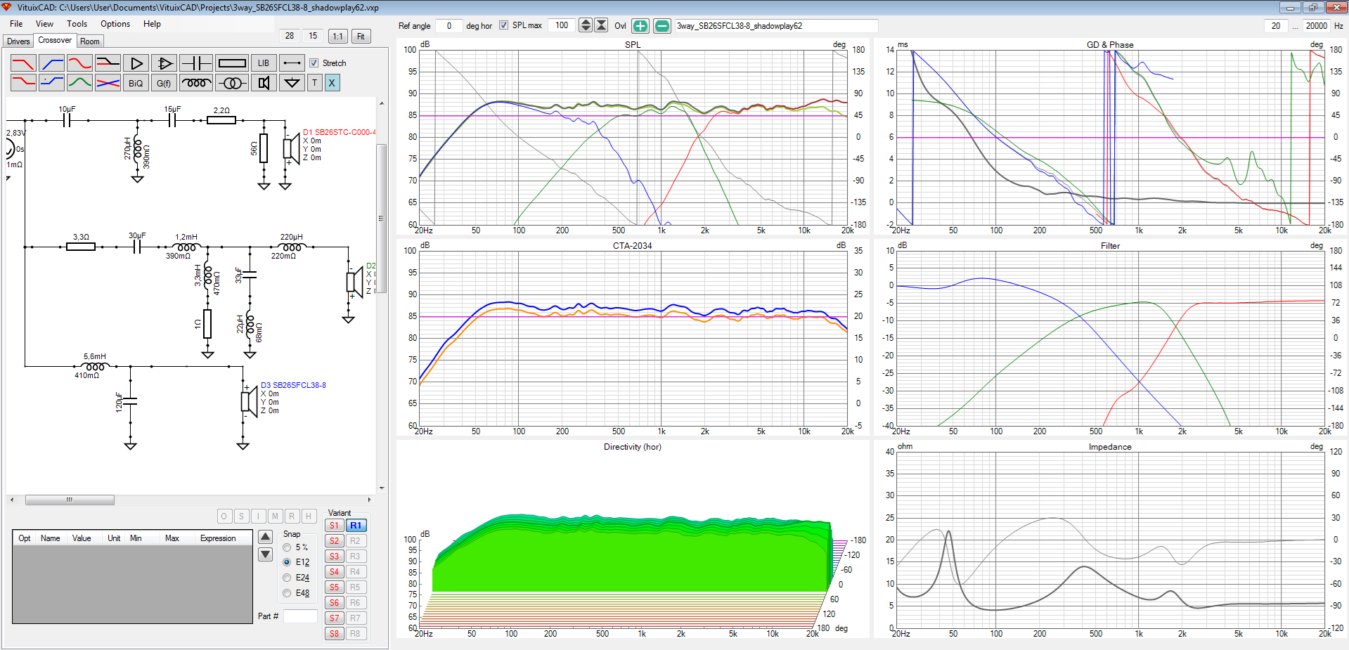

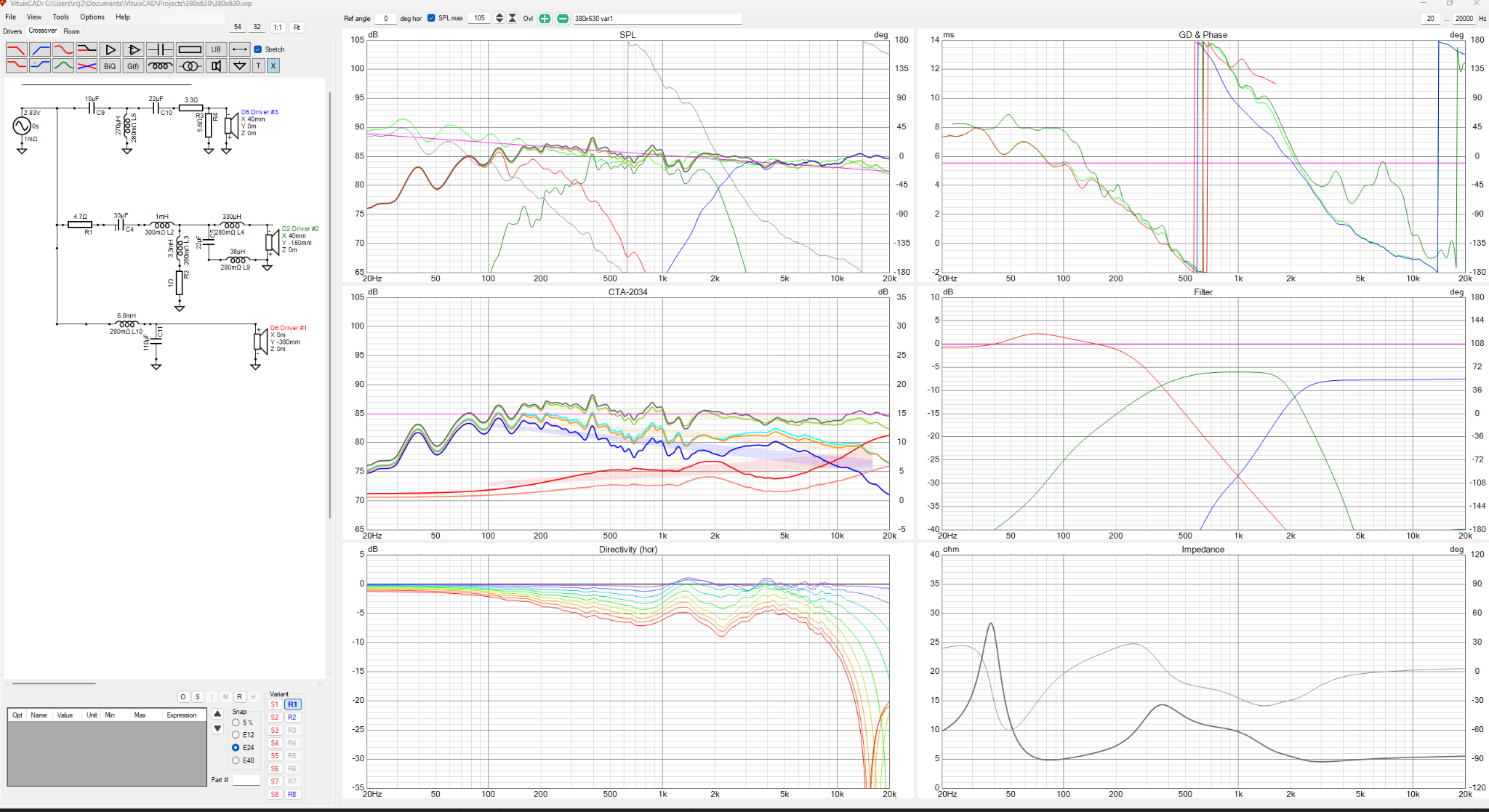

So fixing the woofer response I can obtain:
It looks good.

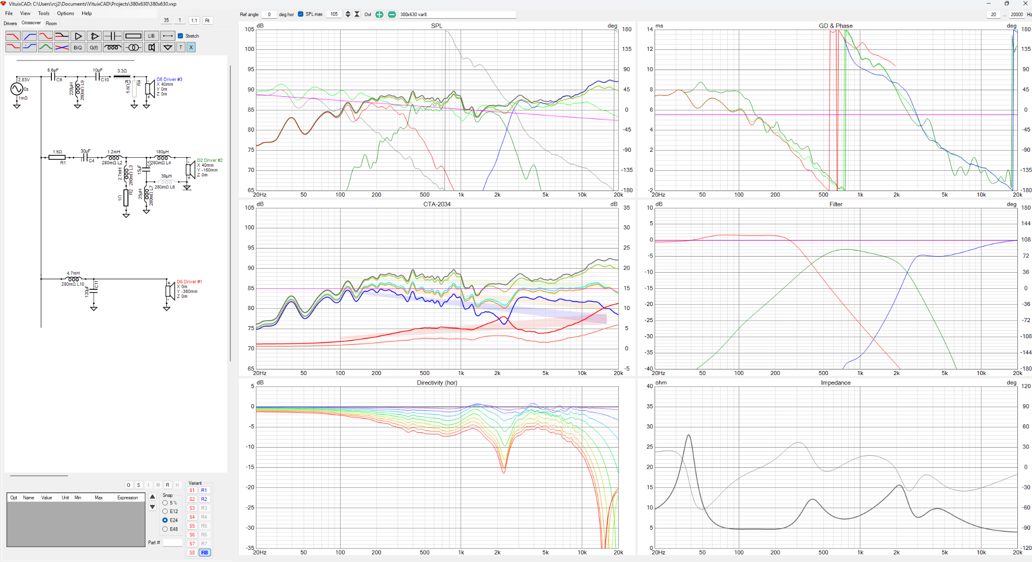

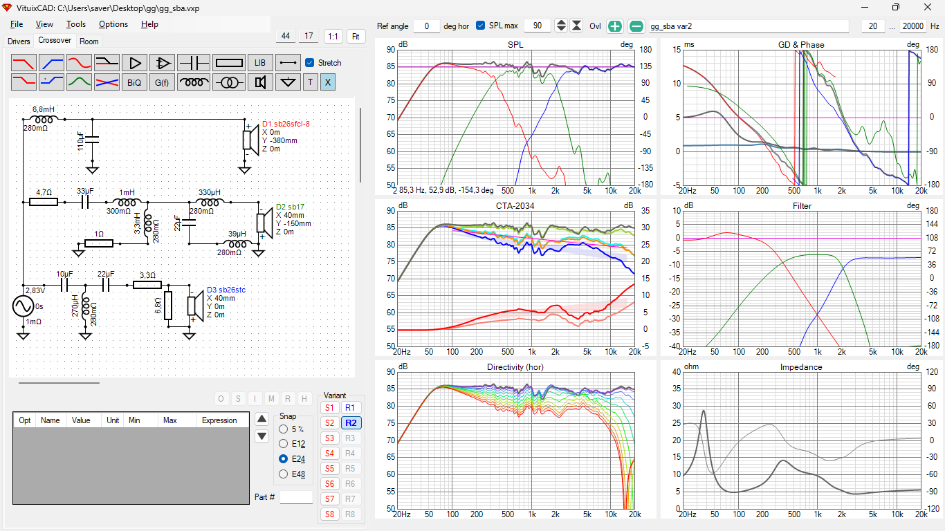

I do not like steep slope but that's what I came up with: on-axis FR is a bit rugged, but off-axis, PIR and SP FR are quite decent, at least in simulation.
Baffle is 38x63cm and the woofer enclosure is a closed box of 70L (full stuffed).
Mid and tw have 4cm offset to the right.
Woofer is 17cm from the bottom.
I also tried the version suggested by you and also this one seems quite good.

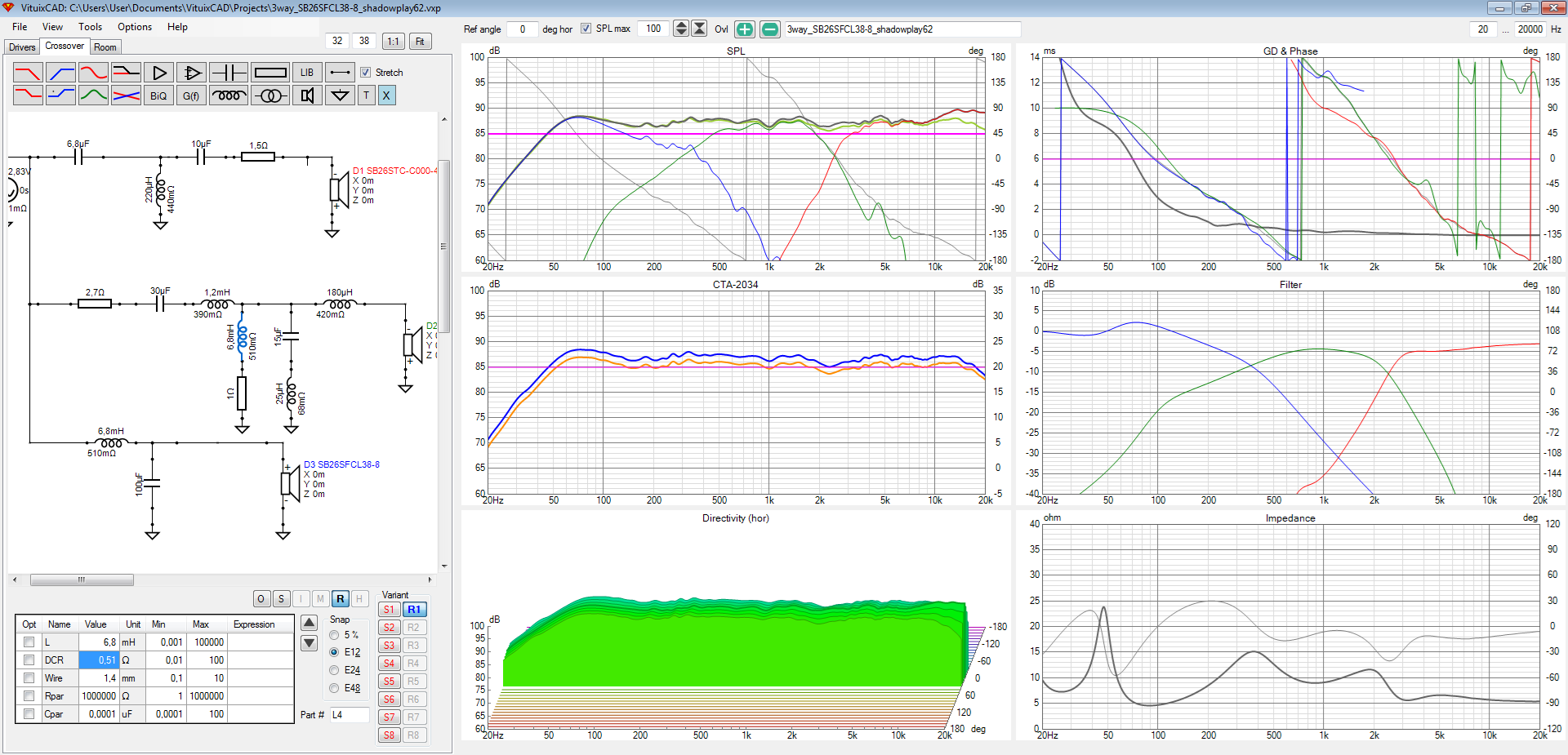

You have greatly reduced the impedance on the bass section. That's not good at all. Increase inductance, decrease capacitance
it is not so easy to change values there... increasing the coil and reducing the cap generates a hole around 200Hz.
In any case below a tentative

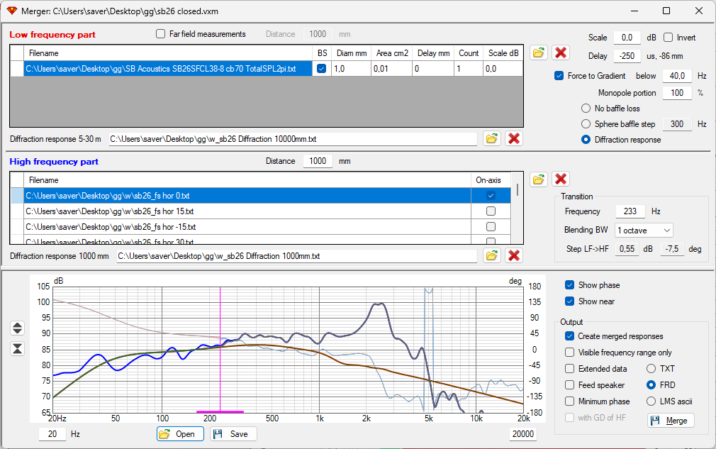

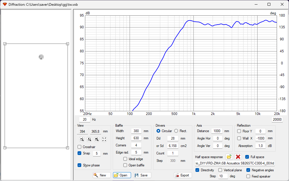

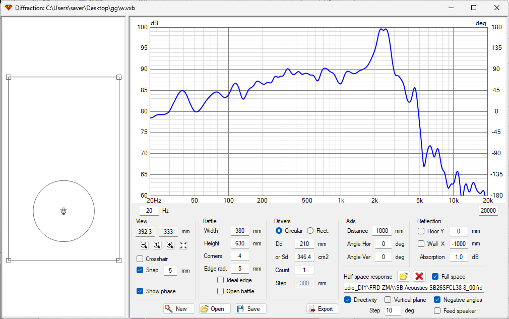

Generate the LF part in the enclosure tool and export itHow can I simulate the BSC?
Generate the diffraction resp. at 10m/1m in the diffraction tool and export them
Generate the HF part (full space at 1m) in the diffraction tool; check the Directivity option if you wanna simulate off-axis responses and export them
Load all the FR in the merger tool and export them
Repeat the same procedure for the midrange
Generate off-axis FR for the tw and export them

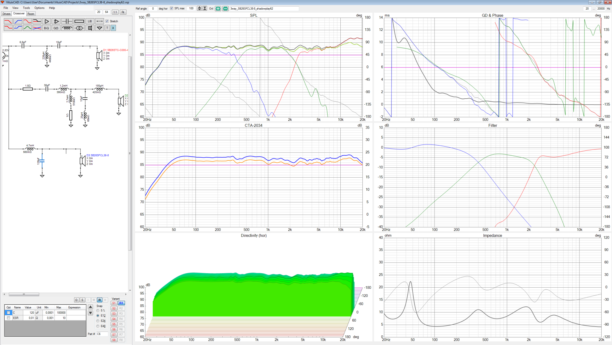

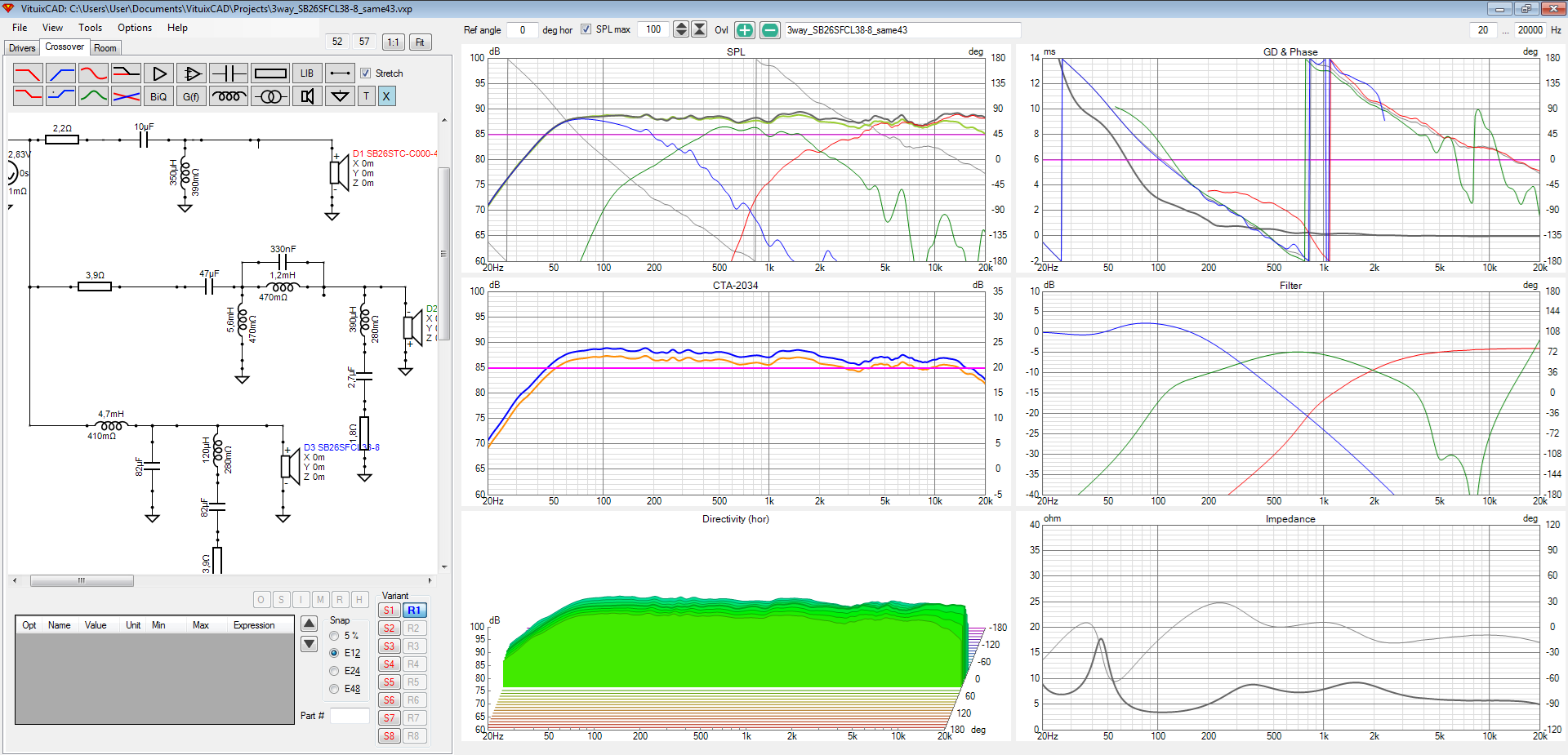

thanks all for your suggestion.
After yours input about the woofer enclosure and diffraction simulation I lowered a bit the resonant frequency to 28Hz reducing the SPL at 50 Hz to 88db.
This is the final result
I moved the lower crossover around 350 Hz and then the tweeter crossover around 2400Hz.
Do you think that this is a good result?
I think it would be very interesting to see your latest crossover modelled by Shadowplay62 so we could compare the two.
I have tried to do it myself but as it is my first attempt with the merge tool I think I am probably going wrong there. Plus I have a suspicion that I have placed the mid 5mm in error. Consequently I cannot say this is good data.

Shodowplay62's post earlier in the thread gave suggestions.
What I aimed to used in the diffraction calculator were the following:
Bass width 190, height 185, and SD 210
Mid 230, 420 and SD 118 and I imported a ZMA file representative of the mid in a 10 Litre sealed Cabinet
Tweeter 230, 565. SD 6.2
I have a feeling I was out by 5mm though on my mid height, and i haven't had time to retrace my steps or do some further verification on merging things correctly.

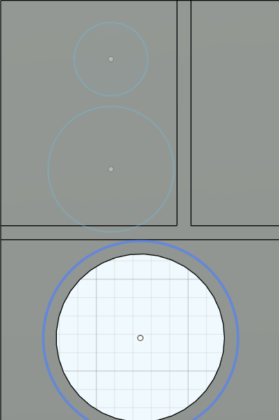

I have just one doubt... the distance between the outer circle of woofer and mid on Y axis is less then 19 mm. Inside the cabinet I need to create the room for the mid and tweeter...
Is this ok?
I think there will need to be some modifications if it doesn't fit your mid compartment dimensions.
Ideally you want an internal 45 degree chamfer for the midrange. So this should be factored in to get the midwoofer snug in its new home.
I think from the various posts and your own Xover iterations you should be able to re specify the cabinet dimensions slightly to allow everything to fit. nicely and re model.

You need to consider the diameter of the holes (145 and 230mm). The drivers should fit well. You can increase the M-W ctc distance to 24cm moving the woofer down by 1cm: there will be a slight change in the vertical directivity: I tried to increase the distance in my simulation and I did not see any differences.Ok thanks
Is this ok?
