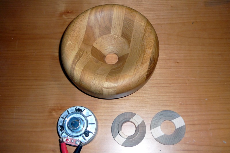

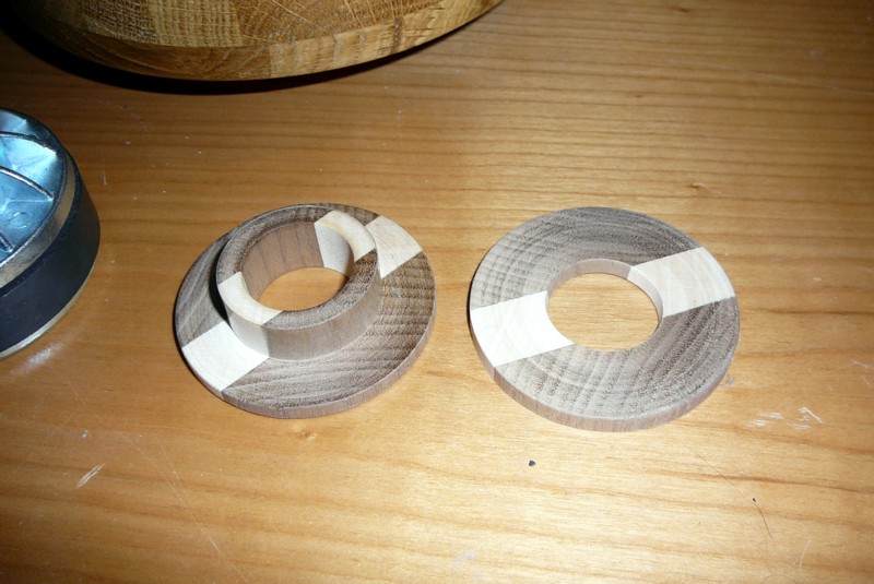

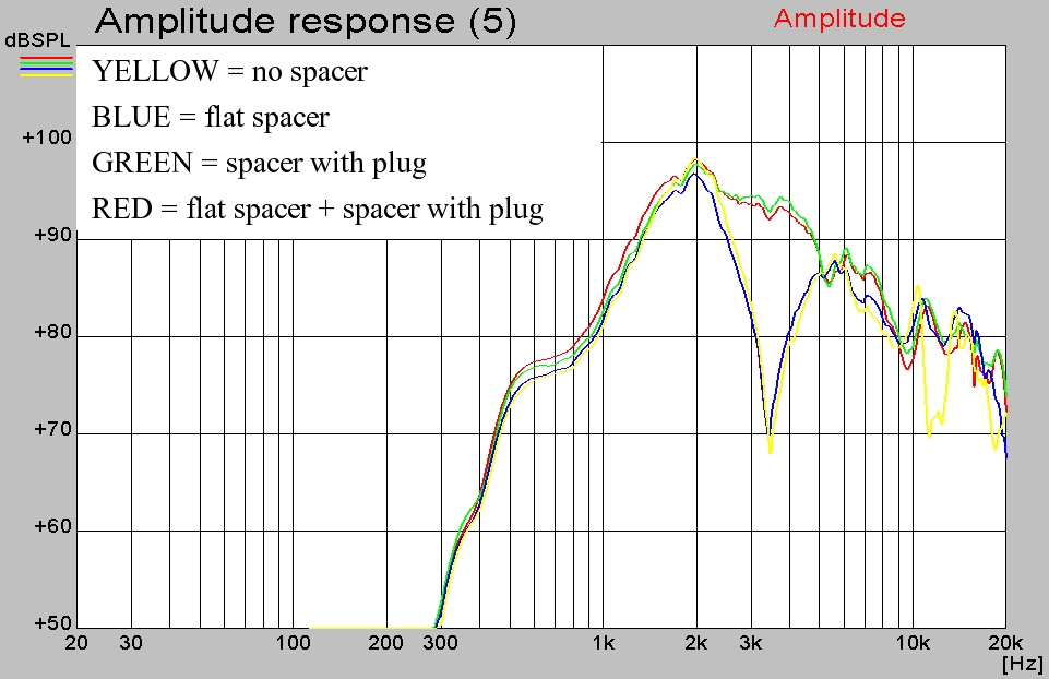

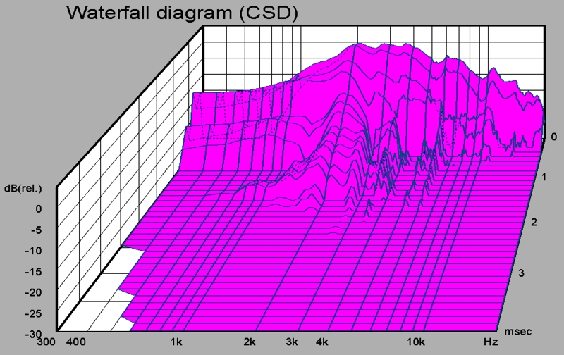

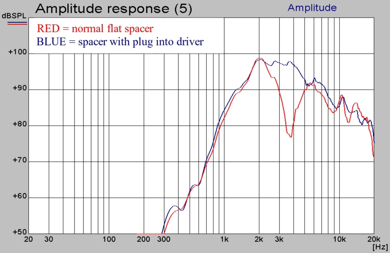

Hi again.
Now I´ve made two different spacers and measured both.
As you can see the spacer with the plug into the driver make a huge difference.
The mic was placed 30cm from the horn mouth and the signal was gated, no smoothing was used.
That little driver actually measures pretty good on a waveguide.

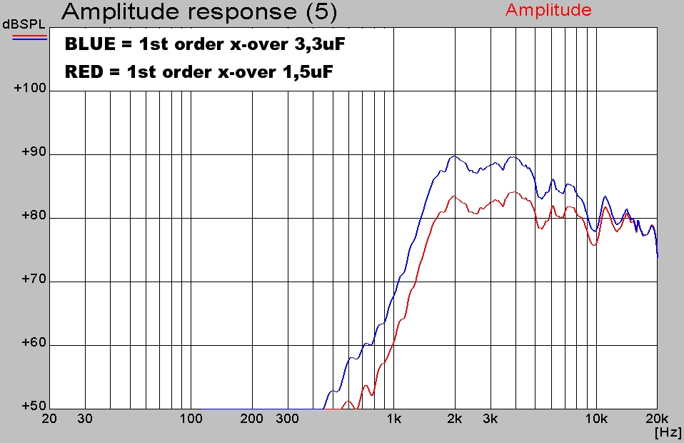

I´ve also tried several horns and also turned two similar sized woodhorns, one with a tractrix contour and one with an OS WG 40° contour.
The OS WG sound so much better, it is more open and much less colored, but it´s also harder to make a crossover for it, as the tractrix loads the driver better.

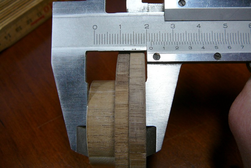

Hi again.

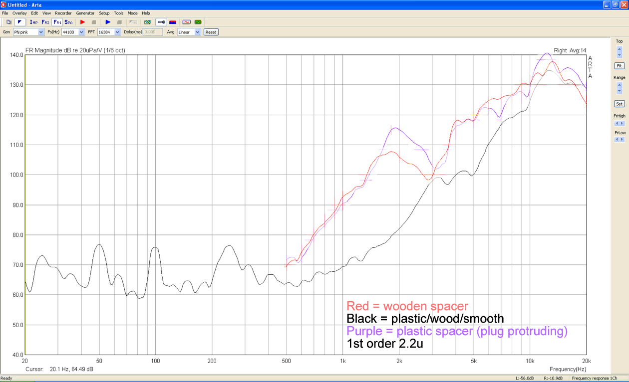

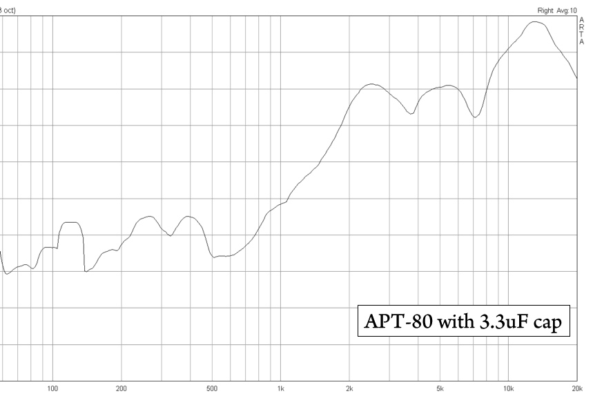

Here's one of my tweeters measured as-is, using the ~10mm wooden spacer with its probable issues. There's a fair old peak at 1.8Khz and a following null at 2.85Khz. Perhaps this is related to my dodgy throat.
Also attached, for comparison, is the APT-50 (not 80 as it says) in the waveguide before the spacer was introduced.
More to come later.

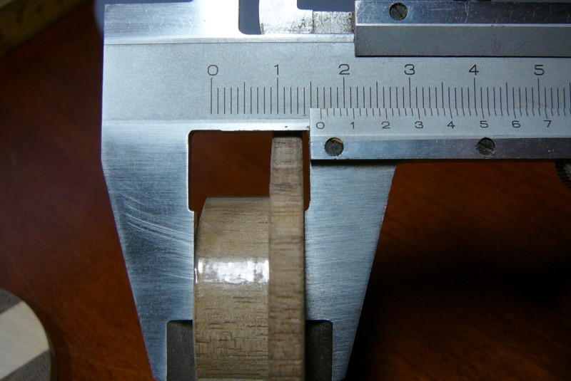

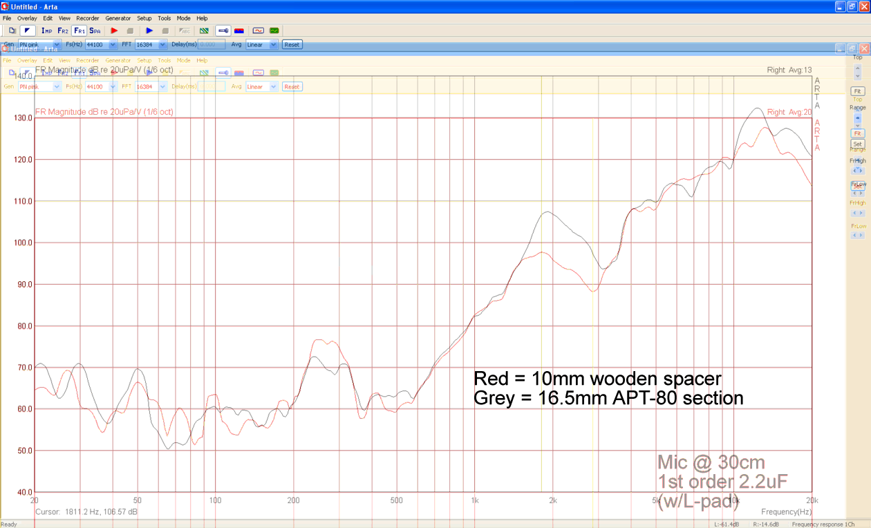

I've had a disaster 🙁
I cut and filed to a depth of 16.5mm +-0.1, totally forgetting the plastic "spacer" would begin from further back than the wooden one. The result is a phase plug that protrudes at least 5mm out of the waveguide. A complete disaster. The result is even worse than with the wooden spacer.

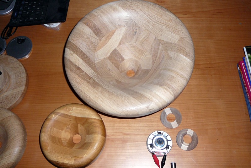

😱 I´m sorry you dropped one of the drivers.
Something must not be right with your measurements, look at these I just made.
This time using the biggest WG I have to see if that makes a difference.
And as you can see my spacer with plug is also exaxtly 16,5mm, and the graph actually gets worse by adding the flat spacer.
Are you sure you had the gating set correct ?
Did you listen to it with the new adapter ?
I can hear a huge difference in the test noise between the flat spacer and the spacer with a plug. The one with the plug sounds more like white noise where the flat one sounds nasal.

Your big waveguide looks like a salad bowl with a dressing drain hole... but it's amazing, like a work of art.
I think perhaps the hole on my spacer is smaller than on yours. It was basically 25mm on mine, perhaps a little less, say 24mm. I expect my measurements can be improved upon a lot but they're still relevant to one another as they're all done in a similar manner.

I've finished repairing, filling and sanding things on my waveguide so I'll solder and fix it back in place and measure it now. I'll take a picture too. After MUCH messing around I've got a good transition from waveguide to "tube" section, I think.
ok, you use 60 degree angle for a total of 120 degree angle.
Why are you using 10 degrees for the throat angle ?
If I remember correctly the B&C driver you wanted to upgrade to is 6,5 degrees at the throat exit.
And the APT is at 0 degrees, but it might not matter when you have filed it smooth with the adpater you made.
BTW, how wide are your WG´s ?
I'd say my throat angle is actually close to 0 degrees. I've taken a measurement of the new adapter set-up and it's looking rather different.
I'm sorry about the level mismatch between measurements and sub-optimally high xo point.
In spite of the issues raised I think I've at least managed to get a better curve, though it's still clearly a roller-coaster.
