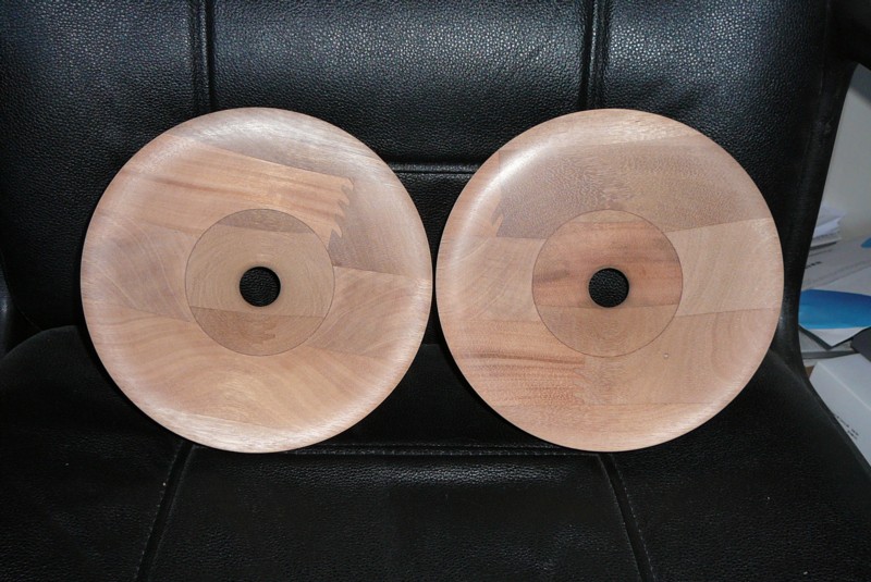

My WGs are 8" in diameter. The test noise I hear now is slightly better to my ears, less resonant and nasal

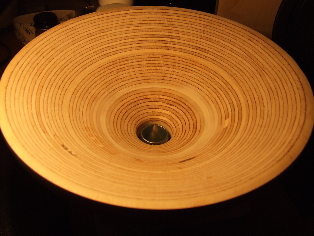

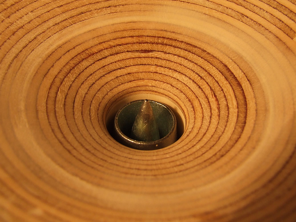

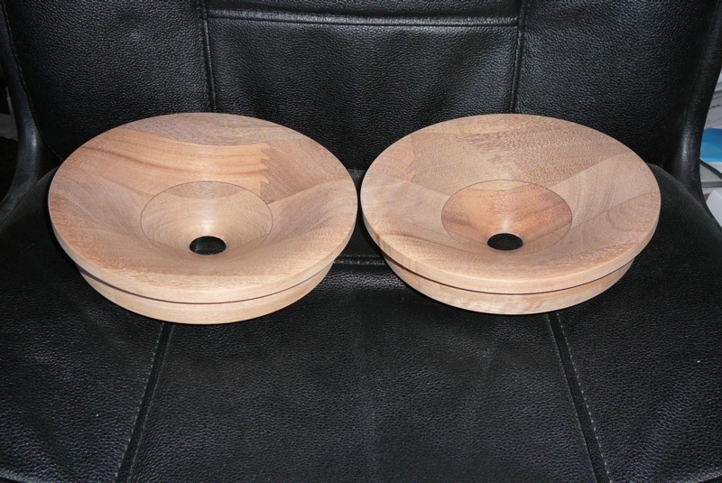

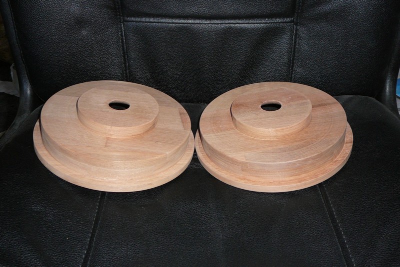

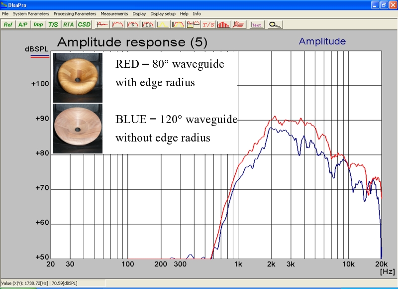

I made a couple of 120° waveguide´s yesterday, 2" deep and 8" wide, so they should be pretty much the same as yours.
Now I have made a measurement compared with my small 80° waveguide.
This was a bit surprising, as I would have expected the lower freq to have less energy, but it is overall less effecient.
The more ripple in the graph is probably because of the missing edge radius, as this is designed to be mounted flat in a baffle.
I really think you should investigate your measurement setup, as it does not make sense your measurement show a rising response, when the driver has a falling response.

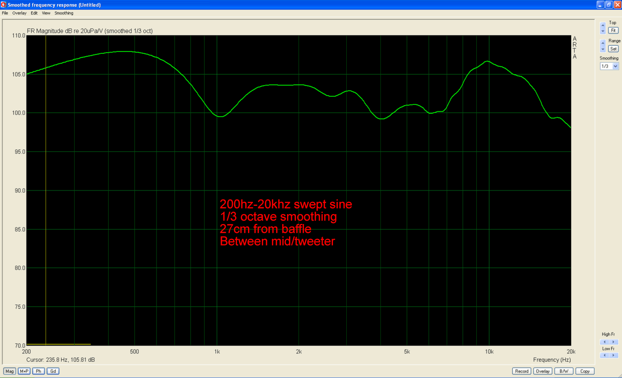

Wow, you're quite the expert turner, those look beautiful. Any idea why I get a rising response and you get a falling response? Do you think the drivers are different or is my measurement technique so bad it makes it completely wrong? I'd like to know what's going on here.
I see you posted whilst I was typing there. I agree something is not right, I'll try to look into taking more accurate measurements as I really don't trust them now... even though they're been "sufficient" to allow me to design the speakers.

Thx for the kind words about the new wg, it is a nice way to recycle an old kithen countertop.
I have some old drivers (Altec, Coral, JBL) I would like to use as they sound great, but I think their Qts is to low to use without massive amounts of eq. Maybe a H baffle could work.
Can you try to make a measurement of the Beta8 30cm from the baffle without the crosover in place, then I can do the same and compare the graphs.
Have you tried measuring a factory made loudspeaker, to see if that also shows the rising response.
I can readily post a curve of the Beta 8 from a fairly close distance as I have some to hand. I've not tried measuring any other speakers - that is a good idea. The only suitable ones around really would be my Tangent Monitor 6, which are my rear speakers.

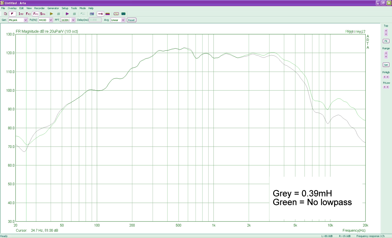

The attached is the Beta 8 in isolation from about 20cm I think. The crossover was something like 250uF in series, and 0.4mH or no coil. There's also a booster circuit of about 12R in parallel with 8mH.
I've been measuring at different distances, and using a sine sweep or noise in the impulse response section of ARTA, as well as the steady (room-influenced?) pink noise measurements (labelled FR1 section). Whatever I do I get that rising tweeter response and, on the CSD, there is lots of resonance at about 15khz.

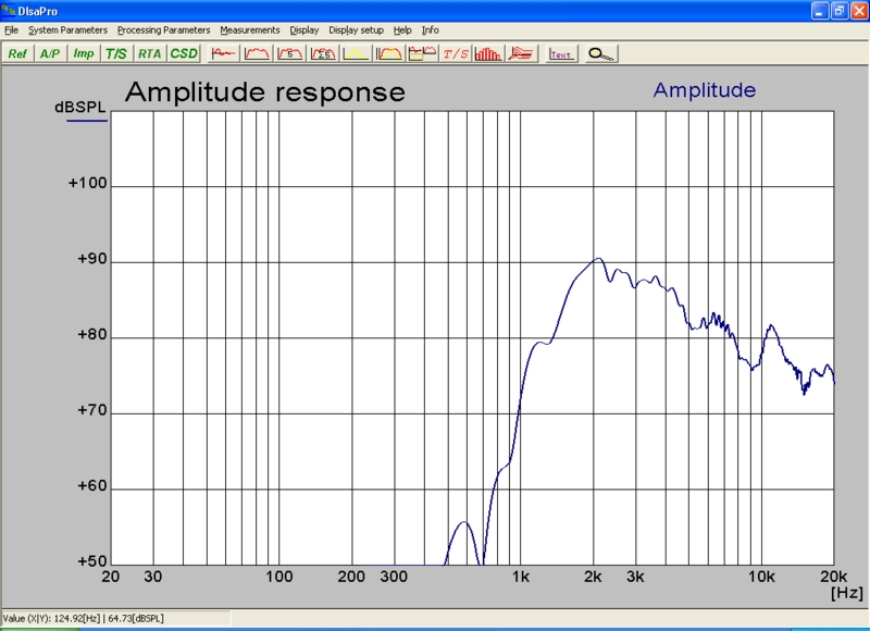

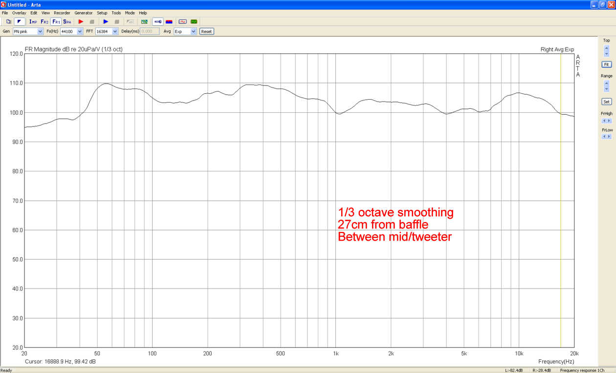

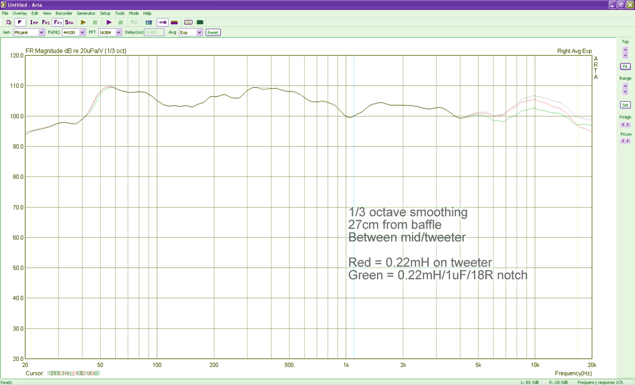

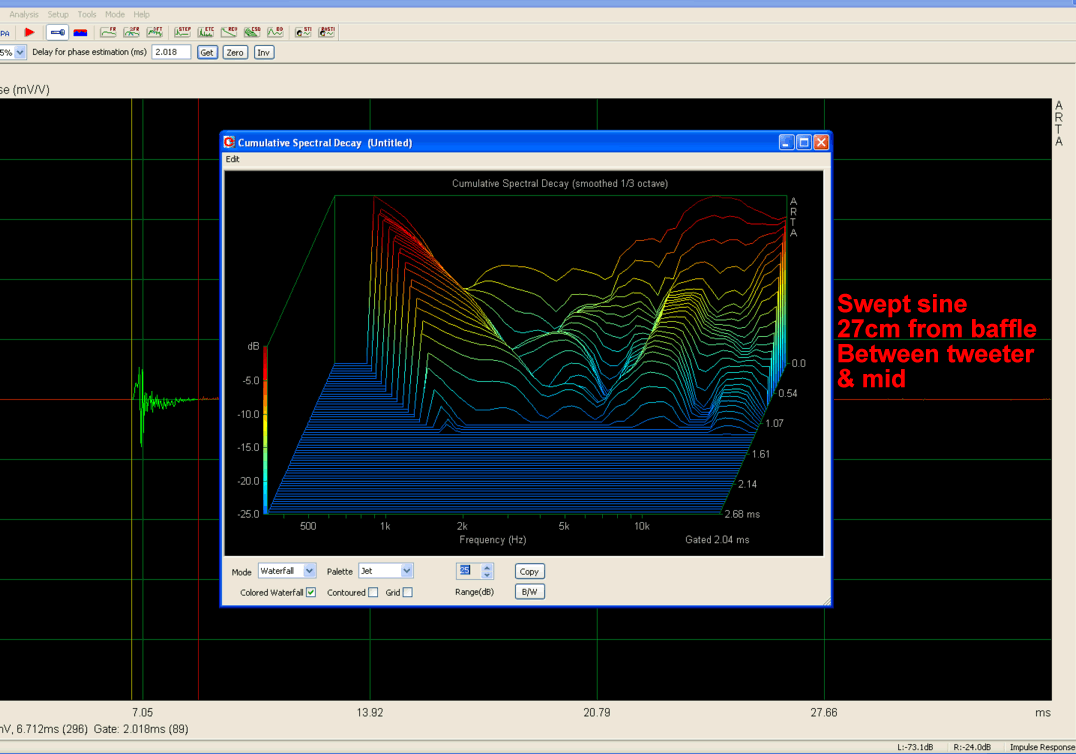

Ok, I thought it's about time I posted some more graphs lol.
Here's the current state of play as shown a short distance form the baffle of my right speaker, height more or less between the tweeter and midrange driver. I used a swept sinewave this time. I think it's too "quick" to allow time for low frequencies so it's cut off from the upper bass down.
As mentalistic as it probably sounds I'm going to insert a 0.22mH coil in series with my tweeter to do away with the tizzy higher frequencies. It will be interesting if not a good solution.. and I could boost the overall level to gain more in the presence region relative to the area of harmonics that is presently too loud.
If anyone would like to suggest better methods for measuring, I'm all ears

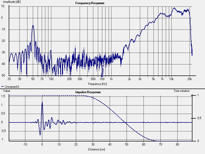

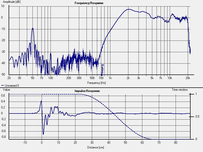

Simon, I have played around a bit with the Holm Impulse software, and you should try it out. It´s pretty easy to use, and I get the same results as with my DLSA measuring setup.
I have also tried a homebuilt mic to compare with the DLSA one, and they are identical in response, only the DLSA one being about 5db lower in output.
I tried to use my laptops first, but their soundcard would only go up to about 7khz, so I had to use the stationary one, which measured fine when doing the loopback test.
Try the Holm software with a loopback test, to see if you get the same rising response, or if your soundcard is flat.
I have added the graphs from the measurements, no smoothing only gating on the graphs.
This is of the driver/wg with and without crossover.
