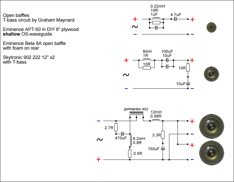

This amp is about to be relegated to bass-duties and my old dual mono LM3886 chip amp will drive the mids/tweeters. At first it will be using the passive crossover with the midrange resistors removed. The level will just be matched with pots/line-level attenuation. I'll give this a listen for a while and then get working on an active crossover. In the meantime I will get my other tweeter the same as the more tweaked one and try to decide if I can keep them or not. As they stand I'd rather be listening to basic silk dome tweeters for their smoothness...

The Carlsbro has been upgraded with CMC binding posts, Wima decoupling caps on the output transistors, DIY stepped attenuators with Allen Bradley resistors and Elna Silmics on the main board. It sounds quite good now.
I've removed all padding resistors from the midrange and tweeter. Overall attenuation is done at line-level and by fluke the levels of mid and tweeter are great with no plain resistors. They're both dropped a bit by their own "shaping" filters - notch on tweeter and bass-boost on mid. These filters use good resistors (Kiwame on treble, Audio Note on mid) so they're hopefully not causing trouble.

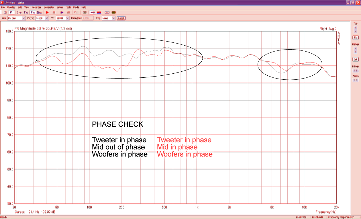

I also took more measurements and messed with some parts again. I remembered how I changed the polarity of my mid driver to address a dip where it met the woofers. I put the polarity to standard to double-check this and again saw a big suck-out. I also noticed this reduced a suck-out I was getting at the top end where the mid meets tweeter. The solution was to change the polarity of the woofers (swap the speaker cables - easy!) and to leave the mids and tweets connected with normal polarity.

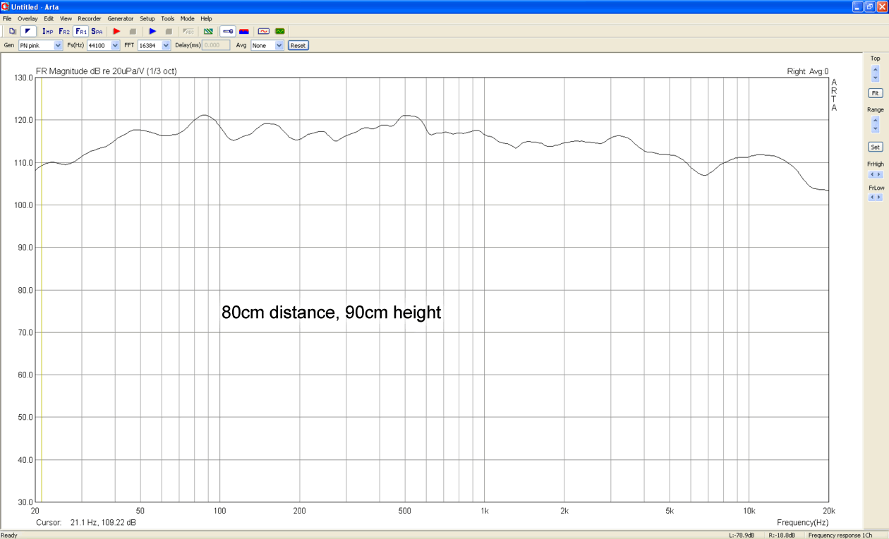

Here's the response with some tweeter filtering options. I'm listening to music with the notch filter at the moment and I think it's an improvement over leaving it alone.
Hi Simothy,
Why is there a +10dB bump at 500hz. baffle step?
If you post your filter Maybe I have some suggestions to improve it.

I don't really agree there's a 10dB bump at 500hz (I suppose if you're comparing to 1khz we could say 5dB) but the area is certainly raised somewhat and it is due to the baffle width I believe. I expected issues when simulating in Edge. I have considered a notch filter but am yet to try this.
Attached is the graph I forgot to include earlier showing the cancellations I referred to. Now the graph is like a mix of both lines (the better parts).

Ok that looks very good for a passive open baffle I think.
To control the rise at 500Hz would advise a L-C-R parallel to the mid driver.
2.2mH-30uF-and a R =0-8 Ohm you have to test what resistor will be the best value.
The rise can also be caused by the woofers then you need to parallel it to the woofers

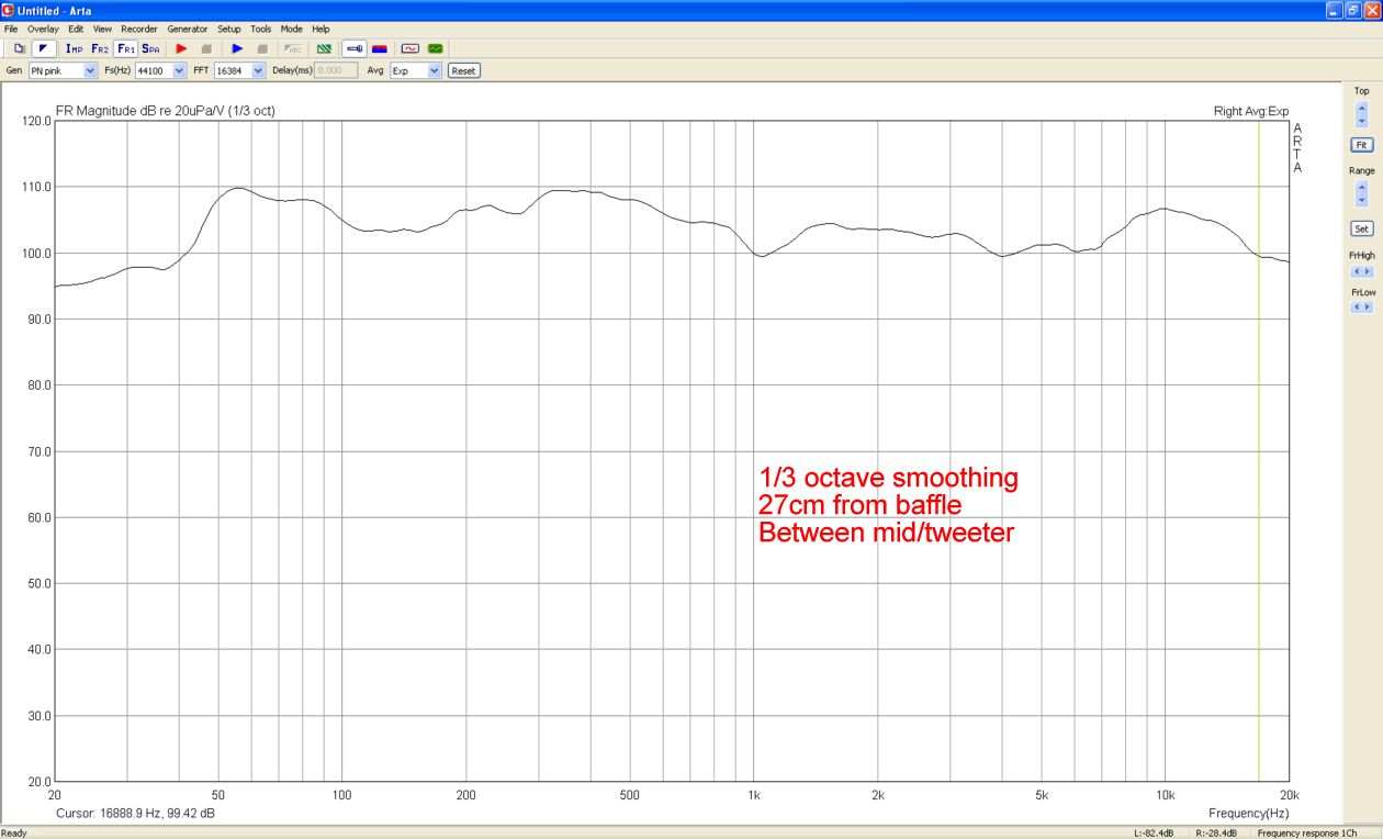

It's funny because when I measured closer in this peak wasn't there. I suppose that almost confirms that it is due to the baffle shape - as close-up the shape will be seen much less in a FR measurements, I think.
Thanks for the filter suggestion. I was actually just working on something like that, using this calculator: 500 Internal Server Error (Amplitude Parallel Notch Circuit)
The problem I'm having is that to deal only with the peak and nothing else I need a 300uF cap. The 0.33mH coil and 4.7R resistor pose no problem as I have those.
Your parallel circuit uses more normal parts but I don't currently possess a 2.2mH coil
Would you say parallel has any better qualities other than component availability?

WRT to this peak centred at ~520hz, the woofers do seem to be contributing to this, as can be seen on a recent graph showing two connection options (polarity of drivers). The peak is about 2dB lower when the woofers are out of phase with the mids, therefore cancelling some output in the area. A third pole of roll-off on the woofers would probably help and I think they're still contributing too much anyway... I am a bit hesitant to do this, though as I feel I'd be opening a new can of worms and with the prospect of going active on the low-mid x-o right on the horizon it seems like not the best time to further tweak this part of the crossover too heavily (at least not the slopes).
