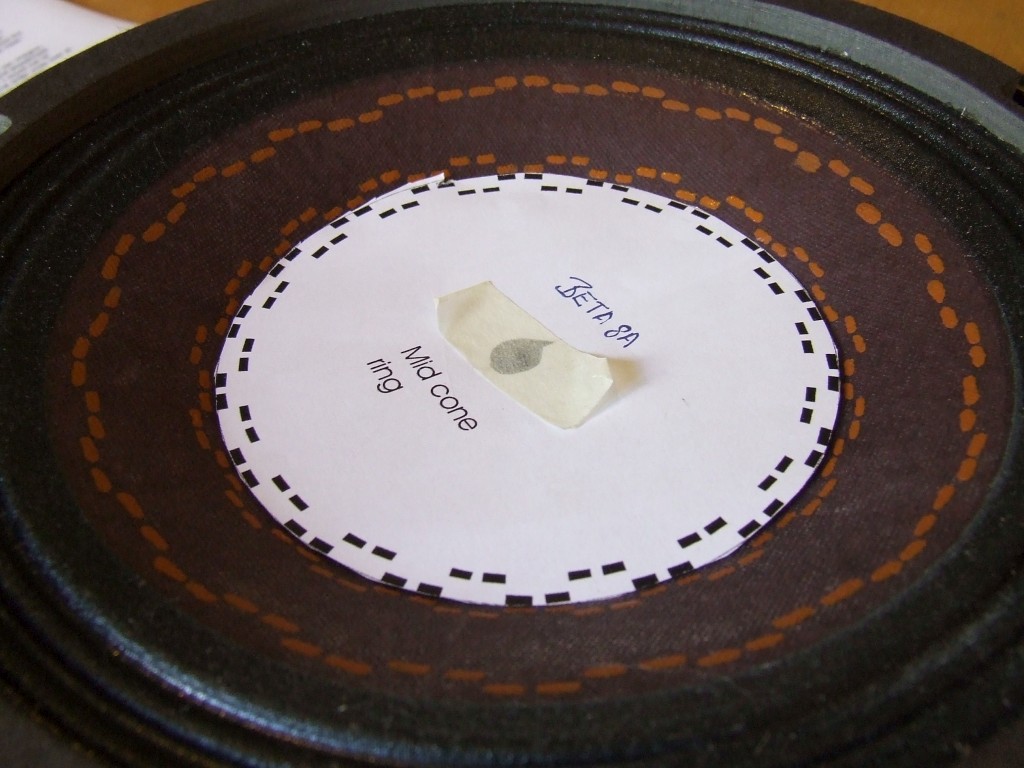

I can't wait to try BudP's EnABL and other tweaks, I just need to find the always-tacky glue he uses to quell a resonance the Beta 8a has. I can do the pattern rings for now though.

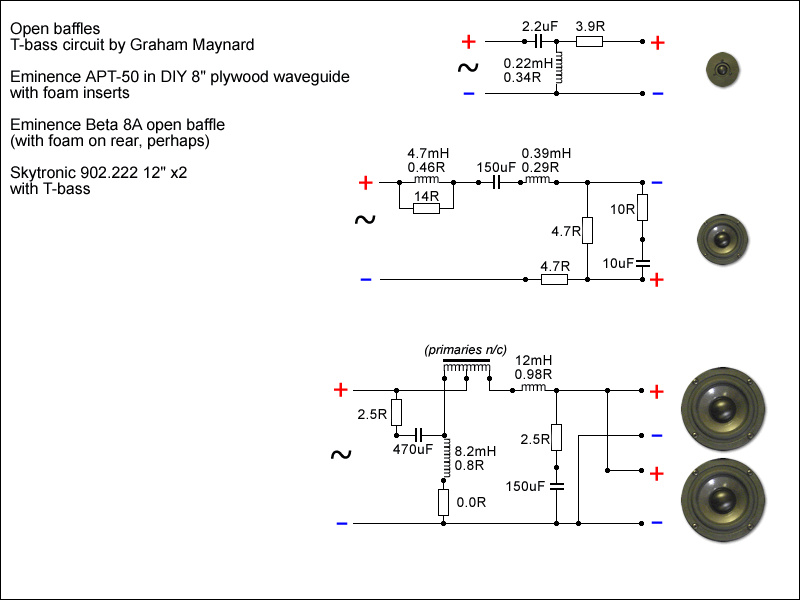

Here's an up-to-date schematic of what I'm listening to. I think it's accurate but might have mistakes as I copied and pasted from a different speaker and made changes from there.

Thank you for the XO Simon.
It is interesting that I used almost the same values for the Supravox 215 RTF 64 in a OB design.
contour filter (4.7mH // 14r)
0.39mH series coil
aprox 5r lpad
I did not use the series cap and the zobel.

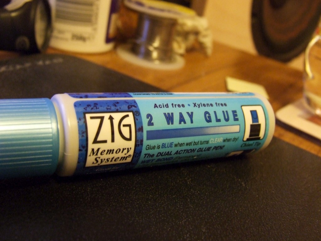

Please let us know about the special glue.... I guess I could use some to restore my old peerless mids 🙂

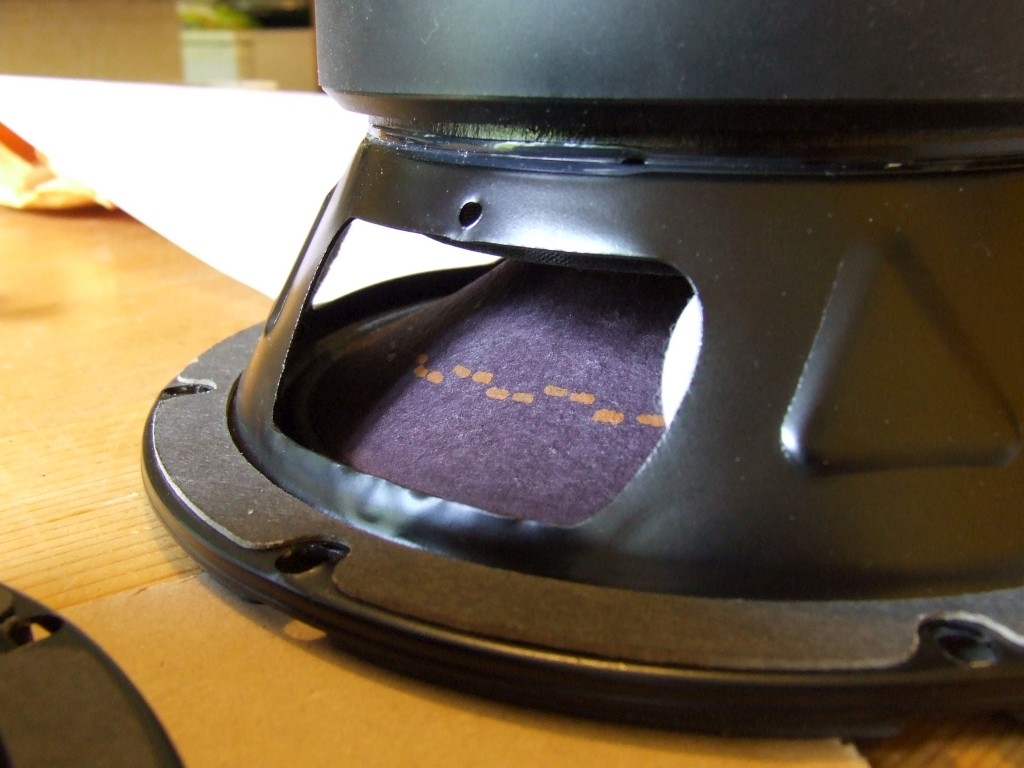

I painted some EnABL pattern rings onto my Beta 8s yesterday. I've listened and found the sound more open and detailed and more dynamic, but with more emphasis on the resonant top end the Beta 8s have. Today I procured the "2 way glue" needed to treat the back of the cone to remove the emphasis these drivers have.

The paint is Testors Polly Scale Model & Hobby Paint. I chose Rust colour. EdLafontaine of this forum sells EnABL kits which include a pot of paint, the Microgloss (often used with EnABL patterns), a pen handle and nibs/tips to go with it. It's like a fountain pen for paint. He ships worldwide.

You may want to coat the dome on the Beta 8 with 2way, after you coat the backside, from pattern to basket. You may even end up with a single coat over the whole cone backside with a second layer, or even three, between the pattern and surround.
This is a very lively speaker!!!!! Just damp out the Raleigh wave resonance until it is gone, you won't loose a noticeable amount of power and the mids will become astonishing.
Those mids are already starting to come away from the speakers quite nicely. I'm excited about how it could sound with further work. I should get painting that funny glue on tomorrow. I will start with the rear as prescribed, listen and then consider coating the done. I appreciate the advice given here.

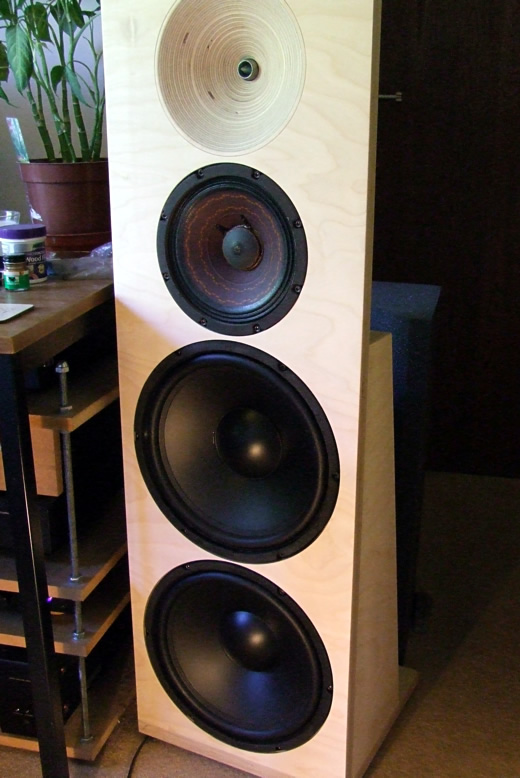

Well one more...are there pics of the completed speaker somewhere in amongst this lot ?
Got your mail thanks - replied with pics
Cheers
Sorry I've been slow to update, I've been away. I'll try to get a decent up-to-date picture the speakers tomorrow.

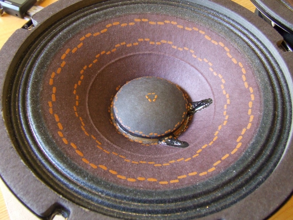

I've posted my impressions of the mid driver treatments as a whole (all done now - PVA dots, Microgloss, EnABL, 2-way glue, pads on spokes, Electron Pools & basket grounding) in the EnABL thread: http://www.diyaudio.com/forums/mult...ng-impressions-techniques-54.html#post2321655
In truth it's really mostly the gloss and 2-way glue, and less so the Enable (and much less so the other things) that have transformed the Beta 8As.
Since I posted the comments in the other thread I've brightened the top end by reducing the parallel resistor in the L-pad circuit by about 0.4R (should give 1dB or so extra top end). The sound on the CDs I've tried so far is very pleasing!!
