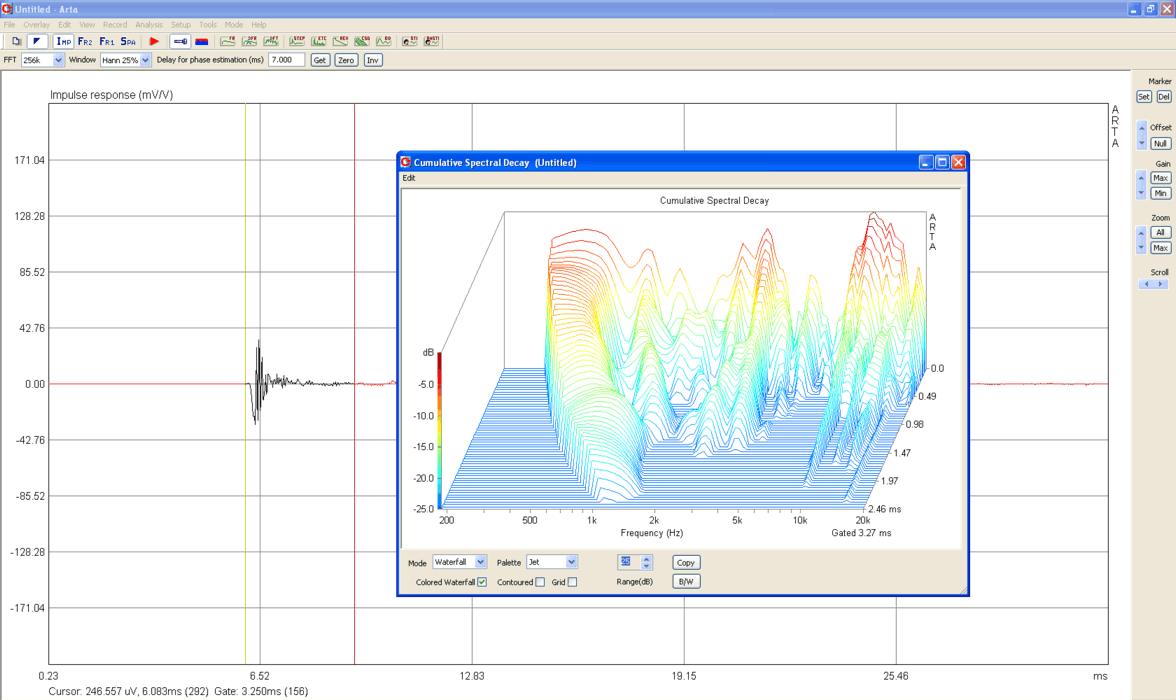

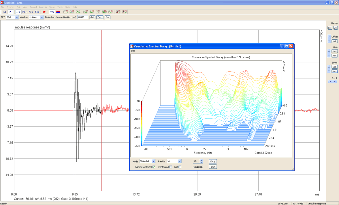

I'm not sure how I change the gating as I don't see that terminology used in the options so far.
Gating is possible in the Impulse and Step Response windows. If you move the cursor over the response window and push the left button, you get a yellow vertical line under the cursor, which can be moved horizontally while the button is kept down. Move the yellow line to the start of the gate.
Same for the right mouse button, which produces a red line. Move that line to the end of the gate.
Usually you want the yellow line just left from the onset of the impulse and the red line just left from the first reflection.
Rudolf, your knowledge is much appreciated!
See attached a more meaningful plot:

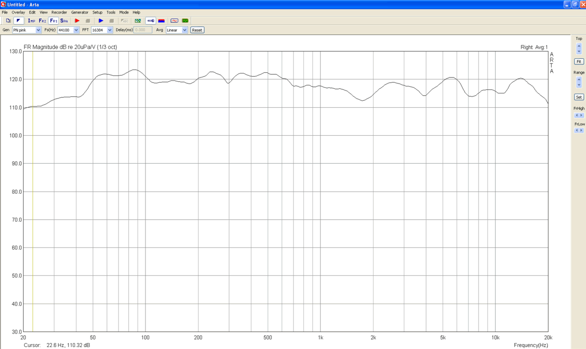

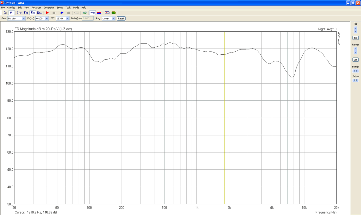

Here's the on-axis response with the new crossover. It's quite a bit smoother than the one I managed by ear but probably still needs a lot of work.
In truth I think it looks better than it really is because of the massive scale. I'll keep using this scale for the sake of familiarity and before/after comparisons though.
You need to gate the response to remove effect of room reflections, etc. Its basically choosing a window of time to measure the response.
Go to nutshellhifi and check out the mlssa gallery. Lynn Olson does an excellent job of explaining how to gate the impulse response. In your graph, I can see the gate starting just after the impulse peak (in the CSD graph). I cannot see where it ends.
Download Holmimpulse, it has a great impulse response gating feature. Very handy and very easy to use. Also, there is an application note on ARTA's website which explains how to combine nearfield and farfield responses.
I wish there was an easier way to learn this, but these some of the references I read while learning to make measurements 🙂

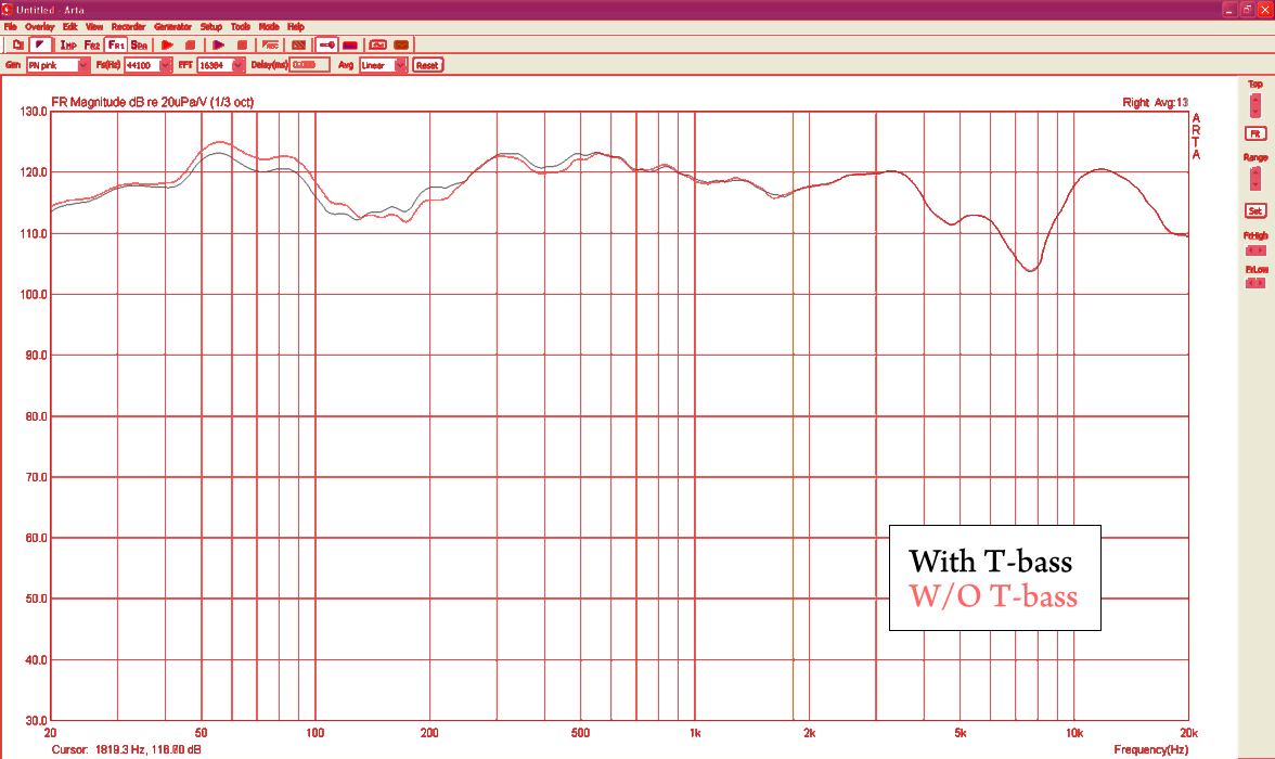

I did some tests with and without T-bass. It clearly wasn't doing what I thought it was, but it is improving the response a little. I think it needs tweaking.
Yup, the result is similar to what I've experienced with regard to wiring the mid and woofer out of phase. That is a spectacular response you are 'starting' with. Can only get better from here.

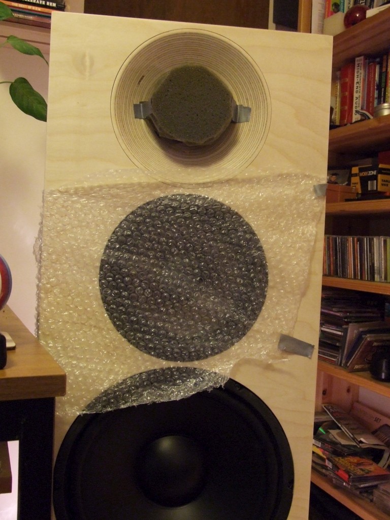

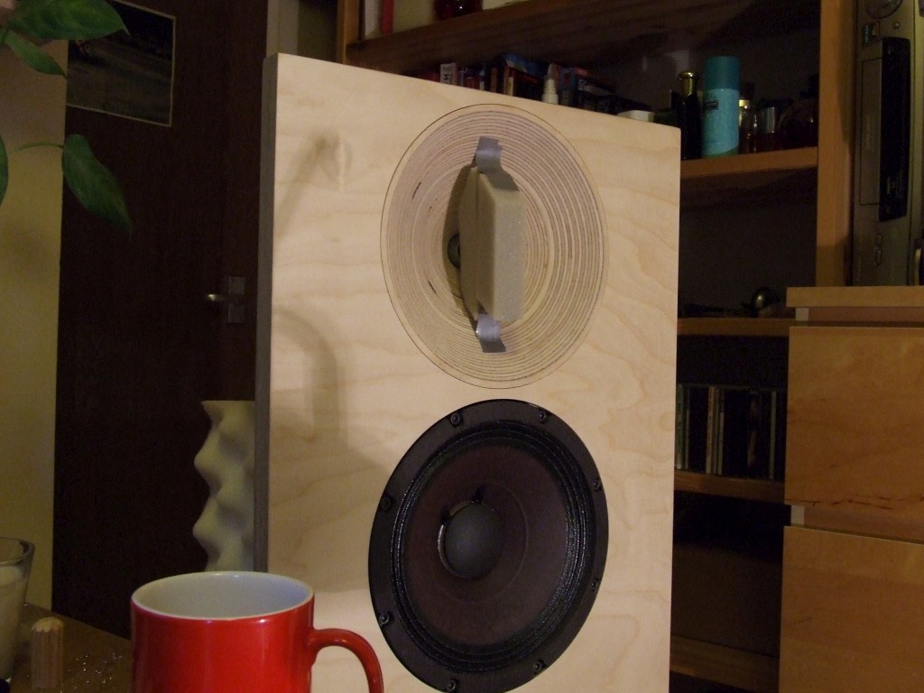

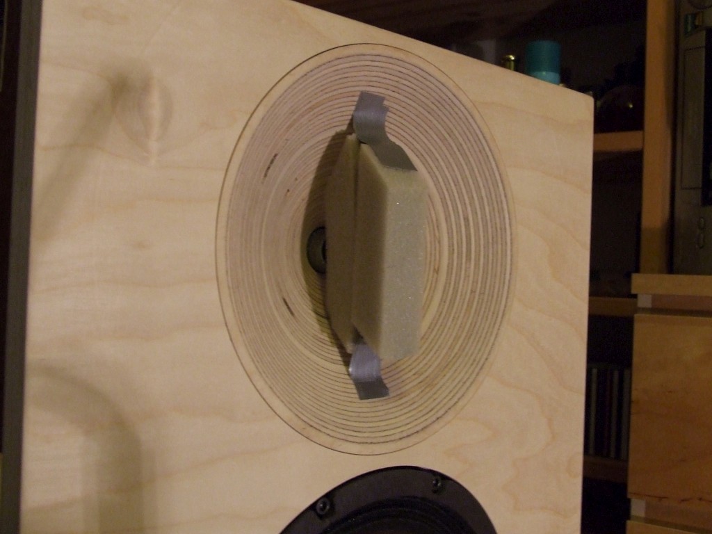

Can you post pics of the foam thingy you are doing?
It looks better than it is because of the 100dB range/scale I think, but it's really great to be moving forwards so much in one (very busy) day.
The foam is a false victory because it's only good on-axis, but off-axis it's a bit top heavy. I need to find some more suitable foam!!

I've been in the attic and found a bigger piece of foam, quite thick and large enough a sheet to be useful. With two discs in front of the tweeter the graph gets quite smooth and flat and the sound becomes superb! This is a world apart from the sound I had this morning. Everything is so relaxed and open and clear! Fleetwood Mac sounds amazing on just the one speaker 😀

Here's the pic I tried to attach earlier, and an up-to-date CSD plot. I don't know if I've gated it right etc. but it's still quite interesting I think.
Since you have the driver, and the setup, can you do a CSD of the Beta 8A alone? From the spec sheet, it gets a little peaky beyond 1k. It looks like a very promising driver for the midrange.

ra7 - I will surely do the CSD you ask for, just don't read too much into it because I'm measuring in a tiny room (my bedroom) and probably haven't optimised the settings either. That said, the mic capsule and pre-amp are definitely decent and I've got the capsule almost hanging in the air so it's probably not too bad with reflections.
