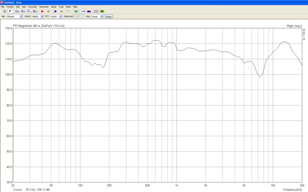

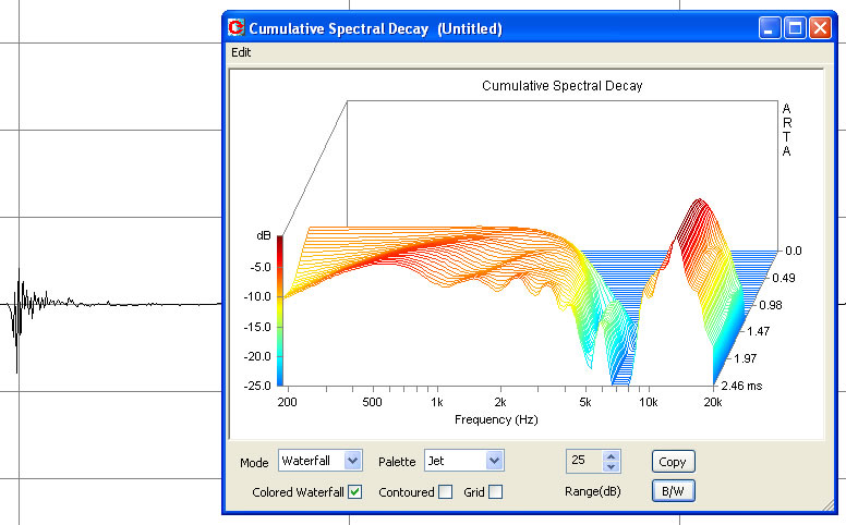

I'm using the pink noise type test on ARTA to get some kind of a response curve about 80cm away from the right speaker, with the other speaker not playing. The method is probably all wrong but already I see a big dip at 7.5khz and a big peak at 13khz. Between 100-250hz I have a dip of about 5-6dB. I think there's my missing midrange warmth, and the healthy response below there goes along with the funky big bass I hear.
If anyone knows of a concise thread or webpage detailing how to get the most from ARTA measuring a speaker I'd love to see it. I feel I could be getting more accurate results if I wasn't just "messing around".

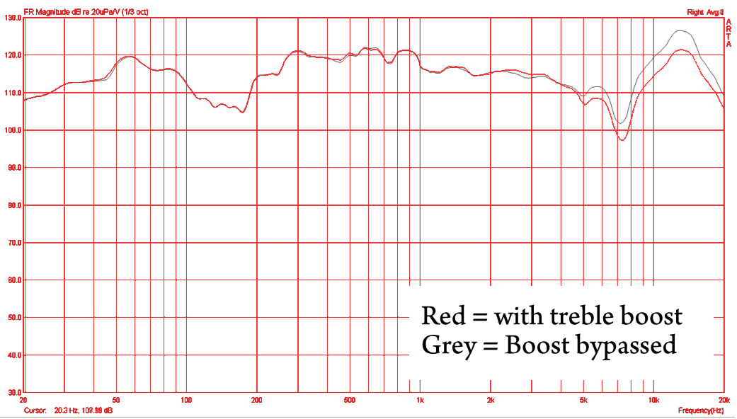

Quick question if anyone will bite - what would a treble boost filter do to the phase of a tweeter? I ask because my top end dip looks like it might be related to an out of phase thing happening with the Beta 8a. Perhaps I should get rid of that bit and see what I can do at getting the axial response smooth at the crossover region instead.

Here's what I'm seeing. I tried at different distances and the top of the graph is always about the same so I'm going to put some faith in it and say it's not completely random noise 🙂

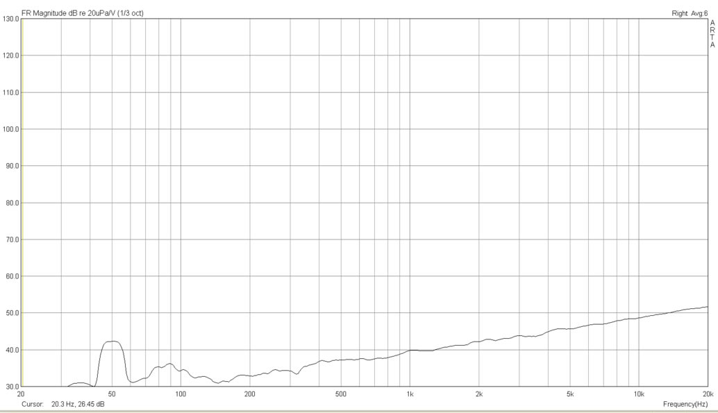

*I've added a graph of the noise ARTA sees with the mic pre-amp switched off for reference.

Here's an overlay showing the "treble boost" filter on or shorted out. Clearly it wasn't doing anything useful: it just looks to be cutting everything equally. I'll pad the tweeter down some more and adjust its x-o point and see what happens.

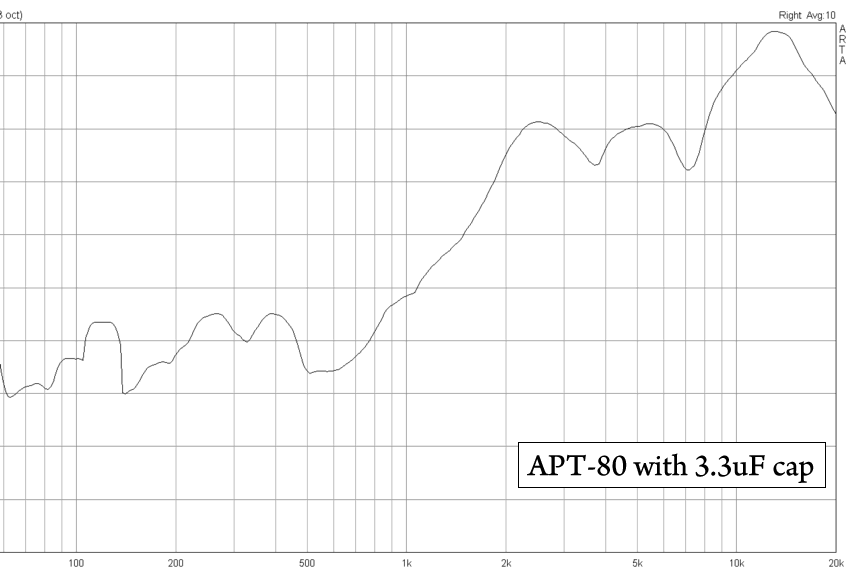

Tweeter with just a 3.3uF cap and L-pad.
So you have a similar problem... the tweeter is too loud.
Would you post a graph without the tweeter connected ?
IMO, the midrange is the most important driver so you could try leveling it with the woofers in the first place.... than you can connect the tweeter and smooth things out.
Also I agree that the tweeter moth is protruding from the horn.... maybe it should be flushed in.

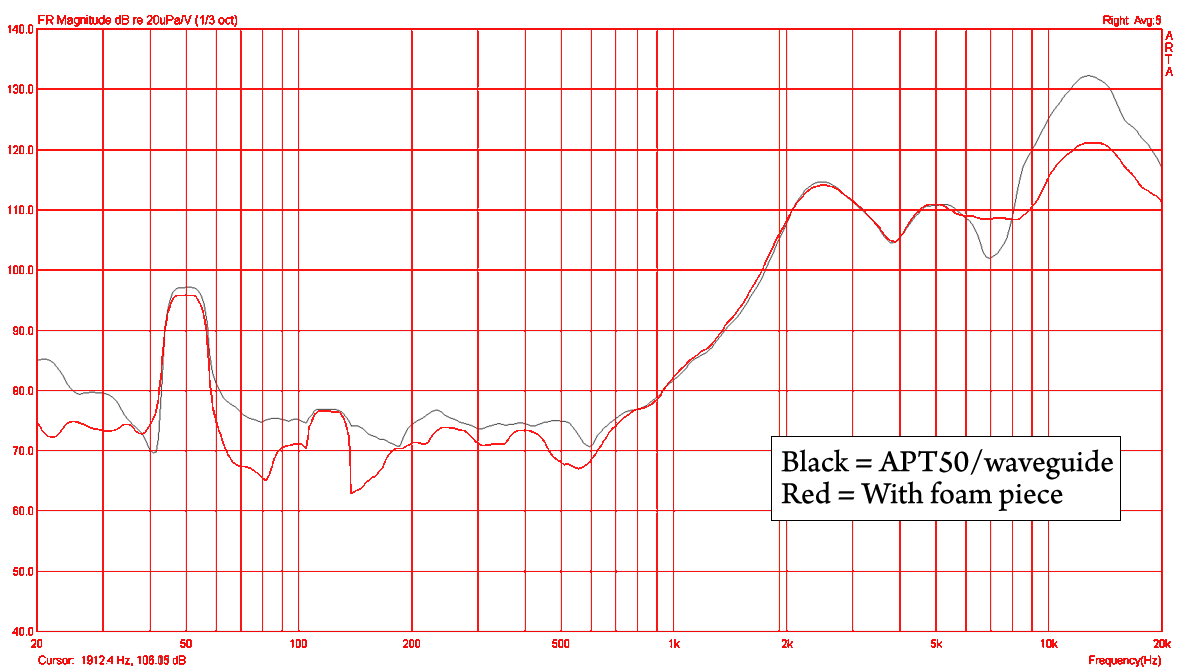

More graphs will follow today. I'm just attaching some foam to act as a low-pass filter on the tweeter to soak up that resonant peak at 14khz.
edit: here's the before and after from adding a strip of foam across the tweeter. 10dB of reduction where it's needed and as a bonus it seems to have filled in the preceding dip!

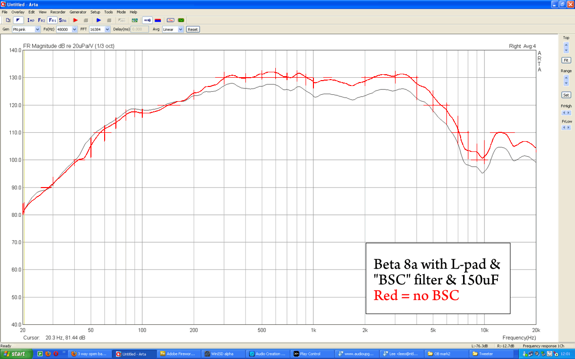

Here's the mid driver in isolation with and without the baffle step correction filter. The driver also has an L-pad for attenuation and a 150uF cap for high-pass filtering. There's no low-pass filter as such here (other than a zobel network of 10uF/10R)

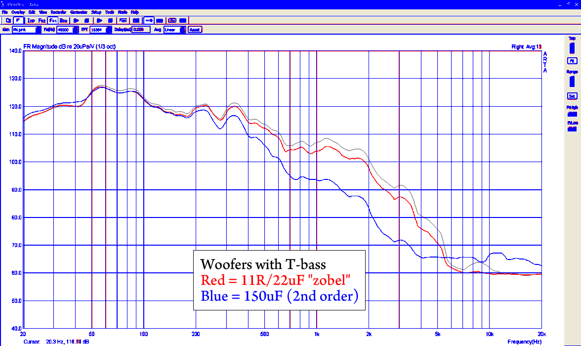

Here's the woofer with T-bass and a 12mH ferrite coil in series. Also showing with a zobel network and with a 150uF cap as a 2nd pole (no zobel). I tried with zobel and 2nd order together but it made the picture messy: essentially it looked as with 150uF (2nd order) but with a bit less output after about 2khz.
The CSD you posted on the last page is a little weird. At 0 ms, the response should look approximately like the FR graph. And then the stored energy appears as a waterfall. Check the impulse gating. I think the gate must start before the begining of the impulse response.
The woofer and mid looks nice. If you don't have any nasty resonances in the 2k-5k region from the mid then that's great. I am also interested in how you tackle that 14khz hump in the tweeter response.

ra7, thanks for pointing that out, I am still puzzled by the CSD plot though. I'm not sure how I change the gating as I don't see that terminology used in the options so far. I'm playing around with the setup now trying different things but I'm shooting in the dark a little bit.
Ricardo, the XO on the tweeter is currently 2.5R/3.9R (parallel/series) L-pad at the terminals, preceded by 2.2uF in series and 0.22mH in parallel. There is an inch or so of foam in front of the tweeter at the centre of the waveguide.
I have opted to keep 2nd order on the bass for now but I find it makes the bass less integrated and it stands out on some notes. To help I've added a 2.7R resistor in series with the cap to calm its effects down a bit.
I've recorded smoother overall plots than I showed at the start of the day but I still have a bit of a dip 100-200hz and funny things happening at the top end!
