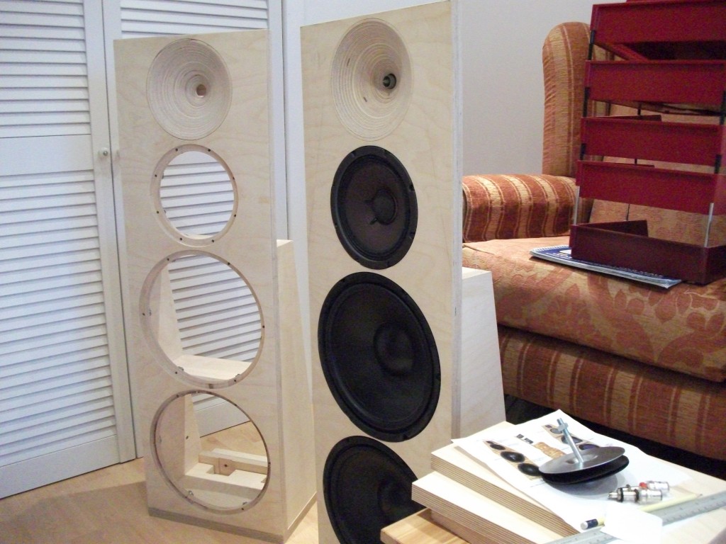

I suppose it's high time I posted an update! With the weather here in the UK finally reaching acceptable levels and my car working quite nicely again I got back to the speaker project. The other day I did the final cuts on my pieces of wood and glued the baffles up. The 2nd waveguide took some sanding to make it fit centrally but it was worth the effort (in terms of looks).
I'm very pleased with how they look so far. I'm going away for a week but soon I'll get them closer to completion and finally listened to.
Excuse the low image quality, these were taken with a £50 digicam.

Well-proportioned baffles. Looking really nice.
However the WG seemed a little bit odd at the throat. The driver looks like APT. If so, that's a 2-slit phase plug which protrudes out of the throat of your WG. And then the sound waves coming out of the outer slit would be splitted very hard (facing a rapid flared surface), while those of inner slit would escape straight out ahead without the 'support' of the WG (too far away from the nearby surface) -- that's what I'd imagine.
So, normally the phase plug (which used for synchronizing the wavefront) is placed slightly behind the throat, so the flat wavefront (in theory) can show up right at the throat.
Just my 2c.
Just my 2c.

CLS, thanks for your comments, I'm so glad you brought this issue up because my instincts tell me something's wrong with my waveguide-throat-driver transition.
I was hoping to upgrade to the compression drivers recommended by Dr Geddes at a later date, which I think look quite different...
What, in your considered opinion, should I do to rectify this situation? Should I build up a spacer to make the outer part of the phase plug flush with the throat of the waveguide?
Thanks,
Simon
You're welcome and yes you may try it, but unfortunately I think it's almost impossible to make it fit both your current APT and future other compression drivers🙁
It's because if a standard 1" bore is to maintained through the 'adaptor' for APT, then it'd be a straight tube. So the transition between the end of that tube to the WG will be inevitably very abrupt, which is a bad thing for sure.
If you try to make that transition smooth, then the entrance of WG will be larger than 1", it'll be a problem for your future upgrade.
To make things 'perfect', you'll need 2 different type of adaptors - one for APT, the other for standard 1" CD. I believe they'd be in very different depths and shapes. Is that effort worth it? It's up to you.
Good luck and tell us your progress🙂

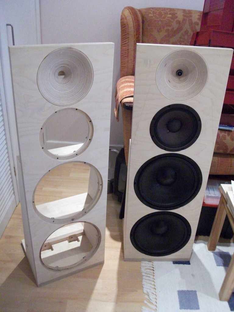

Well I've finally sanded my baffles a bit and put all the drivers in place. I've bolted everything in and wired up a basic crossover just to make some sound.
Instantly there appeared to be some promise of a very clean sound but as we should all realise a skewed frequency response can give a very wrong impression of a speaker's true character.
I've spent the last days fettling like mad, exclusively by ear for now.
Today I've kept one speaker the same (tolerable sound) and purely worked on the other. I used a switch to test different coils on the woofers more directly, I've messed with roll-off slopes on the treble and mids, I've played with attenuation of mid and treble a lot and I've altered x-o points between all drivers and I've done one or two other things too. I've recently had some large breakthroughs in progress.
First thing of interest is, as expected, the tweeter and midrange (Beta 8a) needed huge amounts of padding to meet the mid-bass efficiency of the woofers (Skytronics in parallel on a 12mH coil). When this was set more or less correctly (something like 12dB worth of L-pad on each - done purely by ear for now) the sound became tolerable and some bass came out of hiding.
The next thing of interest was the disturbing nasal quality I was getting from the Beta 8a / APT-80 tweeter combo. Vocals and piano were not close to good enough tonally!

I tried switching the woofers to a 4.7mH coil to fill the gap up to the midrange but the sound was bloated and lacking in deep bass. This was exactly a trade-off I had issues with in my "practice" speakers. Some switching between coils revealed the 4.7mH scenario wouldn't be acceptable. I decided to use Edge's suggestion for a passive "baffle step correction" filter comprising of 4.7mH in parallel with about 7R - these are placed in line with the mids. I thought this would make for a much flatter response from the mid driver and make the transition to bass much smoother.
The result was certainly good, the midrange is now much fuller and almost spot-on. I may try a two-pronged approach and also add plenty of absorbing material behind the mid driver to attenuate the rear-wave. This should also smoothen the response, reducing the open baffle losses.

Hi Simon. That soft wadding behind the midrange was what was needed to correct the in-room sound of the cheapies I made for friends yonks back. Of course I just used what I had available but as an old sleeping bag worked for me I can suggest a starting point.
Start with about 25mm of BAF and use some cheap cotton poly blend sheeting on both sides of the BAF batting and make if a loose fit.

Another considerable gain was achieved by connecting the T-bass circuit, comprising of a 500VA toroid, 8mH coil, 500uF? capacitor and 2.5R? resistor to Graham Maynard's recipe. This goes in line with the woofers before the 12mH coil and has the effect of slightly attenuating mid/upper bass but boosting deep bass from Fs by as much as 6dB. It also seems to improve the tunefulness of bass.
The only issue I have is that with my current test amp - a rather weak and grim 50WPC Sherwood receiver - playing too loud causes the amp to switch itself off. A favourite test track - a drum kit recording - can't be played at realistic levels at all: it just switches itself off 😱
The incredibly cheap woofers will distort quite readily but I think when both speakers are playing on stronger amps in my small room I'll not have issues with maximum level. If I do, then I'll have to talk my mum into allowing me to build the attic infinite baffle subwoofer I've been pondering lately... 😉
I connected the Beta 8 chassis to negative for a little extra free tweak, but maybe it should be connected to safety earth - ?
