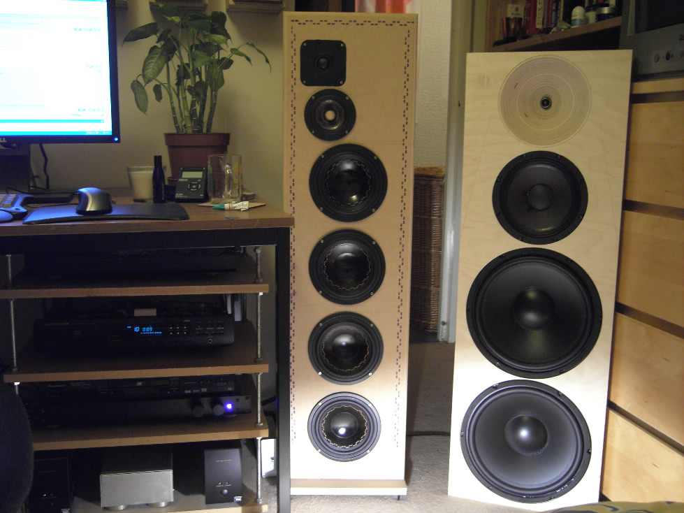

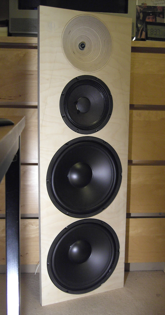

I actually have a couple of pics showing a test baffle, which I think I forgot to post. I will get those up shortly

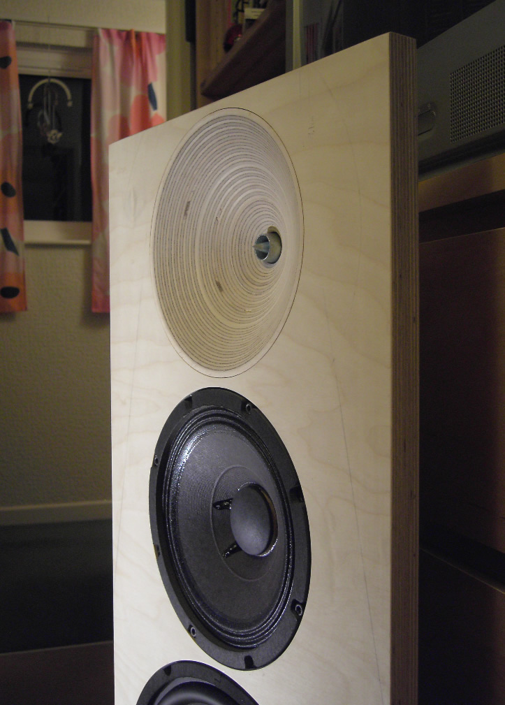

Can you mount a thin plywood cover over your tweeter mounting hole to provide a locating point for your router, for rounding the baffle off? Might be worth a try.

Thanks for the kind words. I am very unsure about crossover points but with a Beta 8A and waveguide tweeter I should have a huge range of options from 1khz to 10khz I would think.
Bud,
I hear what you're saying re. smooth and clear sound. Just on a quick dirty test the 8A sounded surprisingly pleasant for a "PA" driver, and very open and detailed.
The woofers are indeed PP so I will attack them with very fine sandpaper before applying any surface treatments.
I hear what you say about added mass and what to add, I will just do the gloss and EnABL.
Nice idea bout the panel over the baffle to locate the circle jig screw. I had sort of thought about that but not worked out exactly how to do it... until now - a piece of wood just neatly bridging the diameter of the recessed portion of the cut-out. I just need to make sure it's strong enough to take the router swinging around it. That would work but then again I do like the way they look!! So it comes down to whether the sonic trade-off is significant leaving the top squared off.
Expect the Beta 8 to behave with the same sort of presence and force you would get from a this driver and a LeCleach horn, once EnABL'd. They are very dynamic and excruciatingly clear and smooth. It took Gary a bit of time to adjust his crossover and divider networks when shifting from UnEnABL'd to EnABL'd versions.
I don't like sharp corners on speaker boxes, but I can work with them. My own open baffle system will not have any however.
I was actually serious about the adhesive backed, clear cabinet shelf plastic. It disappears when applied to wood surfaces and is very effective at making the speaker disappear audibly.

Should work very nicely. Do leave enough material for EnABL pattern blocks though....... Actually, you might try the pattern blocks out on the uncut baffle, just to see if the boards will disappear without cutting anything. You might only need to round the corners. I say this because my instincts (all I have left for mentation purposes) tell me you won't have enough surface to blend mids and highs on, with that tight of a coupling to the edges of the shaped baffle. On the other hand it is very close to what I am planning to do, so I don't know why I think these thoughts about your plans.
Look her for a pic and you will see what I am going on about.

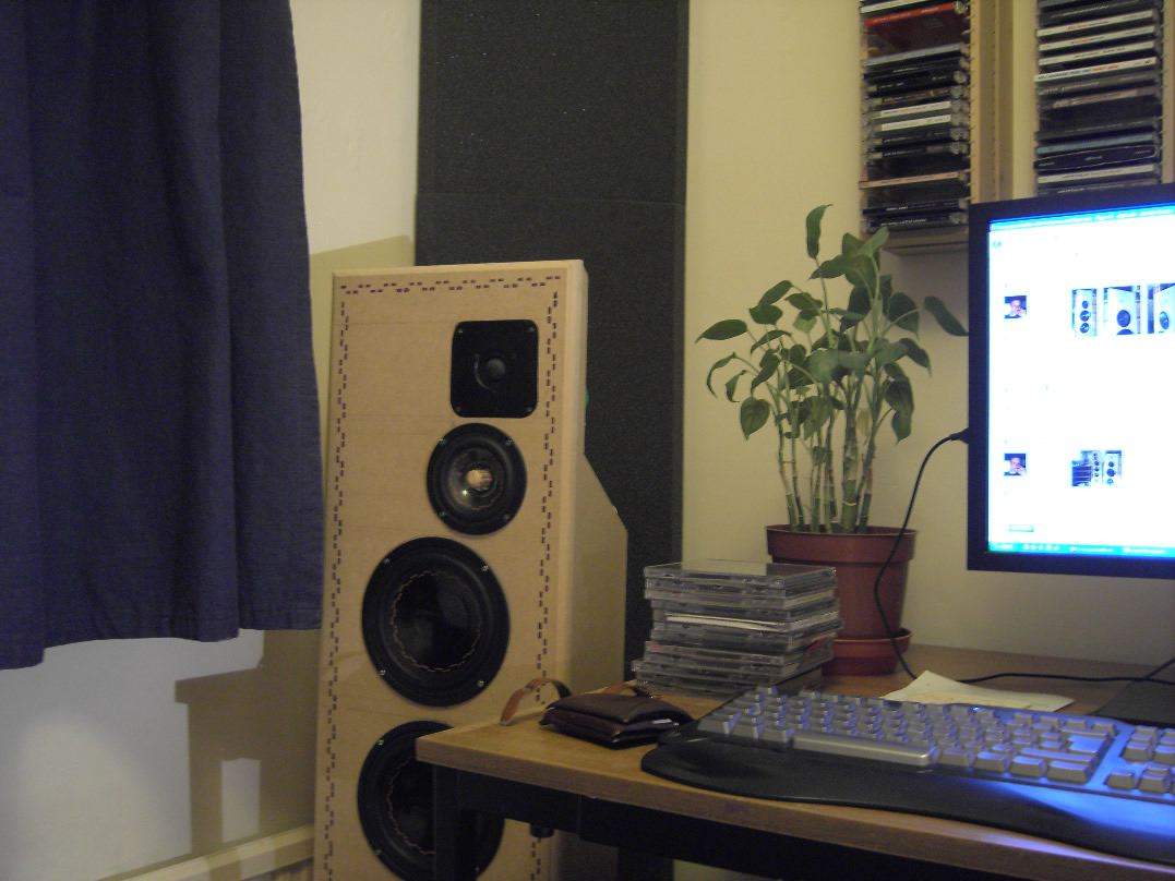

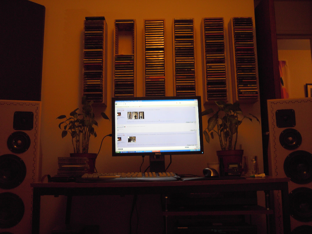

very nice, do you use them so close to the back wall?
Thanks. I have my speakers about 50-60cm from the back wall - as far forward as they can go (it's a bedroom system for the time being).
One is in a corner and does exhibit an issue in the upper bass. The foam corner absorbers behind help, plus they absorb some of the rear output at higher frequencies, which seems to be an ok side-effect.
My CD racks and plants aid diffusion back there - it's all making the most of a terrible listening space. Dipoles seem to be the way to go for getting enjoyable bass from a tiny room, but it's still not easy.
On a quick test one single new baffle (with no t-bass) was able to shake the small room with articulated and deep bass. It was a revelation.
The 2nd pic I've attached is under-exposed due to my bright monitor!
You might want to look into Alex from OZ room teatment. He claims bass resonances are severely dispersed and tells me privately that a full height corner treatment is delicious.
