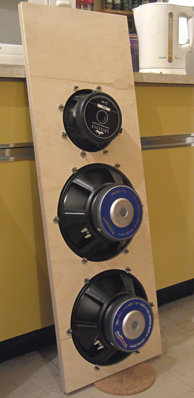

3 way open baffle with Eminence and Skytronic

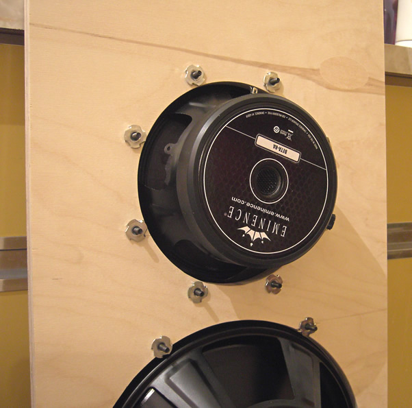

Rear shot 😀
I'll bevel the inner edge behind the drivers with the router at some point.

It depends on how strong the motivation is 😉 And, as I saw you got decent tools on hand already, changing the driver mounting from front to rear shouldn't be so 'drastic'.
The recessed cut on front of the baffle can be chamfered off entirely when you make the new bevel cut. In such case, you might take almost all thickness for the bevel. Then, on the rear, you may stick several small wood blocks around the hole for aligning the driver so it won't slip as long as the support on magnet assembly is in position.
I've seen several cases of rear mounted drivers with gorgeous results. And there is an admirable vibration isolating fuction in it. 😀 I myself will try similar mounting method in my next baffles, just have to wait after I settle down in the new place....
