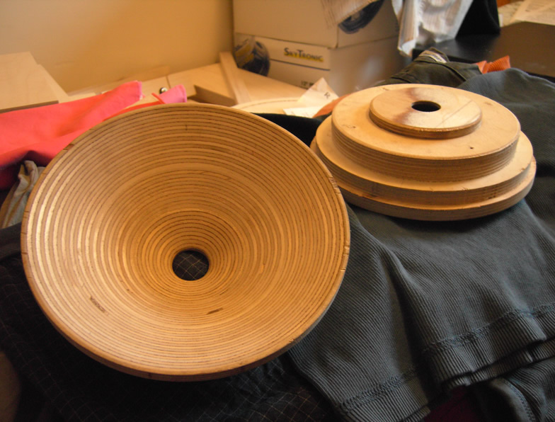

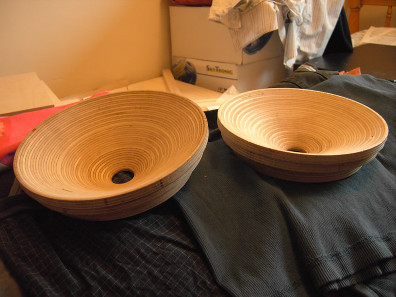

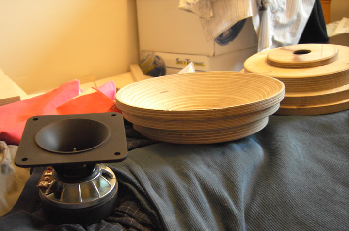

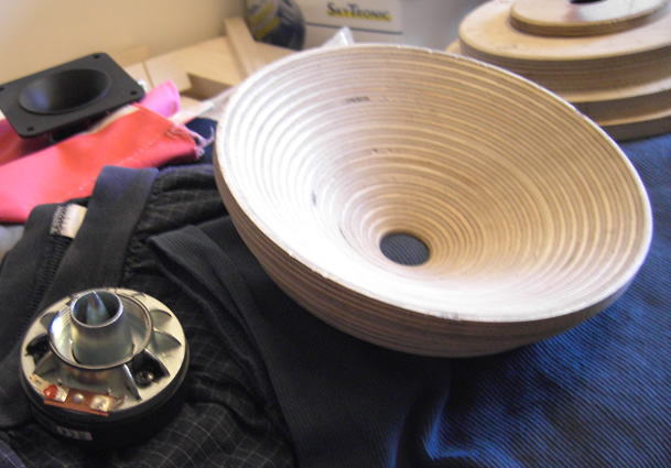

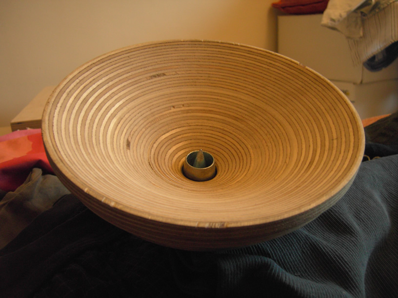

Here they are, I'm extremely pleased with how these turned out! I'll need to sand them smooth and work out a system for attaching the compression tweeter. I'll probably mount a bar across the magnet to press it in place.

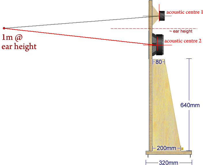

Ok, I will try to work out where that is in my driver. I will then do some tests with a microphone and 1khz sine wave and try to find the optimum position of the waveguide relative to the mid. I'll connect the drivers out of phase to each other and find the biggest null...
Time alignment
To help me visualise how much of an issue (or not) with time-alignment this design might have I took a bit of my picture (it's to scale where 1 pixel = 2mm) and put some extra details on it.
Ok, this includes some guesswork, but it looks like the difference is just about 1cm or less. The midrange driver is closer to the ear. I don't think I'm going to spend too long worrying about such a small distance. I will concentrate on making the waveguide nicely flush with the baffle to avoid excessive diffraction problems.
