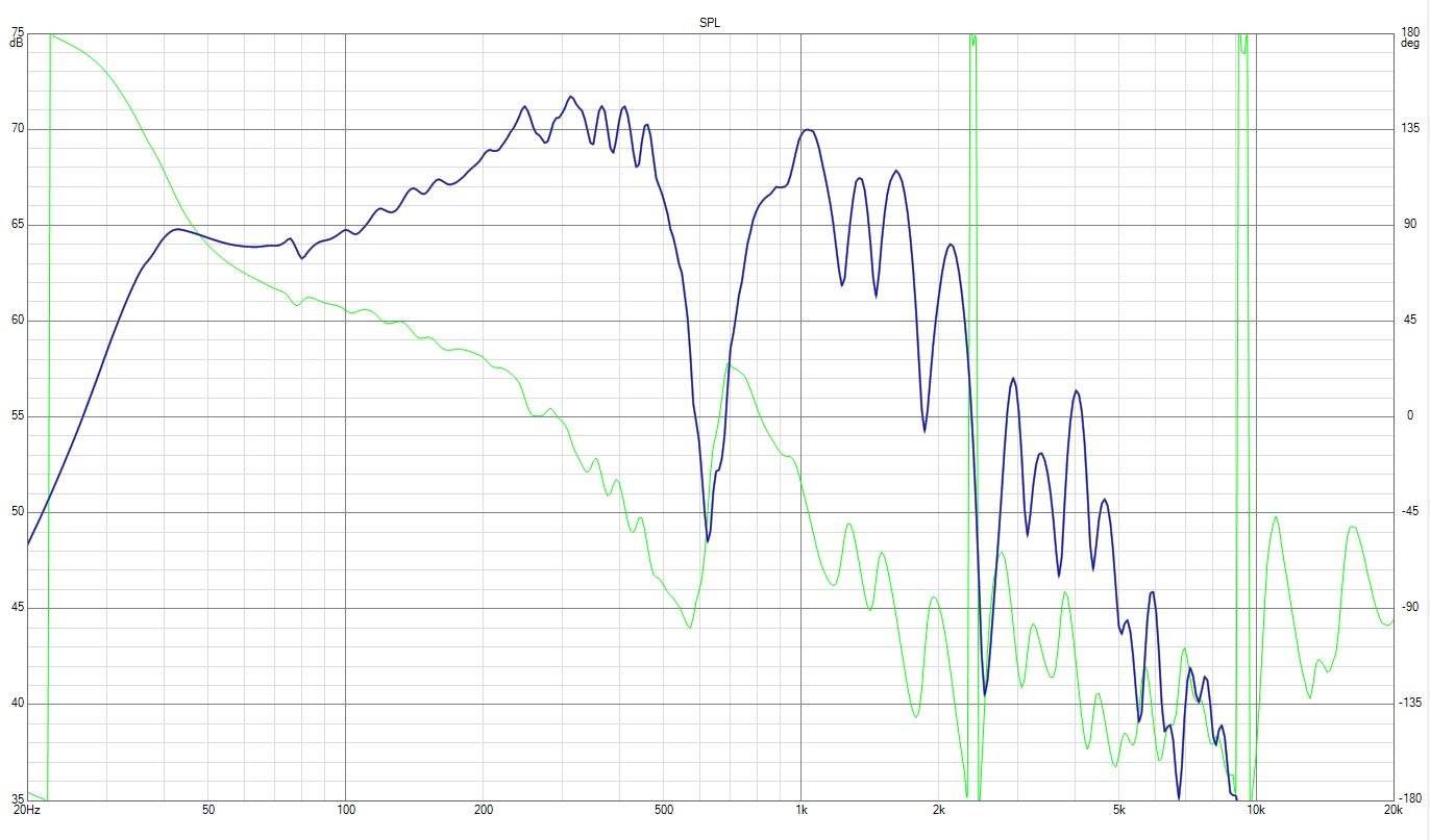

You missing probably one step to get H-frame LF measurement. You need to add to measured near field response same response with phase inversion and delay. Delay in your case is 20 cm sound travel time.

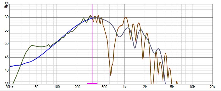

Simulation result are like this. I take H-frame panel thickness 20 mm, SPP-250 T/S parameters are form Monacor page. Dipole peak and 40 Hz level difference is more than 20 dB, you get only 7 dB.
How i get to my H-Frame response:
Nearfield measurement link in the photo above showed this FR:
With Dipolcancallation (merged with inverted Phase and delay)
Merged with 1m Farfield-Measurement:
Delay is a little bit more then 20 cm.... Its (10^2+15^2)^1/2 + 10 cm = 28cm time travel. Thickness of the H-Panel is 19mm. The Sound source point is in the middle of the H-Profile but this means that front chamber is smaller (depth 5 cm) then the rear chamber (depth 13cm).
Also is interesting to see speaker excursion data from simulation. It is taken with 2.83V input, you can calculate how big it will be if you will add +20dB EQ on 40 Hz.Value is in mm, m plus prefix m..

Strange that the difference with simulation is so big, specially peak at 40 Hz. General rule is that all OB speakers had to lower frequency direction form dipole peak 6 db/octave slope.
I know Akabak can be not very accurate in higher than 1000Hz, but in bass region it must be correct. I had made some simulation and tests measurements on prototypes in 200-2000 Hz range and they are very close.

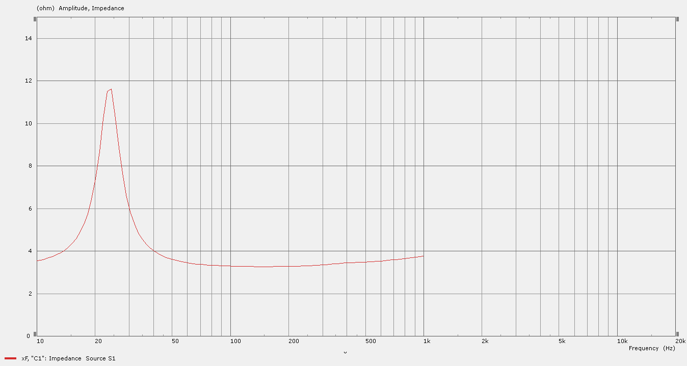

Had you measured impedance of H-frame speaker?
If there is something special on 40 Hz, it must be visible somehow.
I generated impedance of simulation, there is nothing special on 40 Hz.
If 40 Hz peak is caused by Qts 0.90, then it must be visible also in simulation.

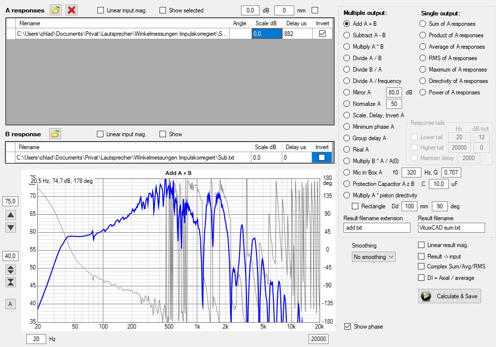

Here is how i add the invert signal of the LF-Dipol.
db = 0
delay: 882 uS for ~30cm
So this is near to your akabak. But has only a rise of 6 db at 40Hz. More or Less the same effect like on the MoDiPo.
db = 0
