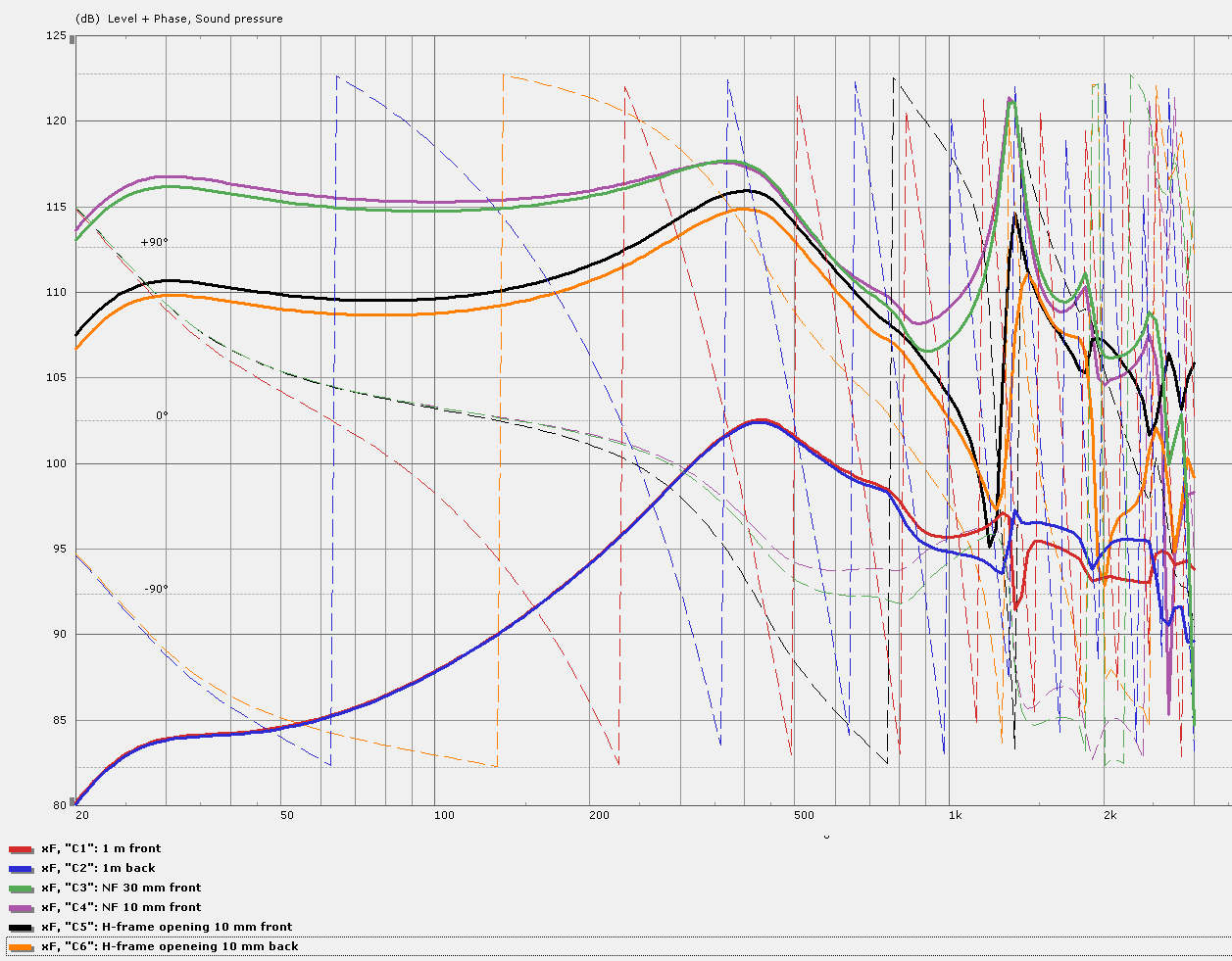

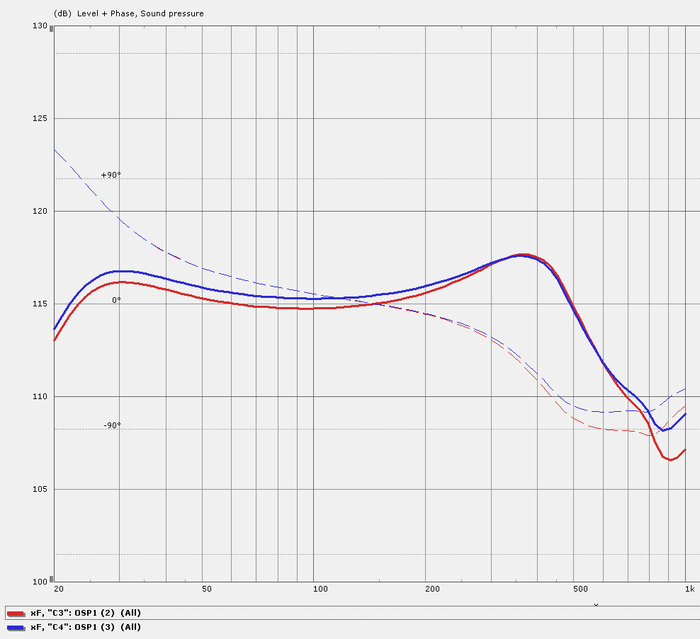

I understand Charlie's point is that measurement need to be done not near to speaker cone but near to H-frame opening. In your case there is difference about 100 mm.
But I put in Akabak simulation one measurement point on 10 mm distance from cone center, result was nearly flat line from dipole peak to 30 Hz, so Akabak simulation did not predict 40 Hz peak in near cone measurements. On image blue line is 10 mm and red is 30 mm from upper cone. My initial simulation measurement points where 1 m from middle point of cones.
One point more. All resonances (peaks or holes) in SPL curve what are related to speaker cone movements will left some sign also in speaker impedance curve. In original MoDiPo impedance curve they are missing or at least not visible, maybe filtered out.

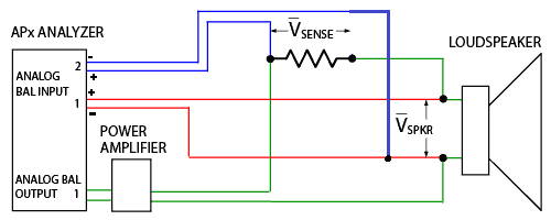

Yes you can. US-144MKII had headphone output.
Use headphone output of one channel. US-144MKII had balanced inputs, important is to connect "-" contacts of inputs (line inputs 14 and 16 in manual) together with headphone output ground. Resistor musty be about 100 ohm, but with precisely know value.

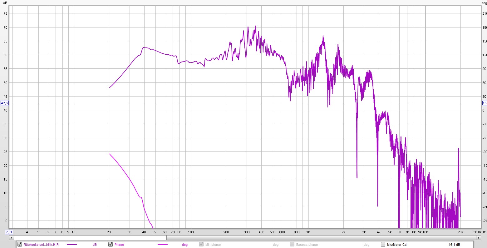

sorry for the delay! I took some measurements yesterday (all measurements not spl calibrated):
First of all the H-Frame (this time) 1 cm from the opening:
Now the Backside:
The hext measurement is on the doorstep to the open balcony.:
In my eyes, the room-mode at 40 Hz gived an additionaly 2db and a stronger db loss under 40HZ in the nearfieldmesurement. But overall there is still a strong Bassresponse from 35-45 Hz. If i hold my fingers on the MDF-Baffle i can recognize vibrations.

I dont have headphone jacks at home. If i understood you and the rew website right i need 3 headphone jacks:
Is this ok 3 times:
Boutique Haut-parleurs & Audio DIY
and a 100 ohm resistor:
Is this ok?
