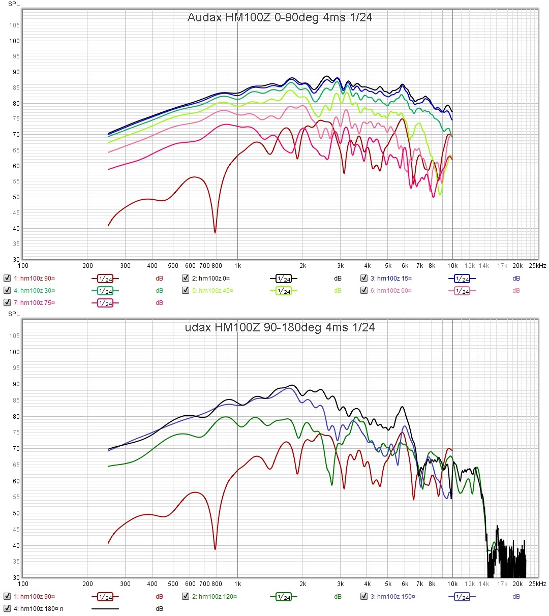

I now understand better your findings with the bigger drivers. But if i want to use a6 inch middriver between 325Hz -2300Hz, then the offaxis response will be wider at 1,5-2khz and then narrow with the tweeter. Did you have seen this effects horizontal off axis?
Many people like to have a single driver in the 300-3000Hz range. What makes it superior? In a good dipole speaker with a crossover in that range i think only the transient response or the vertical smooth pattern. What do you think?
Do you prefer the neo10 (or grs clone) or 1 cone driver or 2 cone driver in the mids?

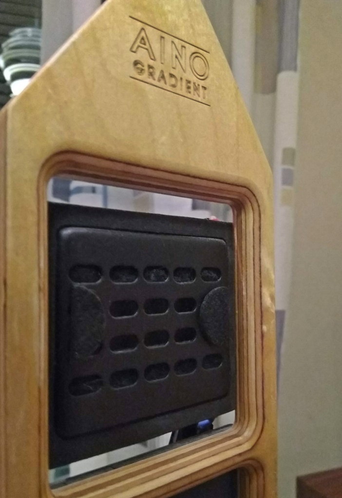

It is 310+310 mm frame from 30 mm oak panels.
Can 71 Hz be some kind of H-frame wall material resonance?
If I measure FR from 1 m, then 71 Hz drop is increased, so probably it is from room.
