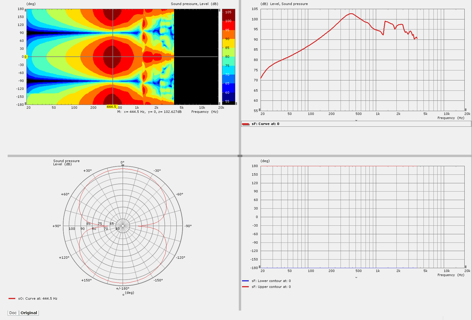

It is impossible to measure H-frame OB bass correctly in the room, nearfield measurement will not count dipole cancellation nearly at all. To get this small size H-frame bass FR direct to to 40 Hz you need much more correction than +3 dB on 80 Hz. I had find with AKABAK simulations that needed is +10 to +15 dB EQ on 40 Hz. Something similar as in mid range where is used +16 dB and +7 dB EQ.

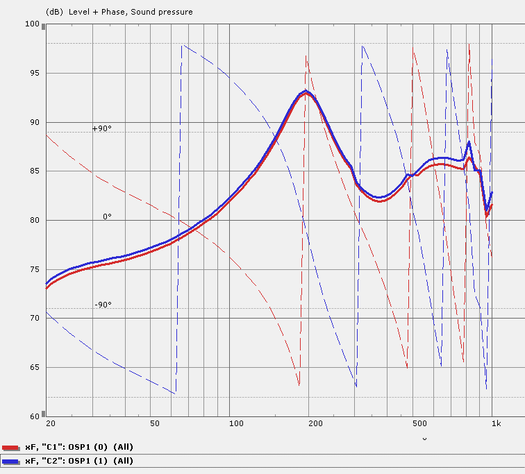

I presumed you measured bass only as near filed from small amount of used EQ level. But you made also "Sum near field response to itself with phase inversion and delay"?
Here is image how looks H-frame Akabak FR simulation form 1 m, frame depth is 300mm front and 300 mm rear, two 12" speakers located nearly as in your H-frame.
Hi kaameelis, yes. I can attach you the merged response for the H-Frame (dipol nearfield, like you described + 1m farfield), and get this response without PEQ:
I think its not to far away from your akabak simualtion. The SPP-250 has an Qts of 0,92, if its important for your simulation with fs at 30Hz. H-Frame differs a little bit of course. And my lowest Room Mode should be between 35-45Hz.
The H-Frame is 31,4cm bright and has a depth of 20cm. The SPP-250 is a 10inch driver.
OK, you had big room influence in measurements at 40 Hz. I thought it is presenting free field FR what must fall from dipole peak nearly constantly with slope 6dB/octave.
I can simulate it on Akabak. is H-frame depth 20 cm to forward and also 20 cm to rear side? Are height and width 31.4 cm, is this internal or outer measurement?
I have measured nearfield LF like in this photo:
After that i merged the nearfield-measurement for LF with the higher frequency part of the 1m measurement.
The depth is overall 20cm. The width 31,4 cm is outer measurement. The High is approx. 60cm.
You missing probably one step to get H-frame LF measurement. You need to add to measured near field response same response with phase inversion and delay. Delay in your case is 20 cm sound travel time.
Simulation result are like this. I take H-frame panel thickness 20 mm, SPP-250 T/S parameters are form Monacor page. Dipole peak and 40 Hz level difference is more than 20 dB, you get only 7 dB.

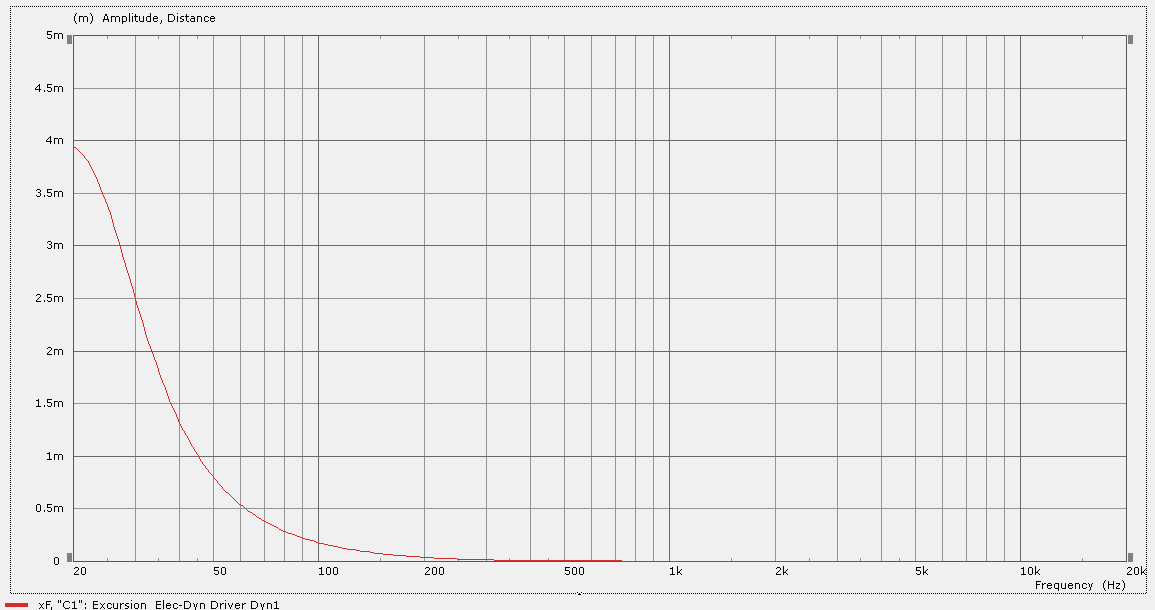

Also is interesting to see speaker excursion data from simulation. It is taken with 2.83V input, you can calculate how big it will be if you will add +20dB EQ on 40 Hz.Value is in mm, m plus prefix m..
