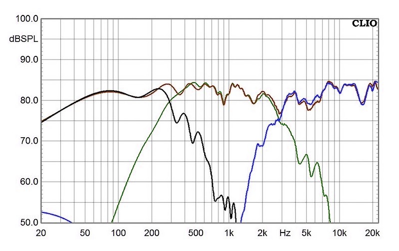

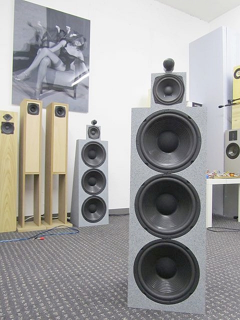

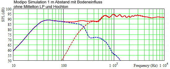

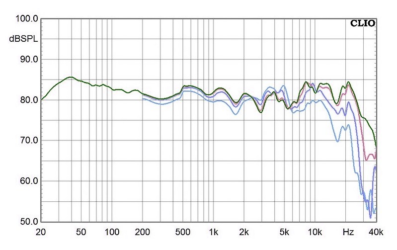

One of the less known solutions could be the LF from the MoDiPo:
It looks to be unintentionally a hybrid of a nxt and a dipol. The simulation showed this bass-response:
Or:
But the measurement...:

It would be very interesting to discuss this. How to intentionally achieve it with a dipole? We could take the modipo and look how the measurements differs if we change some parameters.
My idea is, that with the high qts the spp-250 works like a exciter near the resonance frequency. Especially 3 of them could make a additionally bass boost. Take a look at this study:
