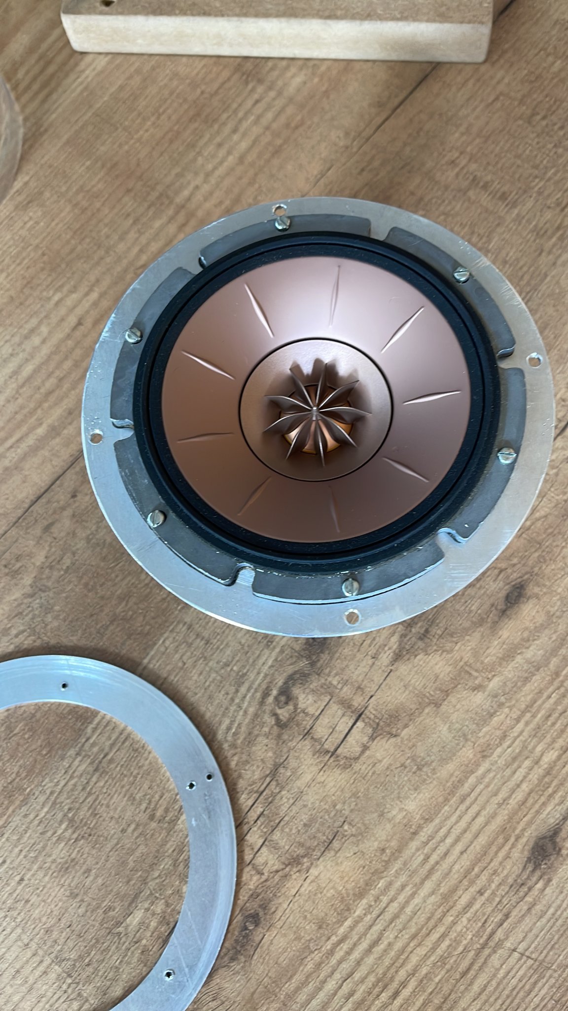

What are the mounting hole and recess dimensions for the Kef coax? I've got my own version of the blade on the drawing board but I haven't bought drivers to put calipers on yet. A shame we can't get data sheets for them from Kef - like the linear Xmax. I do have a pair of R3s so I know they will sound great.

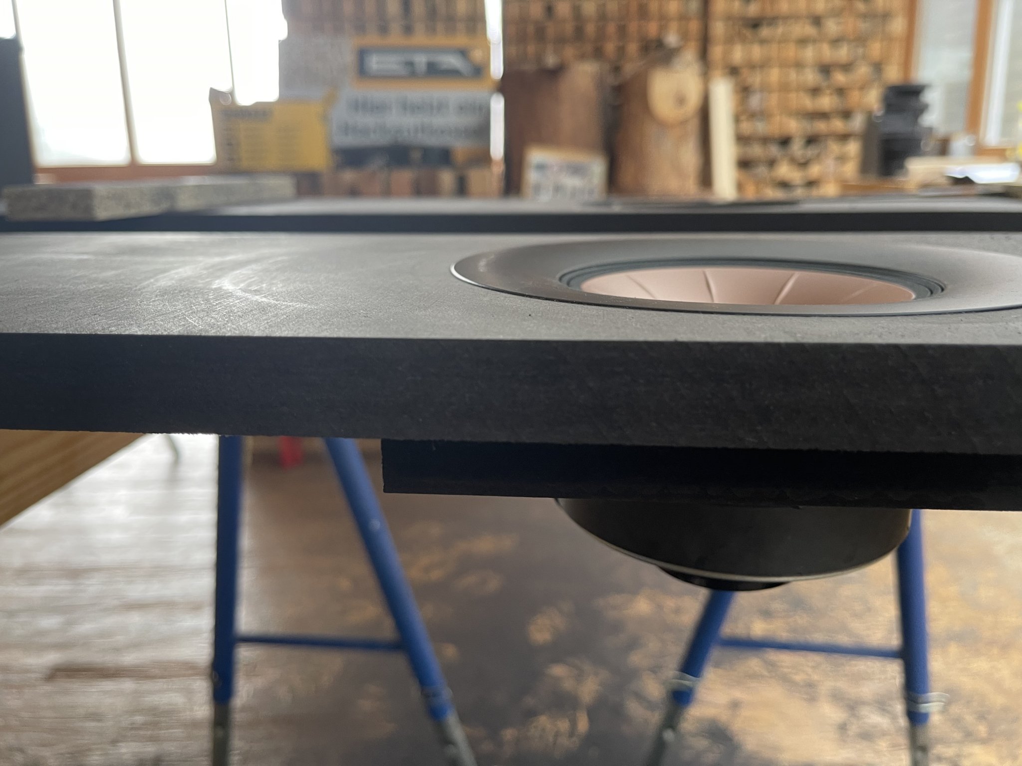

i use an adapter ring so the cutout can be bigger like the original one so the midrange can breath more, not visible in any picture.What are the mounting hole and recess dimensions for the Kef coax? I've got my own version of the blade on the drawing board but I haven't bought drivers to put calipers on yet. A shame we can't get data sheets for them from Kef - like the linear Xmax. I do have a pair of R3s so I know they will sound great.
I saw that on some of the other builds and liked the idea.
I can measure the dimensions for you
Thanks, That ring is a good idea as it gives great flexibility, even to try different drivers - like the Sica 5.5" coax which does have a data sheet.

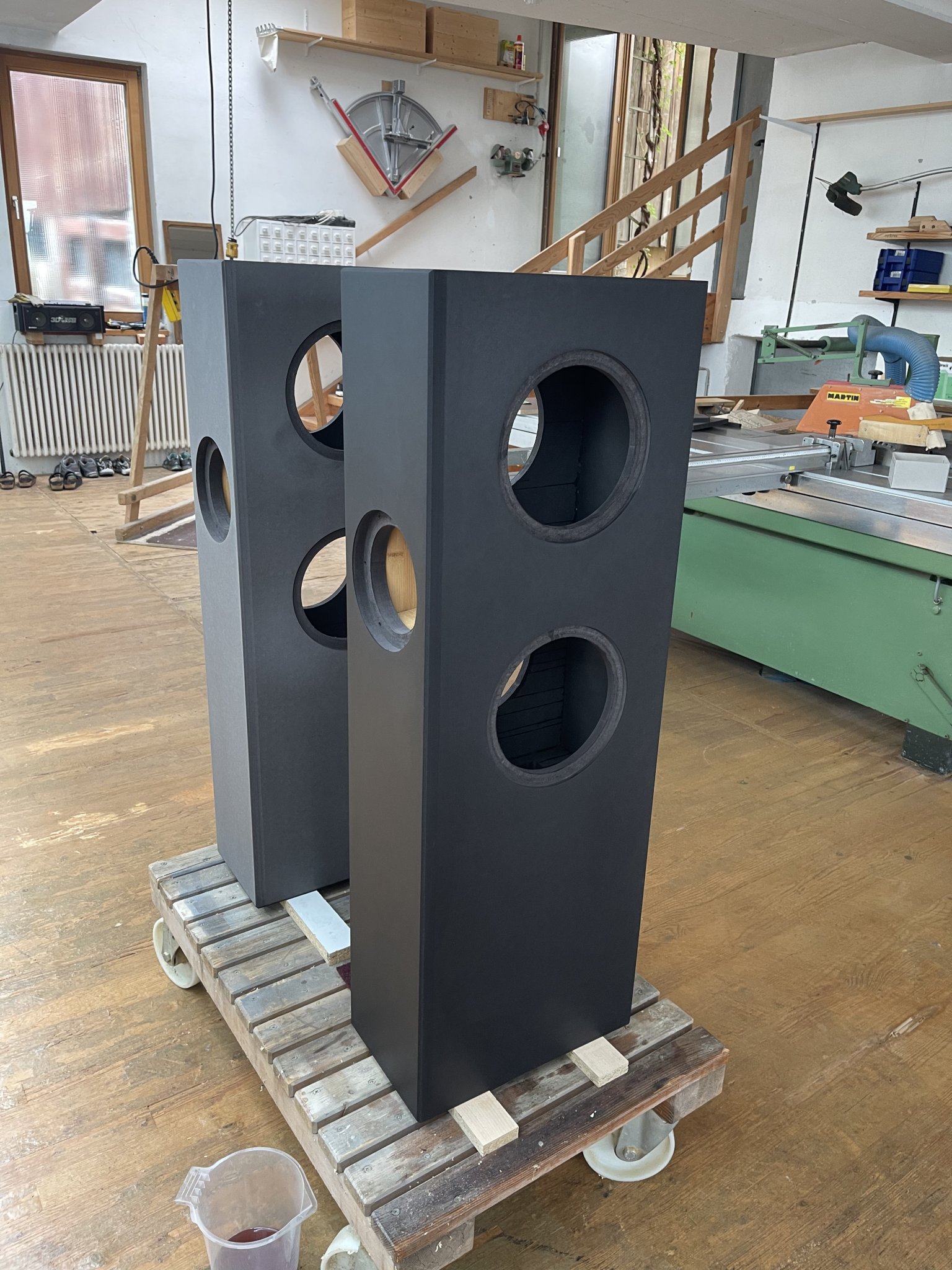

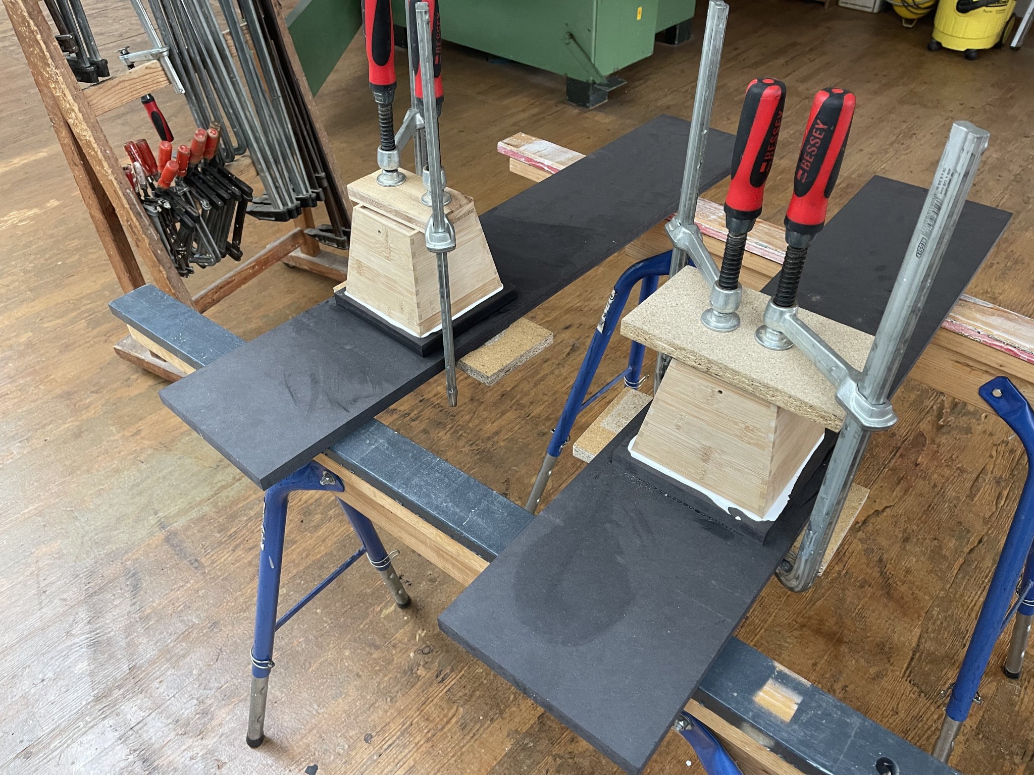

building is finished, I ll take some worthy photos once weather gets better and I can take some serious measurements, it raining at the moment
they will get some 5axis cnc aluminium feet but I haven't decided on design yet 😛

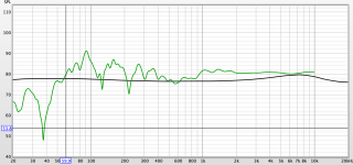

i made some really basic xo settings with lr2 at 500Hz and lr4 at 2950Hz, adjusted the gain and estimated delay with distance sound takes just so I can hear them a little bit, I know I have to measure them outside to get better/ real measurement results. but even without any eq just with xo they sound very nice especially off axis its insane

sry i forgot to measure the drive before installing, was just to focus about finally completing the build.What are the mounting hole and recess dimensions for the Kef coax? I've got my own version of the blade on the drawing board but I haven't bought drivers to put calipers on yet. A shame we can't get data sheets for them from Kef - like the linear Xmax. I do have a pair of R3s so I know they will sound great.
here is the adapter dimension if it helps but my measurements weren't completely on point I had to make the 6 holes on the inside a bit bigger
but I have a broken one from key r900 which I think uses the same basket, if u want I can measure its basket

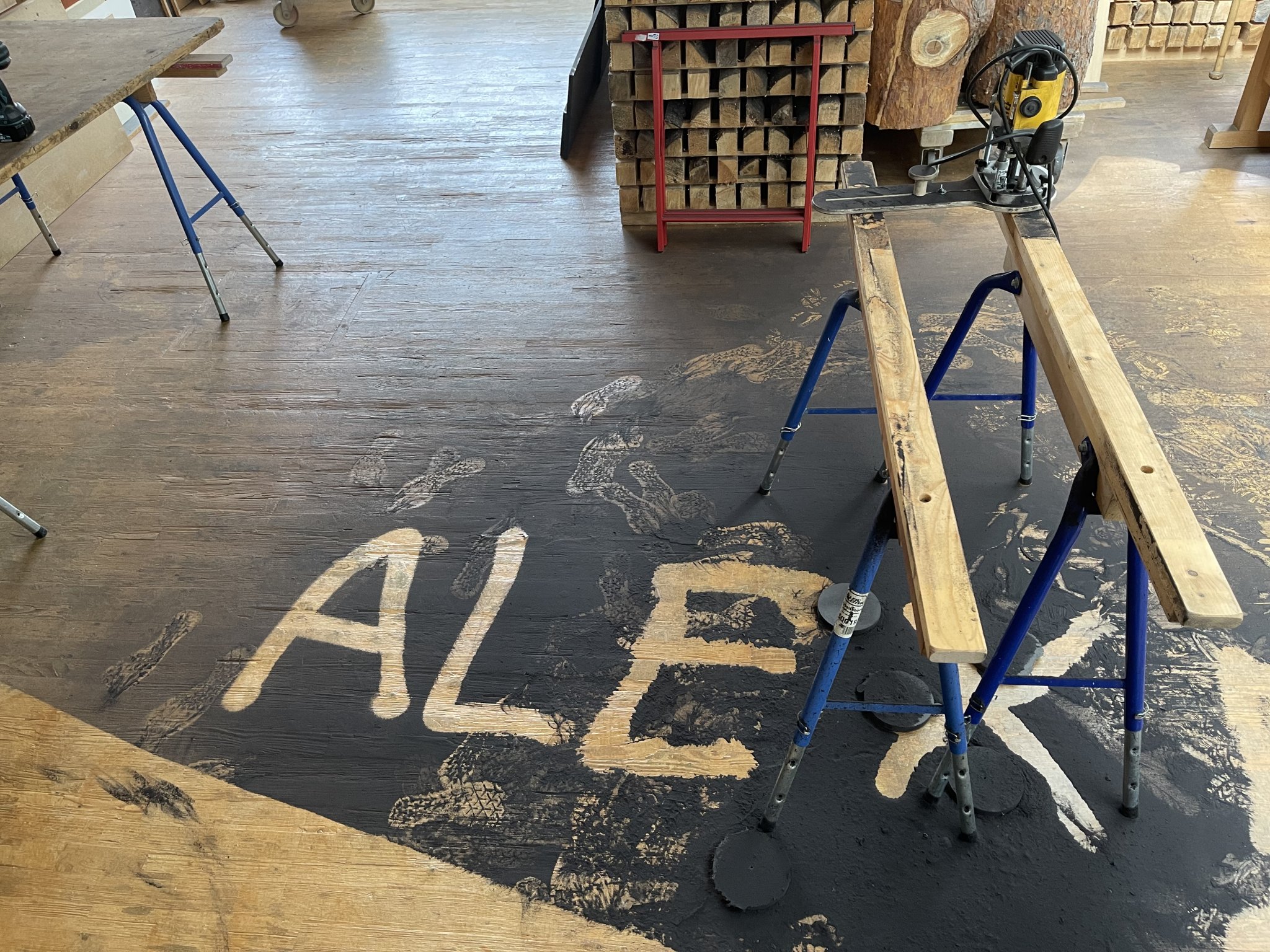

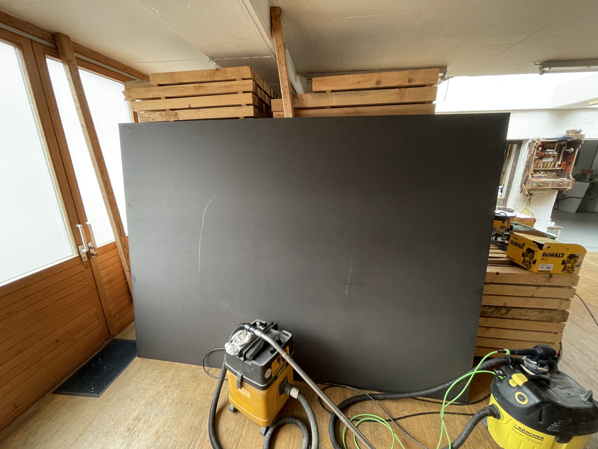

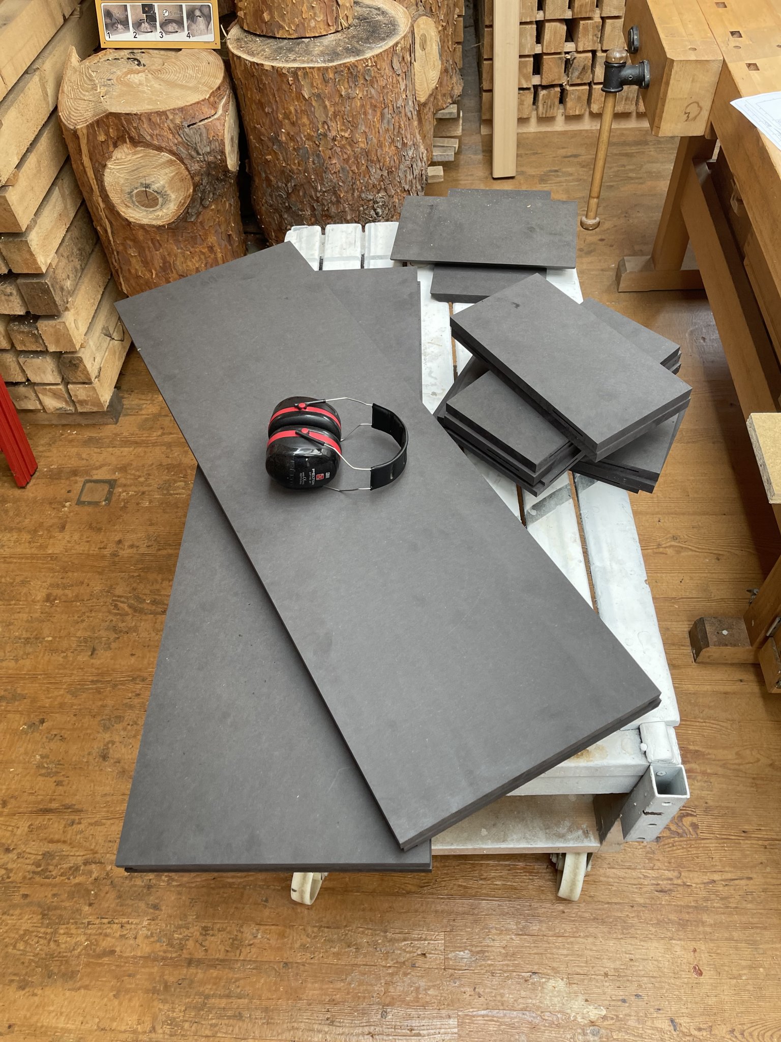

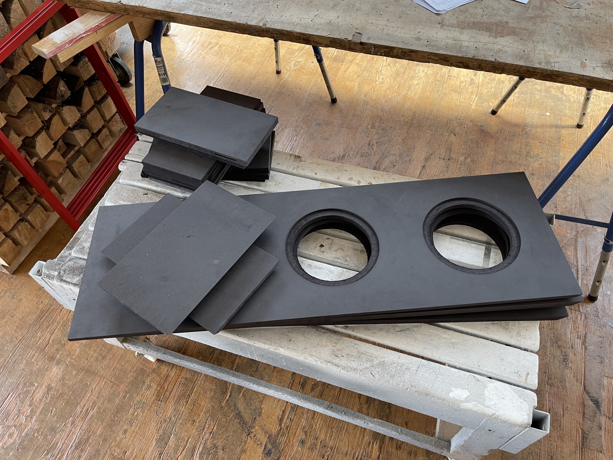

thx, its my uncles place he is retired and has a gigantic workshop with really nice machine, sadly not many are useful for speaker because workshop was designed to build windows. but so much space and a big Format circular saw helped a lotBeautiful neat work and wonderfully roomy and organized workshop

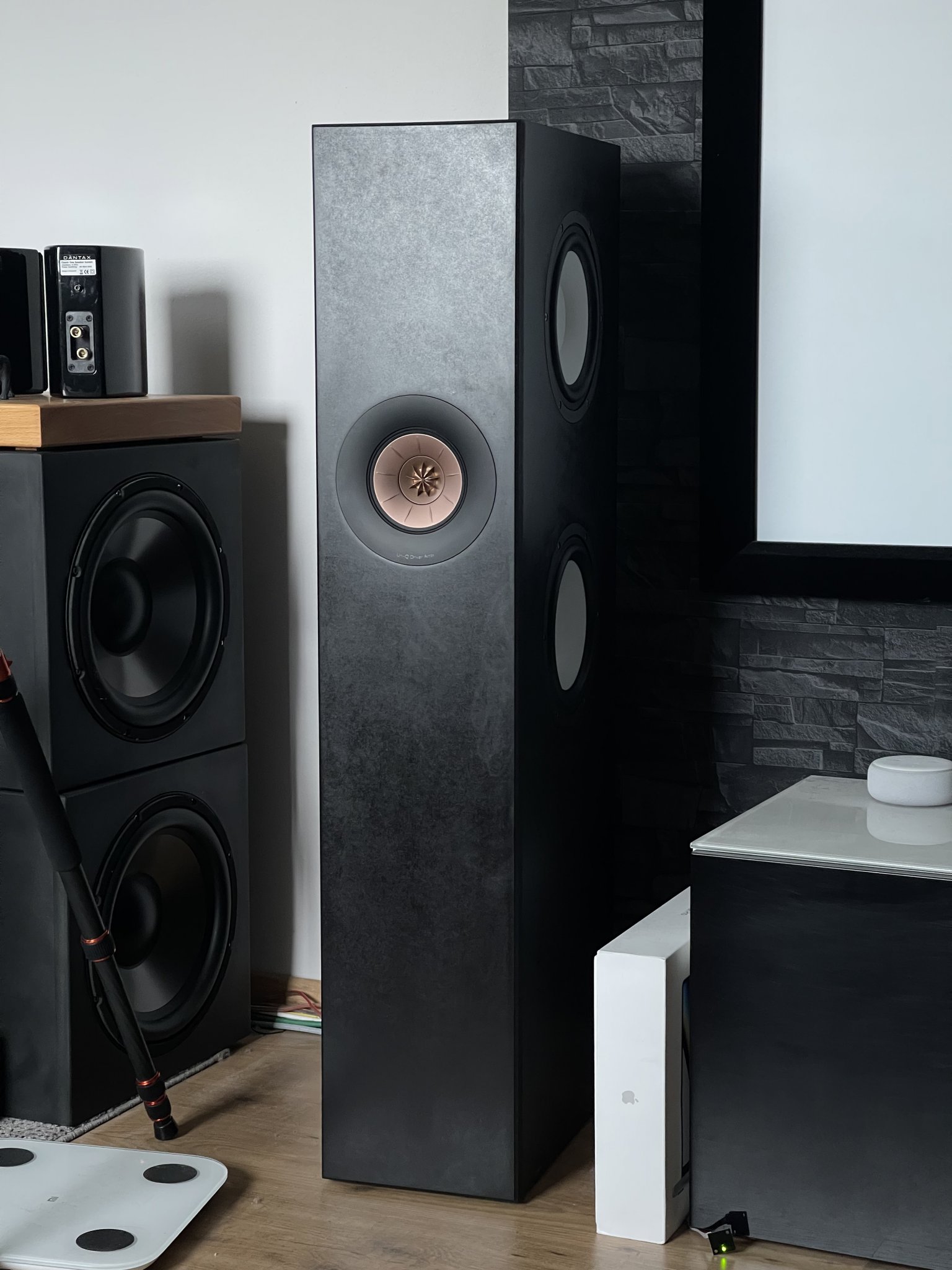

Whoa...
These look like Kef LS70 🙂

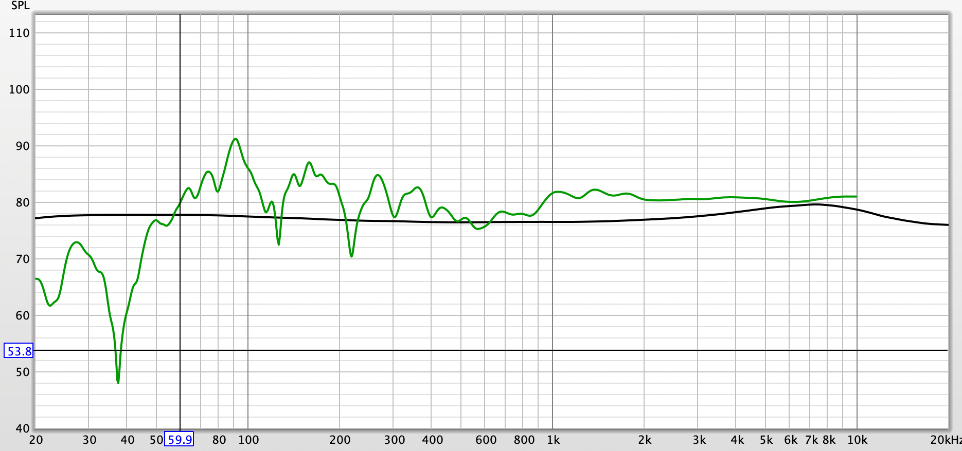

I will get a driver on order shortly so don't worry about the measuring it mechanically. I'm much more interested in the acoustic measurements. What you have shown has an exceptionally clean top end for a coax driver. Is there any smoothing on the graph? Unfortunately, the room is corrupting the lower frequencies. Eagerly awaiting those outdoor measurements ideally a full set of polars; at least enough to estimate how equalizable the response is over an area.
yes they are smoothed, rew var smoothingWhat you have shown has an exceptionally clean top end for a coax driver. Is there any smoothing on the graph?

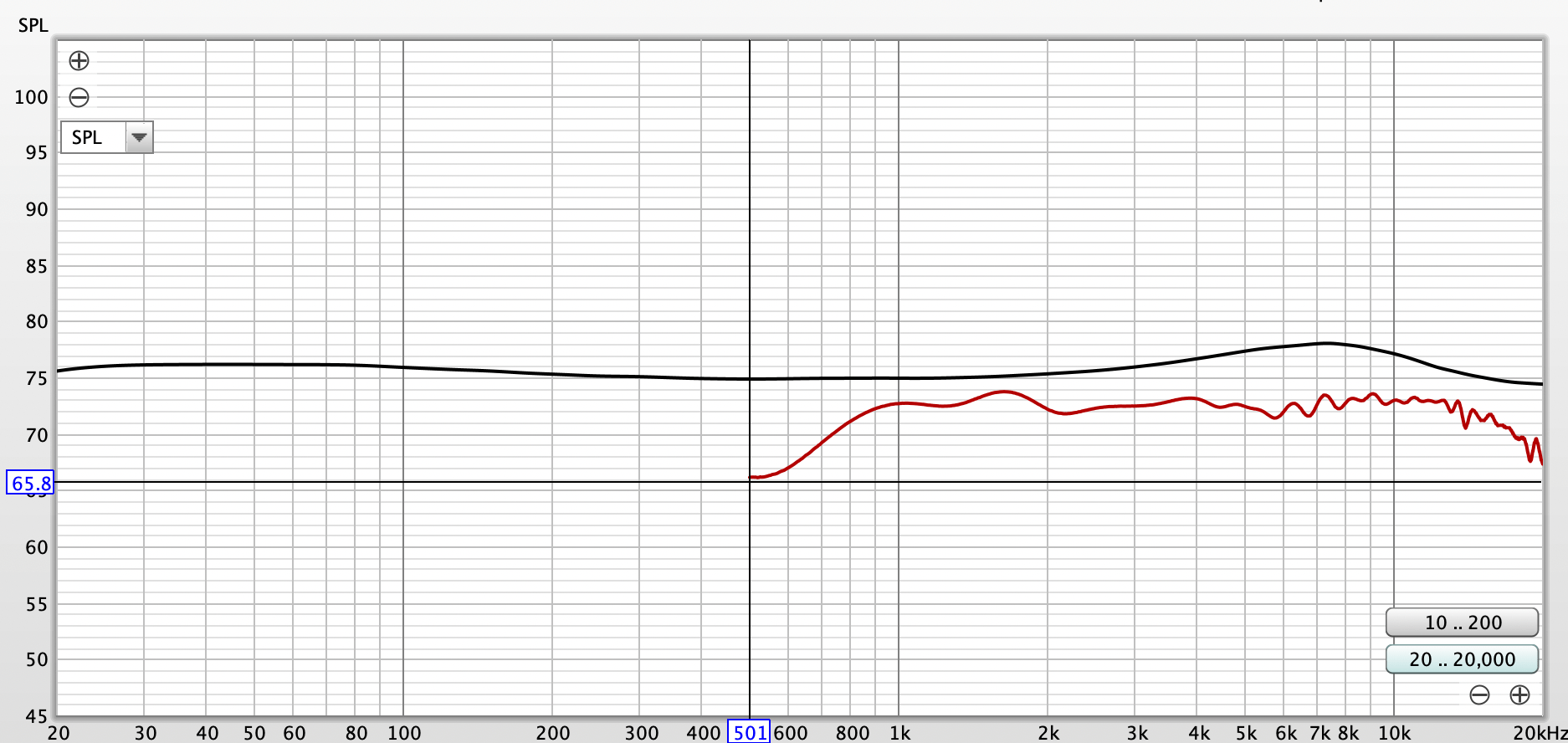

2ms gated, hole speaker and no smoothing (ignore the dip in 500hz region crossover is not properly aligned yet)

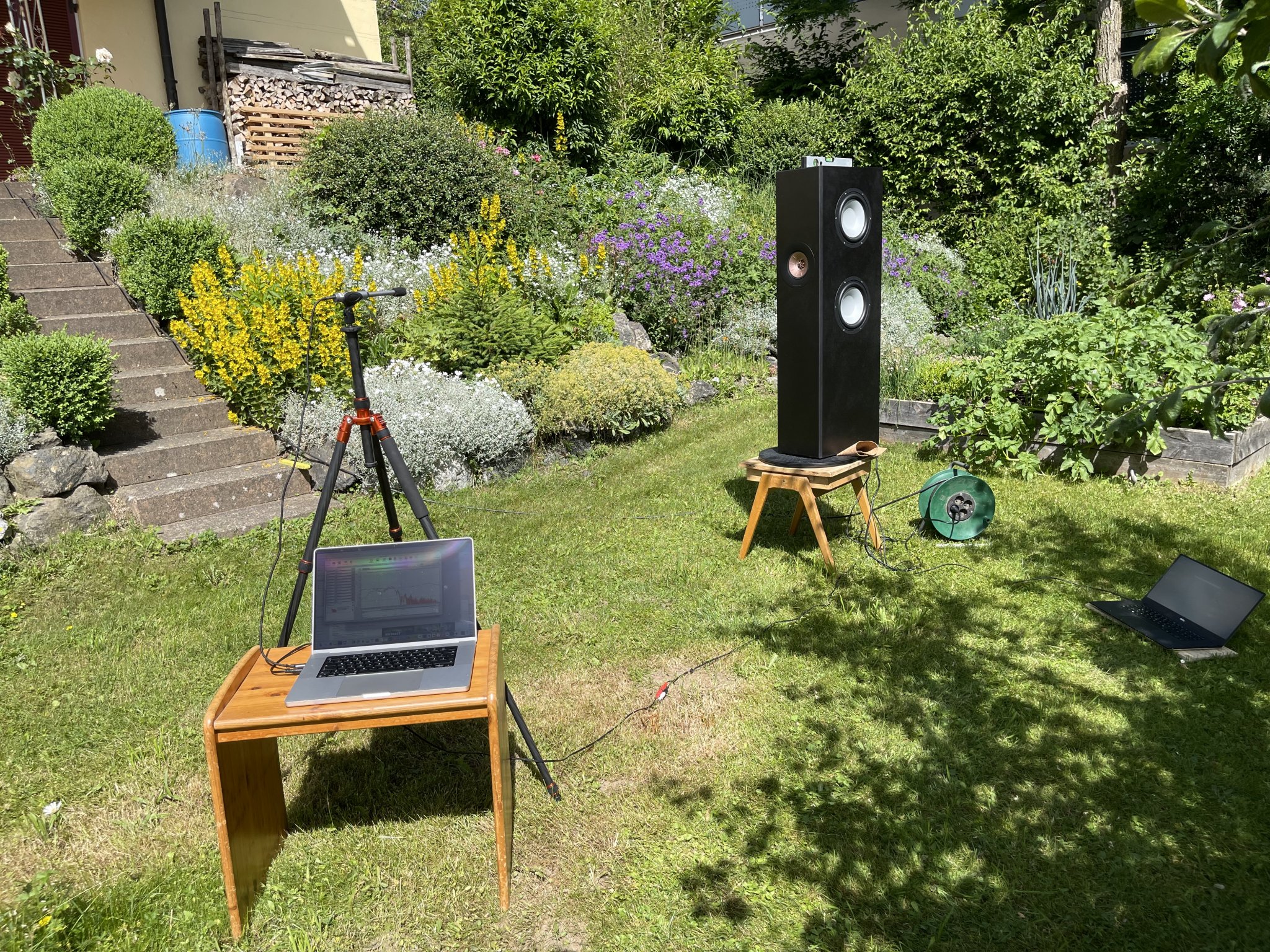

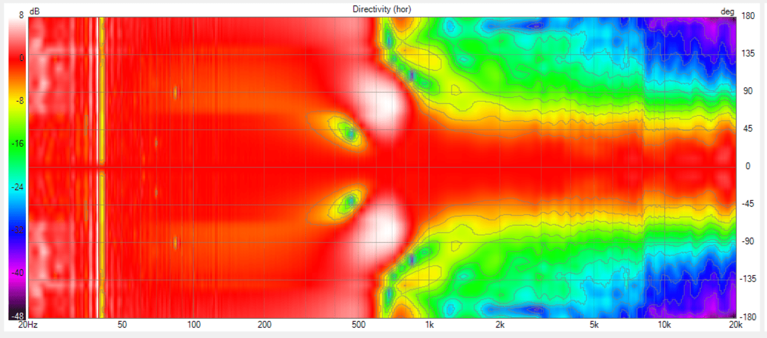

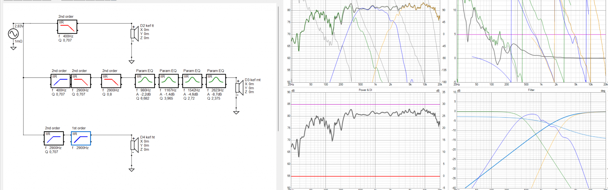

Well i tried my best at measuring but sun was burning insanley so i only did sweeps for tt, ht, mt direct and hole speaker 0-180 degree with 400Hz LR2 and 2900Hz LR4 without any correction, just a bit gain adjust
even outside and raised speaker first reflection was at 3,3ms...but i thinks its bether then nothing. i need a higher rig
gated 3.3 directivity:
server has problems with zips...i ll link measuremnts with cloud
looking at the files, thanks. you definitely need more height! Build the 2nd speaker and stack them 🙂
Nice garden.
