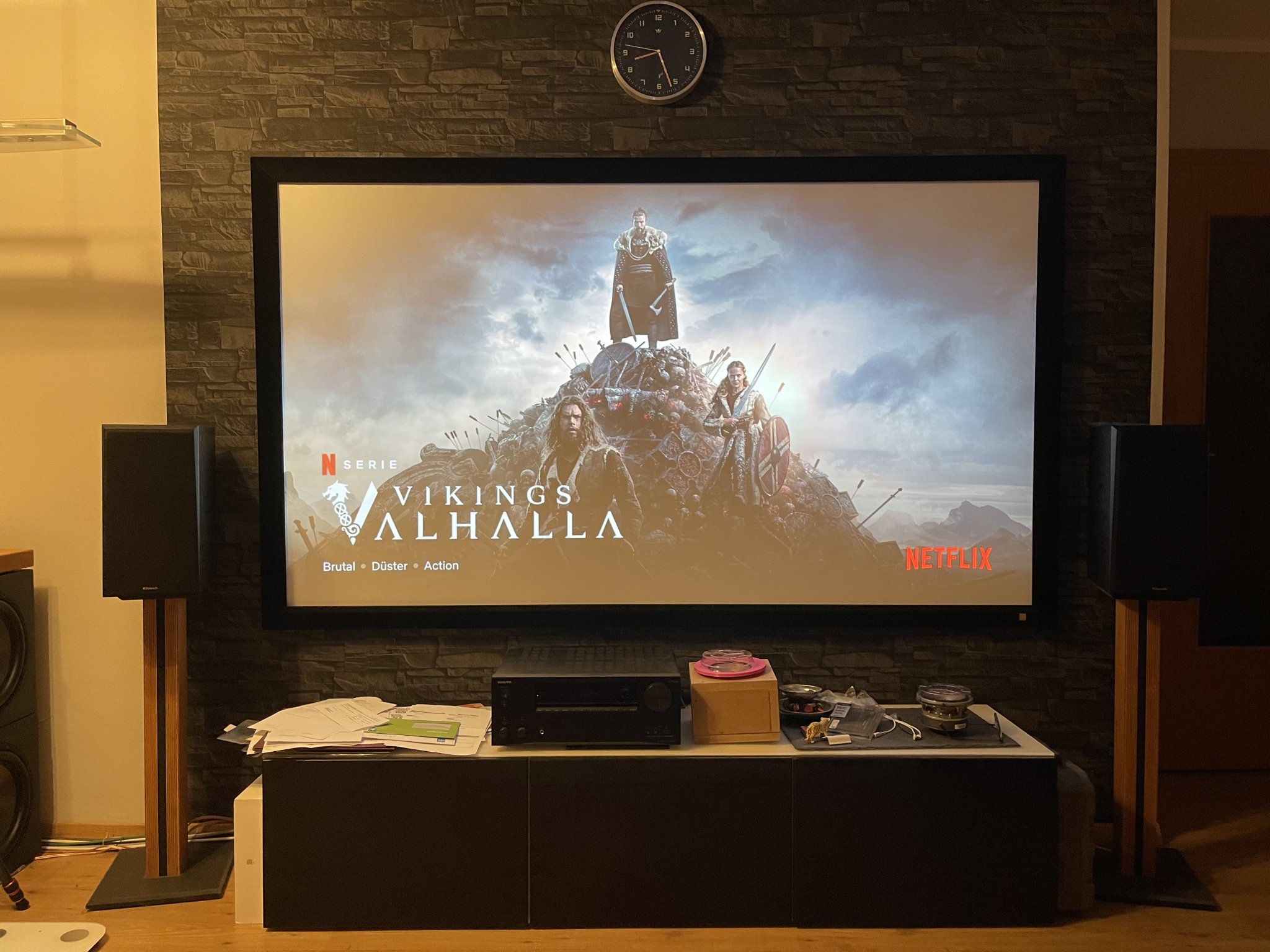

jeah but even my setup with only a bit of height was really not stable, i thought several time "oh **** now the fall"looking at the files, thanks. you definitely need more height! Build the 2nd speaker and stack them 🙂
Nice garden.
well i have 2 of them building is done

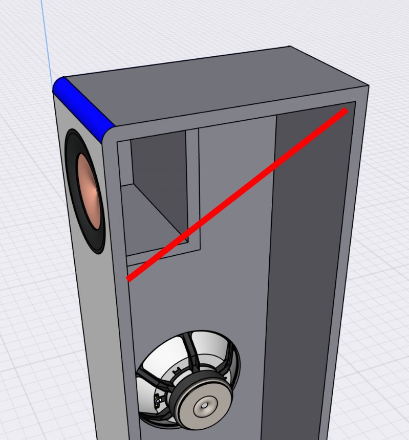

How big a cabinet would the Omnes W8 need?Well after looking at the kef ls60 design, which looks quite similar to my mock, I am confident it will work.

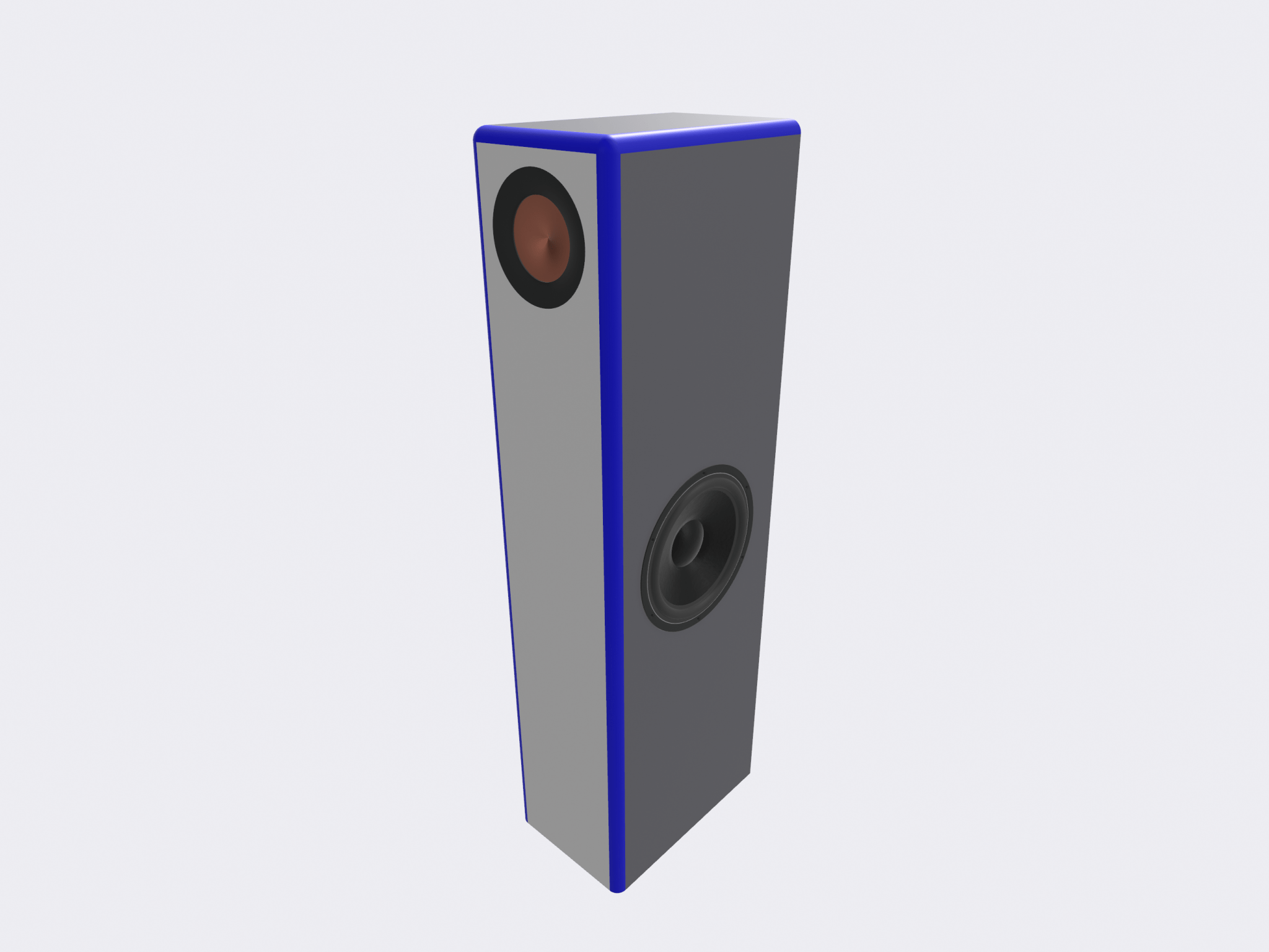

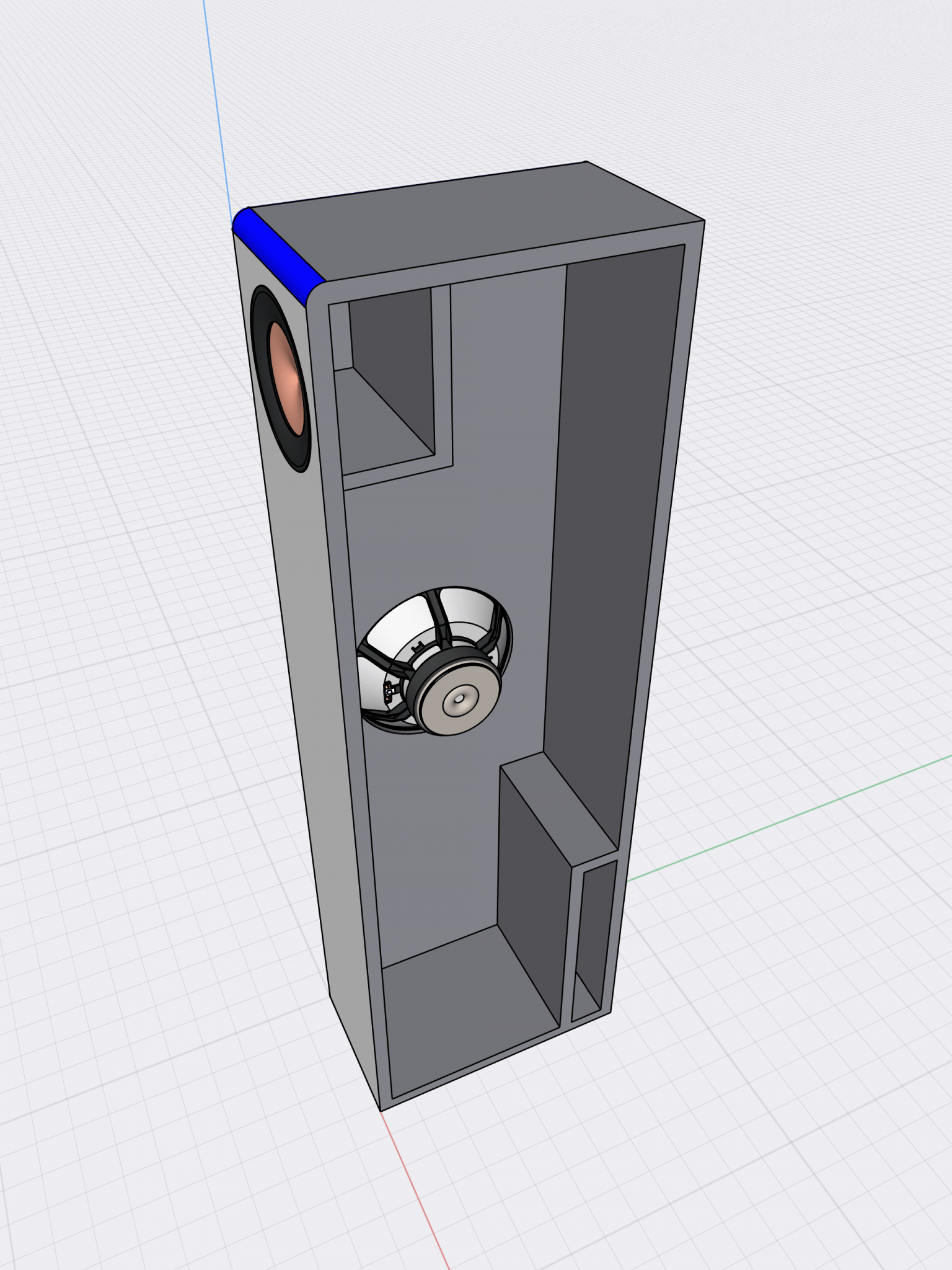

A rudimentary drawing of my concept is here. The final height of the drivers would be decided on by measuring my ear height.
https://www.diyaudio.com/community/attachments/driver-system-r1-jpg.1083575/
Since my cabinet is small, I could not find any 8" woofers that would
(a) have a depth that would permit 2 of them to fit back-back in 15cm
(b) give a response (without DSP) that is reasonably flat
I did consider the SB17CAC35-8, but Erin's review lead me to believe that the driver is not suited for bass duty.
https://www.erinsaudiocorner.com/driveunits/sbacoustics_sb17cac35-4/
Hence I chose the SEAS L16-RN/SL (assuming that Sigfried Linkwitz wouldn't have designed a bad woofer for his LXMini).
http://www.seas.no/index.php?option...icle&id=96:h1480-l16rn-sl&catid=44&Itemid=238
https://www.linkwitzlab.com/LXmini/Introduction.htm
Now I am waiting for the drivers and will start once the drivers arrive. I have included a Fountek NeoCD 1.0 ribbon just in case the MAOP7 does not offer adequate dispersion/extension above 10k.
would only work in the key blade like style because copper color(key coax) and alu don't really match. I need a qtc of 0.8 to reach below 70 Liters with 4 of them. talked with baur he recommends at least 25 Liter per woofer
otherwise they seem nice
4x8 Inch would be an insane speaker and much headroom to dsp

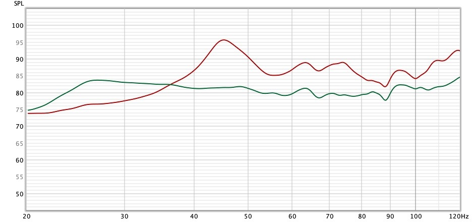

Thanks. Based on published specifications, I modelled 4 x SEAS L16 and 4 x SB17 in 45L sealed and vented cabinets. This is what I got in Win ISD
I then simulated the 4x L16 in a 45L VituixCad just to ensure.
I won't get the SPLs that you will get from your 8" woofer. I wish we got the Omnes woofers in India.

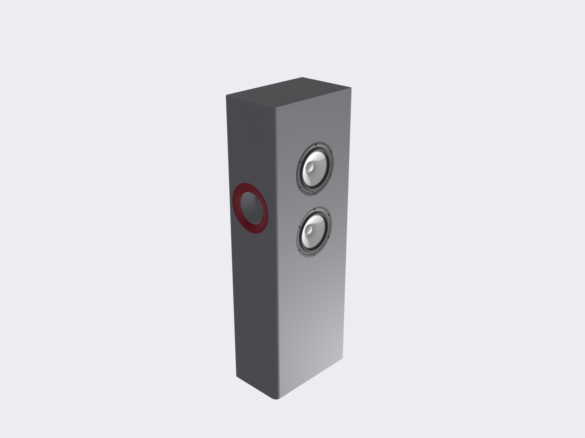

I'll just fire up this old thread, to ask a few question - if hopefully someone knows:
1. Does having 2 woofers on each side, help with dispersion control?
2. Would it help to use smaller drivers - like 4 6,5" woofers instead - controlling dispersion and ease filtering?
3. Would a driver from LS50 meta be a better choice, since it can be crossed a bit deeper and then easier be integrated with the side woofers?
4. Would it be easier to copy a KEF R7 or R700 with forward firing woofers?
I already have a set of KEF drivers from a R3 - which made wonder how to make the best of it.
Not according to kimmosto: (LINK)
I would consider something else than side woofers. For example WWCWW - just like Kef R11. With side woofers directivity index drops to zero or slightly negative. Baffle step exists to 90 deg, but not to 0 deg and 180 deg. Solution is slightly worse than normal (R11) and significantly worse than actual half space design i.e. flush-mounted wall speaker producing direct power about twice.
The general ROT for side woofers is to cross them over no higher than 125-150 Hz. The KEF LS60 crosses over at 350 Hz, but the woofers have been moved up to surround the coax. YMMV
It can if the woofers are used to create an interference pattern with the drivers on the front. The front and side drivers then both need to have overlapping frequency ranges where the directivity is wanted. Blade style speakers don't do that.1. Does having 2 woofers on each side, help with dispersion control?
An MTM of two woofers and coax on the front with a woofer or two on either side could do that, or a coax with a woofer or two below and woofers on the side.
Having 2 drivers on each side means that the fullrange/coax driver can be be between the centers of the 4 drivers. Creating a cylindrical waveform similar to a D'appolito configuration.I'll just fire up this old thread, to ask a few question - if hopefully someone knows:

I used 4 16cm SEAS woofers the same ones Sigfried Linkwwitz used in one of his designs. I think the nomenclature is L16SL (H1480). Since I did not have access to a Meta driver I used a Mark Audio MAOP 7 for the midrange onwards.
The sketch below is an older version. I decided to replace the port with 3 x SB15 5"x8" passive radiators on the rear of the speaker.
The sketch below is an older version. I decided to replace the port with 3 x SB15 5"x8" passive radiators on the rear of the speaker. View attachment 1235764
