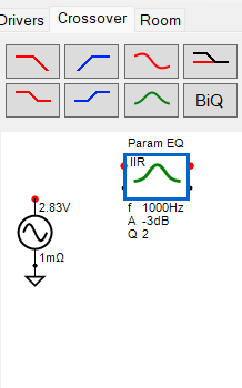

Hi where did you get hold of the ParamEQ block in Vituix? I can't find them on my copy?
The green button in the top left of the crossover tab for peak/notch filters

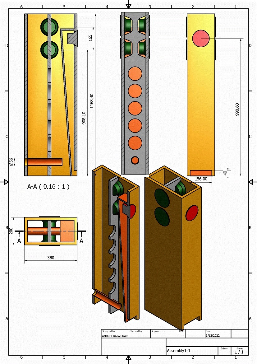

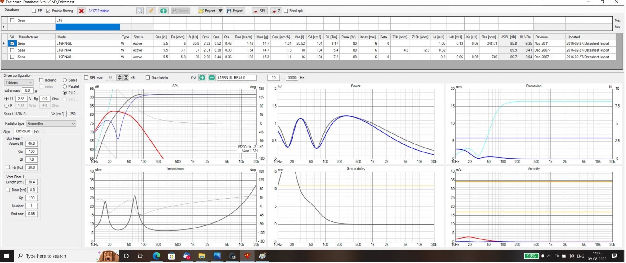

Not so long ago, I, too, ventured down this path. I don't have access to many drivers in India (only Madisound ships here), and the only coaxial I could lay my hands on was the SEAS C16N001. Eventually, I decided to use a full range (Mark Audio MAOP 7) instead of a coaxial. The other alternate I considered was the Tangband W4-1879.
https://www.markaudio.com/online_shop/7-cm/maop-7/
https://www.parts-express.com/Tang-Band-W4-1879-4-Full-Range-Driver-264-903
A rudimentary drawing of my concept is here. The final height of the drivers would be decided on by measuring my ear height.
https://www.diyaudio.com/community/attachments/driver-system-r1-jpg.1083575/

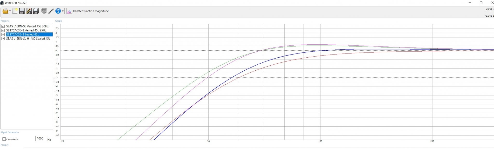

Since my cabinet is small, I could not find any 8" woofers that would
(a) have a depth that would permit 2 of them to fit back-back in 15cm
(b) give a response (without DSP) that is reasonably flat
I did consider the SB17CAC35-8, but Erin's review lead me to believe that the driver is not suited for bass duty.
https://www.erinsaudiocorner.com/driveunits/sbacoustics_sb17cac35-4/
Hence I chose the SEAS L16-RN/SL (assuming that Sigfried Linkwitz wouldn't have designed a bad woofer for his LXMini).
http://www.seas.no/index.php?option...icle&id=96:h1480-l16rn-sl&catid=44&Itemid=238
https://www.linkwitzlab.com/LXmini/Introduction.htm
Now I am waiting for the drivers and will start once the drivers arrive. I have included a Fountek NeoCD 1.0 ribbon just in case the MAOP7 does not offer adequate dispersion/extension above 10k.

I used 4 16cm SEAS woofers the same ones Sigfried Linkwwitz used in one of his designs. I think the nomenclature is L16SL (H1480). Since I did not have access to a Meta driver I used a Mark Audio MAOP 7 for the midrange onwards.
The sketch below is an older version. I decided to replace the port with 3 x SB15 5"x8" passive radiators on the rear of the speaker.
