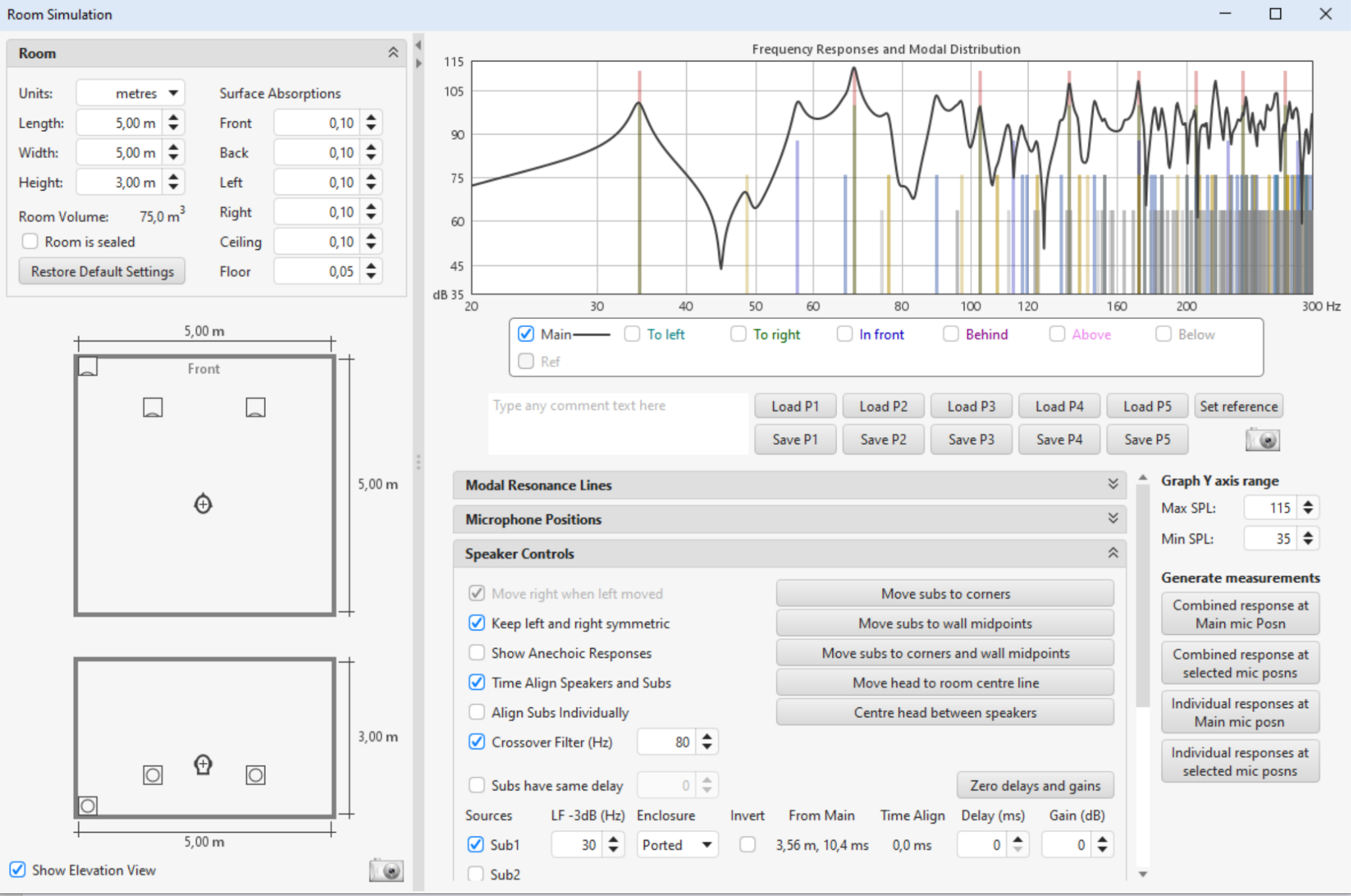

It is a living room measuring 5x5 meters with a height of 3. The current speakers are at a distance of 2 meters and 20 more or less from each other, and about the same from the listening point.
You're probably listening close to the middle of the room? The listening position in the center of the room can be a "null" point for certain low-frequency sounds, meaning there may be phase cancellations between the direct signal from the speakers and reflected sound waves. This can make the bass sound less impactful.I am looking for a speaker that returns more impact and dynamics
There are many room mode simulators, this is in RoomEQWizard.
I put the sub in the left corner, but the listener's head location is most critical. User can move speakers and mic/listener etc. parameters freely and see the response changing

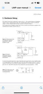

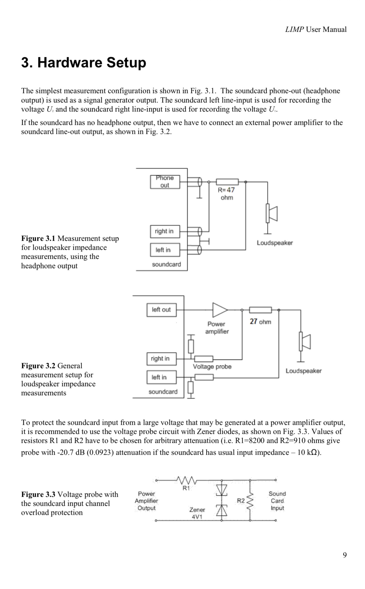

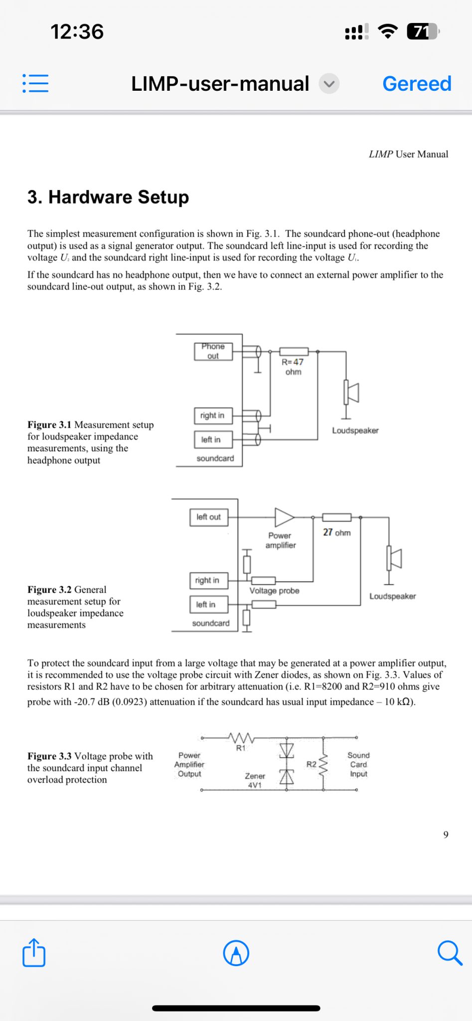

What is an impedance jig? and how is it made?
The LIMP manual (LIMP is part of the ARTA software bundle) shows it in its most simple and elegant way. It takes five resistors and a way to attach them to amp, soundcard input and Device Under Test. Alligator clips, banana plugs, cable and two 6,3mm jacks or two RCA plugs. No need for DATS or Clio.
