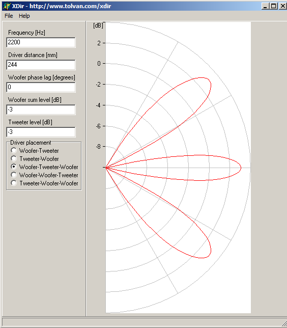

Directivity:
This refers to whether the speaker radiates sound only in one direction or in all directions. The degree of directivity generally changes with frequency becoming more directive as frequency rises (this can be seen in the manufacturers curves as the off axis measurements spl starts to drop away from the on axis level at higher frequencies, most manufacturers will show some off axis measurements, often at 30 deg and 60deg off axis. The other thing that affects this is the size of the driver. The bigger the woofer you go for (provided that you are aiming for a wide dispersion) the lower the frequency you will need to cross the tweeter over at. A lot of people end up going for a 6.5” woofer as a good compromise.
Generally you do not want to be crossing over in a range where the speaker is becoming directional; as it will affect how well the drivers blend together (you want a seamless crossover that doesn’t stick out). Another thing to look for is off axis curves that closely follow the on-axis curves just at a lower level. Wild variances in the off axis response indicate breakup and resonances which may cause undesirable sounds if they are too close to the pass band.

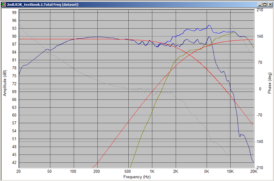

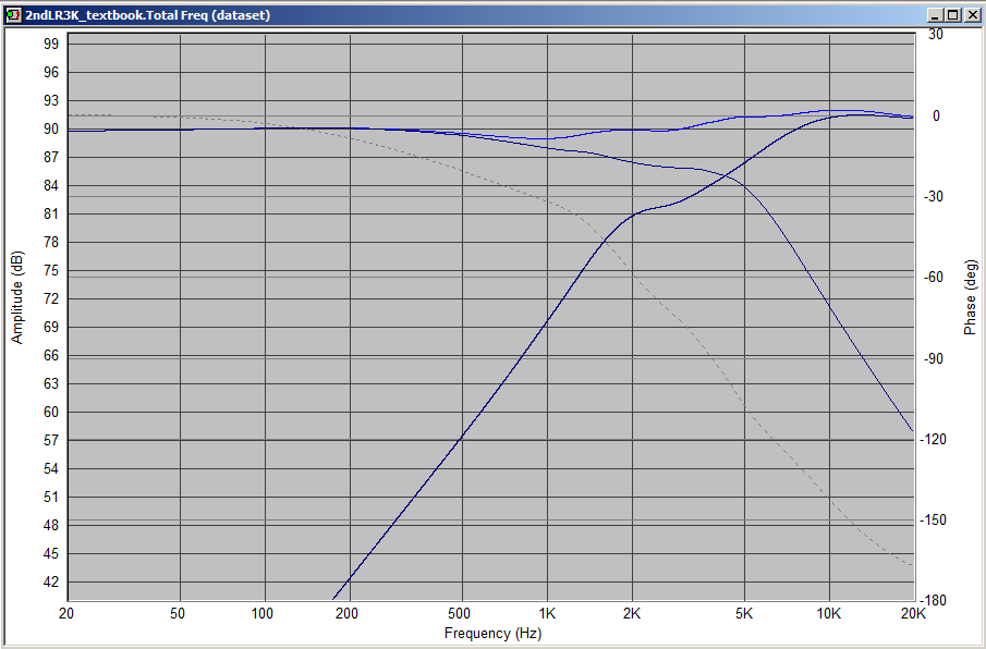

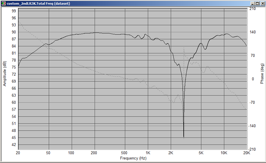

Frequency Response:
The two most important factors in predicting subjective listening preferences as researched by Toole are smoothness of on axis and off axis frequency response (I highly recommend reading this whitepaper by Toole "Audio - Science in the service of Art" ).
Drivers with wildly fluctuating response curves are best avoided. Note that sharp dips in frequency response tend to not be very audible, but peaks in frequency response (if not dealt with) do tend to be very audible. Also wide shallow dips or peaks are also a lot more problematic. When looking at manufacturers curves be aware that not all are taken under the same conditions. The easiest ones to compare are those that have been taken on an IEC Baffle. Note that a gently rising response should be much easier to deal with than something with sharp response peaks. Many drivers have "breakup peaks" in the region just before they run out of steam. Drivers with very rigid cones such as metal coned drivers tend to exhibit more severe breakup peaks. These peaks are caused by resonances in the cone. They can be dealt with with notch filters but you are best crossing over way below these peaks, and drivers like this are best avoided if you are doing your first crossover design.

Crossover Frequency:
What crossover point am I aiming for?
This is an important question when it comes to driver choice as it will have a big impact. Perhaps a better question is “Do I care what the crossover frequency will be?” For a lot of people this is absolutely critical and they have very strong beliefs as to where it should be. Me personally? I think that as long as you do a good job of it, it shouldn’t matter too much where it is 😀 That aside you need to choose drivers that will not be misbehaving because you are trying to cross them too low or two high. In the case of tweeters, if you cross them too low you will get high distortion. In the case of woofers if you cross them too high you may have problems with breakup peaks, and increasing directivity (which depending on your other design goals may or may not be a problem).

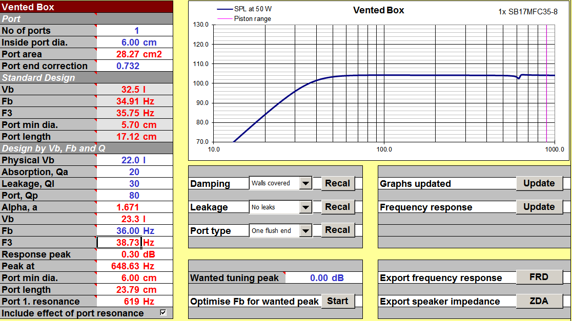

SO without further ado, I’ll show some sims of a driver I found, that fitted most of the criteria I’ve mentioned thus far. It’s an SB acoustics SB17MFC35-8 6.5" Poly Cone Woofer. It does have a broad peak from about 3K to 8K but hopefully it won’t be too hard to deal with.
As celef has pointed out in the discussion thread, a simulation is only an approximation and there is no substitute for actually building and measuring a box. A simulation is a good starting point and if you have the time and resources available, building a prototype before committing to your final build is always a good idea! This page from Troels is worth a read if you are planning to do a bass reflex enclosure vent tuning
As mentioned I use Unibox for doing simulations so the following graphs are produced with unibox. You can of course do manual calculations, lookup tables or whatever other method you want to arrive at your box volume, but I like to simulate.
Pretty much all simulation programs give you recommended alignments, but you do not have to use them! They make a good starting point, but you have quite a lot of latitude when it comes to the final design. You can try trading off size and extension to suit your needs. At some point you will find that going too far makes the compromises unworkable.
Unibox suggests a vented enclosure for the SB driver, with a “Standard Design” being a 32.5L box with 34.9Hz tuning. Note that I always model with 0.2 ohms of series resistance, as this is a little more realistic than having zero resistance wires between the amp and the speaker. It DOES make a difference to the modelling.
Below are a series of plots for close to the recommended volume and also for a reduced volume (let’s say 32L was bigger than we wanted for our project).
The parameters used for the two sizes of box are shown below:
729678d1437374089-designing-speaker-scratch-images-thread-vented_31l_params-png
First the 31L box
729679d1437374089-designing-speaker-scratch-images-thread-vented_22l_params-png
Then the 22L box.

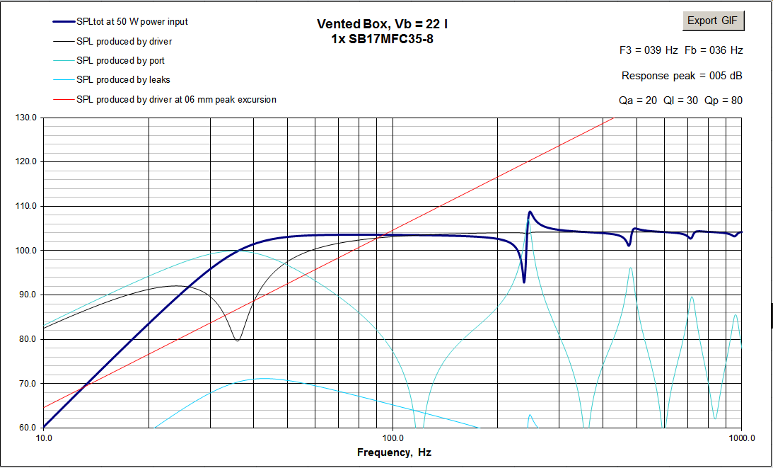

UniBox produces a lot of plots other than just spl which are available under the Closed Box tab and vented box tabs. The main ones I concentrate on are the SPL graph, the excursion graph, the port air speed graph, and the step response graph. These are good graphs to look at to see how the various compromises we make can affect the overall design. First the approx. 33L recommended box is shown, and then some comparisons of a smaller 22L vented box. Note that as I added lining on the walls of the enclosure I went with a 31L box (which has effective volume of around 32.9L)

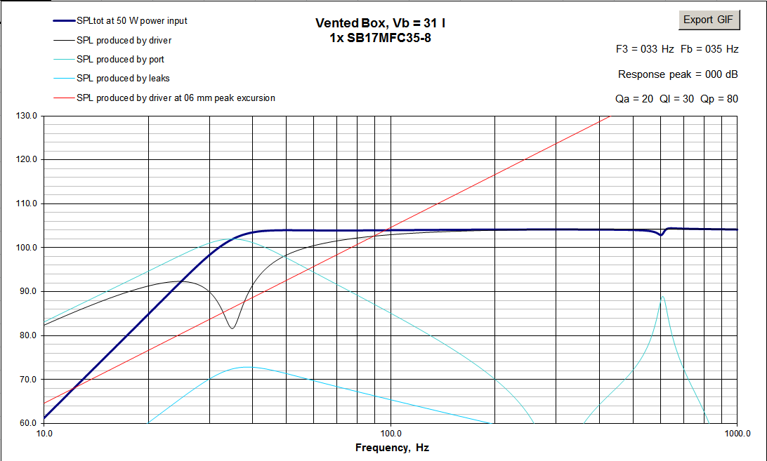

729680d1437374089-designing-speaker-scratch-images-thread-vented_31l_spl-png
The above graph has quite a lot of information in it. The SPLtot is the main thing we are interested in. but it is also interesting to look at the other things that combine to create this “theoretical” final SPL. Note the dip around 600Hz which is a result of the port resonance. For a design where the port resonance will be in the passband of the driver you want to try and minimize it*. This is one of the trade-offs. A low tuning, or a big diameter port will tend to create lower (and bigger) port resonances. More on this a bit later.

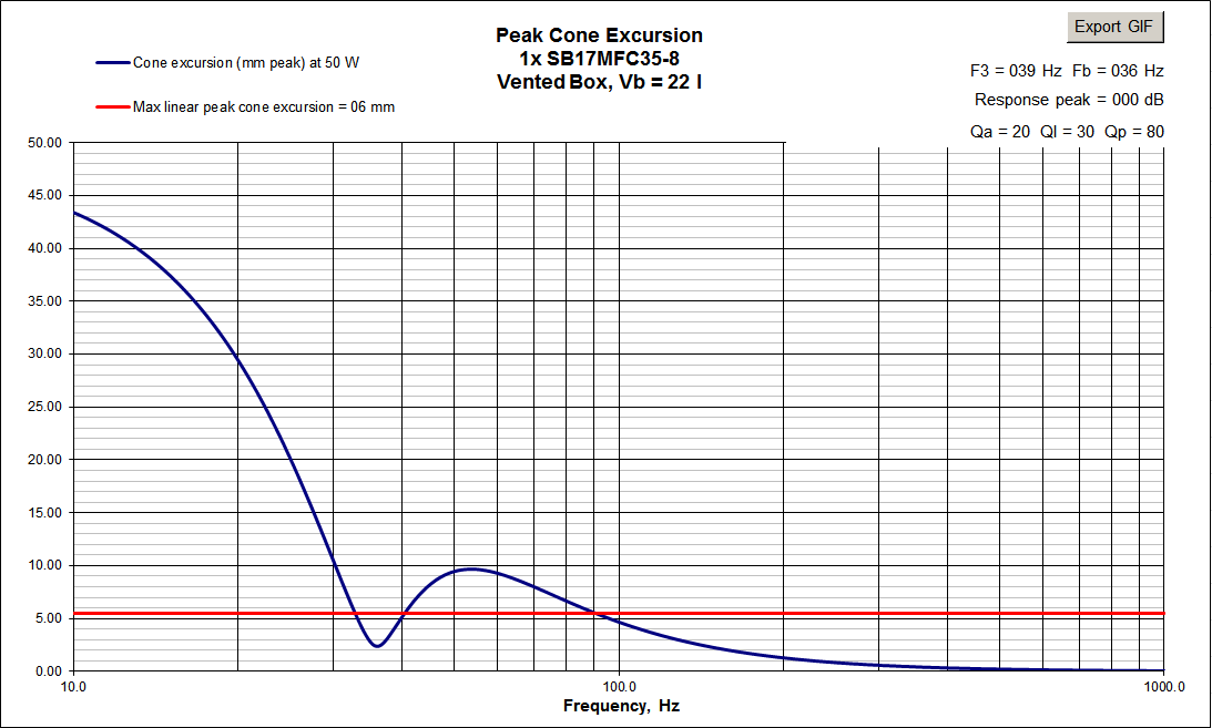

729682d1437374089-designing-speaker-scratch-images-thread-vented_22l_excursion-png
In comparison here is the excursion of the 22L enclosure. You can see that the power handling is slightly better. Note that different drivers will show bigger or smaller differences in power handling when changing things like box volume and tuning frequency.

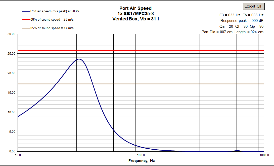

Next we will take a look at the port air speed graph.
729683d1437374089-designing-speaker-scratch-images-thread-vented_31l_port-png
This graph shows the port air speed with 50W input. If the 8% line is exceeded then you may hear chuffing noises from the port when driven hard. The best way to reduce the port air speed is to increase the diameter. This will have the effect that the port needs to be longer to achieve the same box tuning, and the port resonance frequency will be lower and generally of higher amplitude, thus it is necessary to find a balance. The smaller the box volume the more tricky it is to get this balance.

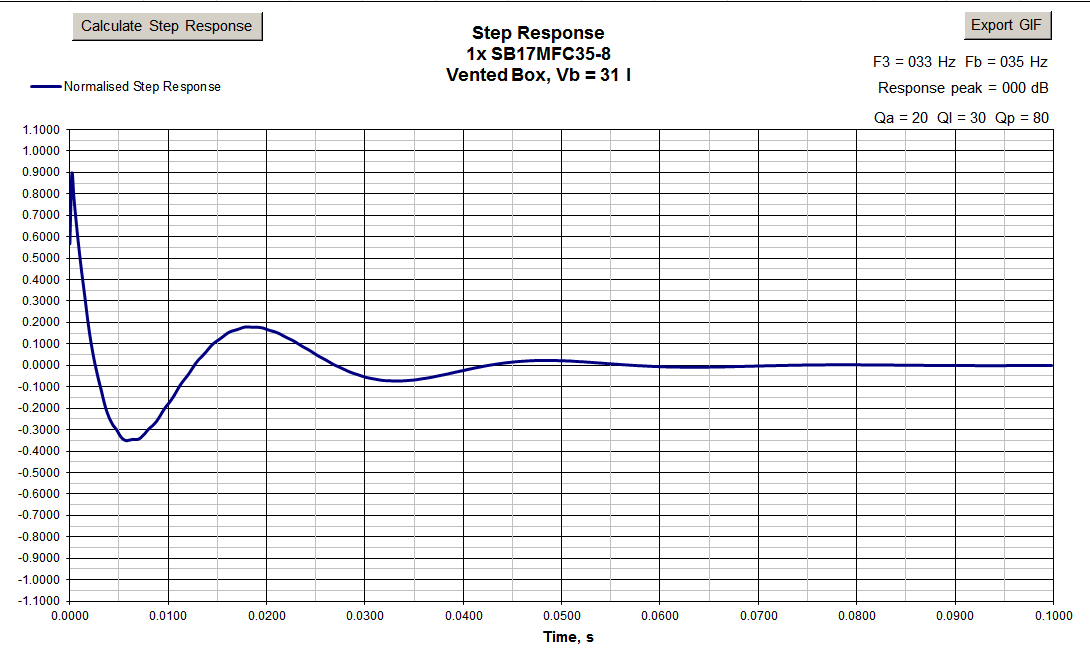

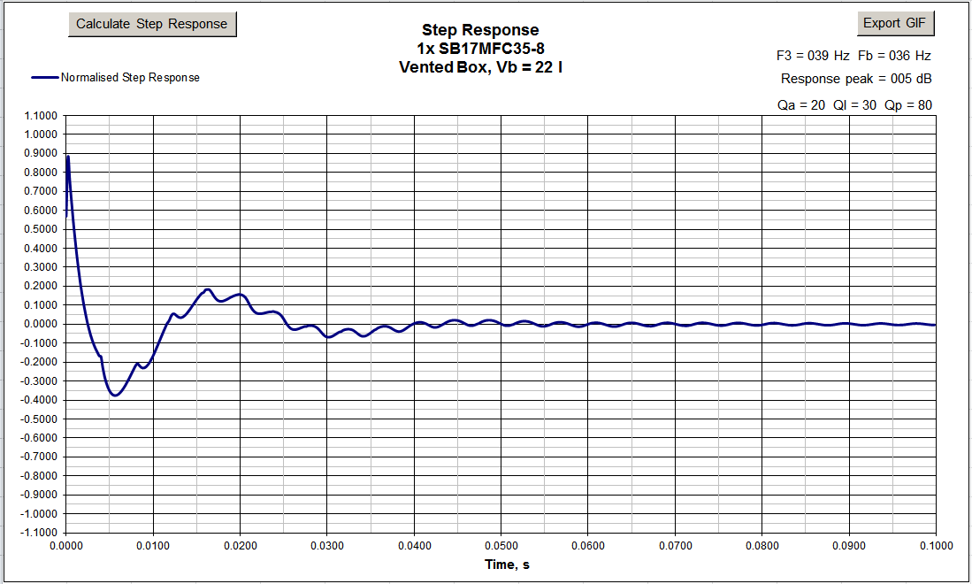

729684d1437374089-designing-speaker-scratch-images-thread-vented_31l_step-png
Finally we have the step response. This shows us how quickly the driver cone returns to rest after an excitation signal is applied. The other thing that will show up here is port resonances. These will show as a smaller ripple superimposed on the main Step response. You can see a very small amount on the graph above. Once again we see our trade-off’s here. Below is a comparison of the same driver in a 10L sealed enclosure to show the difference in step response.

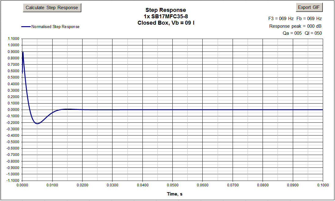

729685d1437374089-designing-speaker-scratch-images-thread-sealed_10l_step-png
The tradeoff with the sealed alignment is much poorer bass extension, as can be seen in the next graph.

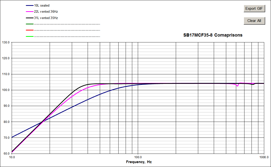

729686d1437374089-designing-speaker-scratch-images-thread-comparison-png
The above shows our modeled drivers spl with three different configurations. A 10L sealed enclosure, 22L vented tuned to 36Hz and 31L vented tuned to 35Hz. It helps to demonstrate some of the trade-offs, the step response graph below shows some more!
729687d1437374089-designing-speaker-scratch-images-thread-step_comparison-png
Note that unibox cannot superimpose step responses like the above. This has been done in Photoshop to demonstrate the difference between the three alignments. You can see that the sealed has the best step response, and that the smaller box has a slightly better step response than the bigger one. When looking at the spl graphs as well we can see that our bass extension is at the expense of step response.
One thing I didn’t go into above is how I arrive at the tuning frequency when changing the box volume. Basically I just increase or decrease the tuning frequency until I find the point where the F3 stabilises, and then choose the lowest tuning frequency that achieves that F3. The range of tuning frequencies that will achieve a given F3 will vary from driver to driver, but could be from a few 100 mHz to a few Hz. Note that this is just what I do. It is not the conventional method. There are conventional alignments for Bass reflex. Do a google search and you will find alignments like the butterworth and BB4, in reality there is a continuum of alignments which a box modelling program allows you to explore.
Just as a final comparison Below are a couple of graphs where the only thing changed was the port diameter (and length).
729688d1437374168-designing-speaker-scratch-images-thread-22l_big_port_spl-png
729689d1437374168-designing-speaker-scratch-images-thread-22l_big_port_step-png
This is an extreme example where I increased the port diameter from 60mm to 100mm whilst keeping the box tuning the same. However this shows how going with a bigger port (to reduce the chance of chuffing) can have an adverse effect on other areas. It also demonstrates that if you are simulating without considering port resonances you may get a nasty surprise! The other thing worth mentioning is that the port length increased from approx 24cm to approx 70cm!
After doing simulation such as the above we may decide that the driver is just what we need. However depending on what our design goals were, we might find that what looked like a good candidate is not such a good choice after all. This is why it is important to get an idea of how a particular driver will perform before making the purchase. From the above sims we can see that this driver should be good for relatively low power applications and is quite suitable for cabinet volumes between 22L and 35L much smaller and the driver starts to peak (note I did not show the effects of this above).

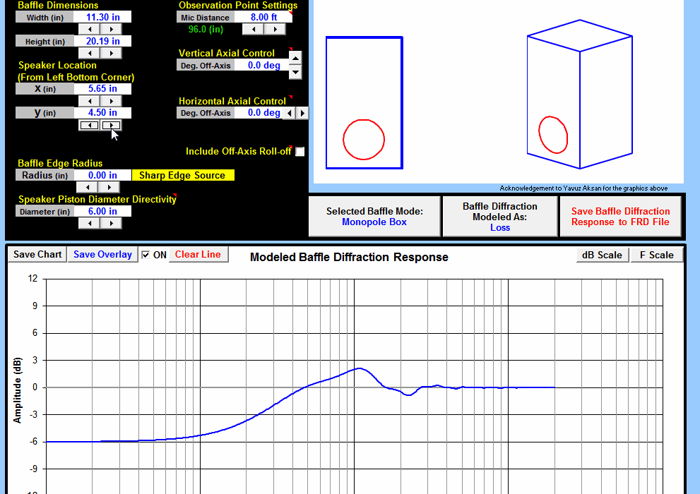

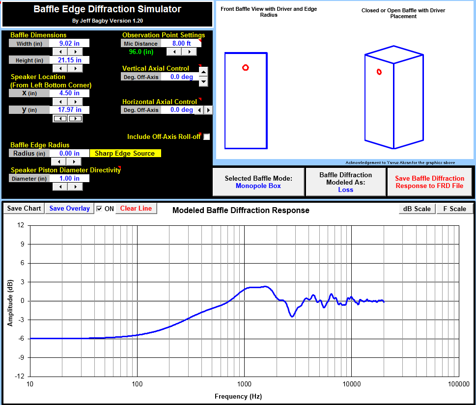

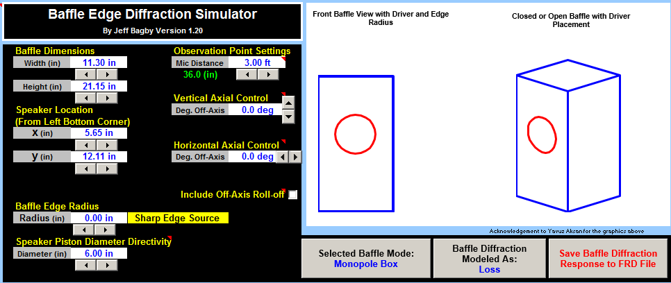

Step 3b simulating baffle step.
So you have simulated the driver in an enclosure and are happy that it will perform to your requirements, you’ve decided to purchase and now you are going to build a box right? Well there is another thing that you need to know about, and that is baffle step.
At its most basic, baffle step is the phenomenon that occurs as the wavelength of the frequencies being reproduced approaches the dimensions of our baffle. For frequencies much shorter in length than our baffle dimensions the baffle effectively appears to be an infinite baffle. However once we start approaching the baffle dimensions the sound stars to wrap around the baffle and we no longer get the re-enforcement to the sound wave that the baffle provides. There is a transition from full reinforcement down to no re-enforcement which shows a gradual 6db drop.
As usual it’s not quite that simple. In reality we have peaks and troughs in the response as well which can wreak havoc with our Frequency response. In the worst case you may get a dip at a frequency where there is already a dip in the driver. If we are savvy we may in fact be able to help fill in a dip in the driver’s response with a peak in the baffle step response! A much more thorough explanation + a simple circuit that can be used to deal with basic baffle step at line level is available here Baffle Step Compensation
For this reason I highly recommend that before you finalize your cabinet design you perform some simulations to find out what effect on the frequency response your baffle dimensions will have (and how they will help or hinder your choice of driver). We may be jumping the gun here a bit, so you may also want to read the next section on cabinet design in conjunction with this section.
There has been a trend towards having very narrow cabinets. This may be due to aesthetics, but I have also heard (but do not know if it is true) that narrow cabinets are better for imaging. Unfortunately Narrow cabinets also appear to be the worst for producing large peaks and dips in the response.

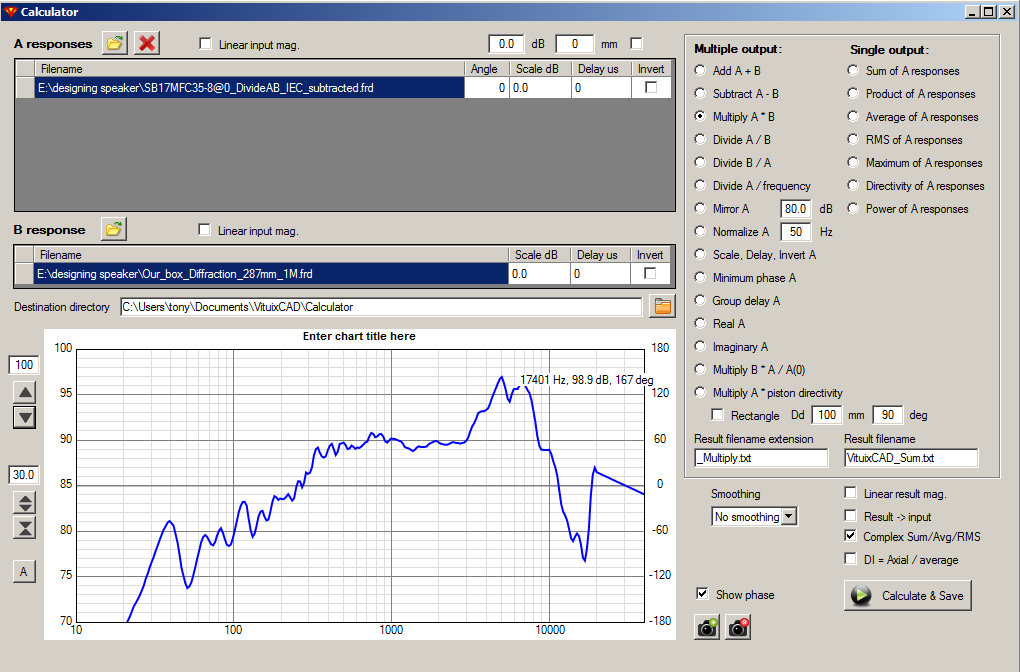

There are a number of programs available that allow you to simulate baffle step. I will list a few below:
Tolvan data's The edge
Jeff Bagby’s Baffle Difraction and Boundary Simulator spreadsheet
Jeff Bagby’s Frequency Response Modeller spreadsheet
The FRD consortiums Baffle Diffraction Simulator spreadsheet (works with complex baffle shapes)
Kimmo's Vituixcad Which is a full blown speaker design package.
  • The edge is probably the easiest to use to get an idea of what the effect (on a flat response) the baffle geometry will have.
  • The FRD consortium spreadsheet is able to simulate complex baffle shapes but is also quite difficult to use.
  • Jeff's Baffle Difraction and Boundary Simulator spreadsheet has the added benefit of allowing you to model boundary reinforcement effects as well as the baffle step (ie to some degree how the speaker will perform in your room).
  • Jeff's Frequency Response Modeller spreadsheet has the added benefit that you can take an infinite baffle frequency response file and model how it will be effected by the baffle geometry.
  • Kimmo's Vituixcad includes crossover simulation with off axis measurements. See the documentation for more info.

I have worked out the dimensions of a box that will have our 22L nominal enclosure volume. This actually highligts a very important aspect that perhaps needs mention in the previous section on simulating the box volume. After additional volume for the speakers, port and bracing are added the box volume increased around 20%. I decided to go with 18mm ply and when we take the wall thickness into account our overall volume increases by a whopping 50%!! our 22L (internal volume) box has become a 33L overall volume box.
The overall external dimensions of the box are: 513mm X 229mm X 287mm This is using a prime ratio of 487:197:293 (or 2.472:1:1.487) This should give an asthetically pleasing box and we have the flexibility of using either the 229mm or 287mm dimension as our baffle width. We will model both in one of the baffle step modeling apps and see what we get.
Below is an animation of the changes in baffle step response with the driver moving up the baffle in the vertical plane. Jeff Bagbies Baffle Diffraction and Boundary simulator spreadsheet was used. You can see that depending on the placement the dips and peaks change quite a bit.
729690d1437569489-designing-speaker-scratch-images-thread-baffle_diffraction_demo-gif
This gives us a pretty good idea of what sort of response anomalies the baffle is going to introduce. If we want an even better idea, we can spltrace the manufacturers curve and import it into Jeff's other spreadsheet the frequency response modeler, this may help us to fine tune the response to avoid worsening any natural dips in the drivers response or accentuating natural peaks. If we are really lucky we may be able to compensate for them.
Note that we can move the driver off centre as well and this will also have an effect on the baffle diffraction (usually smoothing it out). There are trade-offs (as usual) in doing so, in that you will not get symmetrical off axis response. The baffle step can be dealt with (including humps) in the crossover, off axis irregularities will be best dealt with using room treatment or speaker placement. If you are considering non-central positioning of the drivers it would pay to do some research on what the pros and cons of doing so are.
Lets keep this thread uncluttered, A separate Designing your own speaker from scratch discussion thread has been created.

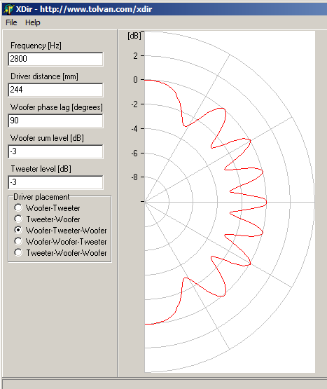

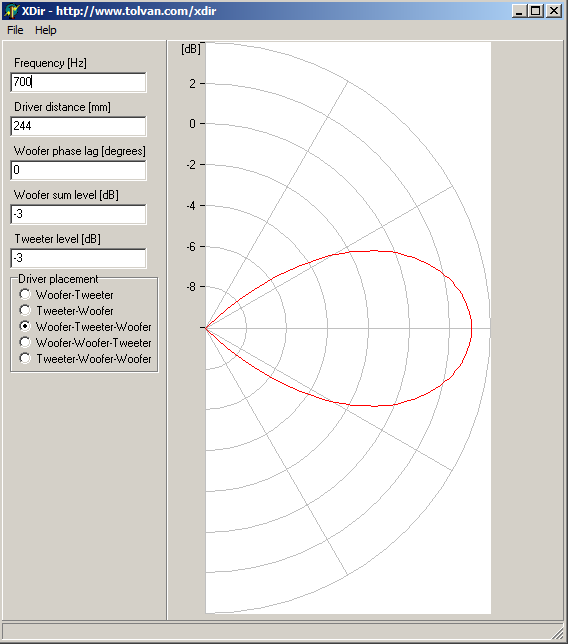

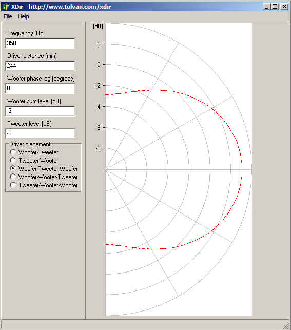

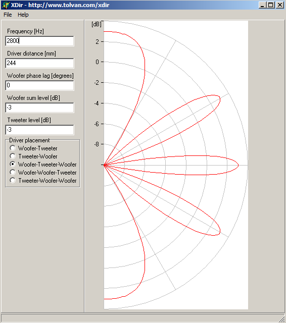

I recently became aware of another tool for simulating vertical polar response. The tool is Xdir Tolvan Data
The simulation is simple but gives a very good idea as to the effects of different placement of speakers on the baffle, how centre to centre spacing affects the polar response, and how phase tracking also affects the polar response.
Below are some images that show the simulated polar response of my own MTM. The first is as it was actually implemented.
You should be able to see from the parameters in the input to the sim the differences. The 5th plot with 90 deg difference between the drivers is interesting!
The 6th plot shows an TM implementation to give an idea of the difference between an MTM and TM implementation as far as vertical polar response goes, if "traditional" higher crossover points are being implemented.
Note that when I modeled these I had -3db summing, but my actual implementation is 4th order bessel acoustic with -6db summing. In reality this only makes a magnitude difference on the graph.
The 7th plot shows the TM with 90 deg phase shift, this demonstrates the often mentioned "tilt"
I'm not 100% sure about the CTC spacing in this tool when it comes to MTM's so I'm a bit hesitant to rely on it (I can't tell if you are supposed to enter CTC one woofer to tweeter, or CTC between the woofers... obviously the results are quite different depending on which you do!!
Oh well. I thought it interesting just the same 🙂 This post will likely get edited in future.

OK now that we have thought about all of the above lets get down to brass tacks. Is there anything else we need to think about? Yes!
What volume will things like the drivers themselves, the ports(and it is the entire volume of the port that needs to be considered), the bracing and the crossover (if going passive) take up inside your cabinet? The volume of all of these things needs to be estimated and added to the volume that was determined in our earlier simulation step.
Will we have any issues with things like pipe resonances? A tall skinny cabinet may have undesirable resonances that will affect it’s sound, unless you are designing something like a Mass Loaded Transmission line (ML-TL) This is a subject unto itself but if you are interested in persuing this then the following link will be helpful Transmission Line Modelling Software - diyAudio
OK so we have worked out how much extra volume we need for other things that will be in the box, the simplest way to get to an actual box design now is to use a tool! A couple that I know of are:
boxycad available for download at Charlie Laub's site http://audio.claub.net/boxycad2.xls
boxsim (this is more than just a box design program) Page not found | Visaton
boxnotes Boxnotes - Free Speaker Design Software
I've not used any of these in the past (I've done it the hard way, with a pen, paper and calculator. What you need to keep in mind is that it is the internal dimensions that matter for vour volume!
The last speaker I designed I ended up using some 3D cad software to do the plans for the box itself (after first having done it on paper), though you can of course use pencil and paper 🙂 I used this excellent program http://www.ptc.com/cad/elements-direct/modeling/express

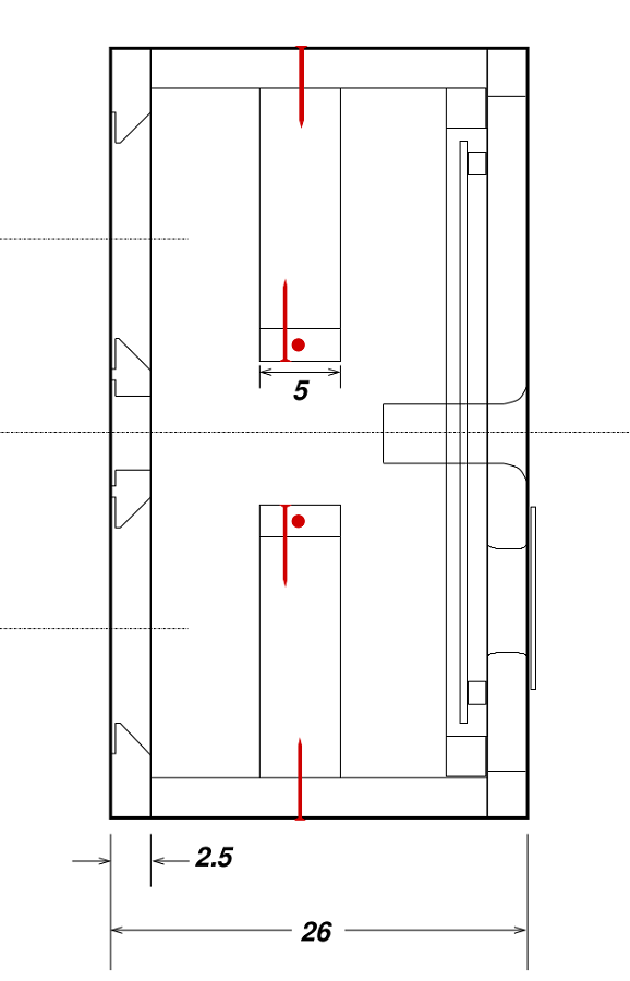

We will start with one example: a floor-stander MTM design built in the early 2000s. The drawing below shows its external shape and size (dimensions in centimetres).
734545d1549535299-designing-speaker-scratch-images-thread-plan-png
As you can see, it's a big rectangular box. Its insides is a different story. The drawing below shows a cutaway view of the internal bracing.

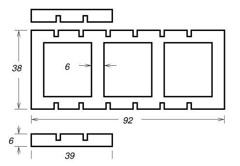

The drawing below shows the sizes and shapes of the ply sheets used to make the bracing (ignore the piece at the bottom of the drawing where a tube is fixed to a square piece of ply -- that was used for the ducted port for this speaker -- it's not part of bracing.)
734547d1549535299-designing-speaker-scratch-images-thread-exploded-png

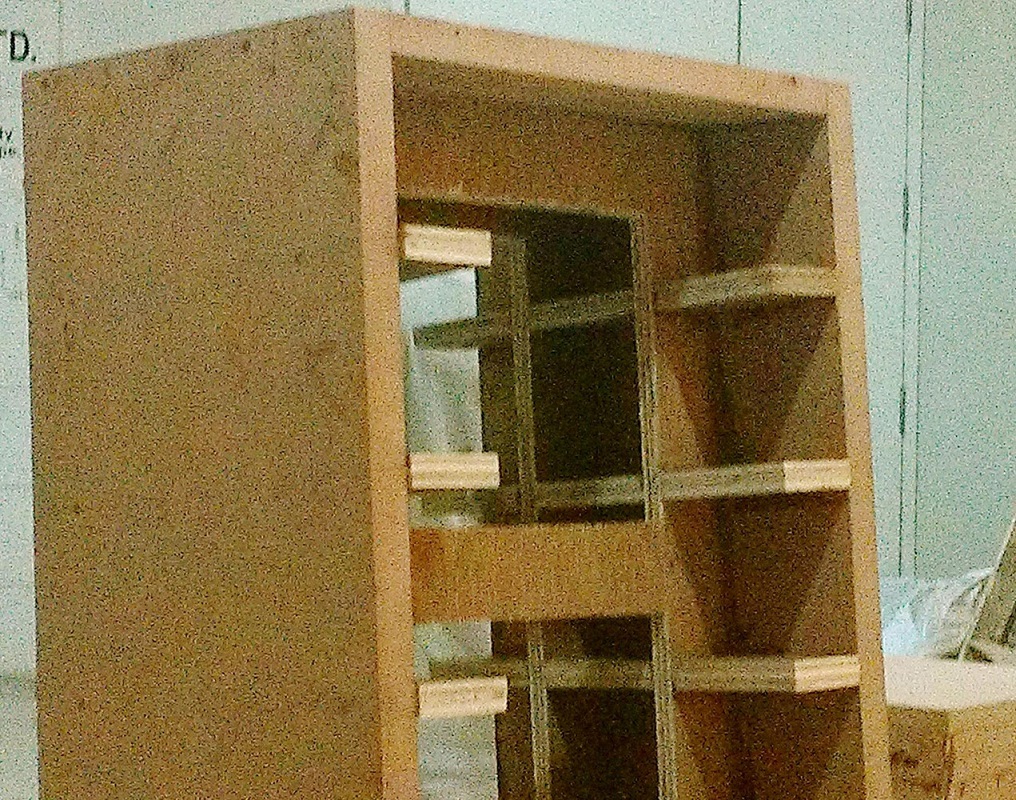

Below is a photo of the half-complete enclosure with the internal bracing fitted:
734548d1549535299-designing-speaker-scratch-images-thread-box-braces-2_0-jpeg
In the photo above, the front and rear baffles are yet to be fitted. This allows the carpenter free access to assemble and fix complicated internal bracing very tightly. The front and rear baffles are fixed last.

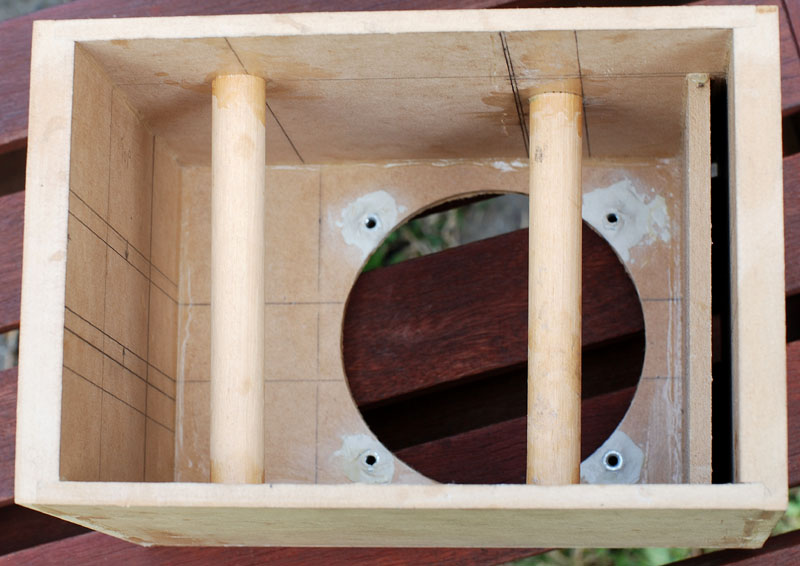

Another small speaker I created I used dowel for bracing. This is supposed to be for nearfield (computer) listening. The box walls are very thin.
364640d1375879544-sb-acoustics-sb12mnrx25-4-range-build-thread-dsc_3350-jpg
The tricky thing with this was getting the dowel the right length! 🙂

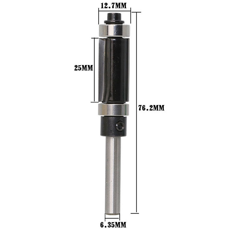

You need just four bits, strictly speaking, for speaker building:
  • a straight bit, at least 35mm or 1.5" long, to do straight cuts (cutouts with vertical walls)
  • a bottom-cleaning bit of at least half-inch diameter, to cut recesses for speaker mounting (so that the speaker flange will mount flush with the surface of the front baffle)
  • a 45-degree bevelled bit of 1" height (2" bit diameter) so that you can slope the sides of the cutout for your midrange drivers from the inside (more on this below).
  • a 1" roundover bit, with 1" height and 2" bit diameter, to do rounding of the edges of the front baffles.
This is it. You will get straight bits with a ball-bearing at the bottom end. Don't buy those. Buy the bits whose blades go right to the bottom. See router bits you need, below for pictures of the bits.

Router bits you need
A router is essential for building good speakers.
No one taught me how to use a router, which router to buy, and what bits I need. I learned all of these by buying these things, trying them out, realising my mistakes, and wasting time and money. I actually bought two routers before I stabilised on my current (third) one. So, this post may help save your time and money.
Buy a router with a half-inch or 12mm shank specification, as I had said earlier. The bits you need are exactly four, and are shown below. I buy all my bits from reputed sellers on eBay and I've never had a lemon in my track record of at least 12 bits so far.
The straight bit
You need one bit like the ones below, with blade length at least 50% longer than the sheet thickness. My sheets are 25mm, so I use straight bits with at least 40mm long blades.
734555d1549535598-designing-speaker-scratch-images-thread-bit-straight-jpg
Note that the bit above does not have any ball bearings. The photo below is of a bit with a ball bearing at its tip. Avoid those. They cannot be plunged into the sheet -- they need you to drill a leader hole first before they can be inserted. This slows you down.
734556d1549535598-designing-speaker-scratch-images-thread-bit-straight-ballbearings-jpg
Note that straight bits are tall and slender like the Girl From Ipanema, and therefore they break. This is the only type of bit which breaks during use. Keep one or two spare bits.
The bottom cleaning bit

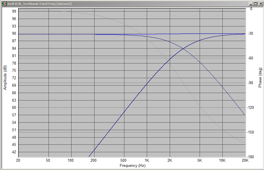

Lets see what happens with our theoretically flat speaker with a completely flat impedance using our text book crossover. For this we have two speakers which are both 90db efficient, completely flat and have a completely flat 8 ohms resistance. Now if you had such drivers you wouldn't be making a crossover in the first place, but it serves to demonstrate what is happening.
The schematic is for a textbook 2nd order linkwitz riley crossover at 3Khz. Calculated using this online calculator Speaker Crossover Calculators by V-Cap
attachment.php
The graph is showing the summed response of the two drivers and the rolloff of each driver. See how wide the range is where it is both drivers that are summing together to make the flat response (It's almost from 200Hz through to 20Khz)!
attachment.php
Note how there is a step in the frequency response. This is due to the resistance inherent in the inductor which is in series with the woofer. For this sim I used 0.29 ohms for the DCR of the coil. It is not too significant but it does show that even with our perfect drivers we have not got a perfectly flat result with out text book crossover.

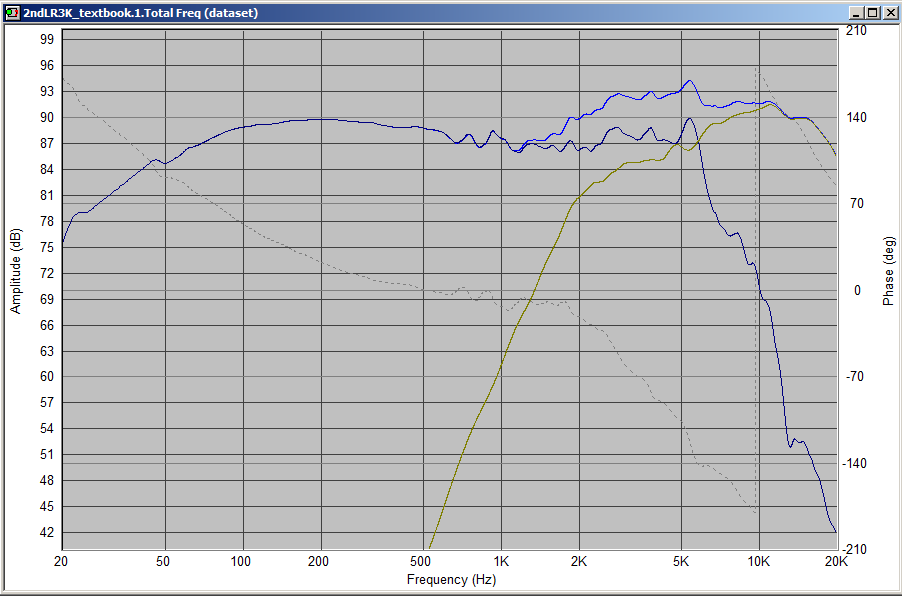

Next we will show what happens if we use actual impedance curves for real drivers (but still with our perfectly flat frequency response). I've chosen a Dayton RS150P-8 for the woofer and a Morel DMS37 for the tweeter, as I happen to have frd and zma's for both. Everything is the same except for the real-impedance curves being used in the sim.
attachment.php
Whoah!! What happened to our nice flat response!! Textbook crossovers only give a text book response with a flat impedance, which the above demonstrates very well 🙂. Now it is possible to greatly improve this by using impedance compensation on the drivers, but that is not necessarily something you need to do as you will see later when we do a more optimal crossover.
So now we add in the real responses of the Dayton and Morel drivers and see what we get.
attachment.php
Probably not really what we want! So you can see that if we just used our text book crossover with our two new drivers, that we would likely have a bit of a tweaking job on our hands!
Note that even the above is a very crude estimate of what would really happen, as we have not taken into account how the baffle effects the frequency response of our drivers, or how differences in driver offset on the baffle affects their phase relationship to each other, in reality the above probably looks even better than it would in real life!

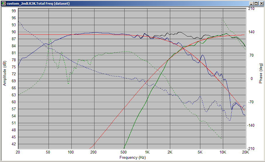

One of the things that people starting out with crossover design fail to grasp is that it is the acoustic rolloff of the speaker that is the real goal not the electrical order of the filter. When we say we want a 2nd order linkwitz riley crossover, that doesn't necessarily mean that it will be an electrical linkwitz riley filter (for newbies I would actually suggest that a fourth order LR or bessel filter is much more likely to give them results that they will be happy with, 2nd order acoustic filters are not easy!) After having said that, what I come up with later, does appear to be a 2nd order electrical filter on both the woofer and the tweeter, but it doesn't always have to be. When doing 4th order targets I have achieved it with 2nd order on the woofer and 3rd order on the tweeter, it all depends on the drivers and the frequency you cross them at.
We can demonstrate this concept by adding some target slopes to the third graph. The red lines in the fourth graph are our target 2nd order L/R at 3Khz. These show how our speaker should roll off to get the best blending (assuming we also get the phase right, but more on that a bit later).
attachment.php
As can be seen the drivers are not following the target curves very well at all and the resulting frequency response is pretty awful. I'm sure if you got a result like this you would not be happy and wondering where you had gone wrong! We would be looking at quite a lot of tweaking by ear to sort out this mess, and without actually knowing whether it was the woofer, the tweeter or both that is causing the issue we would be stabbing in the dark.

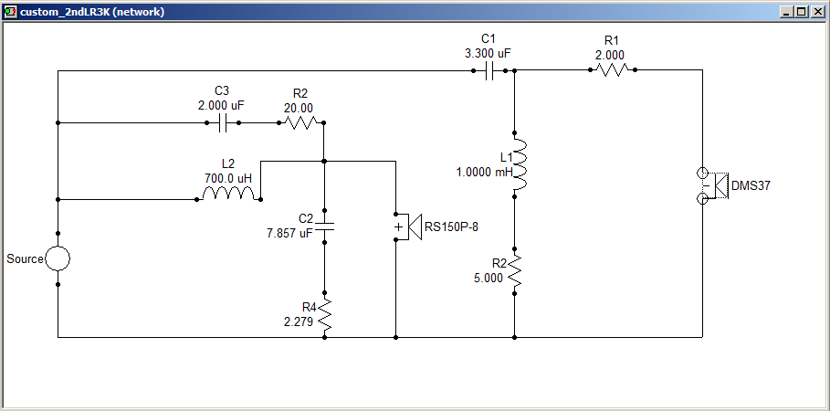

The new circuit is below:
attachment.php
You can see that there has been a few additions, and also changes to values from our original textbook crossover. I used the optimizer on C2 and R4 which is why they have strange looking values, I would normally change them to the nearest standard value but was being lazy.

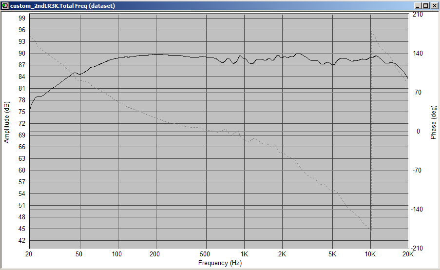

Below is the resulting frequency response using this new crossover.
attachment.php
Looks quite a bit better doesn't it?
Next is the reverse null response which shows how well (or not) the drivers are in phase at the crossover frequency.
attachment.php

I'm going to use vituixcad and Jeff Bagby's Baffle diffraction Simuator spreadsheet for doing these steps. We will use the SB17-MFC35-8 that we traced earlier and an SB26STCN-C000-4 tweeter which I have chosen simply because I like the look of it for a not too expensive tweeter.
Now depending on how far you want to take things, we can in fact subtract the IEC baffle response (both SB drivers were measured on an IEC baffle) before we apply our own baffle effects to the measurements. It's an additional step but if you want the highest accuracy it is probably worth doing. If you just want to get a ball park idea how the drivers will go in your design then you can probably skip it (Note that that comment should not make you think that this method is super accurate, but it is better than using the raw manufacturers curves).
Now something I wasn't aware of is that the IEC baffle is not a fixed size but in fact varies depending on driver size. From what I have been able to find it seems that for drivers smaller than 8" it is the same size, but for drivers bigger than 8" it scales up in proportion to the baffle dimensions for the 8" driver. I've done a spreadsheet (attached) which calculates the baffle dimensions and offset for the speaker based on this info I found from the IEC paper on the subject.
732109d1548629677-designing-speaker-scratch-images-thread-iec-baffle-jpg
Putting the baffle dimensions for 8" speaker into Jeff's spreadsheet and changing driver diameter to 6" and measurement distance to 12 inches (to match our 6" SB driver and measurement conditions) We have the below:
732107d1548629677-designing-speaker-scratch-images-thread-iec_baffle_setup-png
732108d1548629677-designing-speaker-scratch-images-thread-iec_baffle_diffraction-png
We can save the above diffraction curve and subtract it from our manufacturers measurement to get a true infinite baffle response. However we need to scale the measurement first as we need it to have a zero db reference, and the frd file produced by the baffle diffraction modeler changes the loss if the distance is under 1M. This is necessary because we are going to use divide and multiply functions to subtract our IEC baffle and add in our own baffle, and they need to be at the same baseline or it will mess up our results.
Vituix cad has a calculator menu under tools. We can load our IEC baffle diffraction into slot A in the calculator (you will need to adjust the y axis to show the curve as it is under 0db) when we do this we can see that our measurement is centered on -5db (see below)
732117d1548635548-designing-speaker-scratch-images-thread-baffle_loss_calcualtor-png
We can now delete this from slot A as we know we need 5db of offset, which can be applied in the scale db box above the measurement. We actually want to load our baffle diffraction file into slot B, and our manufacturers curve into slot A. We will have to readjust the Y scale again when we load our manufacturers curve.
732118d1548635985-designing-speaker-scratch-images-thread-subtracting_iec-png
The image above shows our manufacturer curve loaded and the IEC baffle subtracted from the response. The difference is quite subtle, but will be more pronounced if the manufacturers curve you are using was measured at a distance of 1M (and you used that distance when doing the baffle sim). It's not intuitive, but to subtract a response you do not use the subtract function, you use the divide function.
We can now save this modified response curve using the calculate and save button. Pay attention to the dialog box that pops up, it tells you where the frd was saved! You will probably want to copy it somewhere more convenient (and rename it to something that you know what it is) as next time you do a calculation it may overwrite what you have just saved. We will use this just saved response curve for applying our proposed baffle response to.
We now need to calculate the baffle diffraction effect of our own baffle. For this I would recommend setting the distance at at least 3ft (1M) as it will give us a more realistic diffraction (unless you are designing nearfield monitors). Back in the first baffle step post (post #6) we came up with a box with dimensions 513mm X 229mm X 287mm I've done sims with both 513H X 287mm wide, and 513H X 229mm wide, I'm leaning towards the narrower baffle, as the response peak is lower with the narrower baffle (which was a bit of a surprise).
732135d1548643680-designing-speaker-scratch-images-thread-our_baffle_287mm-png
732136d1548643680-designing-speaker-scratch-images-thread-our_baffle_287mm_loss-png
This is the baffle effect for our 287mm wide baffle. As you can see when this is applied to our manufacturers measurement it is going to look quite a bit different.
732137d1548643680-designing-speaker-scratch-images-thread-our_baffle_229mm-png
732138d1548643680-designing-speaker-scratch-images-thread-our_baffle_229mm_loss-png
This is with the 229mm wide baffle. My gut feeling is that this will give the better result, but we will apply both and compare to see.
With both of the above sims I decided to leave the woofer centered (horizontally) on the baffle and moved it up and down in the sim until I found something I was happy with. This is where you potentially can try and use the dips and bumps in frequency response to counteract dips and bumps in the speakers response. It won't always work out though, sometimes they can coincide making things much worse, but that is why we want to do this step! Better to be forewarned rather than get a nasty surprise!
Note that you should be able to model the IEC baffle in vituix cad as well. We will use vituixcad for subtracting and adding our baffle effects.
So assuming we have saved the above two baffle responses, we can now load these (along with our IEC baffle corrected response into vituix cad, and apply the baffle step. Load the IEC baffle corrected response into slot A and the baffle simulation we want to apply into slot B. Then use the multiply A X B option.
732319d1548708999-designing-speaker-scratch-images-thread-our_287mm_baffle-png
You can swap between no baffle step and baffle step by toggling between "real A" and Multiply A * B Click on the calculate and save button, and go grab the resulting file and copy it somewhere useful, changing the name to indicate which baffle width it was. I did the same with the 229mm width baffle.
I then loaded each of the original manufacturers curve, the 287mm baffle and the 229mm baffle resposnes into speaker workshop (an old favourite) to put each on the same graph to compare.
732320d1548708999-designing-speaker-scratch-images-thread-sb17_comparisons-png
Green is the original manufacturer curve. Blue is the 287mm baffle, and black is the 229mm baffle. One thing is apparent, the bass drops off quite significantly under about 320Hz with either of our chosen baffles!
We can follow the same approach for the tweeter, you may be surprised by how much of an effect the baffle can have on it too.
I chose a small face tweeter from SB accoustics an SB26STCN-C000-4 for the hypothetical speaker I am building. The below screenshot shows how the diffraction looks when I place the tweeter very close to the midbass (reducing the distance between the tweeter and the midbass helps to control lobing).
733708d1549229363-designing-speaker-scratch-images-thread-tweeter_229mm_1-png
Sorry for the change in image size, I got a new laptop with a higher resolution screen..... Anyway what this shows us is that our tweeter is also going to diverge from what we thought was a quite a flat response if we place it on the baffle in this position, and we just have a standard sharp 90deg edge on our baffle.
733709d1549229363-designing-speaker-scratch-images-thread-tweeter_229mm_2-png
