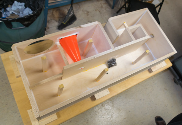

I have used 4 sided 5 sided pyramid and round conical “sports cone”. When covered with mass loaded butyl and stuffed progressively denser at e vertex, they all sound transparent and measure as if the back was in an infinite baffle. That is, no audible or measurable back reflection coloration. An 11in tall soccer sports cone works very well for this application. It has high convenience, low cost, and high performance. Although, smaller 7.5in ones could work very well too depending on the volume you want.

Think it's the easiest/best way for diy : sort of a la Nautilus B&W method.
However, it's even better if you mirror this shape as a nozzle (that's theory, does it matter, I dunno)
far better than the whisky card box I use (that I like because it's around 2.5 liter and gives t the SS 10F we bot likes a 0.55 Qtc : not saying I use the main bottle overture as the back of the load to change when I want the internal stuffing.
Maybe also a problem with foam is maybe a part of the energy is going outside the pyramid foam (perhaps, who knows ?) . Now it could be seconded with an outside tube
Sport cone is a clever idea, you can feel it to reduce the volume if you need...

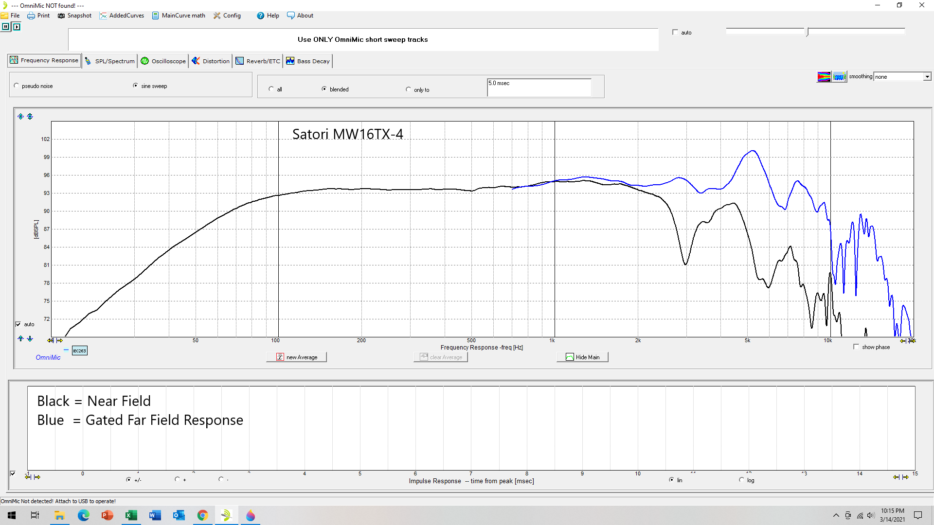

I have closely followed the threads by Augerpro and Remlab, as well as DonVK's ongoing investigations.
I am not being selective; I would like to discuss any data available. With that said, the most straight-forward data would be frequency response.
If internal box reflections come back through the cone, I would expect them to either (1) in phase, which would show up as a peak, or (2) out of phase, which would show up as a null, or (3) some random phase which would be somewhere between the out-of-phase null and the in-phase peak.
I have never seen this on any near field measurement I have made of a woofer or cone midrange driver. The near field response is typically very smooth, much smoother than the far field response. The attached is typical of what I would expect of a 6-inch driver. The NF response seems representative until about 1800 Hz, where the wavelength becomes too small relative to the cone. My NF responses of my SB17CAC35 and SB17MFC35 are similar.
All of my builds so far have been simple box shapes, because that is what I know how to build. Now perhaps I am just extraordinarily lucky and all of my three recent cabinets have optimum internal shape. But perhaps it is the stuffing?
Maybe there is something else I should be measuring?
