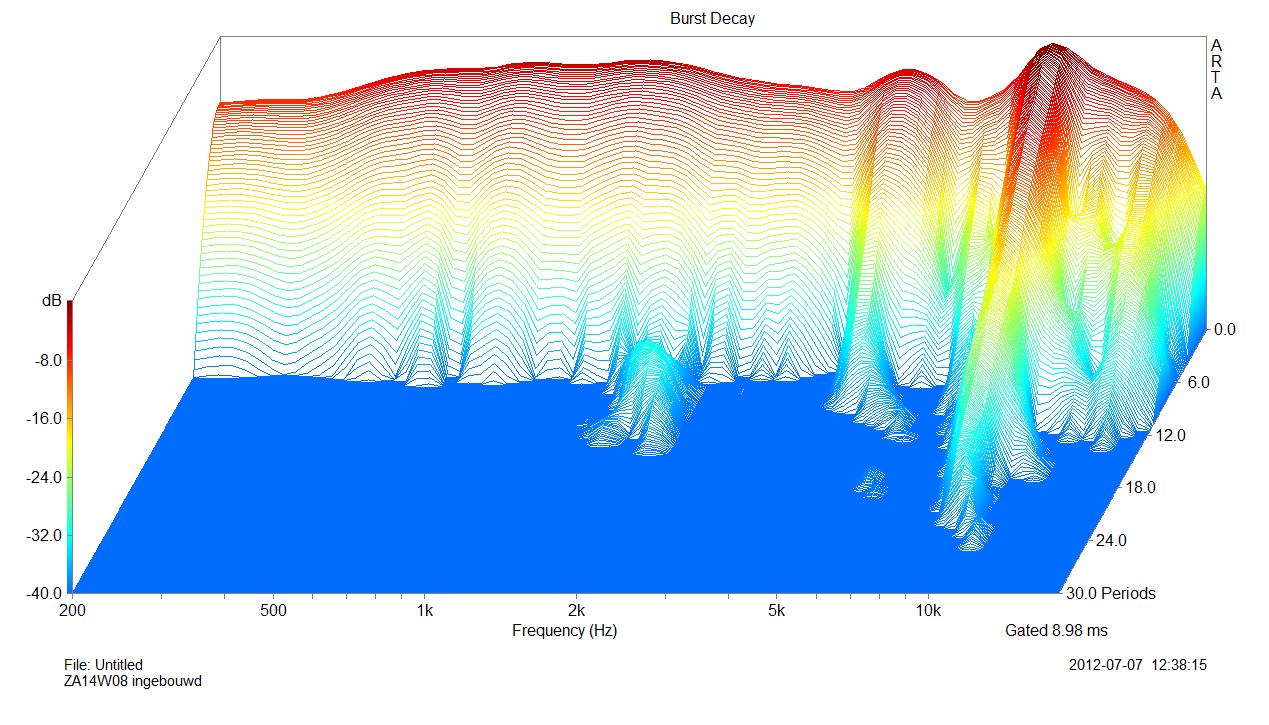

Well, there's a truth in that too much stuffing isn't right either, like you said. I do however not plead for using one's ears to find the 'equilibrium'. CSD and BD plots are far easier and far more reliable. Close range plots can easily have noise floors down 45-50dB. That gives you an impressive tool to find resonances. Not that I think every resonance is audible, but avoiding/reducing them seems the right path to me.

Only old files on device I’m at now, but this BD plot (made with a cheap Yamaha 48k audio interface) near field to a ZA14 clearly shows quite successful damping of a mid enclosure by means of acoustic foam. The enclosure was triangular, with only two parallel boundaries, which caused a resonance at about 1,7kHz. The level was way down and adequately damped, but measurable all the same. Like the cone resonance at 9k and a few other anomalies high up the frequency range.
