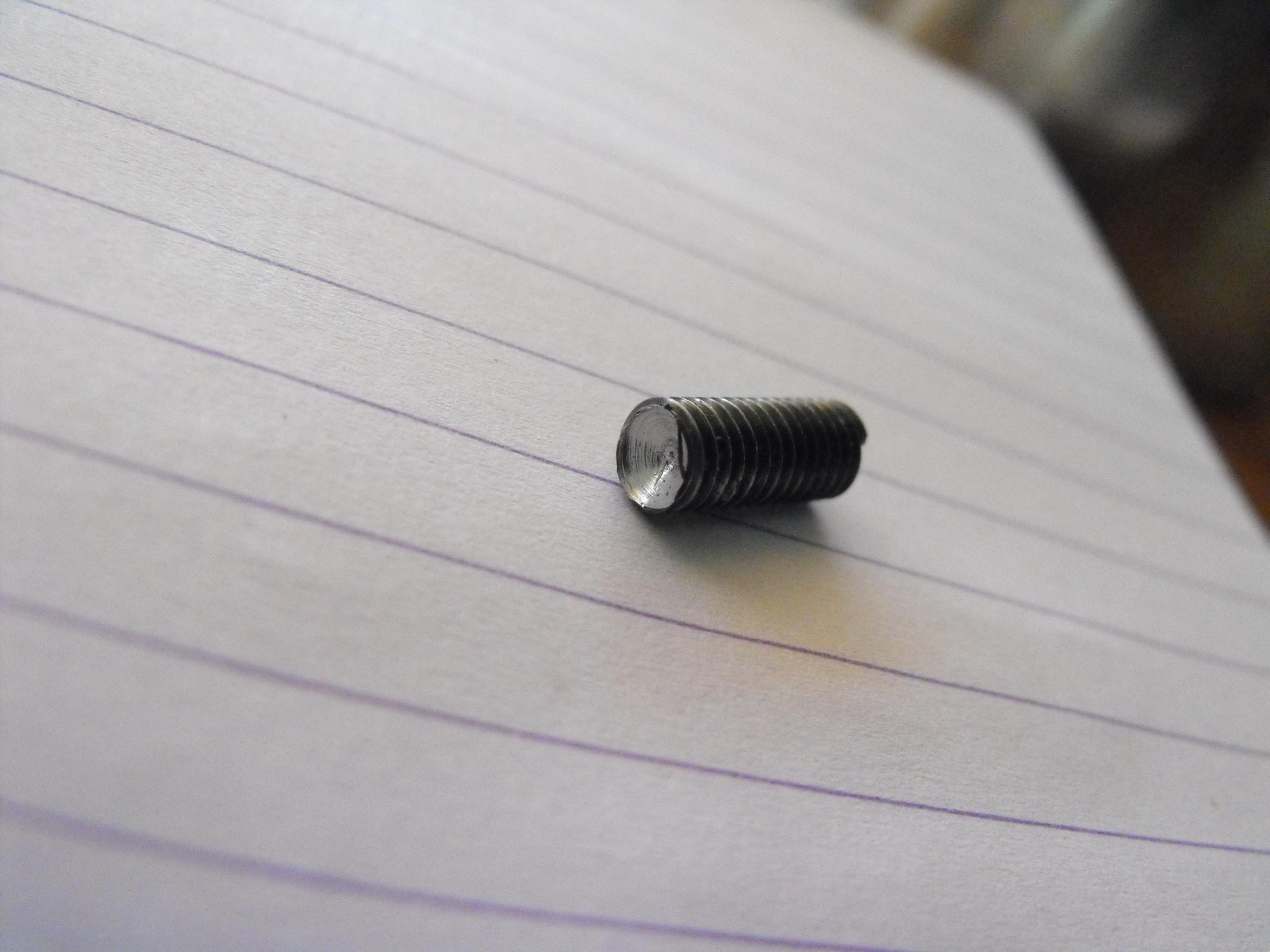

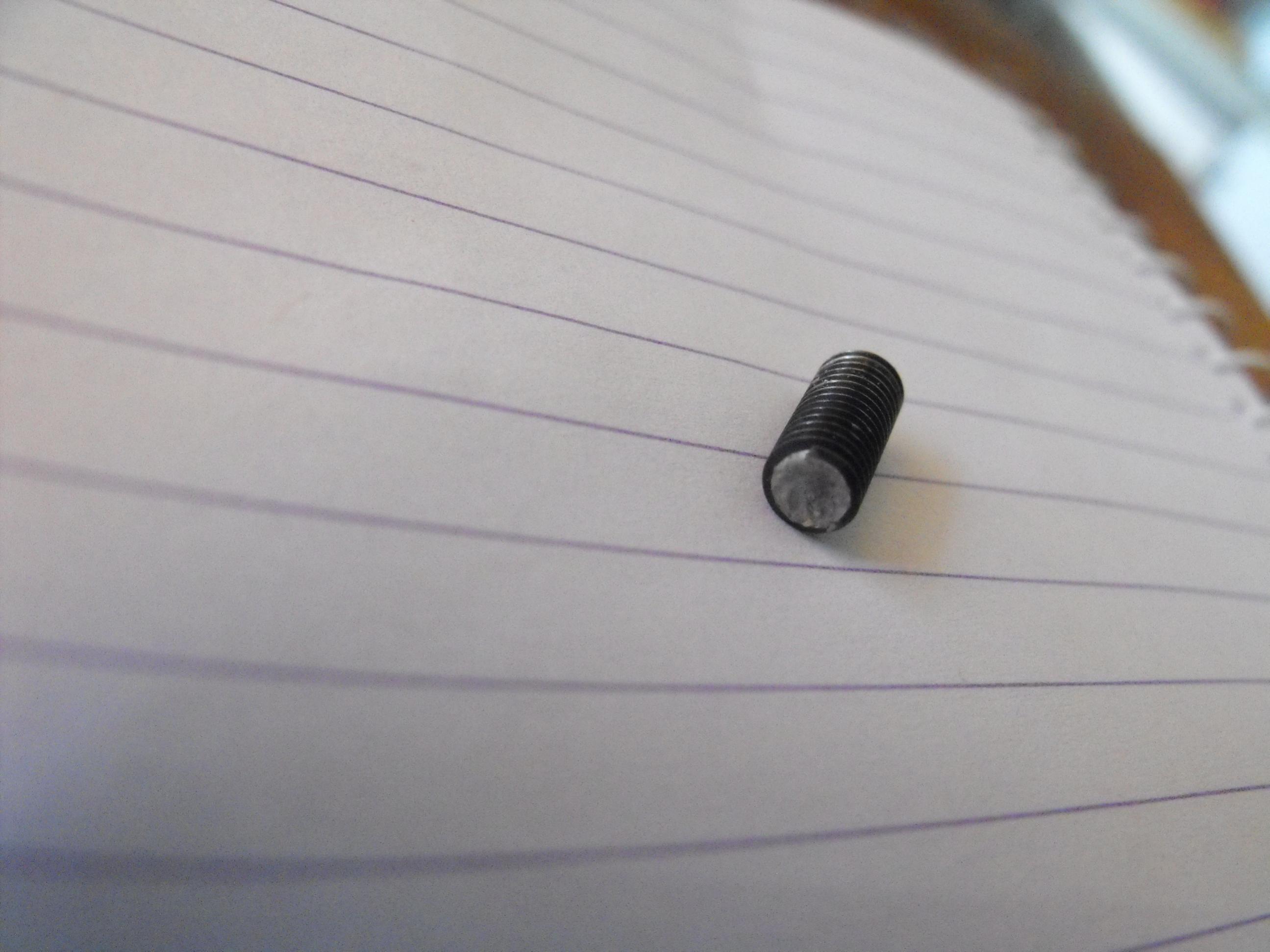

I managed to clean out the two tight bolt holes with a 5 mm tap inserted from the rear with the woofers removed. I cleaned out all the other holes the same way as a precaution. The broken bolt required a bit of effort. It broke off before emerging from the steel plate. My plan was to drill it out with a smaller bit, 4.5 mm, and re-tap. I had no real expectation of a result because the bolt is hardened. With not much room to spare, my 10.8 V battery Bosch drill just allowed me to insert the bit from the rear in contact with the bolt end. Pulling towards me and trying to keep straight, I quickly blunted 2 of my 3 titanium 4.5 mm bits. With the last bit, I seemed to be getting through, when suddenly the broken bolt stub shot out of the hole into my lap! The drill bit had lined up perfectly had somehow got a purchase to the bolt end and screwed it out of the steel plate. What are the odds? I knew no one would believe me so I took photos. All the bolts are now back in clean holes.But then there is Murphy and his Law. Three of the woofer have one bolt that has the same issue. Because the baffle has a 3 mm layer of damping, occasionally a bolt passing through, picks up silicone that then jams the thread into the steel backing plate. I feared something like this and tried to clear out each thread with a lubricated trial long bolt. This worked 29 times out of 32 but the 3 failures are causing me grief. The first failure happened with a jam on the withdrawal. It was solid. I succeeded in snapping the hardened bolt in the thread. The other 2 jammed on the way in and I backed off straightaway. So now 3 woofers are one bolt shy. I will try and clean out the threads of two with a thread tapper but I will have to drill out the snapped off bolt and re-tap with possibly a larger thread.
I will report on the sound after some more serious listening. So far I am a very happy diy-er.
What are the chances of that happening? Guess when you are drilling close to size of the bolt you have a fair amount of purchase on the bolt, so not overly surprising, but you take your wins where you find them 🙂
Pretty amazing what heat and vibration will do for a stuck bolt.

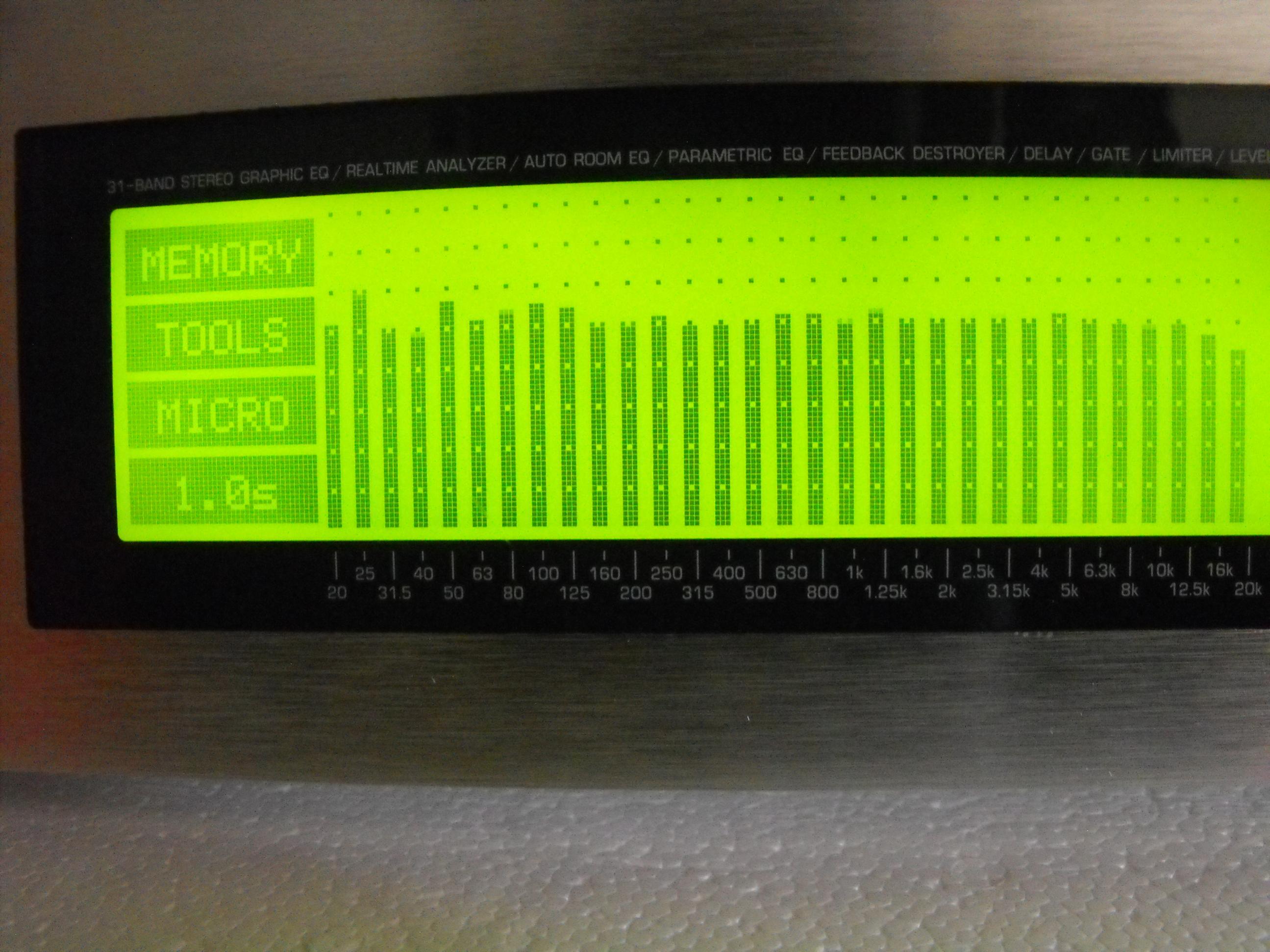

Cross-over tuning update.
Here are some observations on the tuning and tweaking of the crossover that has been taking place over the past couple of months.
My driver choice for each speaker is Peerless Woofer P830452 (2), Scanspeak Mid-Woofer Revelator 18W8531G00, Scanspeak Tweeter D2905-970000.
I use a Behringer ECM8000 measurement microphone, Behringer DSP8024 Ultracurve Pro RTA, HFN/RR Test Disc III, Behringer DCX2496 Ultra-drive Pro.
My preferred choice of cross-over type is Bessel 24 dB/octave.
Firstly I did some pink noise FR of the unequalised individual drivers, measured at the listening position, about 3 m, height 1 m. My first surprise was how flat and extended the Peerless P830452 woofers are in-room. They pretty well matched the published graphs, with some obvious room modes added. The unequalised Scanspeak 18W8531G00 and D2905-970000 were very flat on on the listening axis. My initial crossover points are 160 Hz and 2.5 kHz. With precise level matching and reversed phase nulling, I determined the tweeter and woofer delay relative to the mid-range. The in-phase drivers are level matched for a smooth, flat overall frequency response. One issue with Bessel alignment is the more gradual initial fall-off in the stop band and less flatness in the pass band. This shows in the composite frequency response as slight broad depression around the crossover points. I fill this in with a low-Q bandpass filter for excellent overall flatness. There are a few room modes to deal with. My room dimensions give prominent axial modes at 26, 51, 70, 102 and a strong tangential mode at 37 Hz. The most audible is the 102 Hz mode, which I flatten with a sharp bandpass filter in the DCX.
Further listening with known recordings, is concerned with fine tuning the relative levels of the drivers. This is a subjective aspect. Level changes of 0.5 dB over a driver pass-band are quite audible but barely register on a RTA. The final frequency response at the listening position, is quite smooth and flat.
I experimented with the bass-mid x-over frequency. I found that as I went lower than 160 Hz, the sound became more dry and clinical although the FR at the listening position did not appear to change much. I put this down to the differing radiation patterns of the 6.5” mid and the 10” woofers. Due to their differing physical position and acoustic properties, they drive the room quite differently in the comparison range 80-160 Hz. My preference at the moment is for the 160 Hz crossover but I will experiment with a gradual lowering over the next few weeks.
I put excellent diffraction control and precise time alignment as two of my main goals and I consider that I have achieved this. My favourite recordings for wide-imaging are better than previously experienced. Some are downright distracting, with extreme right and left images in addition to locked in central images. The remaining tweaking of driver levels and x-over points is primarily to adjust the tonality but I feel I am close to a final set-up.
In the attached FR at the listening position, you can clearly see the room modes centred at 25, 50 100 Hz. This is after some attempt at smoothing them out.
