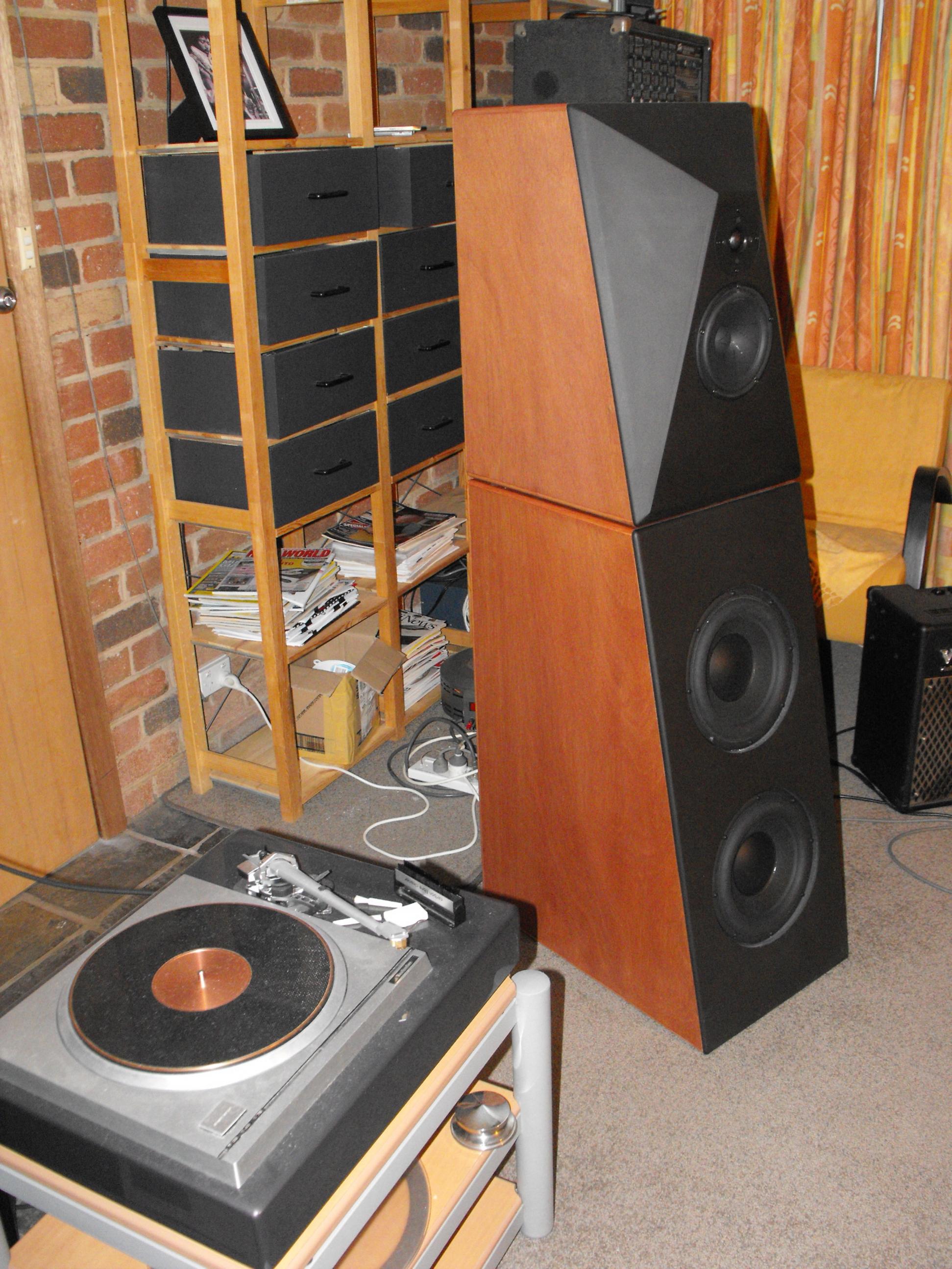

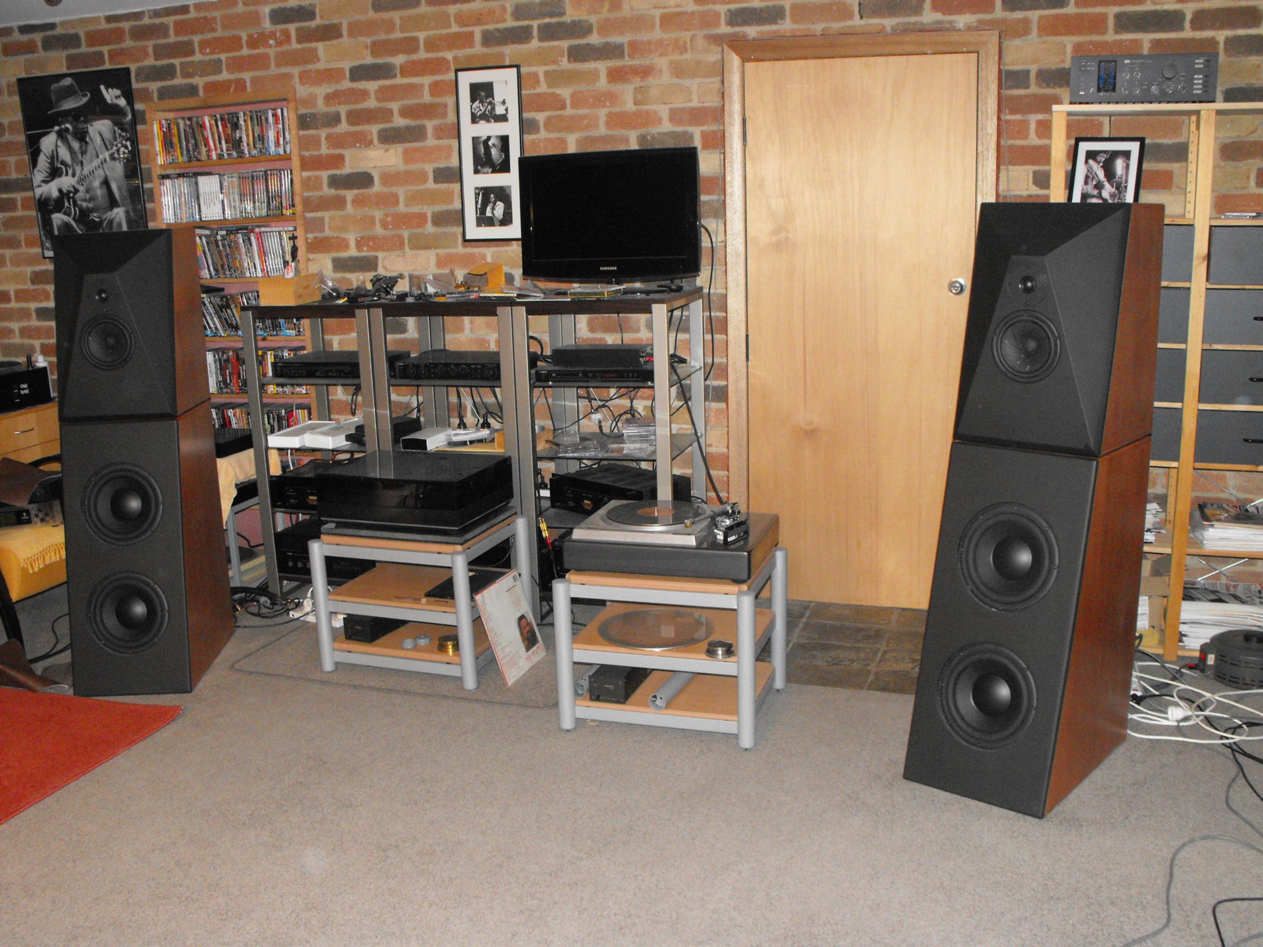

Stuffed and loaded

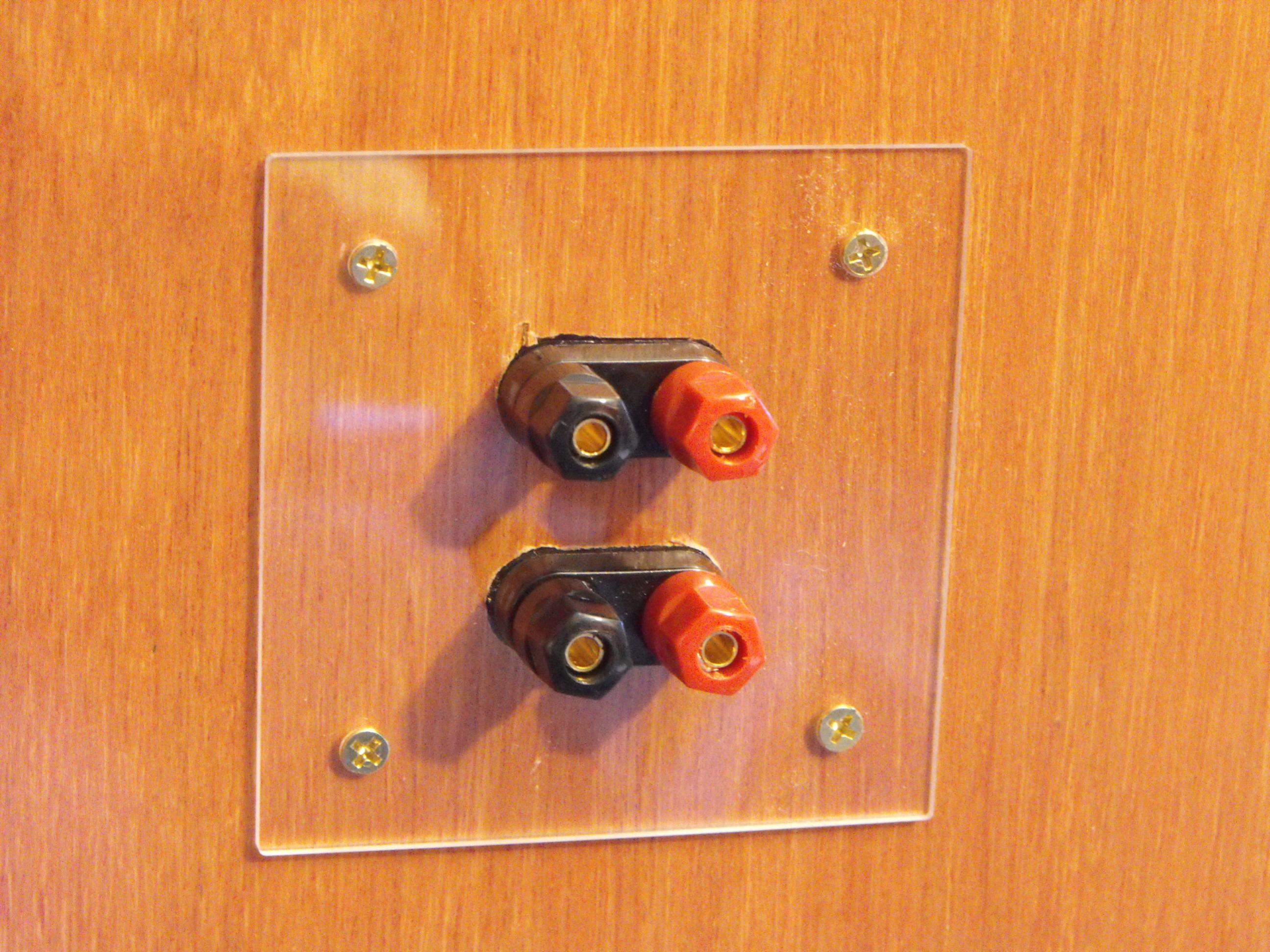

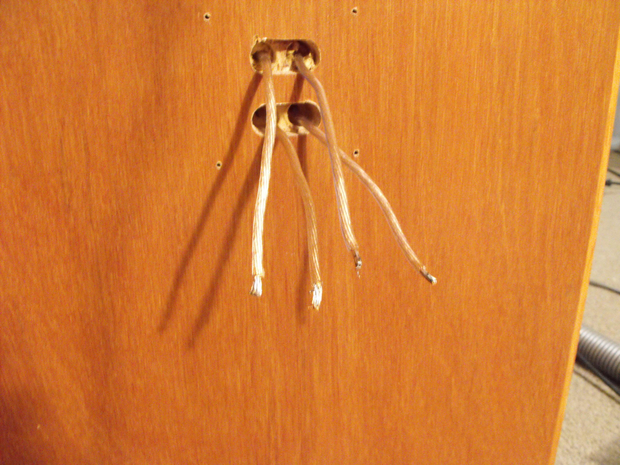

The last lap was definitely the slowest. I made up my own binding post from acrylic I got CNC'd locally and amplifier terminals I found on the web. Cost me $24 a set. Because the plate is clear acrylic, it does not hide the timber finish. I had to be especially neat with the holes. The drivers fit very well. They were close before painting and five coats of flat black made them fit even better. But then there is Murphy and his Law. Three of the woofer have one bolt that has the same issue. Because the baffle has a 3 mm layer of damping, occasionally a bolt passing through, picks up silicone that then jams the thread into the steel backing plate. I feared something like this and tried to clear out each thread with a lubricated trial long bolt. This worked 29 times out of 32 but the 3 failures are causing me grief. The first failure happened with a jam on the withdrawal. It was solid. I succeeded in snapping the hardened bolt in the thread. The other 2 jammed on the way in and I backed off straightaway. So now 3 woofers are one bolt shy. I will try and clean out the threads of two with a thread tapper but I will have to drill out the snapped off bolt and re-tap with possibly a larger thread. Apart from this glitch, i am very pleased with the look. I did not have the time to even try a rough and ready tune since we had guests over the weekend.
But it could quite easily if you masked off a tiny section around the terminal and gave them a coat of black.
Nice job! the finished result is quite pleasing to the eye.

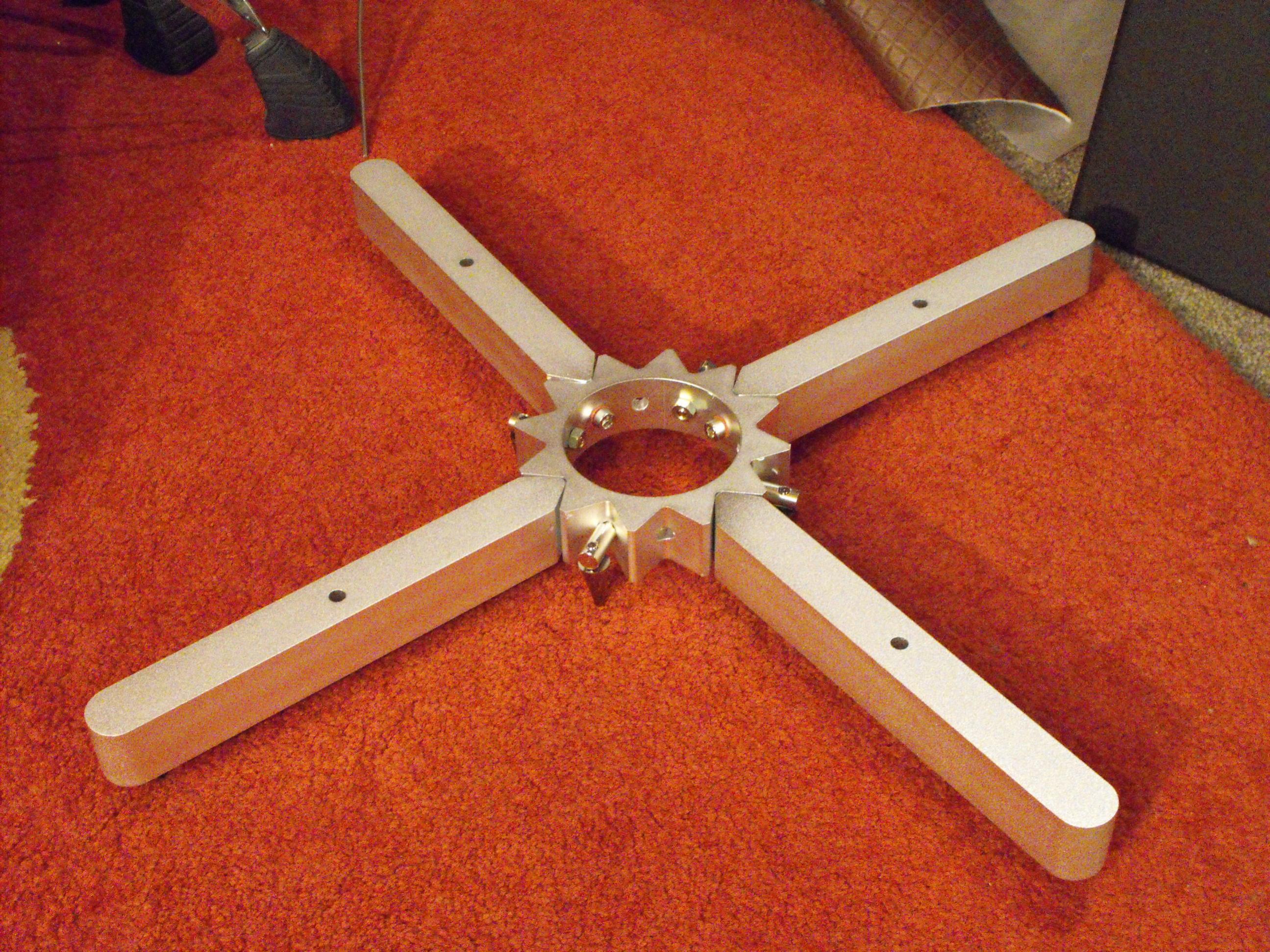

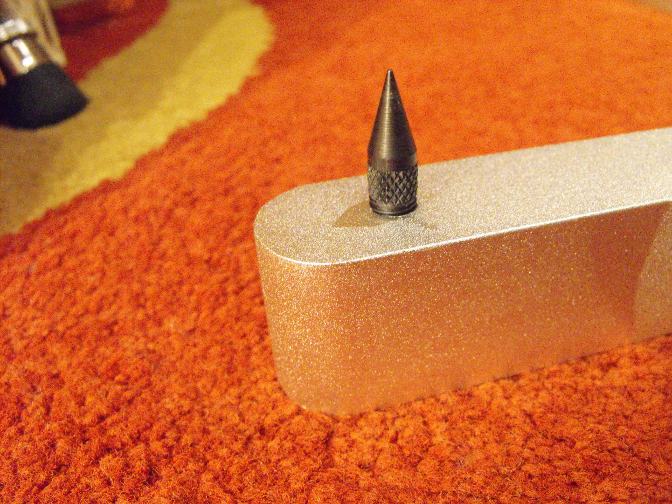

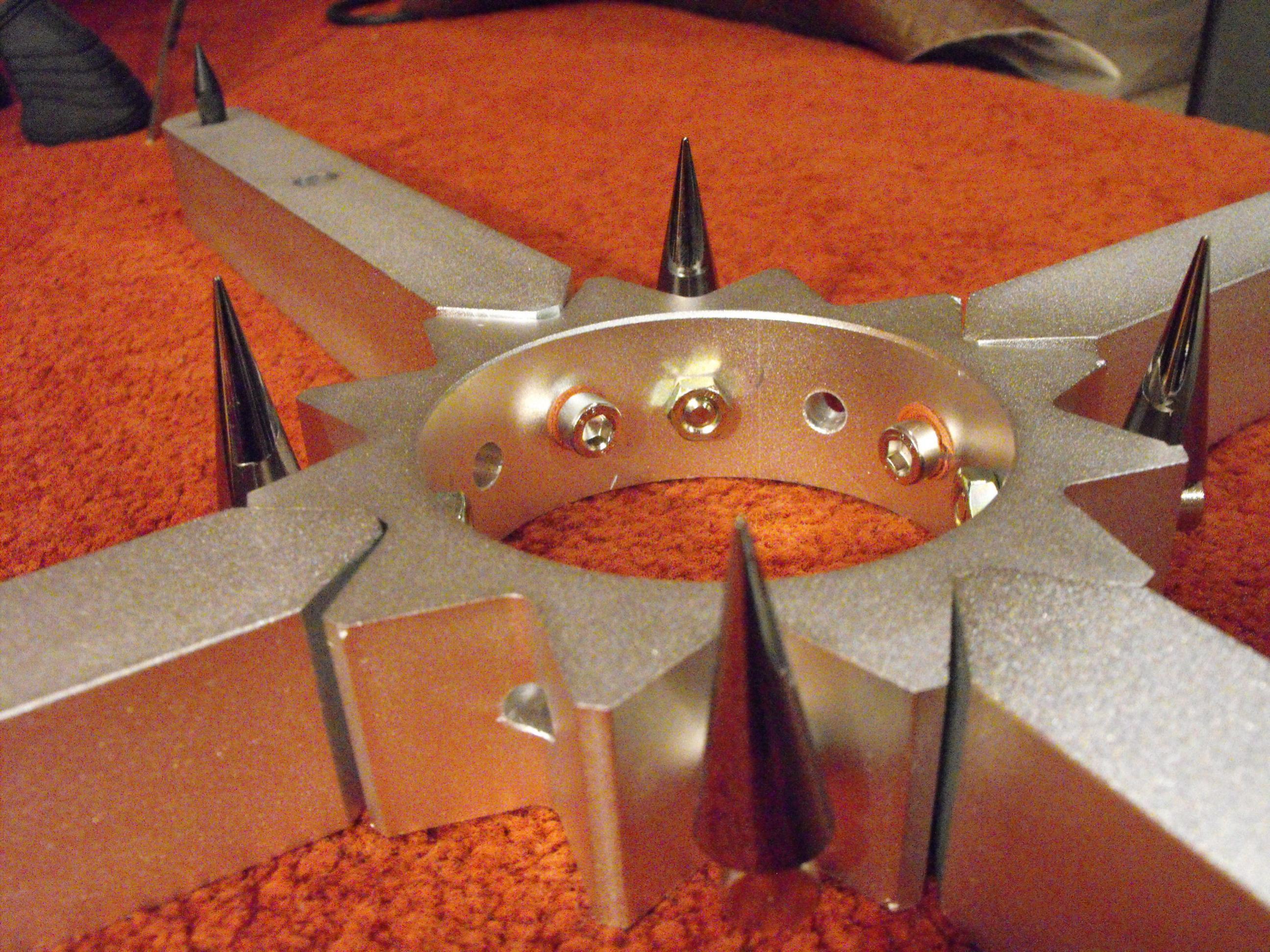

Stands
I quite like viewing the timber even though the holes are not perfect. I have in the past painted black the rear side of the acrylic. The result is a high gloss black. A bit like 3 mm of gloss clear coat. I might do this laterBut it could quite easily if you masked off a tiny section around the terminal and gave them a coat of black.
I found some solid aluminium stands and added extra spikes to handle the weight. I level them on a perfectly flat surface. The raisr the speakers about 50 mm. I won't install them until I have finished moving them around. I can't say they slide well on carpet. 150 kg sinks into the pile and underlay too much for that. I can tug them into place without too much trouble.B
Do you plan to put any feet on it?
And that is why they turned out so good, no detail is too small or was overlooked 🙂
Did you buy the stands locally?
I took a long time to think about what I wanted to achieve. I'm known to be slow to gee up but unstoppable once I get going.And that is why they turned out so good, no detail is too small or was overlooked 🙂
I hope I am not infringing any rules by posting the site where I got them.Did you buy the stands locally?
E&T 55X1 Adjustable Single Stand for Amps,Speakers Etc. | eBay
The shipping was expensive but they are very heavy.
Those stands are so cool! I gotta get me some..I quite like viewing the timber even though the holes are not perfect. I have in the past painted black the rear side of the acrylic. The result is a high gloss black. A bit like 3 mm of gloss clear coat. I might do this later

Absolutely brilliant work!
Those bases will be a great finishing touch.
We'll have to fix this 😎

Amazing Work! Some questions....
Hats off for your work, Bon. It's really admirable!
Myself and some friends have recently gathered together to discuss a serious project for building a subwoofer (lots of subwoofers, actually, one or more for each one of us 😉 ) and I followed this thread from the beginning to the end.
I have some questions, mainly focused on the constrained layer construction principle and the materials and method you used for your construction. Here they are:
1) You mention the Bostik V60 Silicone as the damping material between the two main MDF layers. I believe that any silicone rubber adhesive with similar characteristics (specs) would do the job. I say this, because it is not possible (or very easy) to find an Australian made silicone in Europe. Am I right or not?
2) You described a testing method, which led you to finally choose the Bostik V60. I understand that the steel ball was dropped on a pre-made "sandwich" of two MDF sheets and the damping material between them. In this case, the actual test was made on the final construction, i.e. on all three layers been put together and not on the damping material itself, right?
3) What is your opinion about cork sheet of 4 or 5 or 6 mm, as a damping material?
4) I am curious on a construction detail: The various parts of the box - the "walls" of it - were cut at 90 degrees at their four edges. When joining them, to form the speaker box, there would be a break of the continuity of the damping material between the "inner" and the "outer" MDF box at the joining edges. How did you treat this matter?
(I would understand that, in order to retain the continuity of the damping material, a 45 degrees cut of the edges would do the job, but again I understand that joining two edges with a 45 degrees cut is not an easy job and it certainly gives a weak joint. This is why I ask this last question).
Thanks in advance.

The Bostik V60 is specifically designed for glazing of large glass panels. It has a high adhesive property even under extreme deformation.1) You mention the Bostik V60 Silicone as the damping material between the two main MDF layers. I believe that any silicone rubber adhesive with similar characteristics (specs) would do the job. I say this, because it is not possible (or very easy) to find an Australian made silicone in Europe. Am I right or not?
Bostik Australia :Industry - Catalogue - Bostik V60
I do not think you can assume any silicone would have suitable properties. I would advise testing for adhesion, curing, damping effectiveness, neutral curing. The black also makes for easier visual alignment for cutting.
Yes. I dropped a 20 mm steel ball from about 1 m height. If you can take high speed videos, and average 10 readings for each construction, it will save time.2) You described a testing method, which led you to finally choose the Bostik V60. I understand that the steel ball was dropped on a pre-made "sandwich" of two MDF sheets and the damping material between them. In this case, the actual test was made on the final construction, i.e. on all three layers been put together and not on the damping material itself, right?
Cork is a good damping material in the correct application. It is not suitable for constrained mode damping, which requires the damping material to shear readily3) What is your opinion about cork sheet of 4 or 5 or 6 mm, as a damping material?
The attached pdf shows adjacent panels. You can see that the inner panels are separated by the damping layer at each join. The outer layers are separated from each adjacent outer layer, but the final marine ply layer joins them together.4) I am curious on a construction detail: The various parts of the box - the "walls" of it - were cut at 90 degrees at their four edges. When joining them, to form the speaker box, there would be a break of the continuity of the damping material between the "inner" and the "outer" MDF box at the joining edges. How did you treat this matter?
I rejected the 45 degree join for all the reasons you mentioned. The rebate join, if accurately done, results in three glue surfaces 18 mm wide, at right angles. It is much easier to align the panels with the 90 degree rebate joins. I would have had to use battens to strengthen and seal the joins if using 45 degree joins. I do agree that it is easier to make a single 45 degree than three 90 degree cuts, of precise depth.(I would understand that, in order to retain the continuity of the damping material, a 45 degrees cut of the edges would do the job, but again I understand that joining two edges with a 45 degrees cut is not an easy job and it certainly gives a weak joint. This is why I ask this last question).
