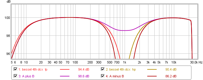

How many dB down at the nominal crossover frequency is the Behringer 4th order Bessel ?
Art
I'd guess that they are down 4db @ the target given Bon's summed response (with no polarity inversion) ... but it would be nice to verify if he can.

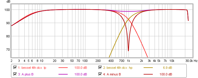

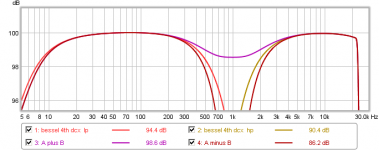

DCX2496 BES24 crossover 1.00kHz filters captured with swept sine via digital input:
Zoom of summed filters:
Yes, appears Behringer did OK by this one. It's been modified so phase of LR and HP match very well, and dip in response of sum isn't too bad. So this filter looks very much like DCX2496 LR24 filter, but doesn't sum perfectly flat.

They must have the frequencies spread apart pretty far to align the phase (ballpark looks like 1520/3700 mid/tweet .... 100/250 woofer/mid). I was trying to simulate what they were doing on some other makers software here ... could duplicate the response but phase was still 45* out. No amount of TA could align the phase and keep the FR Bon was showing (with the frequencies linked).
Adding (4) filters should get the on axis response near ideal ... a guy would need to add one for the tweeter @2.5k +2gain Q=0.7 ... two for the mid, one @2.5K +2gain Q=0.7 and one @160hz +2 gain Q=0.7 ... last on on the woofer @160hz +2 gain Q=0.7. This might get Bon close.
Good observation. This is how I do it. The behringer allows filtering, gain adjustment and delay of the input signal. I apply the required filters with chosen gain and Q to the input feed of each channel prior to crossover. This saves on two filters per channel over doing the same thing on the individual drivers feeds. My 10 year old DCX (v 1.14) has just enough processing power to manage it all. I have a newer version (v 1.17) but have not yet compared to see whether the code efficiency has improved the memory capacity.They must have the frequencies spread apart pretty far to align the phase (ballpark looks like 1520/3700 mid/tweet .... 100/250 woofer/mid). I was trying to simulate what they were doing on some other makers software here ... could duplicate the response but phase was still 45* out. No amount of TA could align the phase and keep the FR Bon was showing (with the frequencies linked).
That's why I asked about the Bessel 24 response at the crossover point of the specific crossover the OP was using, digital implementation is often quite different in different software/hardware, sometimes even from the same manufacturer.I was trying to simulate what they were doing on some other makers software here ... could duplicate the response but phase was still 45* out. No amount of TA could align the phase and keep the FR Bon was showing (with the frequencies linked).
