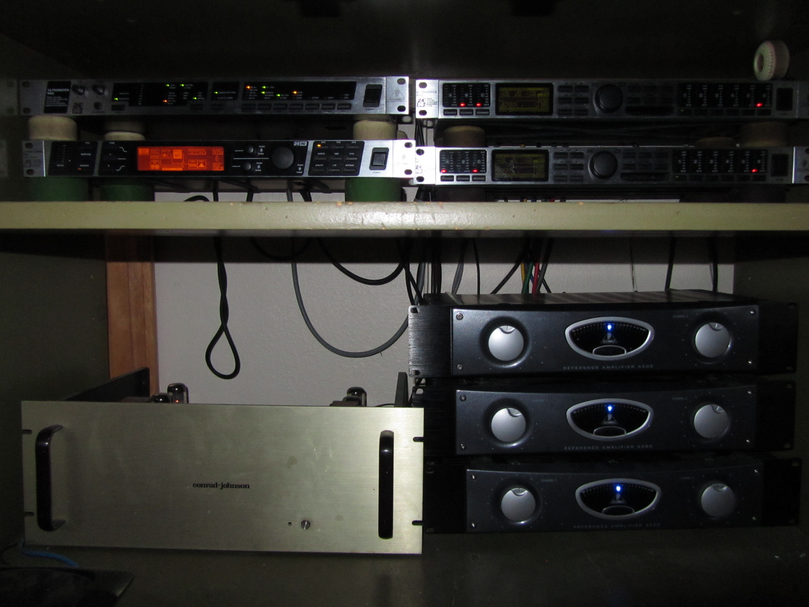

I'm big on active too..
Notice my kids old skateboard wheels? Good for the circulation. "Dad, Where are my wheels?" Huh?Wheels? What wheels?
Computer based system consisting of;
Computer
Squeezebox touch
Behringer DEQ 2496, Behringer SRC 2496, and two Behringer DCX 2496's(One per channel).
Signal stays in the digital domain until the DCX outputs..
Conrad Johnson MV 50 for planar magnetic mid-tweet drivers
Three Behringer A500's for woofers
500w Bash amp
Dayton cabs
Dayton reference 12" subwoofer
Peerless XXLS's
Peerless HDS Exclusives
BG Neo 10's planar magnetics in sealed cabinets
Xover points(4th order); 40 80 160 320 (Planar magnetic dsp'd flat from 320hz to 20khz).

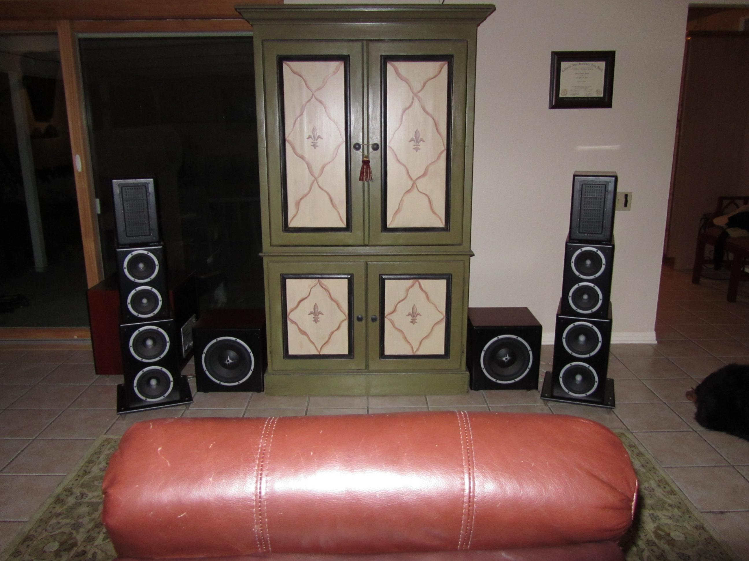

I wish I had cabinet building skills, like Bon, but I don't. What an amazing talent! But I am (Duh!) using pre-made cabinets in a novel way.remlab,
impressive!!!
Don't for a moment think I am putting Bon's efforts down, but really I think anyone can produce the same kind of results... I am not particularly gifted but I always produce excellent results for one very simple reason... I have copious amounts of patience, and provided you think out every detail, to the most minuteaspect and you don't allow yourself to be rushed, there is no reason to believe you couldn't do the same.
But most people want results yesterday and that is the difference between great and ok.
I agree. Anyone CAN do as good a job as Bon did. As long as they are extremely talented! There are so many variables involved with a cabinet design like this, it's not just about good woodworking skills. You need a deep understanding of the physics involved, and a large amount of time invested in this wonderful hobby before you can pull off a design like that. Constrained layer damping? You need to really, really, appreciate things like that in order to succeed in making them work..
I'm not necessarily saying everyone could think it up either, but now that the idea is out there, Bon has provided a good template for anyone with the dedication and persistance to follow 🙂
Most people are content to throw six MDF sides up and call it a cabinet (not quite that simplistic but you get my drift). The level of thought that has gone into every layer of this project is where I see the difference, not so much the cabinet work.
Again the short cutter gets out the circular saw and cuts a fairly straight line and file / sands the difference, the dedicated person builds a fence for their workbench so they know the line is perfectly straight.
I still think preperation and just taking your time can make an awful lot of quality improvement, years of experience or not.

I have settled on 4th order Bessel for mid-tweeter (24 dB/octave ultimate slope) and 4th order L-R for bass-mid. This might seem in conflict with my previous explanation of the Bessels superiority until you consider that the chosen bass-mid x-over frequency is 150 Hz where phase effects are much less noticeable. In fact at this frequency the steeper initial filter slopes are useful for keeping high level bass away from the mid range. The 150 Hz is not a random choice BTW. Research has shown that below 150 Hz, the human ear/brain is unable to locate the position of an acoustic source. I don't get the same buzz out of building electronics so I am happy to use what is affordable, reliable, and sounds good. In fact, I have found that when the amps are not asked to deal with a complex passive x-over, they are more than capable of driving the naked speakers.At the moment I am thinking 4th order but a "hybrid" 2nd order low level active and 2nd order high level passive. This will achieve some "optimised compromises" (if you'll excuse the expression) for a clutch of single rail Class A JLH's.
This must be for passive x-overs. I can't see how an active x-over that is before the power amp can modify the power amp step response. Whereas a nasty passive can make even a good power amp freak out.I was interested to see comments about filter slope altering the step response of the power amps......
Jonathan
Try and find a copy of a Technical Note by Rane Acoustics. It is intended for pro audio but it gives a really clear set up procedure for phase alignment of drivers at the listening position. It is a good starting place. My set up procedure is a modified version but the principle is the same. In short, for each enclosure, play a sine wave at the chosen x-over frequency, set the mid and treble levels separately to be as close to identical as measured with a measurement mic at the listening position. With the sine applied to both drivers, reverse the phase of one driver and adjust the phase and delay until the mic reading bottoms out. I can easily get a 30-40 dB null. With a little practice this can be improved.Also interested in the process of aligning the drivers.
Saw a Danish site that was speaking seriously about single millimeters being important in driver spacing! Is that your experience?
Jonathan
Then put the drivers back in phase. They should now be time aligned. With only two driver active the level should rise 3 dB over one driver. Reversing the drivers and repeating the level should drop 30-40 dB. Play pink noise and observe the frequency response. It should be smooth and flat through the x-over region. With one driver reversed, there should be a deep notch in the frequency response at the x-over frequency. In practice, it is at least a couple of hours work. Wear ear protection.
Yes, the DCX2496 allows delay adjustment increments of 1 mS (2 mm). I find the best null require this level of adjustment.
