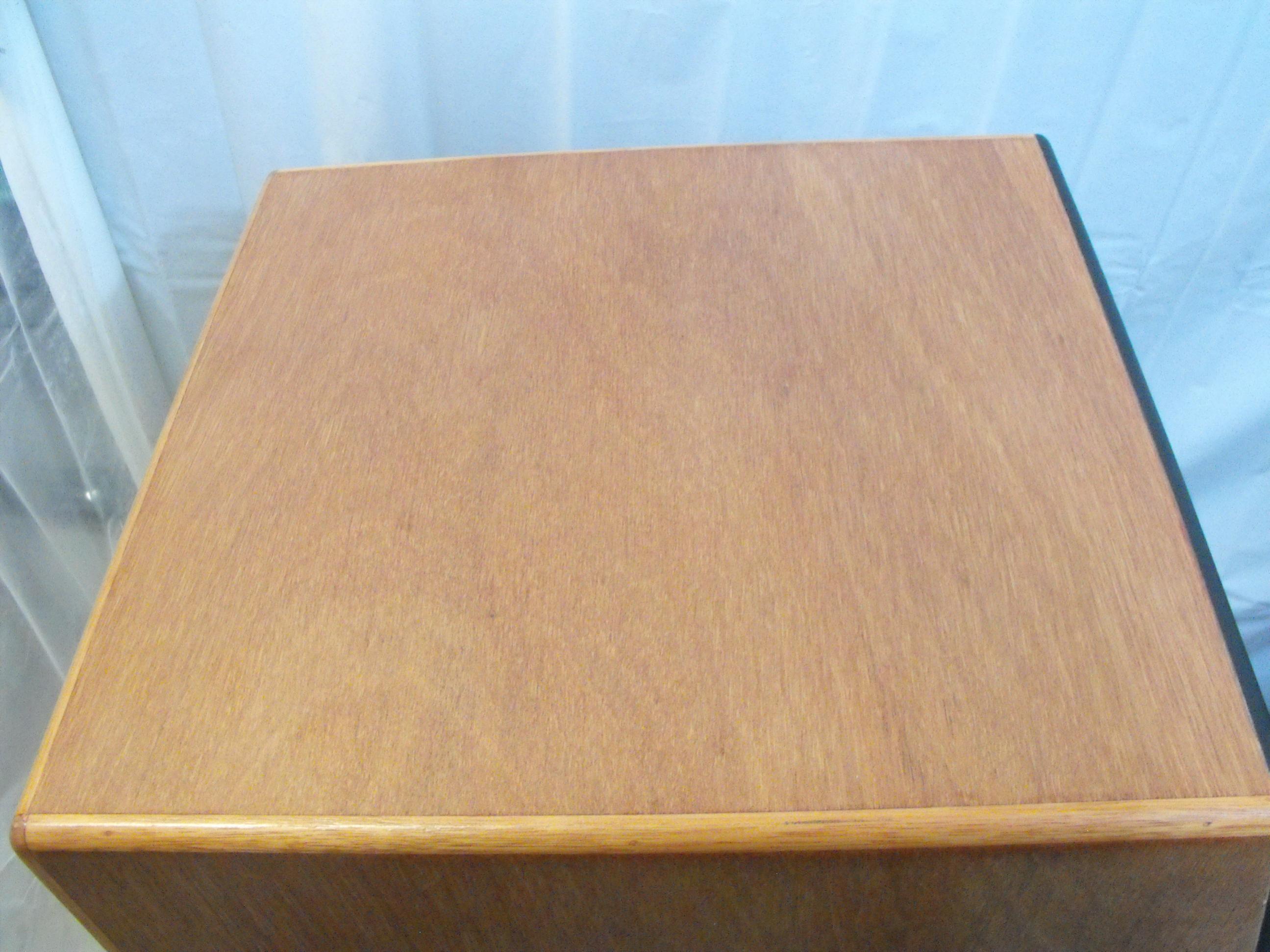

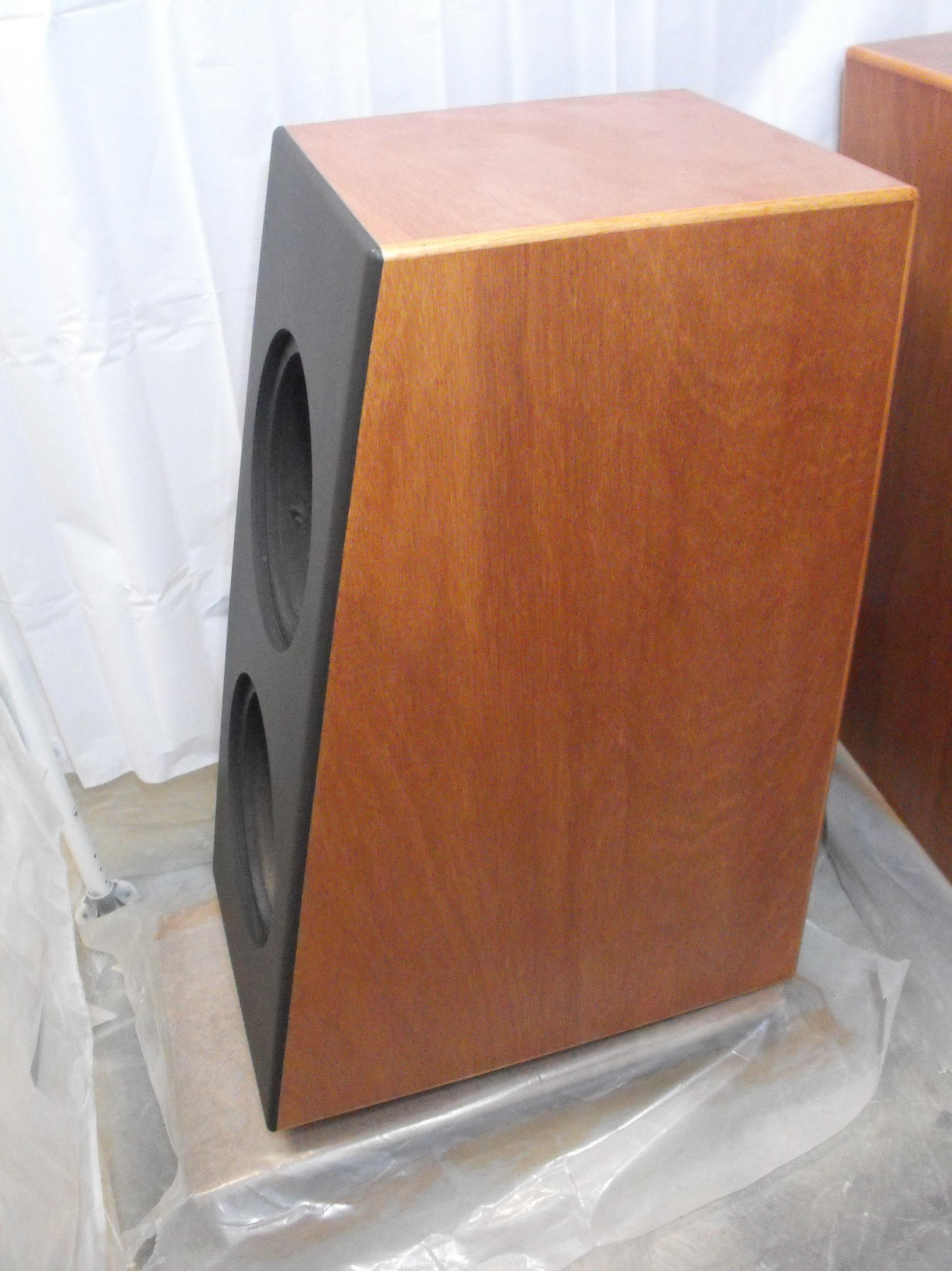

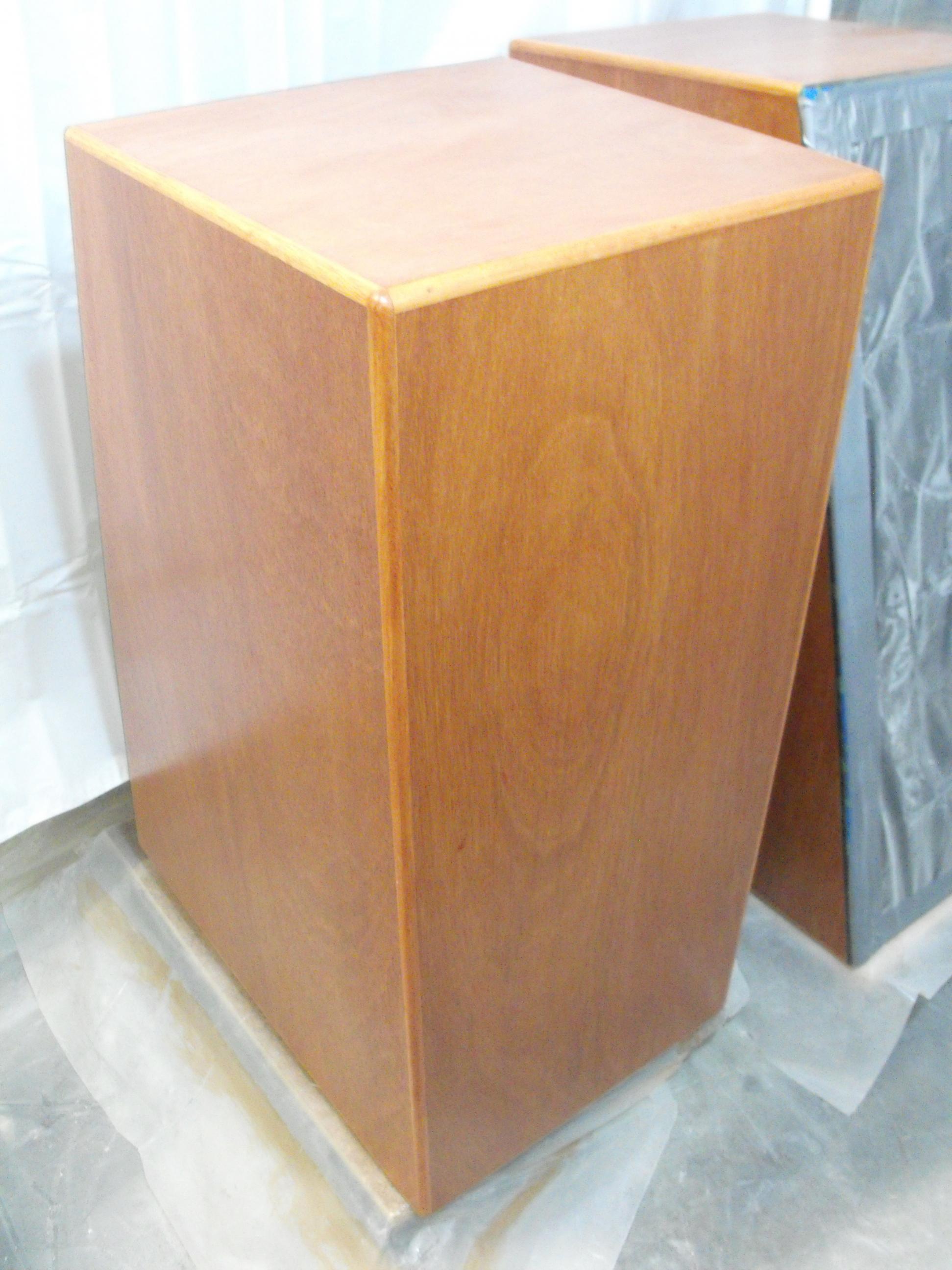

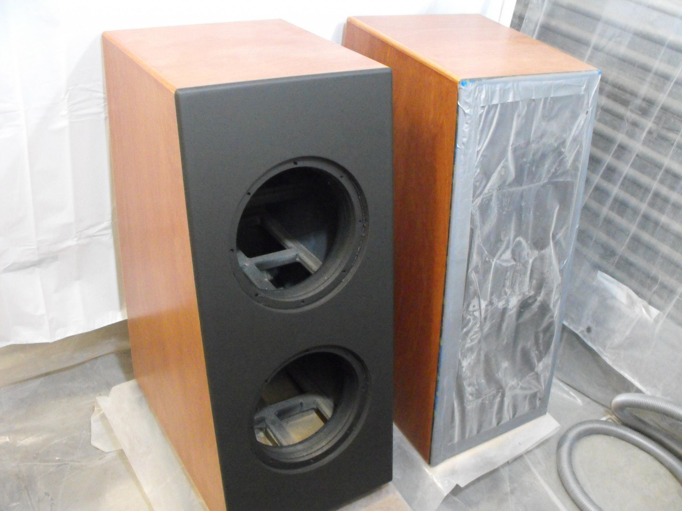

I took a few days to practice my HVLP spray gun technique. Following some Youtube tutorials, I set up the gun as recommended. I chose a 2 mm tip and set my compressor to about 30 psi. I used a 20 m hose to keep the compressor noise away from the neighbours, so the pressure at the gun might be 20-25 psi. I applied a maple solvent based stain by rag and found there was not much wipe off. The marine ply is quite thirsty. I was happy with the uniformity of the colour. I shot 5 coats of waterbased polyurethane clear, lightly rubbing back between coats with 240 and finally 400 grit sandpaper to remove nibs. The shower curtain/gazebo spray booth worked great apart from a few windy moments making the curtains flap around. I waited it out for a calmer weather. The first couple of coats did very little apart from raising the grain as people warned me. The fifth coat was where it all came good. I am happy. I was a bit nervous removing the masking tape from the matt black baffle, because it had been masked up about a week but it came off nicely with a slow peel. You can see the line between the black and timber finish is quite sharp, you have to get about 6” away to notice any imperfection. The finish is satin and I am quite content with the level of gloss. The grain can be clearly seen and slightly felt which I don’t mind because it emphasizes that it is a timber finish and not artificial. I am not a big fan of high gloss finishes. I have yet to finish the mid-tweeter enclosure, but don’t expect any problems. Getting close to stuffing, mounting the drivers and setting up the active x-over and power amps.

Very professional looking job Bon. I think I'll be using a fine spray gun (Wagner) on my next project.
Nice praise from you David. I have seen the high quality of your Delta finish. My generic HVLP gun does a good job when properly adjusted but the settings can drift during use, especially the fan width. I suppose good adjustability is one of the things you get if you pay 10x what I did for a spray gun. It is a good learning experience though.
