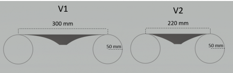

Haha. Noverber has arrived, but let's not fall into despair. There is still beauty in the world and I'm still optimistic that I can eventually get good results with the current approach. Meaning Q100 drivers and a strongly shaped front baffle crafted using 3-axis CNC, 3D printing and laser cutting. Just don't expect fast results.
The first waveguide was mainly designed based on infinite baffle simulations so it's not a surprise that it's not working optimally together with a real baffle. The next step is to use a narrower waveguide which allows use of large rounding without making the baffle very wide. Here's a sketch.
attachment.php

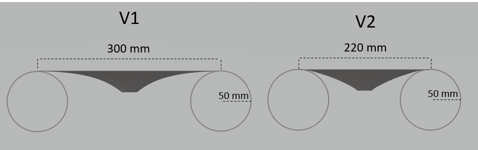

I think V2 may very well be as good as V1 in terms of directivity. V1 just occupies too much space on the baffle in comparison with the depth and waveguiding effect. V1 is very flat around the perimeter anyway.
V1->V2------->This could of course be extrapolated to a case with a minimal flare around the driver and even larger rounding radius, which in a circular symmetric case would be the Ikea Blanda bowl which was suggested. On the other hand, Heissmann showed that diffraction can be controlled nicely also in a baffle which is shaped only on the side edges. And Dutch&Dutch 8C* does a good job without using very exotic shapes. I think in both of these cases the waveguide and baffle have been optimized together in order to achieve the smooth polar response. I suppose instead of minimizing diffraction I attempt to get controlled diffraction since that's what the WG does, and the baffle edges can provide a bit of additional directivity without messing the response if designed carefully. I have just taken the first small steps on this path.
*I'm referring to the tweeter+WG part here, not the cardioid bass.

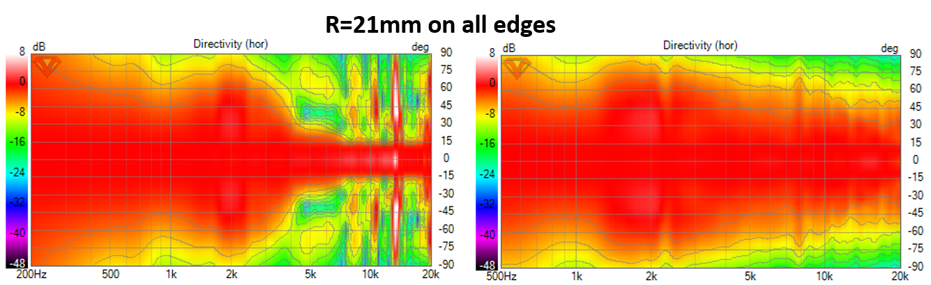

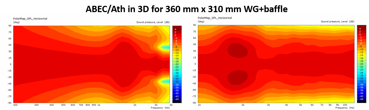

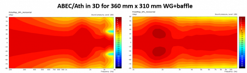

Perhaps my 3D simulation was not too far from reality in the end. The baffle effects are sharper than in the measurement data because the simulated baffle/WG had mirror symmetry for both vertical and horizontal directions.
attachment.php
attachment.php

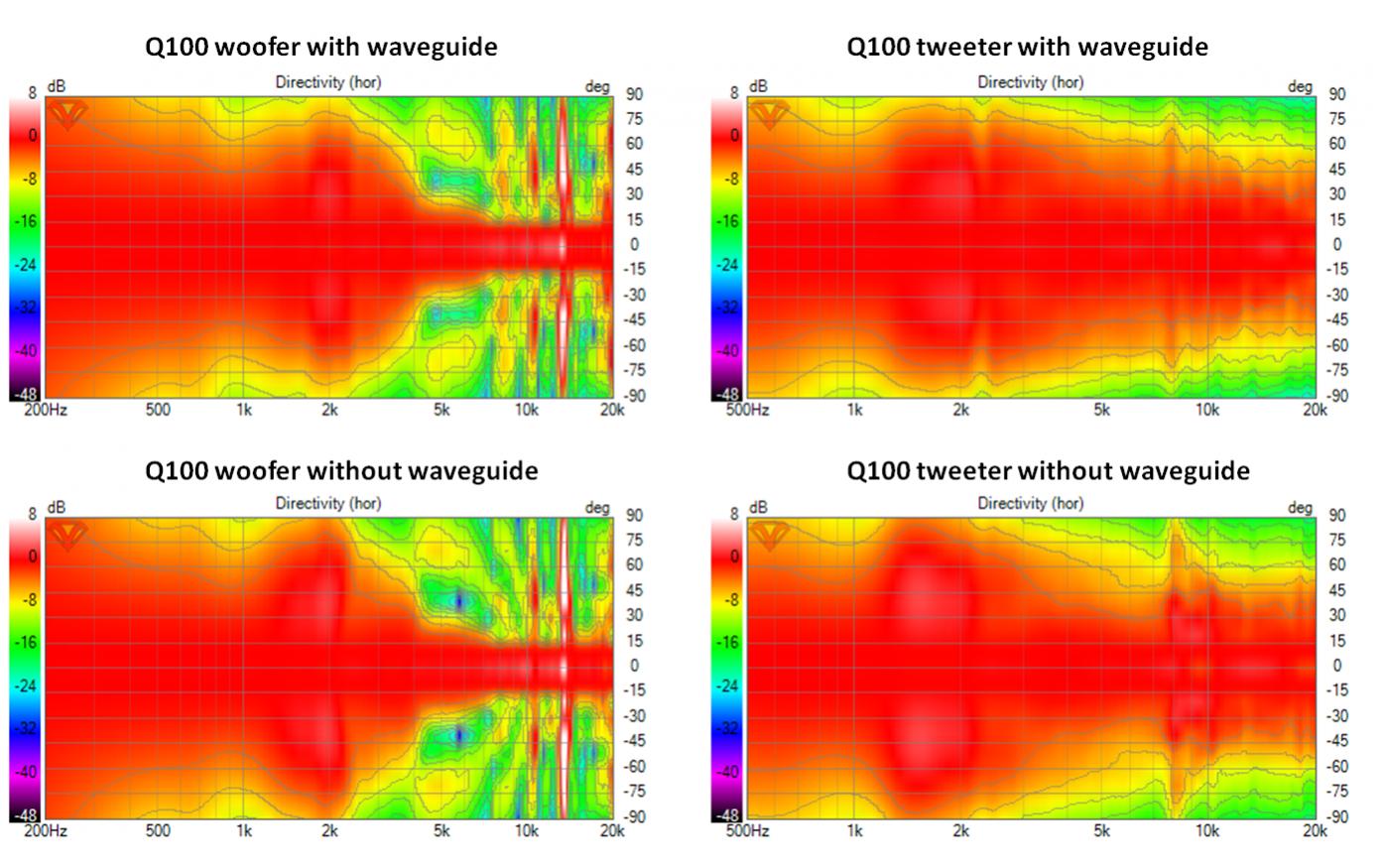

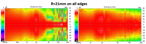

..what's it like with baffle and no waveguide?
Here you go. Both on the same baffle as previously. R=21mm rounding on all edges. Looks like the baffle diffraction has even bigger impact for the 2kHz range without the waveguide. Also the higher frequencies are tidier with than without. So this waveguide seems to have some beneficial effects, but the response is dominated by the baffle. Let's see if the second iteration brings improvements in that respect.

It looks like it could use a wider *baffle profile to get the tweeter's low-freq. "bloom" (around 1.5 kHz) pushed further down to accommodate the woofer's slight lack of pressure (..around that 1 kHz region).
*including waveguide.

Hmm. I thought that the narrowing and bloom would move together if the baffle width is changed. I'm going to consider the wider baffle as an option, but the next iteration is going to be in the other direction. Meaning a narrower baffle which moves the diffraction to shorter wavelength where it is more easily managed with edge rounding. So reducing the bloom and pushing it towards the frequencies where the woofer starts to beam and using the narrowing as an additional low frequency directivity. Then crossing at ~2.5kHz and playing with XO slopes.
A wider baffle moves the diffraction signature (or "bloom") LOWER in freq..
Narrowing it will move that 1.5-1.7 kHz tweeter signature upward in freq.. (..and of course do the same to the woofer's - though for the woofer that's to a point because of the woofer's narrowing directivity at higher freq.s beyond 2.4 kHz).
Yeah the trick is to have a transducer "beam" so that most of the sound radiates forward and little radiates to sides to travel along the baffle to the edge and to diffract and cause the interference seen as bloom on the normalized polar map. The beaming is natural for direct radiators and waveguides on frequencies that are (roughly) shorter in wavelength than the size of the transducer / waveguide. This defines the upper limit of frequency bandwidth where the diffraction interference occurs.
Then there is the baffle that extends beyond the "beaming", the transducer, which projects some of the sound forward if it is significantly large relative to the wavelenghts, which means the baffle is relatively big obstacle for (roughly) shorter waveleghts than the baffle size and diffraction occurs. The baffle size kind of defines the lower limit of frequency bandwidth where the diffraction interference happens.
So to minimize diffraction interference the trick is to minimize this bandwidth where diffraction occurs, or remove the edge to prevent diffraction, or cancel the sound at the edge.
Minimization of the bandwidth can be done by bringing the limits closer together. Upper limit is defined by the transducer size, which has to be there and we can do nothing about it, but the baffle can be minimized by removing it altogether or by making it as small as possible one way or another like adding the roundovers, which is kind of removing the edge as well (for wavelengths that are small relative to the roundover). Cancellation could perhaps be done with cardioid system I suspect, along with minimization of the baffle. All three effects are seen with the D&D 8c for example.
In case of coaxial driver the tweeter has quite a long distance to the edge because the woofer is there so best bet is to try manipulate the waveguide part as well as you can to affect the beaming as much as possible, eg. control the tweete response forward not to the edge. roundover right at the woofers edge might work best but eventually it is the woofer cone profile, the part of the waveguide you cannot change that will make or break the performance in this respect I think. You can play some with the crossover frequency and possibly get the almost inevitable diffraction positioned nicely somewhere there in between. Specialty here is that the woofer being bigger transducer beams lower in frequency and thus has different upper limit for diffraction than the tweeter. But, you still should mind about the directivity of the whole system.
I'm sure you can minimize the diffraction interference and get as good system as possible but not sure if diffraction could be avoided completely. Maybe with a sphere as enclosure, but that defines the system directivity control as well.
Actually it is very hard to imagine a multiway system that doesn't diffract at some point so minimizing is best one can achieve I think. The freestanding ATH examples mabat has been rolling out have least diffraction and most control I've seen but they are only the treble. Add in a woofer somewhere nearby and bam, back to diffraction land. Altgough potentially at very low frequency, below 1kHz.
Hopefully here was some food for thought. If you can imagine further and develop very low diffraction system without significant drawbacks, please post it 🙂 I think there is a sweet spot to be found and if you manage to find it and get some rule of thumb generated out of it, that would be really nice info for coaxial builders!

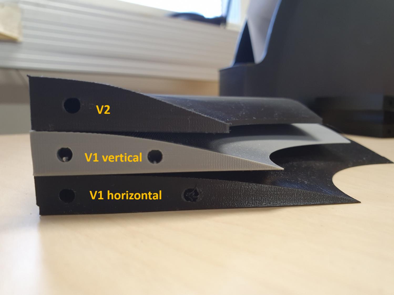

Waveguide version 2 fresh from the oven. The effective depth is the same as in V1, but the lateral size is considerably smaller. Unlike V1, V2 symmetric between vertical and horizontal directions. There's also files for V3, which is the same size as V2, but with some extra depth, but I'll probably measure the V2 before printing it.
