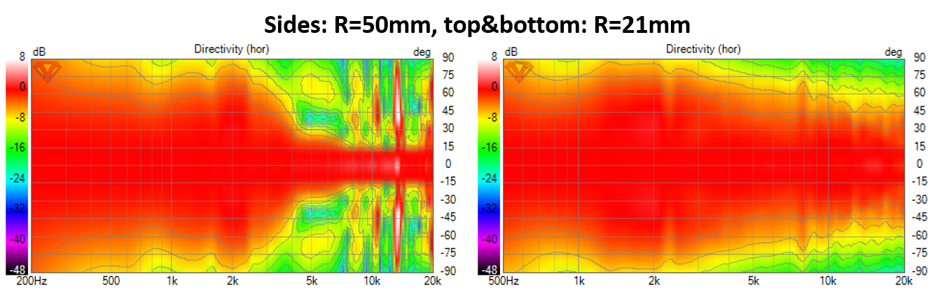

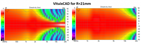

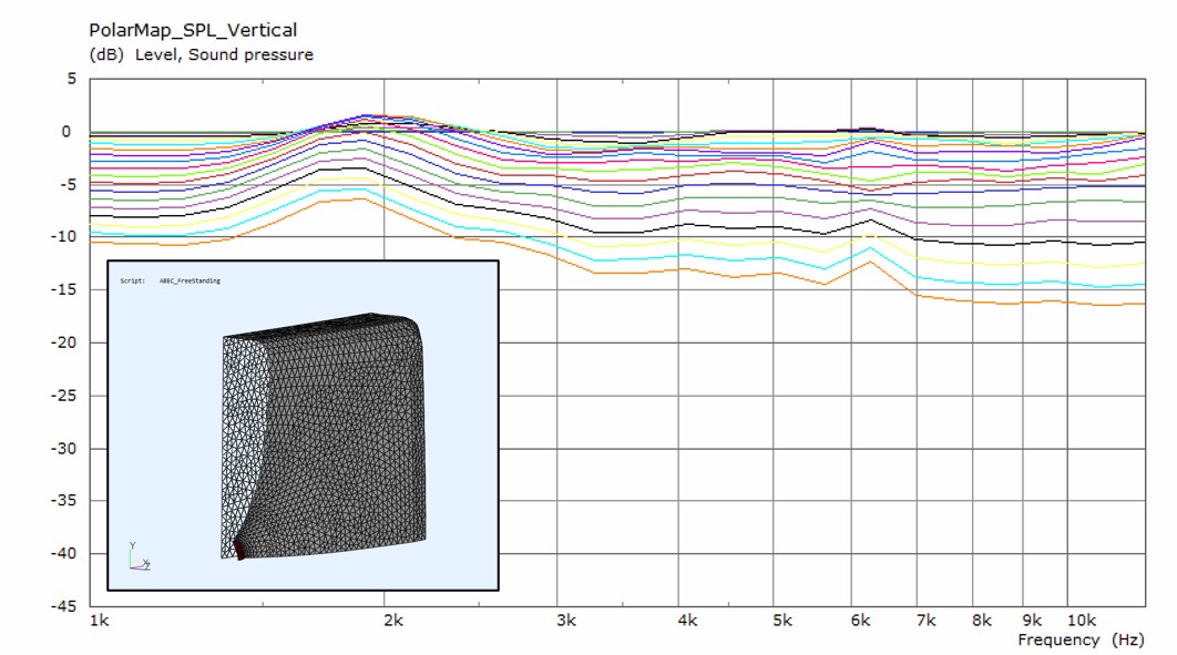

It's been quite intensive at work lately, but I have tried to keep also this project alive. I continued the ABEC/Ath simulations by morphing the circular symmetric waveguide into a 3D form with a rectangular mouth. In an infinite baffle it simulates similarly to the circular symmetric profiles shown before. Then I added some edge rounding and removed the infinite baffle, and got a taste of all sorts of numerical issues and long simulations times required for sorting them out. Here's the most reliable data I have obtained for the tweeter response so far (these took around 8h to solve).

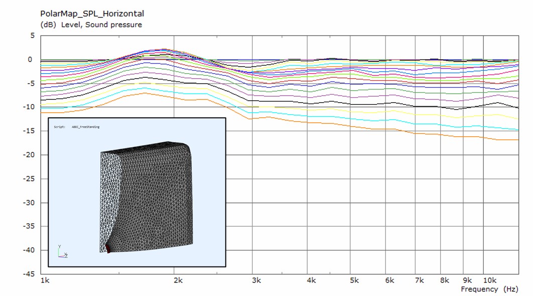

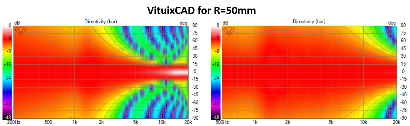

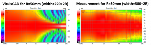

Horizontal polars for the tweeter

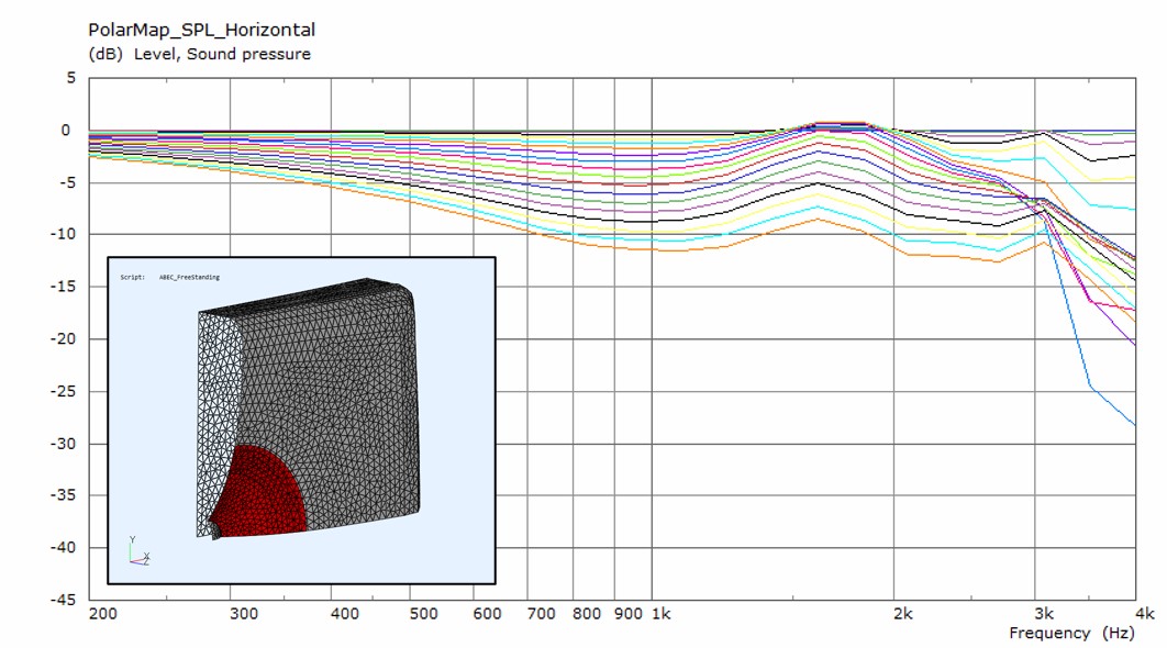

Vertical polars for the tweeter
I'm still not sure how accurate the baffle edge effects at around 2 kHz are. They seem to depend a lot on the computation mesh and placement of the subdomain interface even if the baffle/WG shape remains unchanged.

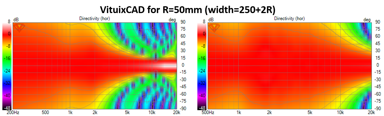

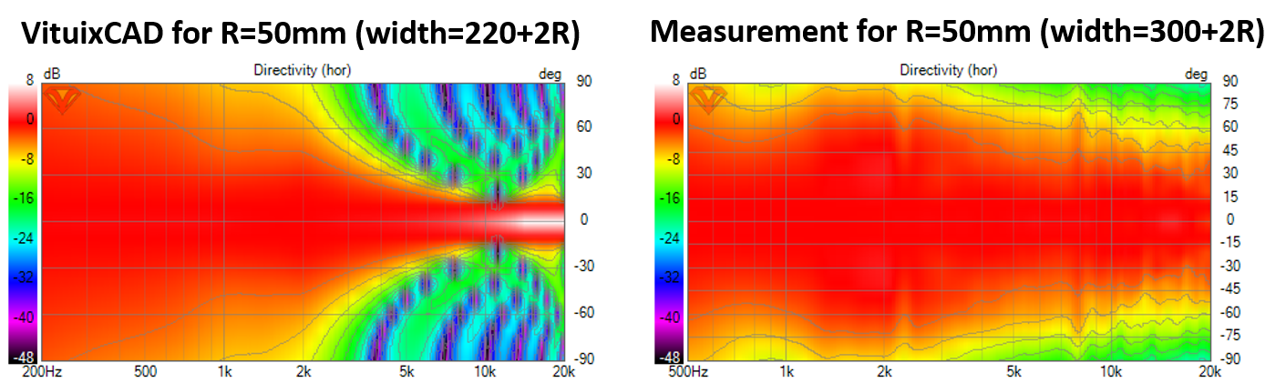

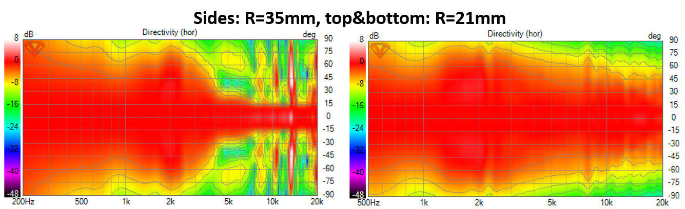

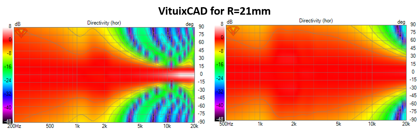

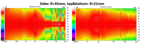

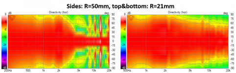

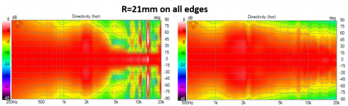

Here's similar simulations for the coaxial mid cone.
Horizontal polars for the mid
Vertical polars for the mid
The design goal would be to obtain smooth directivity and try to manage the edge diffraction effects. The challenge in comparison to real horns and waveguides is that the shape of the mid cone sets quite strict limitations to what kind of waveguide profiles can be achieved using the oblate spheroid + super ellipse formula. There's might also be a tradeoff that extending the directivity to lower frequencies requires a large waveguide. Consequently, the baffle has to be large and thus larger rounding is required to manage the baffle edge effects. I also find it difficult to get reliable simulation data for the baffle rounding effects because having dense enough computation mesh at the edges of the baffle mean insanely long simulation times. Hence, I think it's time to move to experimentation.

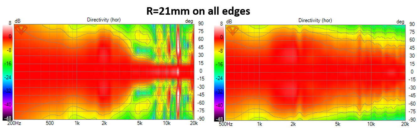

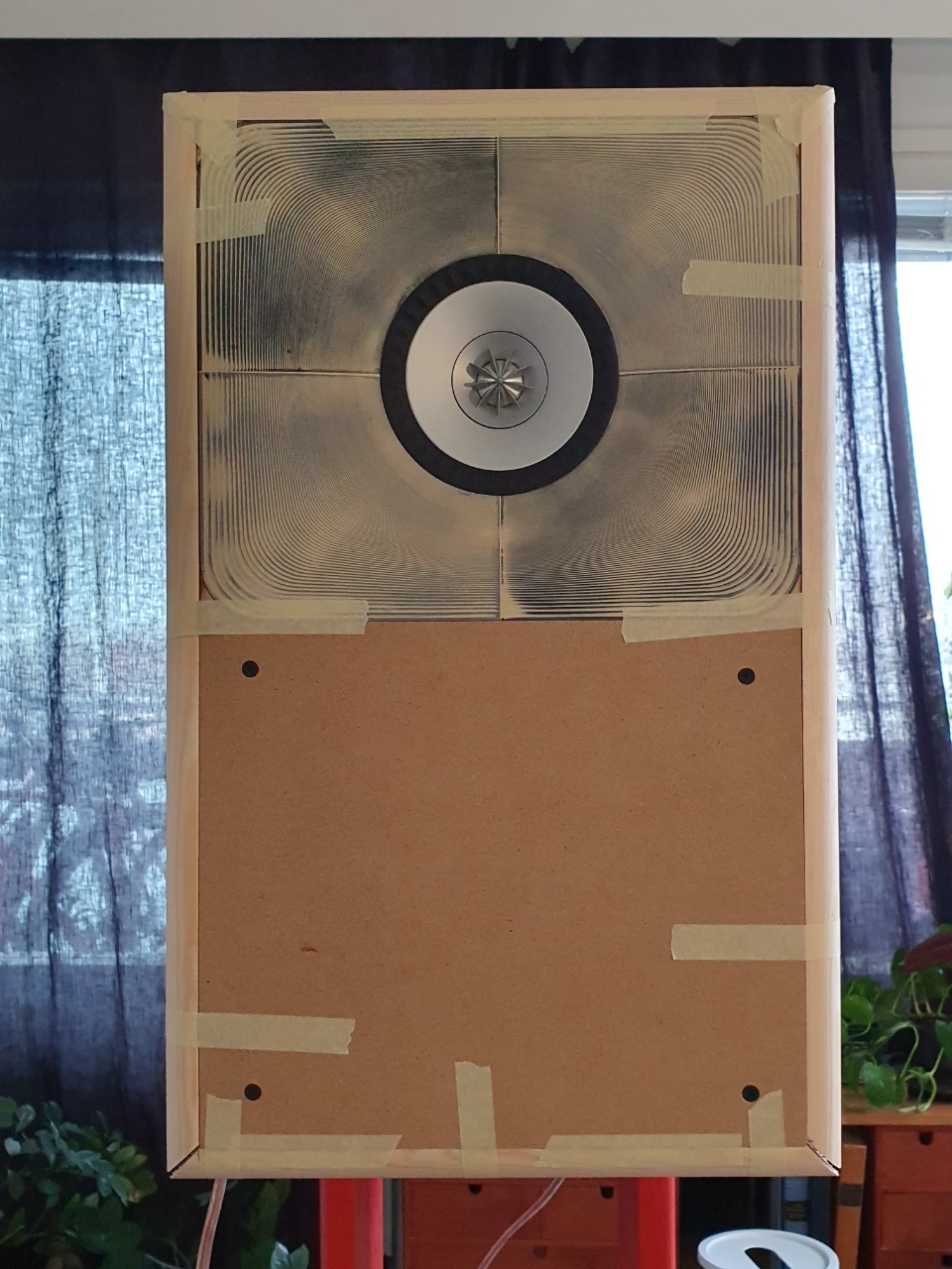

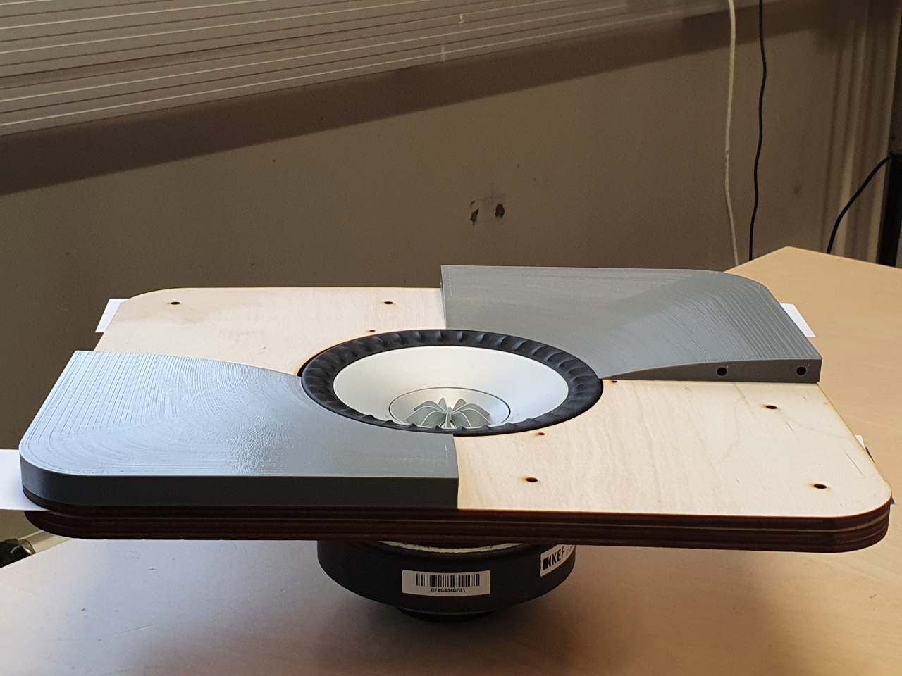

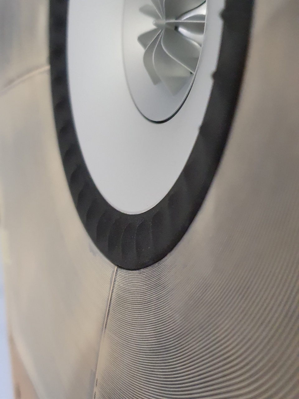

Here is half of the rectangular WG from Ath 3D printed in PLA. The other half is being printed right now.
The 3D printed part stands on top of three layers of laser cut 4mm plywood which includes holes for alignment pins and mounting holes for the UniQ driver. The size of the WG is 300 mm x 250 mm, and the plan is to mount it on a 360 mm x 560 mm test baffle. I have some R=21mm quarter round pine trims that I'm planning to use for baffle rounding for the first tests and the figure out a way to increase the radius.

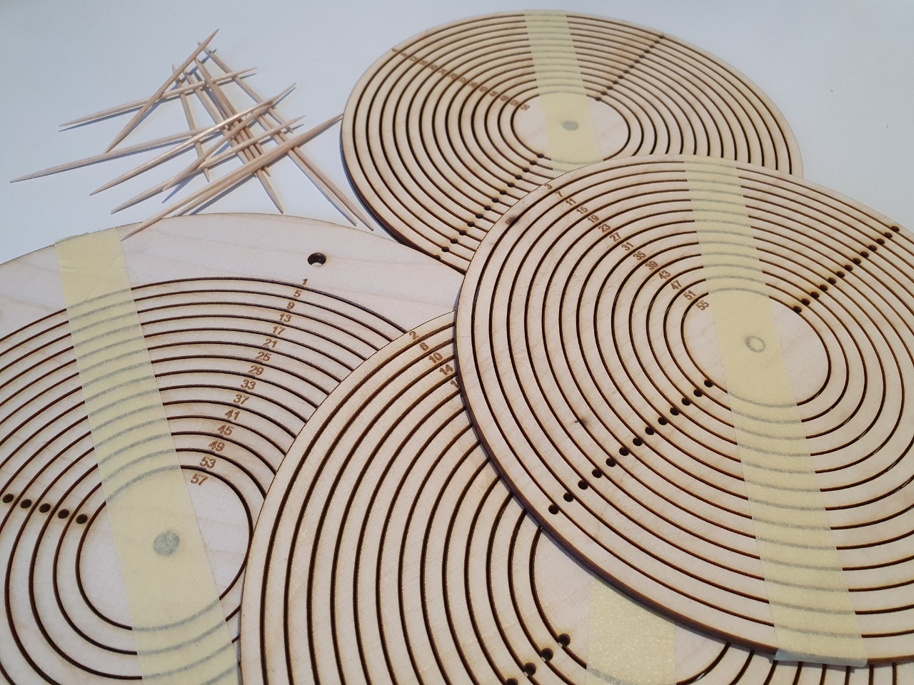

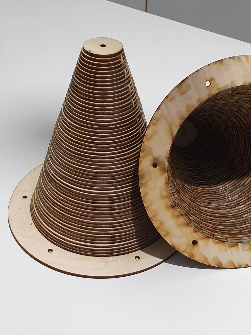

I also crafted conical enclosures for to be mounted to the backside of the baffle. These are 57 layers of laser cut 4mm plywood glued together using toothpicks for alignment. Insane, huh? Well, it's nice and rigid considering the 5mm wall thickness and not much material was wasted. Some supports to be added later and the rear end will be supported to the back baffle of the enclosure.

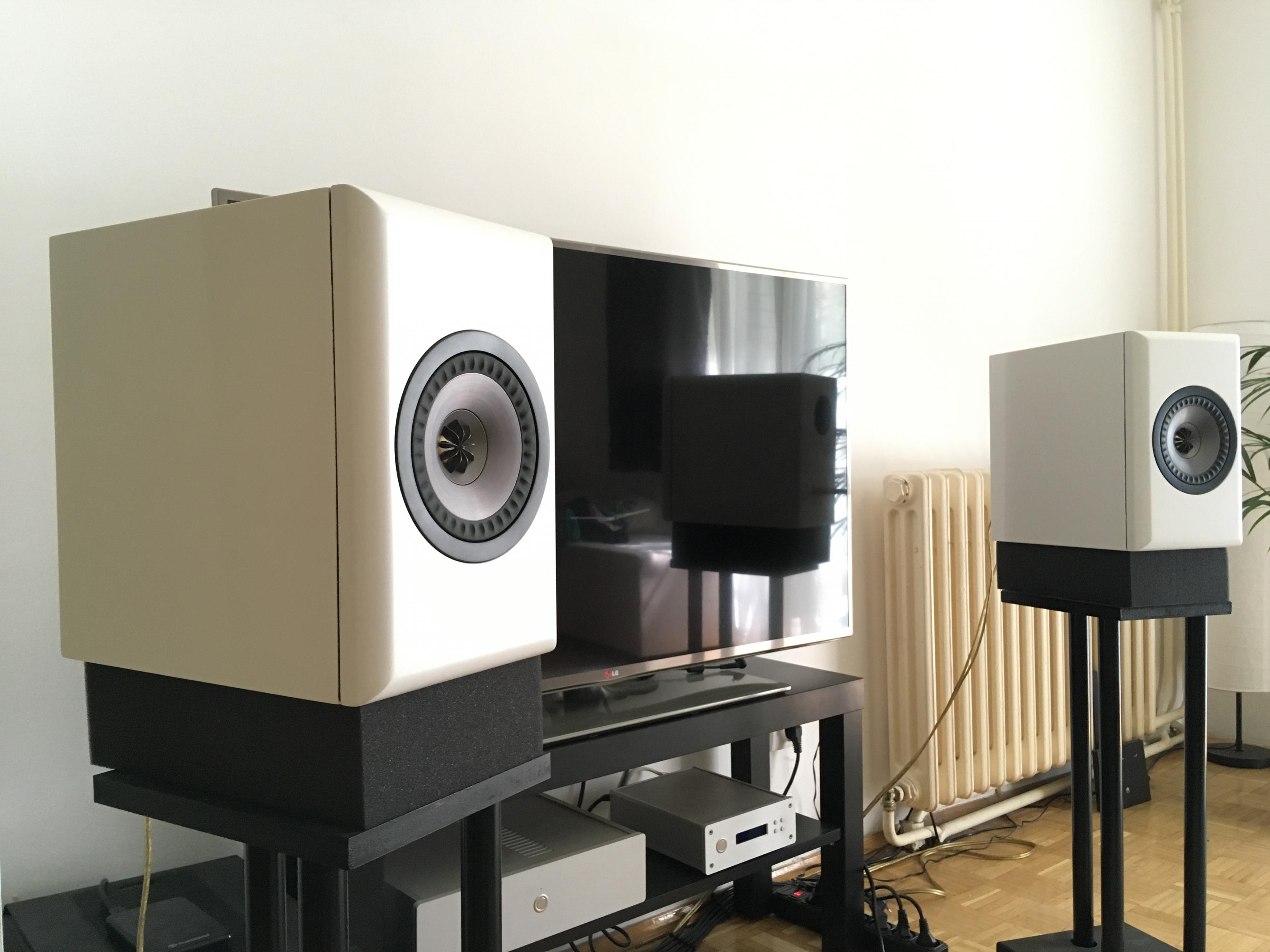

Hello Mr Sticha
I am also utilizing a Kef coax for my project. I'm using 2x7" woofers though.

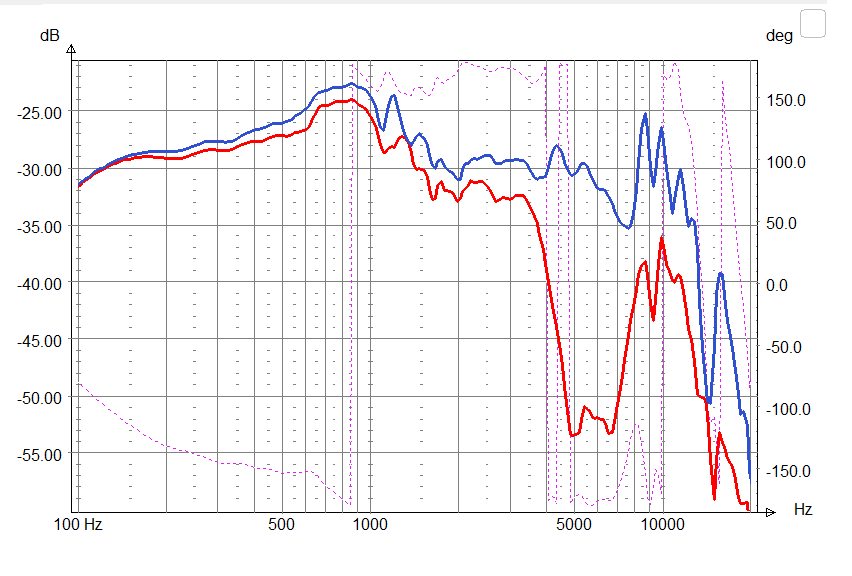

Q100 midwoofer has a resonance at 1100-1200Hz that is quite visible in gated measurements and should be dealth with. No problem for you since you'll be using dsp but wanted to mention it since i don't know how will your measurements be done and how resolute will they be.

Hi, nice! Modern manufacturing techiques at work
For the roundovers, you can use vituixcad diffraction simulator and find out pretty fast how big r roundovers are effective for your application, for the ~1.5kHz issue.
For a flat baffle best results in vituixcad diffraction tool is achieved when the roundover starts right at the driver rim so that flat baffle area in minimized. This means large roundovers if the box has to be wide, and no roundovers when the box is as narrow as possible. Wide with roundovers is a bit smoother but a lot harder to manufacture. You could 3D print the roundovers though.
I have access to 3-axis CNC so eventually I will embed the 3D printed WG in an CNC machined mdf (e.g. three layers of 19mm stacked). What I wrote above was just related to the test baffle for first measurements, which will involve use of cardboard tube or something like that for testing larger roundovers. My plan is to start the rounding right at the edge of the WG and use smooth splines that match the curvature of the rounding to both the WG and the sidewall of the enclosure. This means that larger rounding curvature requires either a wider enclosure or smaller WG. The optimist in me thought that a radius of around 3cm would be enough if it's nicely matched to the waveguide, but that thought was not really based on physics. I suppose I thought that the WG would do some magic there, but now I'm starting to realize that it mainly limits a bit the energy that reaches the edge. Quick testing with VituixCAD shows >50mm is what is needed.
The simulation is probably a bit worse than the reality, because I was using 90deg symmetry. The driver will have different distances to top and bottom edges of the real baffle. Perhaps that and increase of rounding for the sides could do the trick, but I'll still start with the small rounding in order to see how the measurement compares to the simulations.

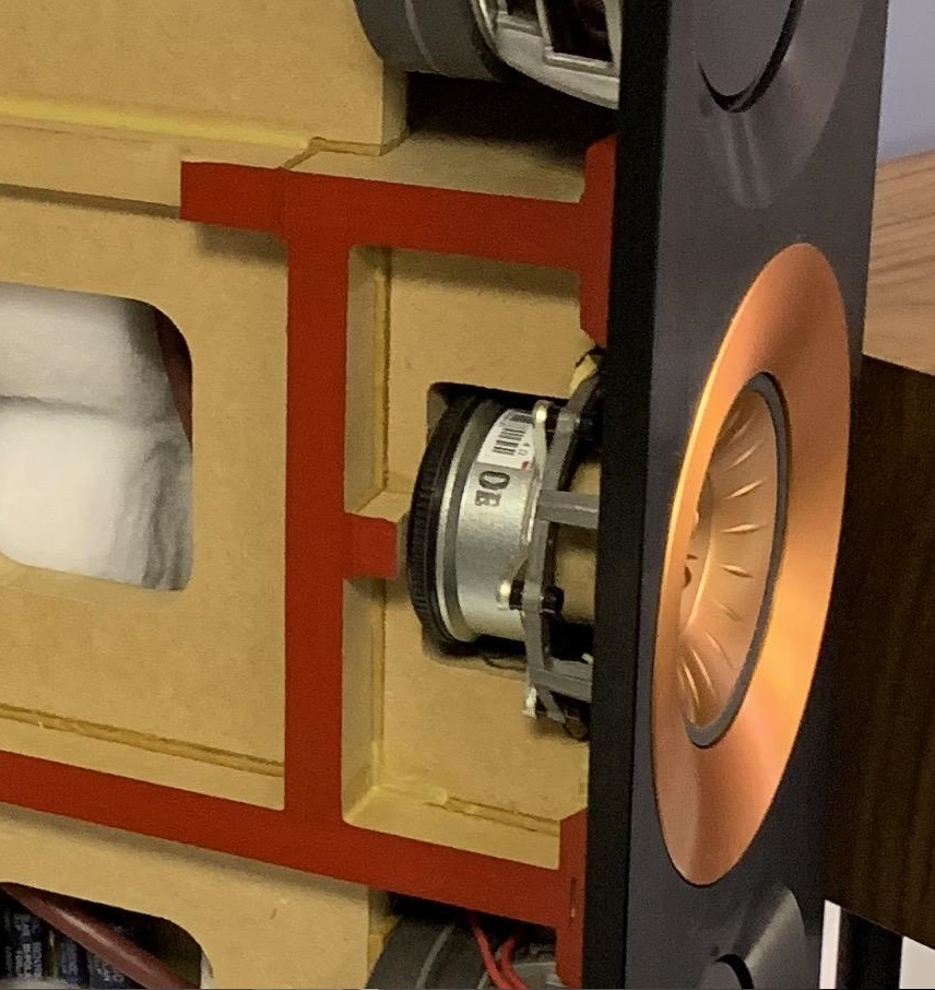

Nice project you have there! That's a newer r series Uni-Q, right? Is the resonance problem fixed by the ribbed cone?
I'll try to find my 10ms gated raw measurement of q100 midwoofer.
Yup, that's new R series coax from 2018.
I don't think that resonance origins at cone but that it is a product of Z-flex surround. In LS50 suspension it is treated with some tacky coat of damping material to minimize the effect.
In R series there was a resonance arround 1kHz but i'm not sure if it is because of driver mounting that was done very poorly in pre 2018 R series. I see no hint of resonance in new R series.
All that being said, the proof will be in the measurements
That would be great. I'm doing the measurements in our apartment so 10ms window is out of reach.I'll try to find my 10ms gated raw measurement of q100 midwoofer.

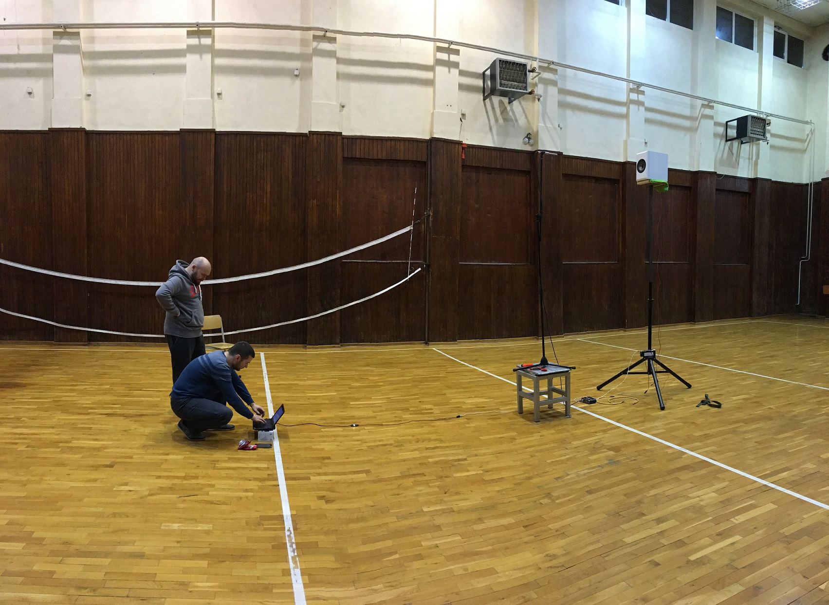

Here it is on axis and 45 degrees off axis. Gate is somewhere between 10-12ms

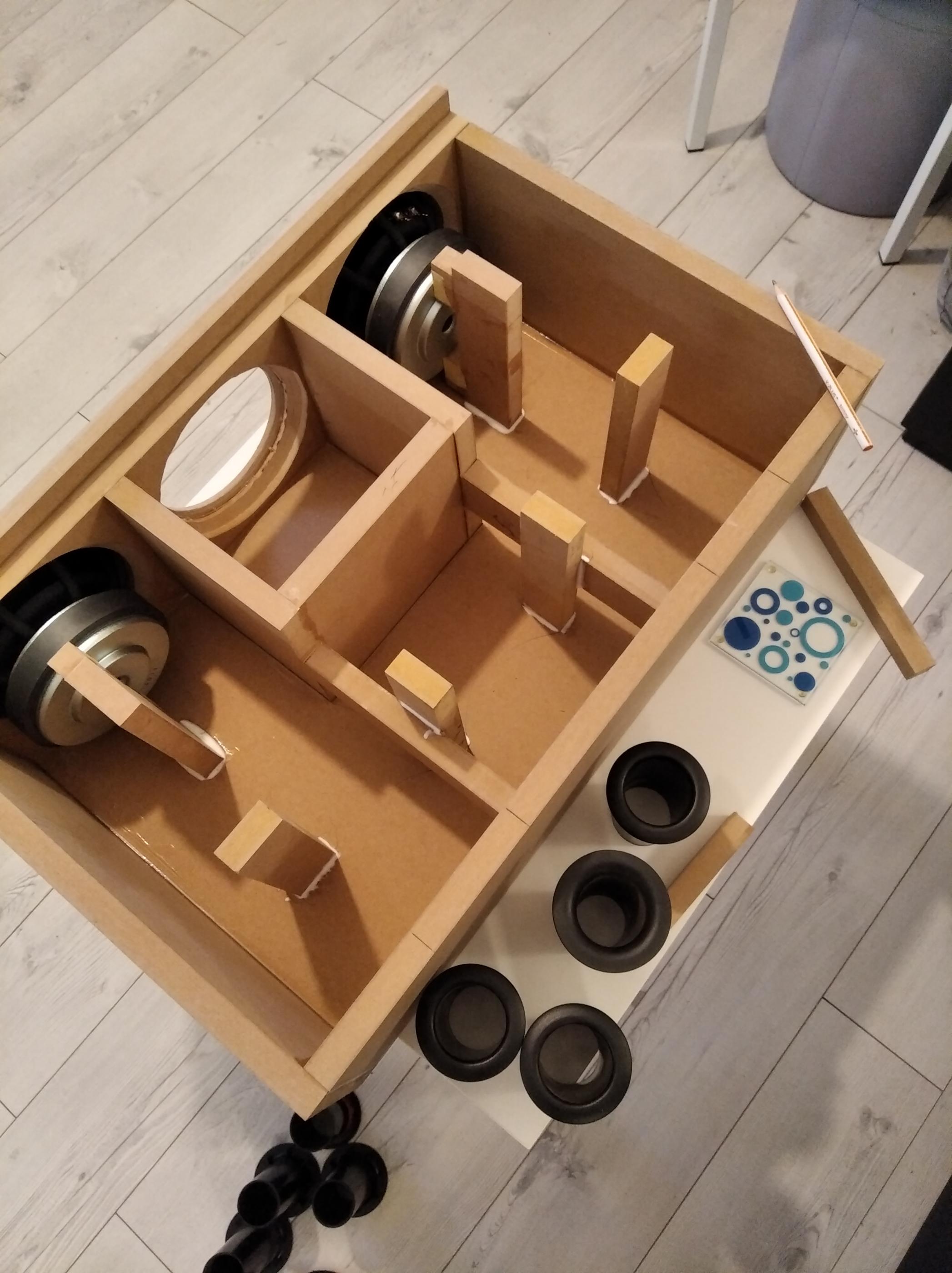

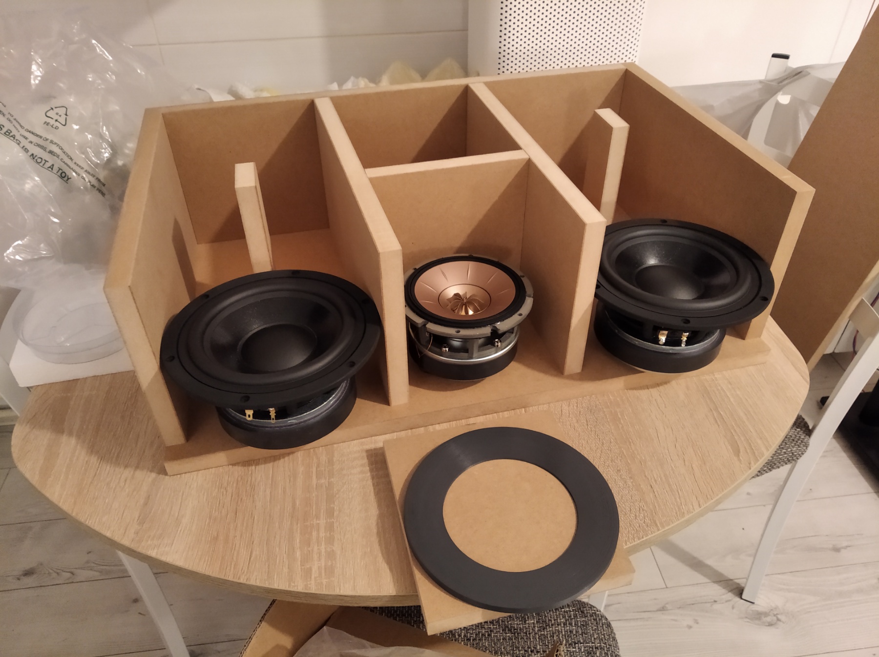

Btw, what kind of enclosure volume do you have for the UniQ and what's the XO frequency for mid/bass?
It is closed rectangular cabinet for midrange with 3,2 liter neto volume. Less when damping material is added. I usually make midrange chamber as big as i need to push the first mode bellow midrange low cutoff, but.. this being KEf coax i examined their cabinets and see that they don't use much volume behind the midrange.
Maybe they know something i don't about their midrange so i decided to test it in such a small enclosure to see how it sounds and measures.
Target for bass/mid crossover frequency is around 300Hz but i intend to utilize my nanodigi to have a listen before i decide. My friend and i made a test with his dsp trying to add 6" bass bellow his Q100 coax (in modified cabinet with modified passive crossover). Point of the experiment was to see how Q100 behaves without having to play low frequencies. We moved the crossover frequency between bass cabinet and Q100 cabinet from 150Hz to 300Hz in 50Hz increments. 150 sounded muffled and every next step sounded better. I couldn't hear any advance going from 250Hz to 300Hz - it sounded the same to me. With every 50Hz above starting point which was 150Hz, midrange sounded cleaner and cleaner. In short, that's how i predict about 300Hz to be fine for my midrange, but i'll certainly do the same test to see what i come up with.

Here's some measurement data for the first baffle+waveguide iteration. First some notes
So in short, none of the tested edge roundings really helped with the baffle edge diffraction. I expected this based on the VituixCAD diffraction calculations.
I did not go beyond R=50mm because I don't think it's practical. Every time I increase the radius, I also increase the baffle width so the problem shifts to longer wavelength where a larger R would be needed to fix it. Next step is the draw and print a new narrower waveguide which allows using narrower baffle. Here's what VituixCAD gives for R=50mm on a 50mm narrower baffle. These are the dimensions where the the rounding starts to mitigate the diffraction problem.
- The fixed part of the baffle was 300 mm wide and 500 mm tall in all measurements.
- The waveguide is 300 mm wide and 250 mm tall.
- The rounding radius R was 21mm for top and bottom edges in all measurements
- The R on the sides was varied (R=21, 35, 50mm) by adding different quarter round objects on the sides of the baffle. The attached picture shows the case of R=21 mm.
- Driver mounting could be improved since it was protruding by ~0.5mm or so (picture)
- Data was recorded using REW, UMC204HD, and Sonarworks SoundID. I was forced to limit the gate to 4 ms this time.
- 7.8 uF was added in series with the tweeter
- All data normalized to 10 degrees.
This is probably close to optimal in terms of how the woofer response comes from VituixCAD. The baffle diffraction provides just a bit of narrowing to allow constant directivity from 1 kHz to 2 kHz from where the tweeter takes over. The measured tweeter response already matches that quite well from 5k to 20k. Next I should to experiment with the 220 mm wide waveguide to see how it works with R=50mm side edge rounding in the 2-5 kHz range.
It also seems that I'm approaching Genelec 8260 (from the 1st post) in terms of baffle width and waveguide shape
