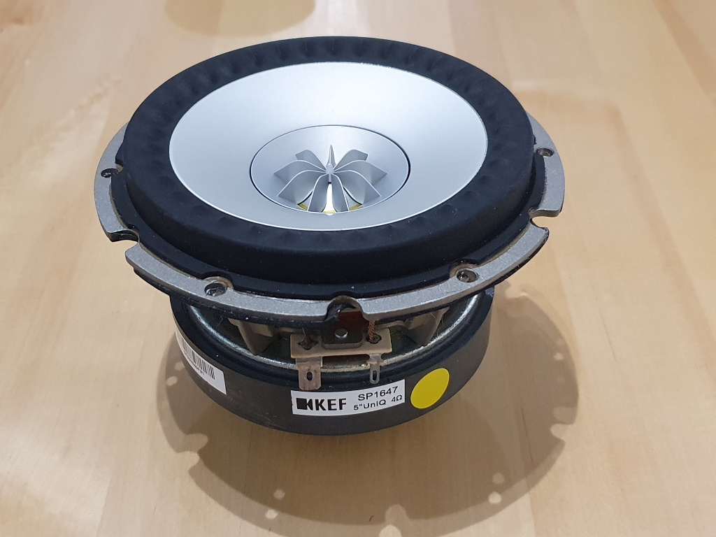

Great! I didn't realise that Q100 is still for sale in Europe. Thanks for the tip! And yes, the R100 driver would be quite ideal for this project.You can still get Kef Q100 which has better drivers.
Look here https://www.idealo.de/preisvergleich/MainSearchProductCategory.html?q=kef+q100
I got a cheap pair of Kef R100 for 300$ of the danish "Ebay". So that's a possibility too.
They sound nice by themselves but I guess that an 8" or 10" driver in a closed cabinet would add some punch.
It's interesting that you mentioned Kef SP1588. That's the 6.5" model, right? People seem to prefer Q100 (5.25") over Q300 (6.5")
Simply because I could not find the raw driver of the other Q*00 or Q*50 models (I even don't know the part number).
I have no idea about individual KEF drivers because I've never measured them, but generally speaking, they are doing a pretty damn good job in recent products.
I suppose I should not judge those drivers based on how well they happen the perform in such low-cost product with super simple crossovers etc.
Indeed, as the final product, Q100 (5.25") does not have good directivity but it was mainly caused by poorly aligned crossover I think, and Q900 (8") was reasonably good, I could not find a good quality measurement of Q300-700 (6.5") but among them, looks rather promising.
And of course, I do not like Q*50's stamper steel frame but not for the sound quality issue, the way it looks!
Other than that, Q*50 could be a great option as well, I personally would use any of these drivers happily.
Oh, one thing I have to mention was, generally speaking, the KEF driver might not have good capabilities of very high SPL or overload, mid-woofer seems to be relatively fragile, so be gentle.

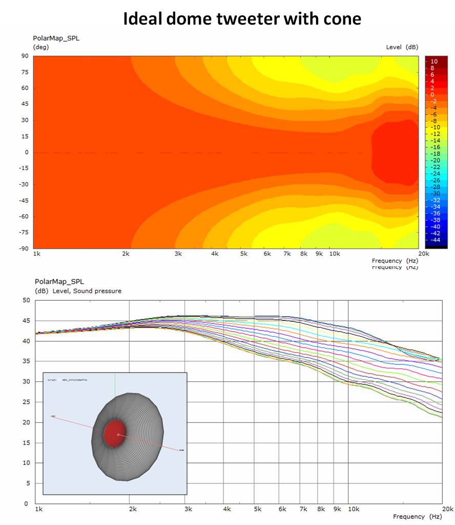

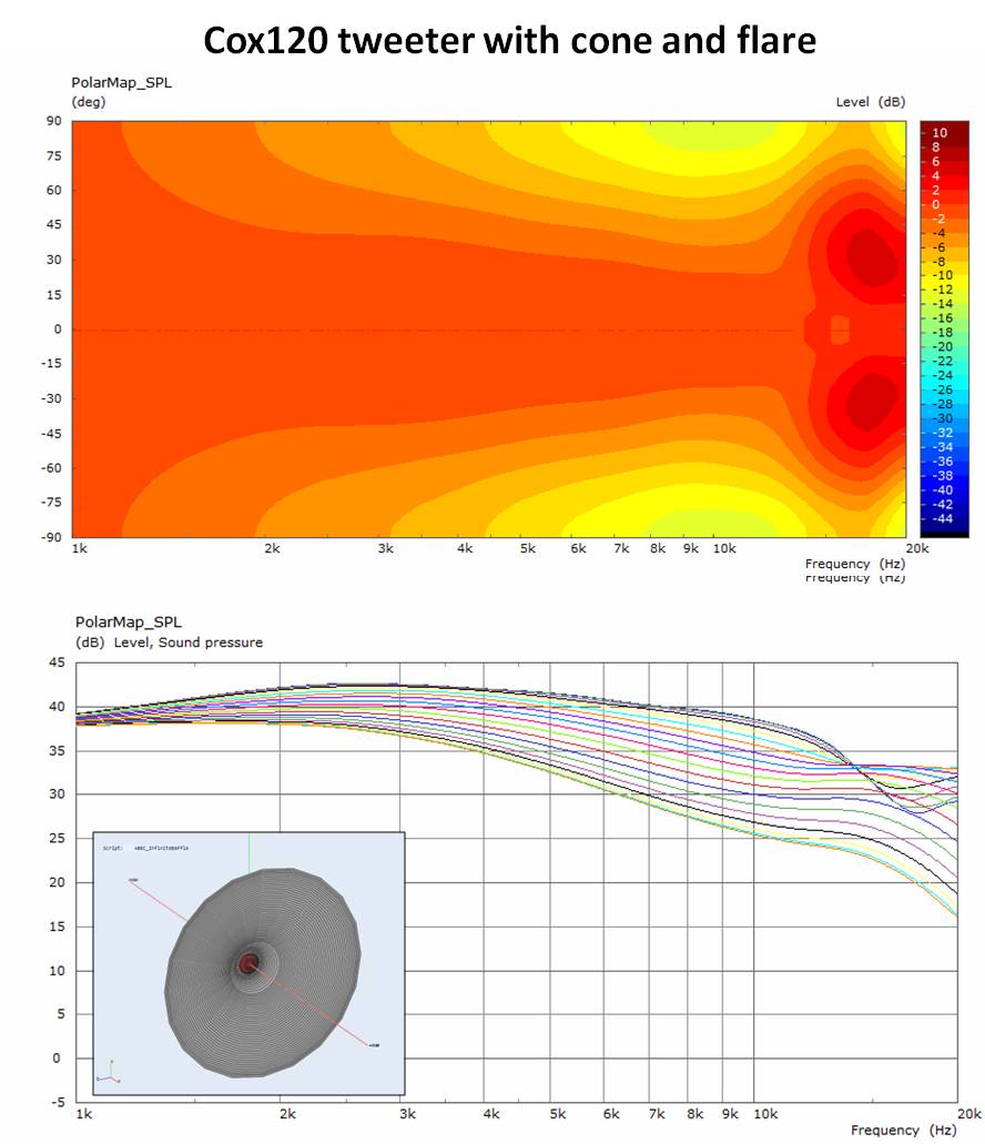

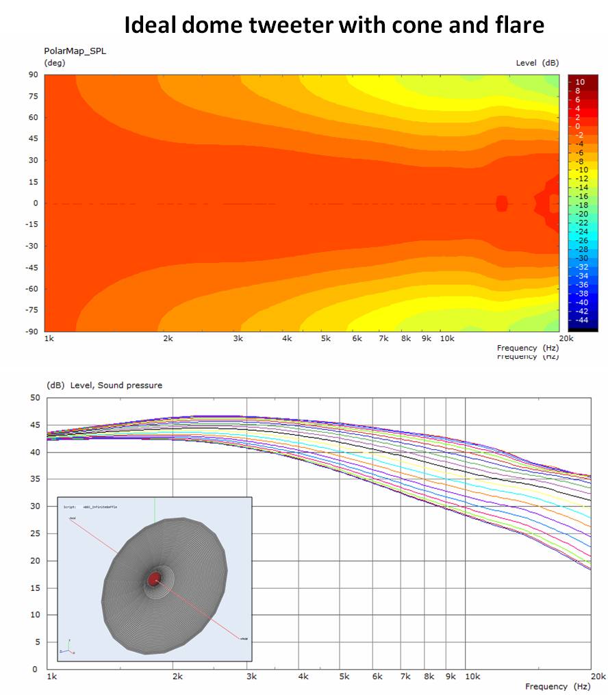

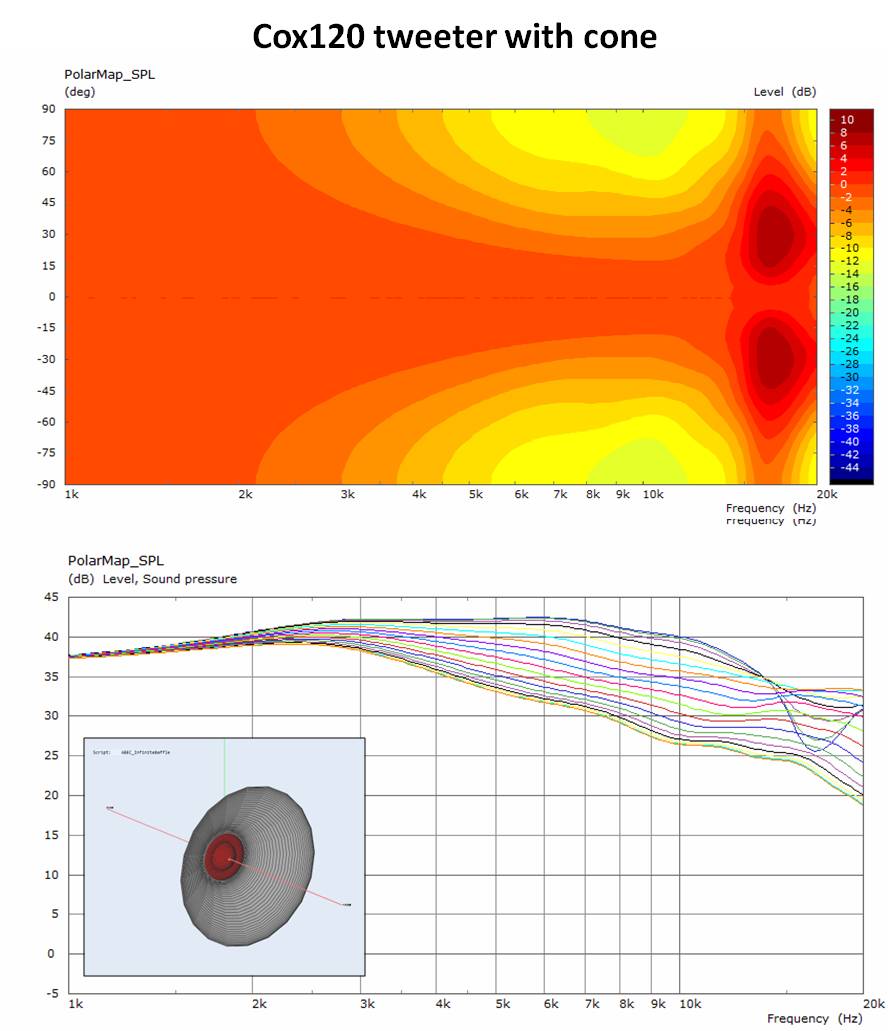

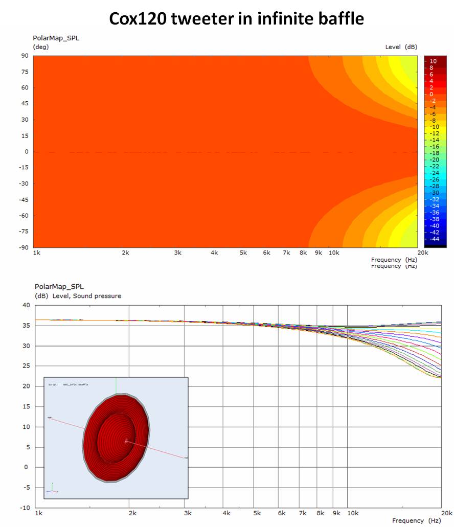

I did some more ABEC simulations for the Kartesian Cox120 tweeter earlier this week mainly just to confirm the previous observations with more refined mesh. I don't think there's really anything new in these results, mostly just confirms what I have been told already, but I thought to share them anyway.
The Cox120 cone acts as a waveguide for the tweeter, but it's far from ideal (as in most coaxial solutions). The on-axis dip can be corrected a bit with the flare as it's at least partly due to poor termination of the waveguide. However, the flare obviously won't correct problems arising from the tweeter geometry. While the tweeter-cone interface does not not include significant steps or gaps, it's clear that this tweeter geometry is not optimal for loading a waveguide. This is most likely because it just doesn't radiate such nice spherical wavefront as a more ideal spherical cap dome (Genelec, KEF) because the suspension contributes to the radiating structure. Elac Uni-fi appears to have a similar tweeter by the way.
The simulations for the "ideal" spherical cap dome obviously look much better. There's the on-axis dip because of the poor waveguide termination, but that can be nicely corrected by including the flare. The results could probably be further improved by breaking the axisymmetry of the waveguide by adding some ellipticity to the flare. With that and nice rounding for the baffle edges, the end result would look pretty much like the Genelec coax + baffle.
All polars are normalized for the on-axis. Note also that the simulation does not include the breakup of the fabric tweeter!

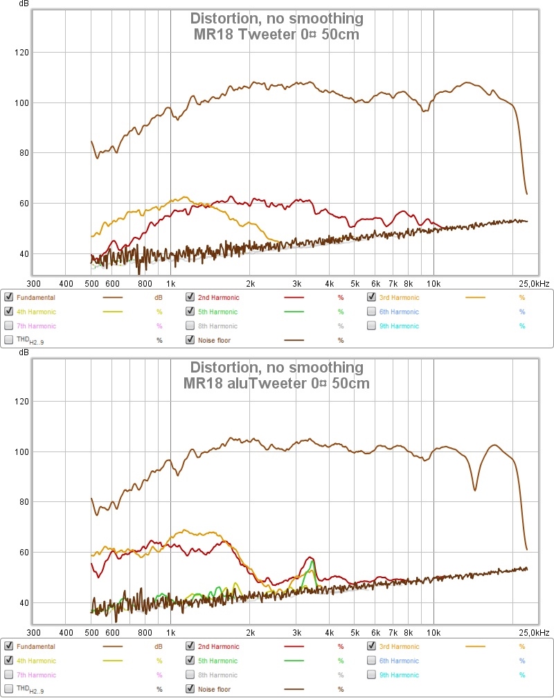

Well, i don't know of any close to perfect co-axial mid-tweeter drivers. KEF upper class new models seem to work best, but I don't know of "raw" measurements of them. Anyway careful eq and xo settings will help to minimize audible issues and let them do the best they can, and reveal the acoustic benefits in room environment.
Most important thing is to use a woofer, to avoid large excursion of the mid cone. Mid-tweeter integration is rather easy to handle with dsp, and tweeter's on-axis wiggles are compensated by off-axis, giving smooth listening window curve.
An example of how different tweeter models behave in SEAS MR18, onax measured by me in this project SEAS MR18 3-way

Yeah but at this point I judge that I can do better with KEF Qx00 or Qx50 drivers than Cox120. The latter has the advantage of making it easier to integrate the cone edge to the flare, but it think UniQ is a better choice overall.
As for the mid dome excursion, a 5.25" UniQ (Sd=75 cm^2) would be better than Cox120 (47.8 cm^2) also in that respect.
