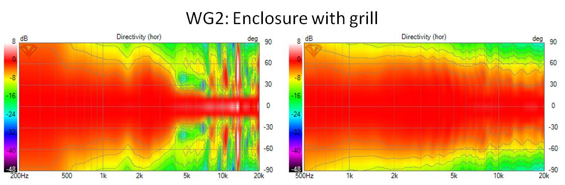

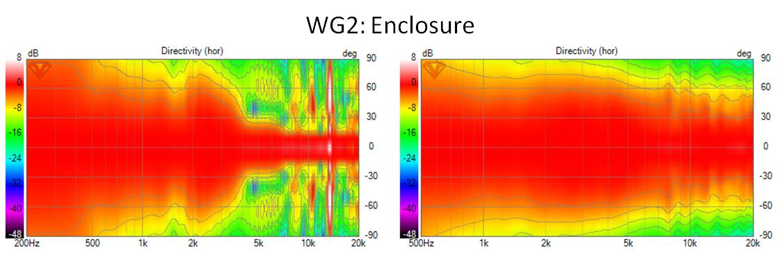

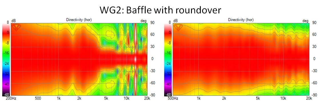

Here are some measurement results for the second waveguide design (WG2), which 220 mm by 220 mm in size. I used R=50mm as the roundover for the sides and R=21 mm for the bottom and top. The baffle dimensions are 320 mm x 570 mm.
attachment.php
As you can see, the tweeter response is clearly improved from WG1 and now looks fairly decent. However, there's still some irregularities in the woofer response. Most notably the narrowing at 1.6 kHz.

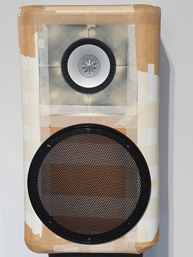

Next I added fiber board sidewalls and roof in order to get some idea of the response of a complete enclosure. The depth of the enclosure is around 320 mm.
attachment.php

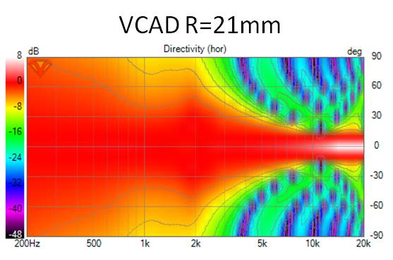

With this the tweeter response is further improved. There's also some small changes in the woofer response, but nothing major. I was also running some diffraction calculations with VituixCAD on the side. Here's how it looks for the woofer depending on the edge rounding.
attachment.php
attachment.php
Clearly these don't really match with the measured woofer responses and provide no explanation for the narrowing at 1.6 kHz. However, there are some dimensions that match that frequency. The width of the waveguide is 220 mm and the distance from the center of the driver to the bottom edge of the baffle is around 450 mm. The edge roundover terminates the waveguide quite nicely to the walls and roof of the enclosure so I thought that perhaps the bottom edge could be the problem. Down there the waveguide terminates to the flat surface, which is then terminated by the edge roundover of R=21mm. On the other hand, the real enclosure would have the 10" woofer in this area. I was also planning to place a grill on top of the woofer. So there would be some diffracting/diffusing elements in between the waveguide and the bottom edge of the baffle. In order to test something towards that direction, I attached the grille to the baffle (attached photo). Here's the response with that in place.
attachment.php
The tweeter looks still good and there is some minor improvement in the woofer response. The narrowing is not gone though. Perhaps there's some contribution to this from both the waveguide dimensions and the baffle dimensions. Hard the say based on the data that I have at hand because neither ABEC simulations nor the diffraction calculations give much hints. Generally speaking I think a weakness of this approach is that, while it seems to work quite well for the tweeter, the woofer does not get much benefit from the waveguide but suffers from the long distance from to the baffle edge which is forced by the wave guide dimensions.

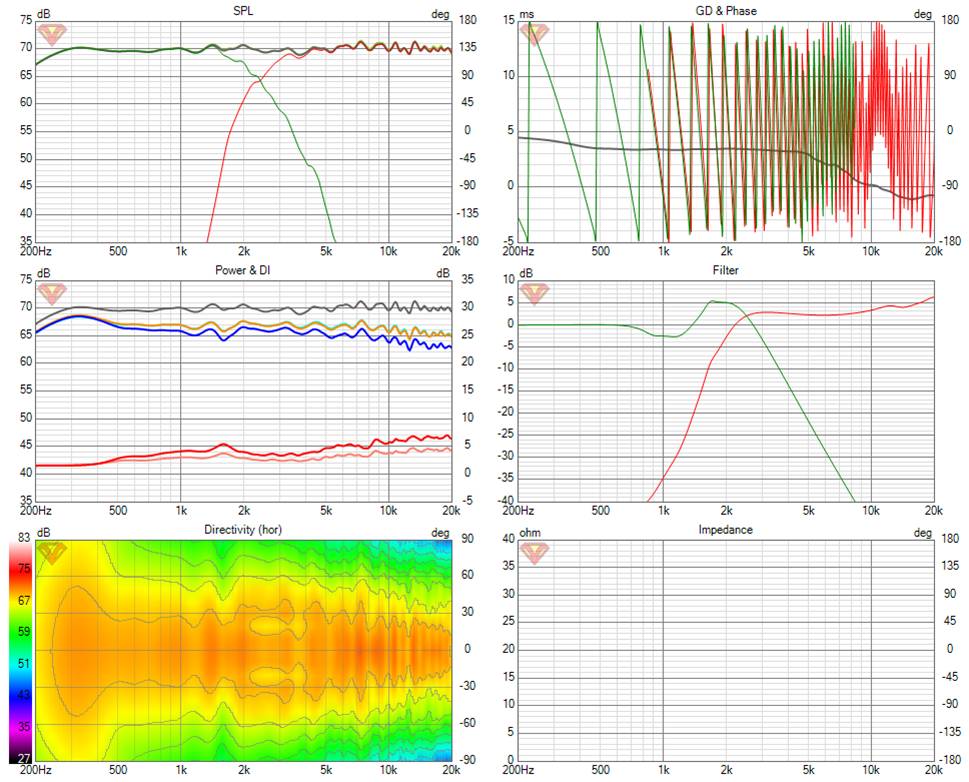

Here's a quick mock-up of the combined response.
attachment.php
Not amazing, but not terrible either. Looks sort of like KEF R3, but with a bit more directivity extending to lower frequencies. I suppose the biggest issues are the narrowing at 1.6 kHz and the widening between 2kHz and 5kHz.

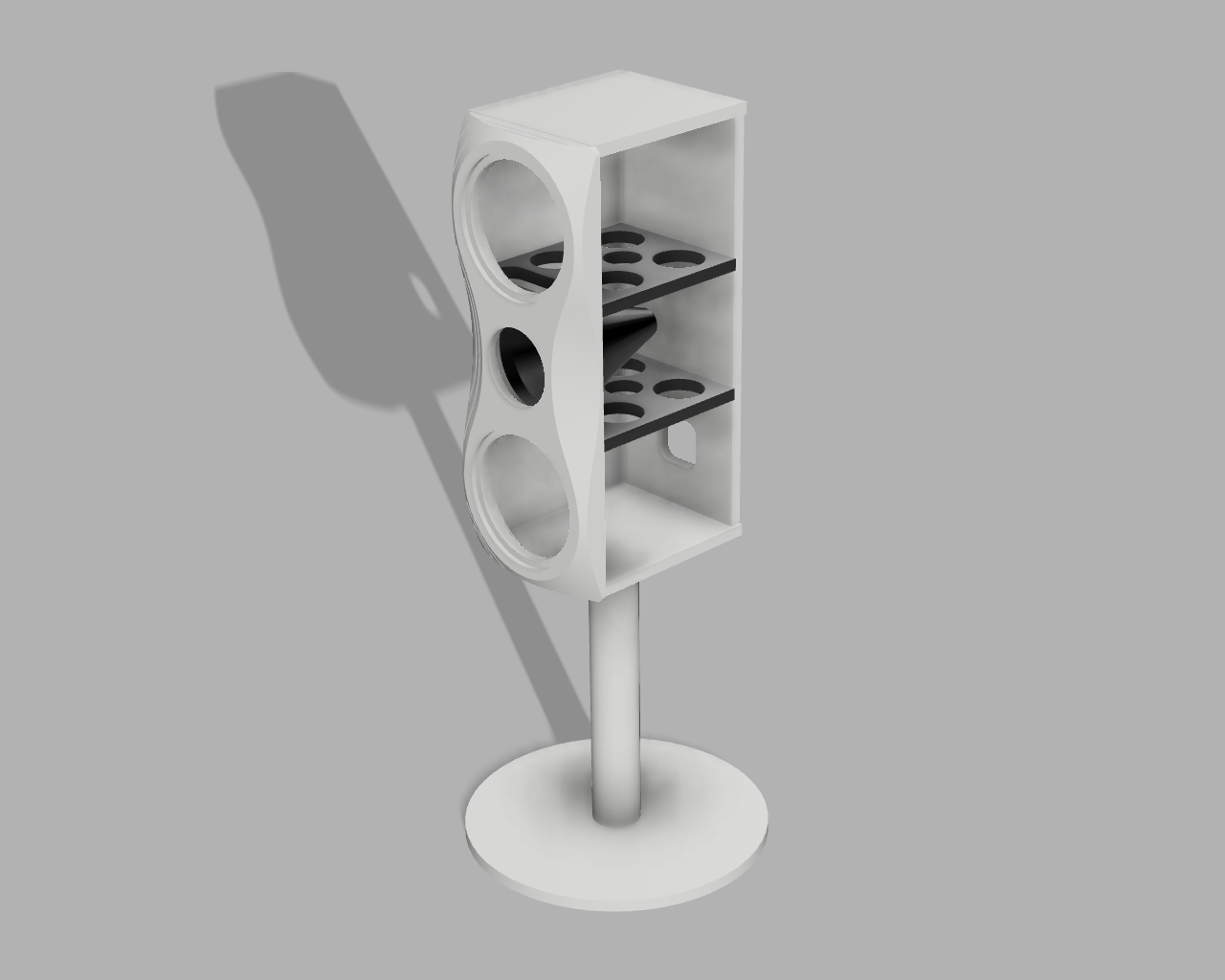

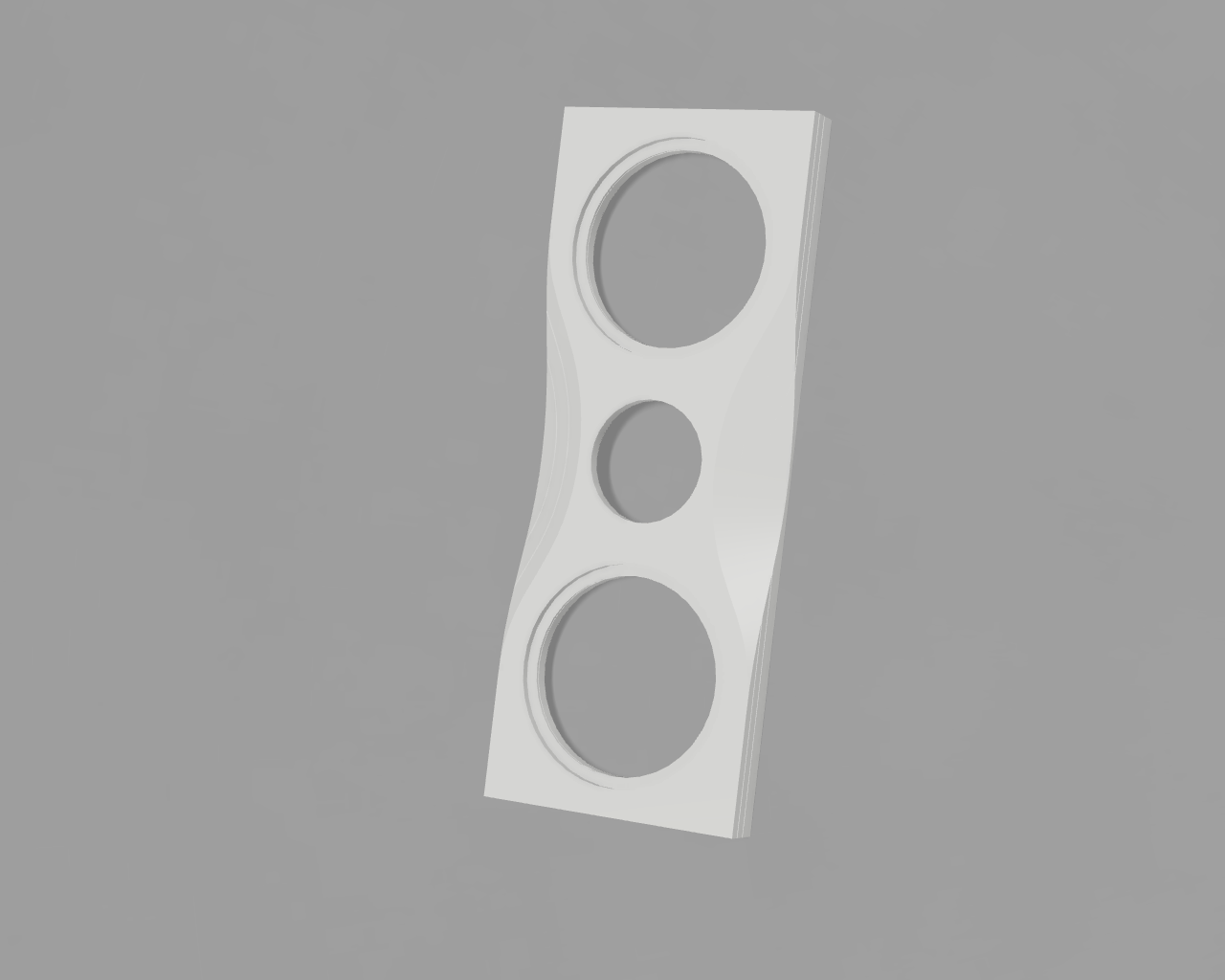

This is how the enclosure would look like for the woofer-coaxial-woofer approach. All drivers and the conical enclosure of the q100 driver to be mounted on the backside of the baffle, so the rear panel would be removable. The recess on the font side around the woofer opening is for a metal grill.

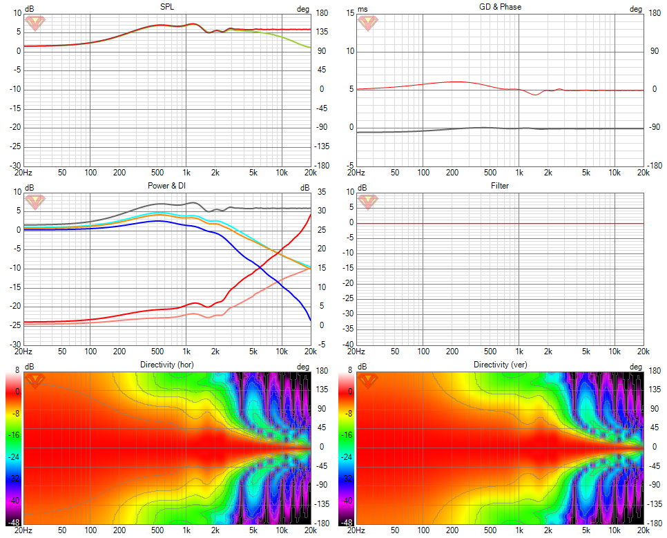

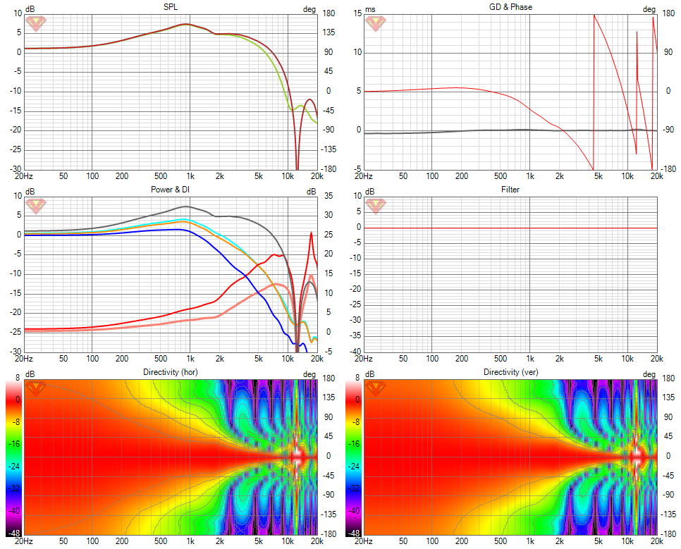

Here's the diffraction calculation for the mid and woofers. This is for a realistic baffle size and driver placement, but includes no edge rounding or chamfering. The actual directivity for the mid (and tweeter) is revealed by measurement once the baffle is machined. I don't think I can simulated it reliably with ABEC.
For mid
attachment.php
For woofers
attachment.php

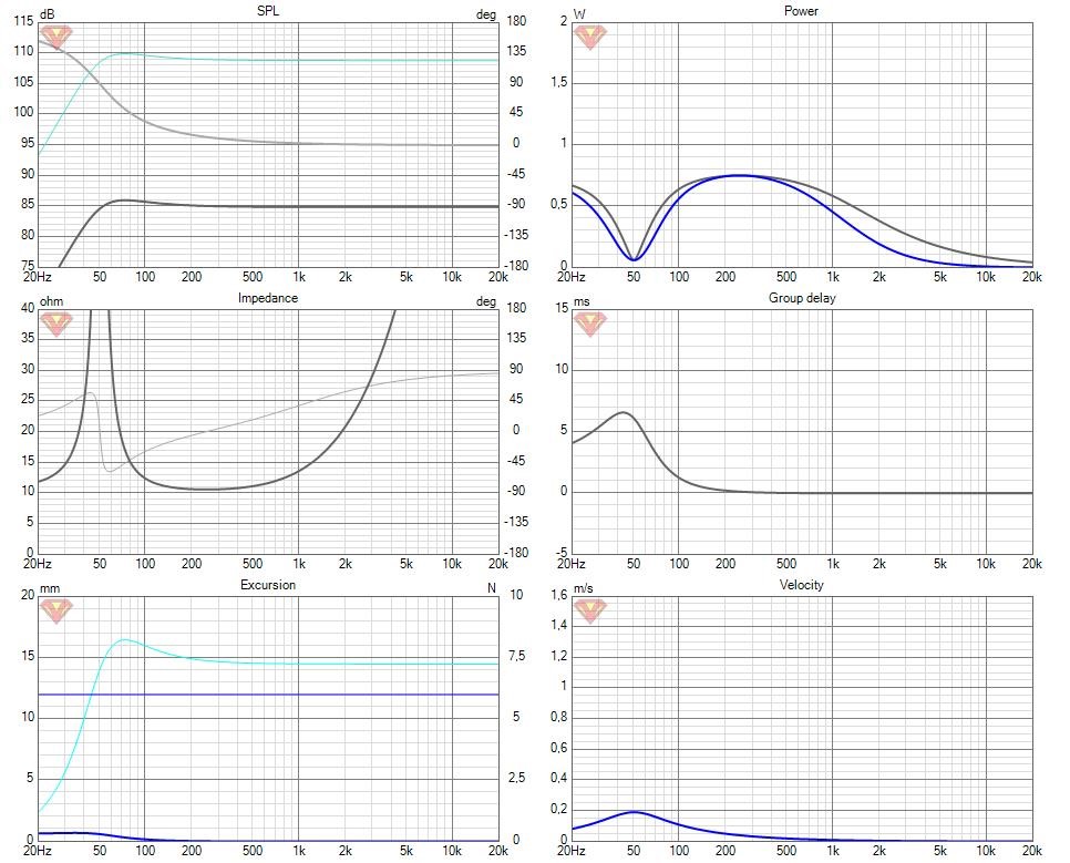

Finally, the alignment for 2 SB23MFCL45-4 woofers in series in a 30 l sealed enclosure. The x-max is reached around 35 Hz with 220W at 109dB. Add a bit of boost with DSP for the low end and it reaches nicely to 30-35Hz which is enough for me.
attachment.php
What do you think? I think this could work.

Thank you krivium. I suppose a more common choice would be to make it a tower with two woofers below the coaxial, but I like symmetry. This way I will also have a nice option to add a fourth way (a 12" or 2x10"...) if I ever move to a bigger space and need more displacement down there.
