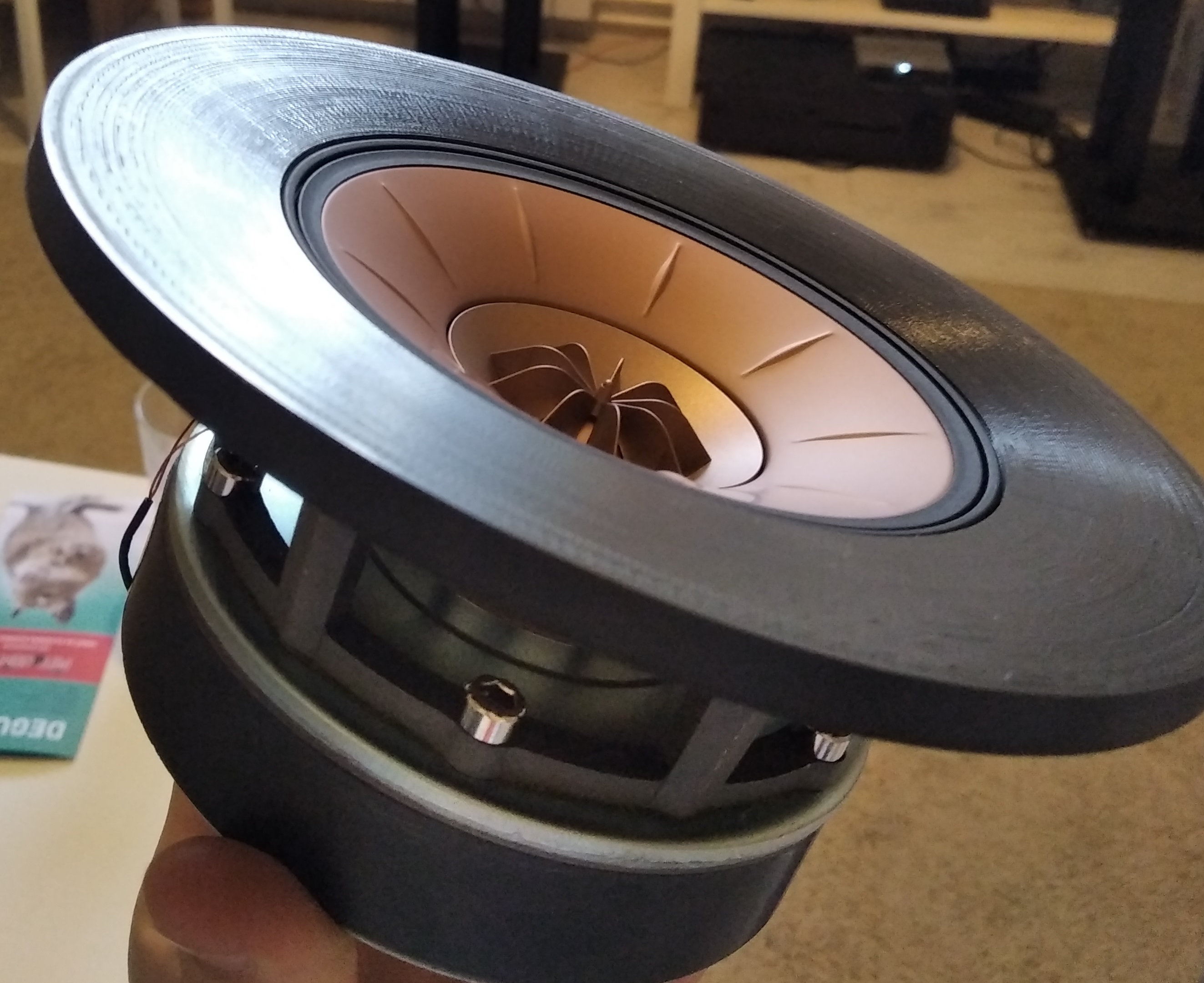

No discontinuity in height between the cone and tweeter/phase plug that i can see or feel with my finger. Other than space between them, of course.

Looks nice - driver with shadow flare. If you are interested in another TW in coax, at the end of road, I'll have .stl for Peerles (or another one TW). As I can see, you have 3D printer so you can try it too. The question is if geometry insde R driver is same as in Q300 case...?

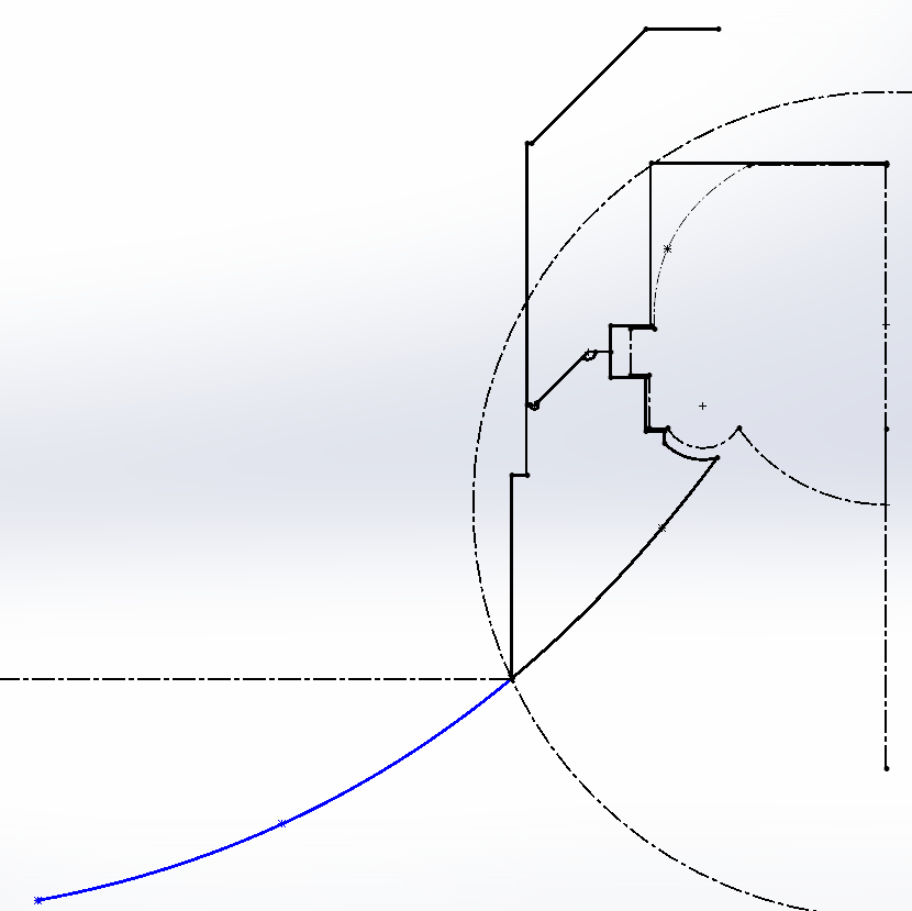

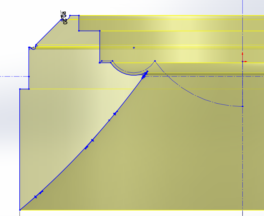

I can post here some drawings of new flange for Peer 3/4". I think that is goal to cover surround, as you say. Original KEF design is the same. I want to try two designs - without tangerine and with it. Now I'm fighting with 3D model, it's a complicated shape...

Tweeter is Peerless OX20SC00-04, stv you're right. It's only 3/4" but I hope it will act good in midbass cone profile. Maybe mesurements shows unexpected problems. I would like to simulate TW in this specific conditions to avoid trial-and-error method. 🙂

Your work on measuring different TW drivers in various waveguides is very beneficial, thanks for link to your website. In fact I have decided between Peer/Vifa OX20 and OT19, and I bought OX20. I don't see problem to order ring radiator OT19, if I'll not satisfied with measurements. If soft dome TW's are hard to simulate in ABEC, all I have to do (as Zvu says), is print the adapter for the OX20 and test how it will behave during the measurement - in my opinion.

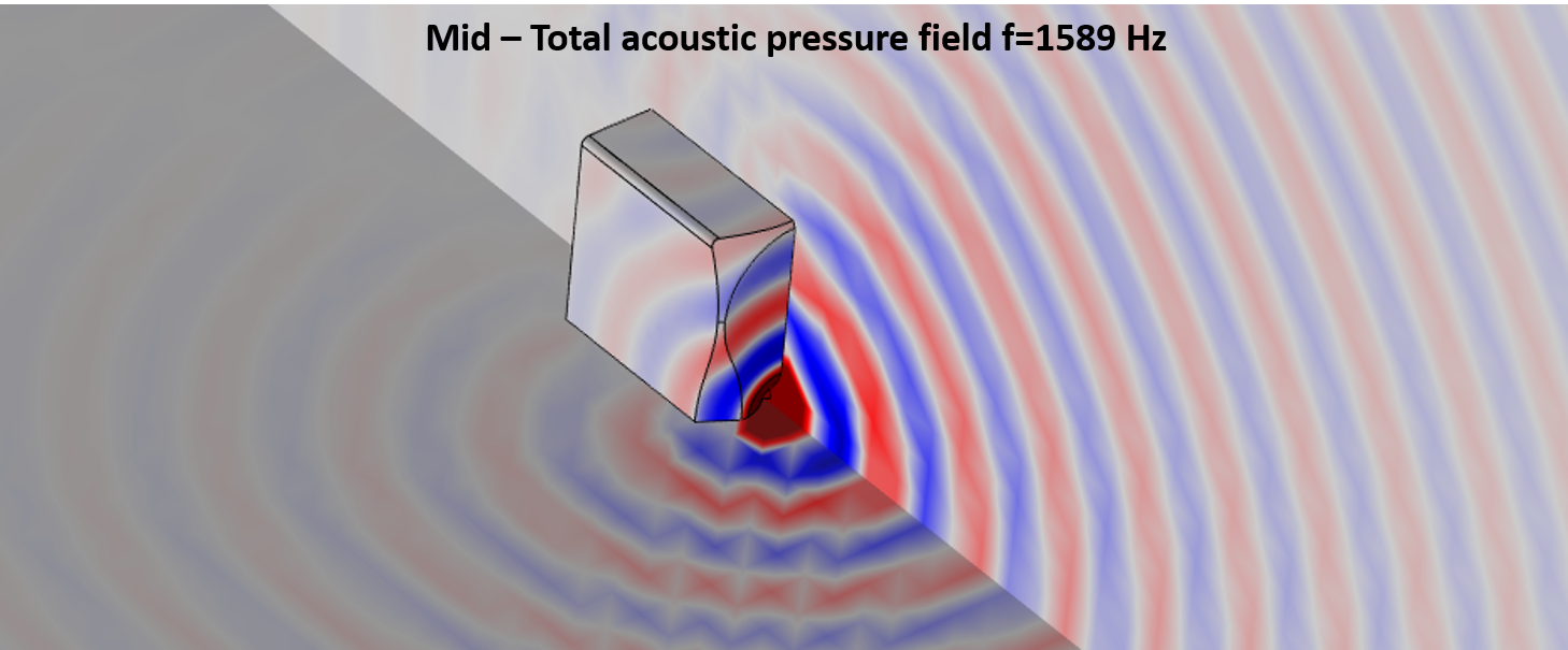

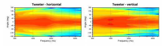

I just couldn't resist... It was pretty straightforward to set up a Comsol BEM model for the woofer-coax-woofer speaker with the Fusion 360 model already at hand. I still have to do some refinements, but here are some results with woofers replaced by planar surfaces.
2dB steps

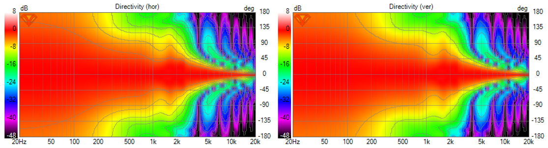

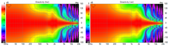

Here's VituxCAD for the mid for comparison. Same baffle dimensions, but without any edge rounding or shaping for diffraction control.

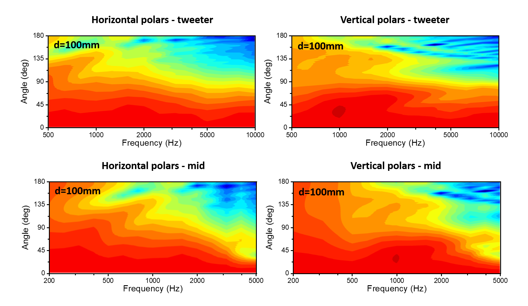

Finally, the pressure field for the mid at 1.5kHz, where the most significant diffraction features are observed.
It may be the plotting but are those features resolved?

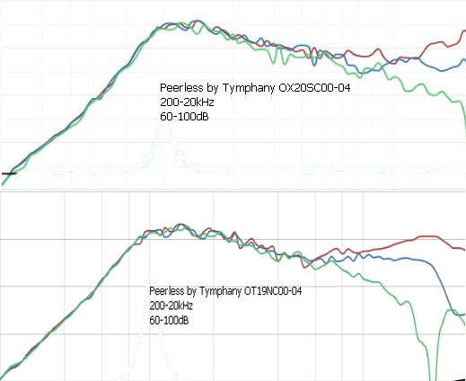

I made a little comparison picture with manufacturers frequency response of drivers. I think OX20 gives better off axis respones. What do you think? Is the key WG loading? In my opinion at high frequencies (10kHz+) is WG without effect.
The results on a waveguide won't look anything like that. You'll have to make the actual measurements to know for sure how it will react.

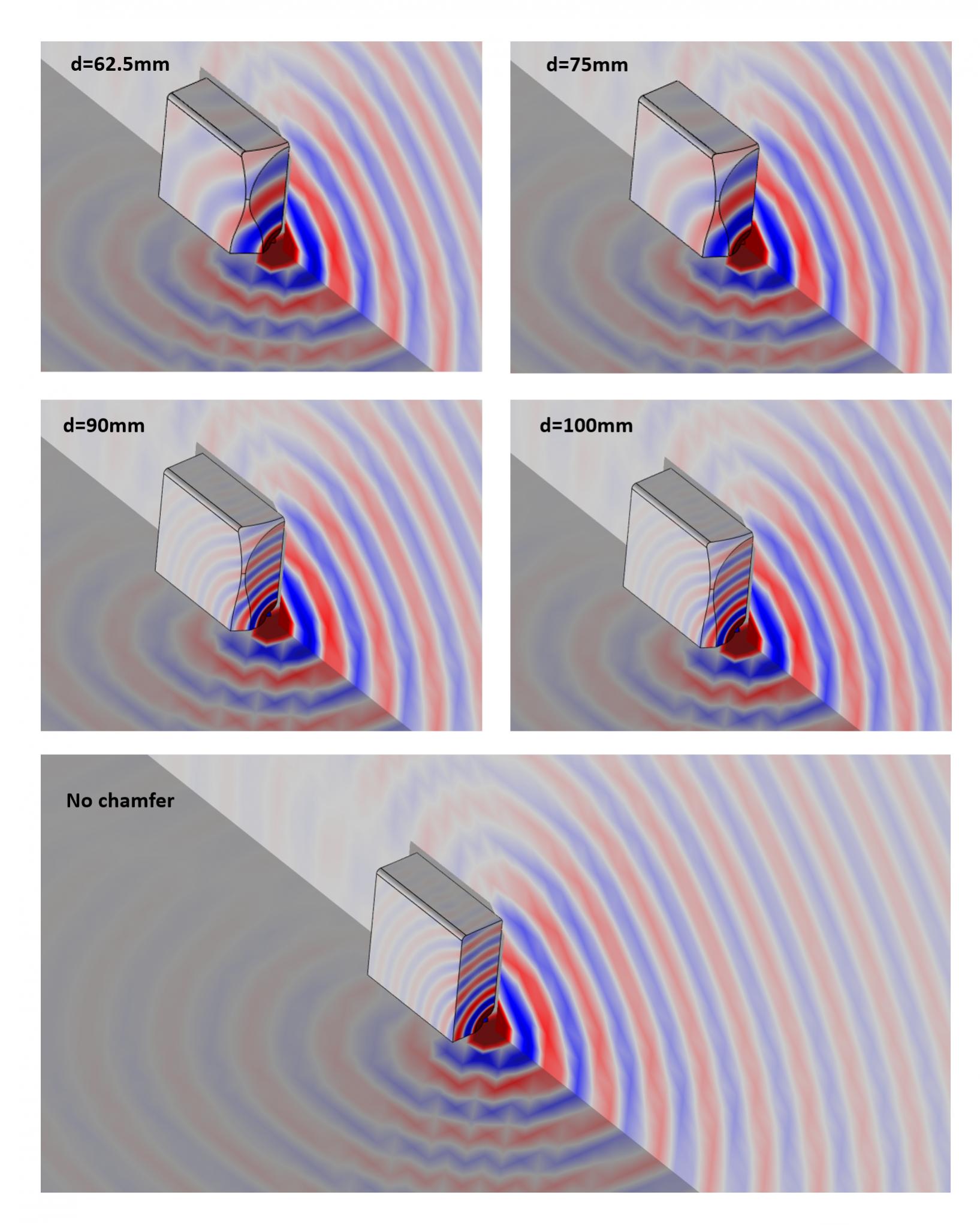

I believe this is reliable data. The model is for 90deg symmetry and includes around 10000 mesh elements and 15000 degrees of freedom. Solving for 15 frequency points from 200 to 5000 Hz takes a couple of hours (i7-8650U, 32GB RAM). I think a coarser mesh would have been sufficient for lower frequencies, but in the end it's the computer doing the heavy lifting while I do other stuff.

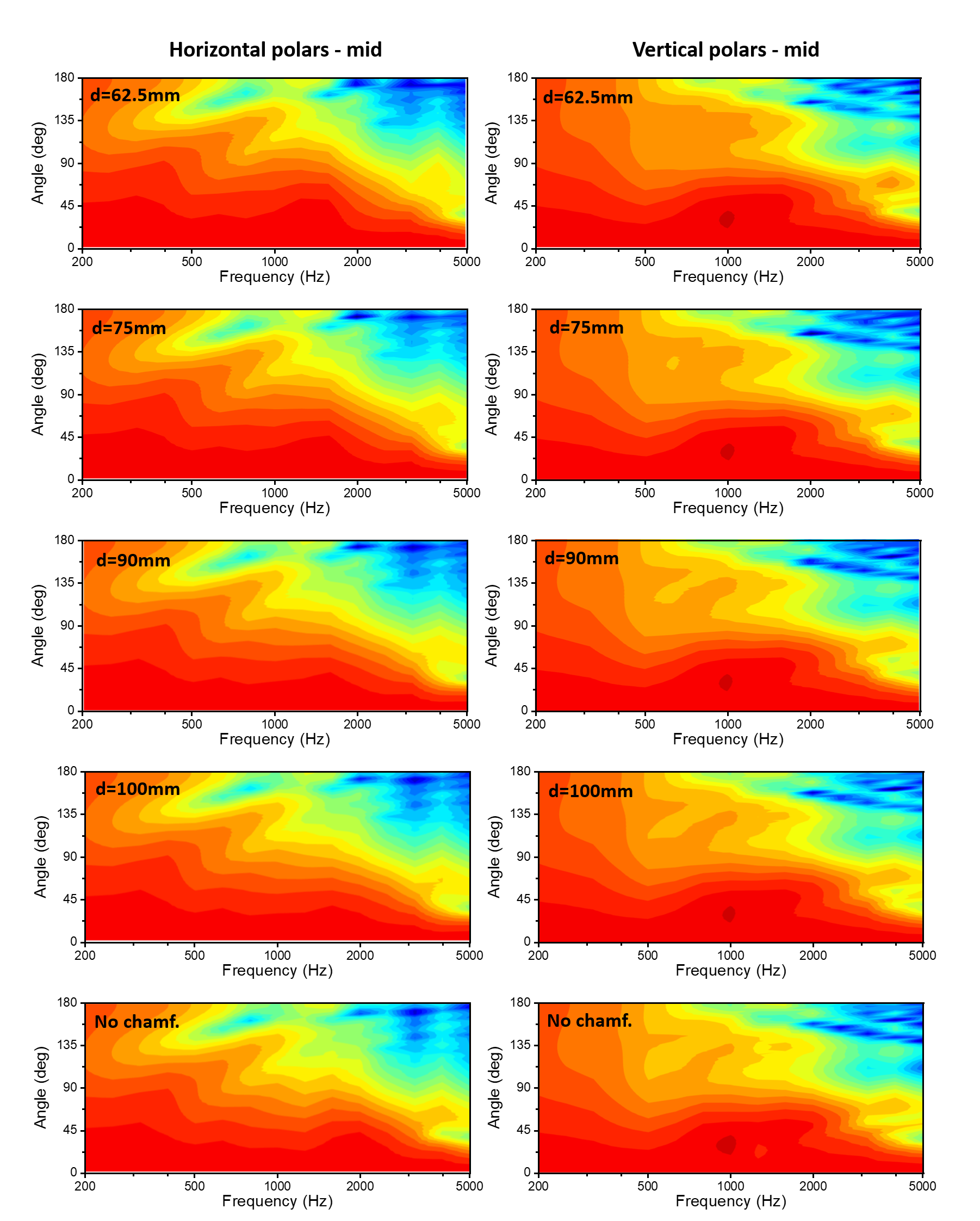

The pressure maps are for f=1589Hz. They are shown for illustrating the different cabinet shapes. One is for no chamfer and the others I varied the parameter d, which is the lateral distance from the center of the driver to the point where the chamfer starts. So small d means large chamfer.

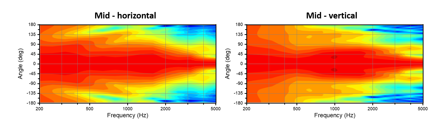

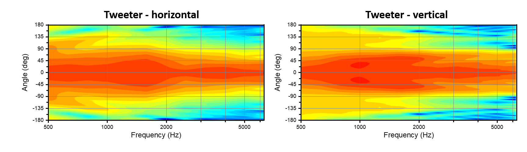

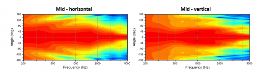

The interesting stuff is in the horizontal polar around 1.5-2kHz.* Without chamfer the widening is closer to 2kHz as predicted by VCAD as well. At the opposite end is the largest chamfer (d=62.5mm) which extends all the way to the driver edge. Here the widening is closer to 1.5kHz. The smoothest directivity in this range is observed for smaller chamfers (d=90 or 100mm).
So the largest possible chamfer is not always the optimal. This is most likely because it creates a new facet and we should consider the dimensions of these facets together with the other enclosure dimensions such as width and driver size. There's diffraction from both edges of the chamfer. In this respect, roundover is probably safer choice if executed without modeling or experimentation.
I should also thank Andy for gently pushing me to this direction. It's probably not a surprise to you that my initial choice of d was not the optimal one😀
*I hope that the color contrast between the most intense contours is displayed well enough on your screens. Removing the grid lines seems to have helped at least my eyes/brain.
Are you using triangular, quad or a mixture of elements? Are they generated with or without a pattern? What is the order of the element and the number of elements per wavelength?
Counting the wavelengths on the baffle seems to show plots at different frequencies.
It is normally easier to see and read quantitative differences from sets of curves rather than contours. Contours are normally better for a higher level overall view. The lines between the levels helps with seeing small detailed differences even if this comes at the cost of a bit of visual clutter. Not a significant criticism just a minor moan that I am finding it a bit harder to judge the size of differences than I would like.
When things have settled a BEM/surface vs lumped/edge model would be interesting and possibly useful in demonstrating the limits of the lumped/edge approach. It is computationally very fast and seems to work quite well for square baffles but likely less so for doubly curved surfaces.
Not sure I wholly follow this comment. Do you intend to simulate more radiused shapes and steeper chamfer angles? Or have you settled on one of the geometries shown for the (first?) build?
It is good to see this kind of simulation which is starting to grow in the hobby. Still early days but they are often the more interesting.
I used triangular elements with quadratic discretization for pressure and linear for normal acceleration. The mesh is generated in this order: tweeter dome -> coax cone -> baffle -> rest of the enclosure. Consequently, it starts with a circular pattern (driver) and morphs into a square pattern (enclosure). Perhaps using triangular elements for the driver and quad for the rest might be good option. I'm getting average mesh element quality of 0.9 with the current method. The maximum mesh element size is 16mm, but around the driver and most edges it's finer (~3-8mm).
That may very well be so. I did not pay much attention, because I showed those plots mainly for illustrating the simulation geometries.
I totally agree. I was a bit lazy in this respect because I don't like plotting data with Comsol. Usually I export that data and use Matlab or Origin for plotting, but this time I just generated the plot axes elsewhere and took the rest of the plot directly from Comsol.
I can do that at some point, but I have some homework to do on lumped model. In any case at best I can provide a comparison of the two approaches for a specific case. I don't think I am the right person to make any general conclusions about the computation methodology.
It has been repeated on this forum, and in this thread, that the edge rounding should ideally begin right at the edge of the driver, i.e. maximal rounding size or alternatively minimal baffle dimensions. On the other hand, it is often said that a chamfer works just as well as a roundover. I just wanted to point out that the chamfer is effectively a facet of the baffle and there is diffraction from the edges of the facet. Hence the chamfer size should be considered from the diffraction point of view instead of just making it as large as possible. I suppose this is quite obvious.
Note that I have used a 30deg chamfer for all simulations and just varied the chamfer width. The reasoning for using a chamfer instead of a roundover is that it is easier to manufacture. This kind of chamfer can be routed with a 120deg v-groove bit following paths in xy-planes, so it's much much more simple that machining a general 3d surface which is not defined by the shape of the router bit.
