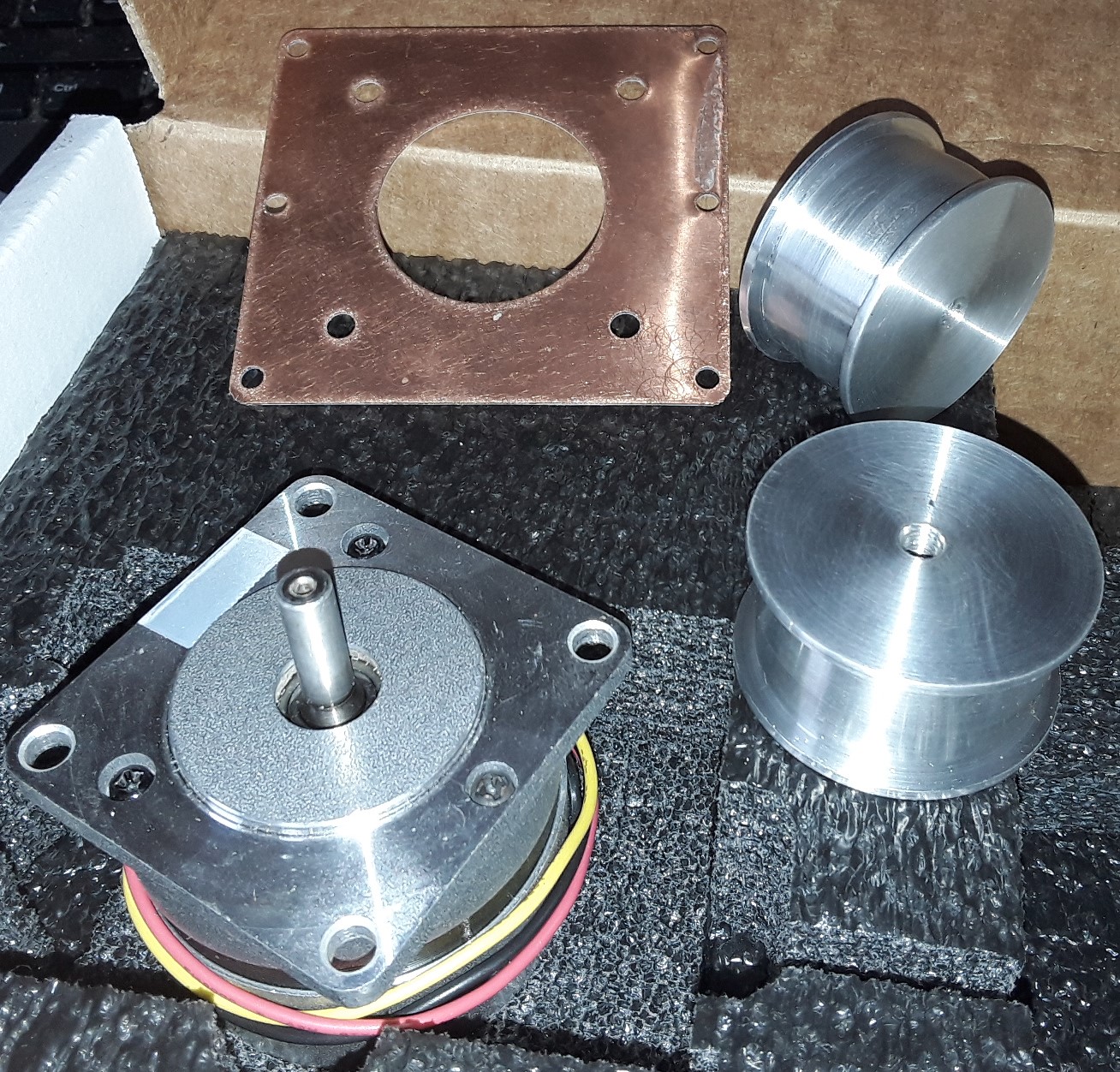

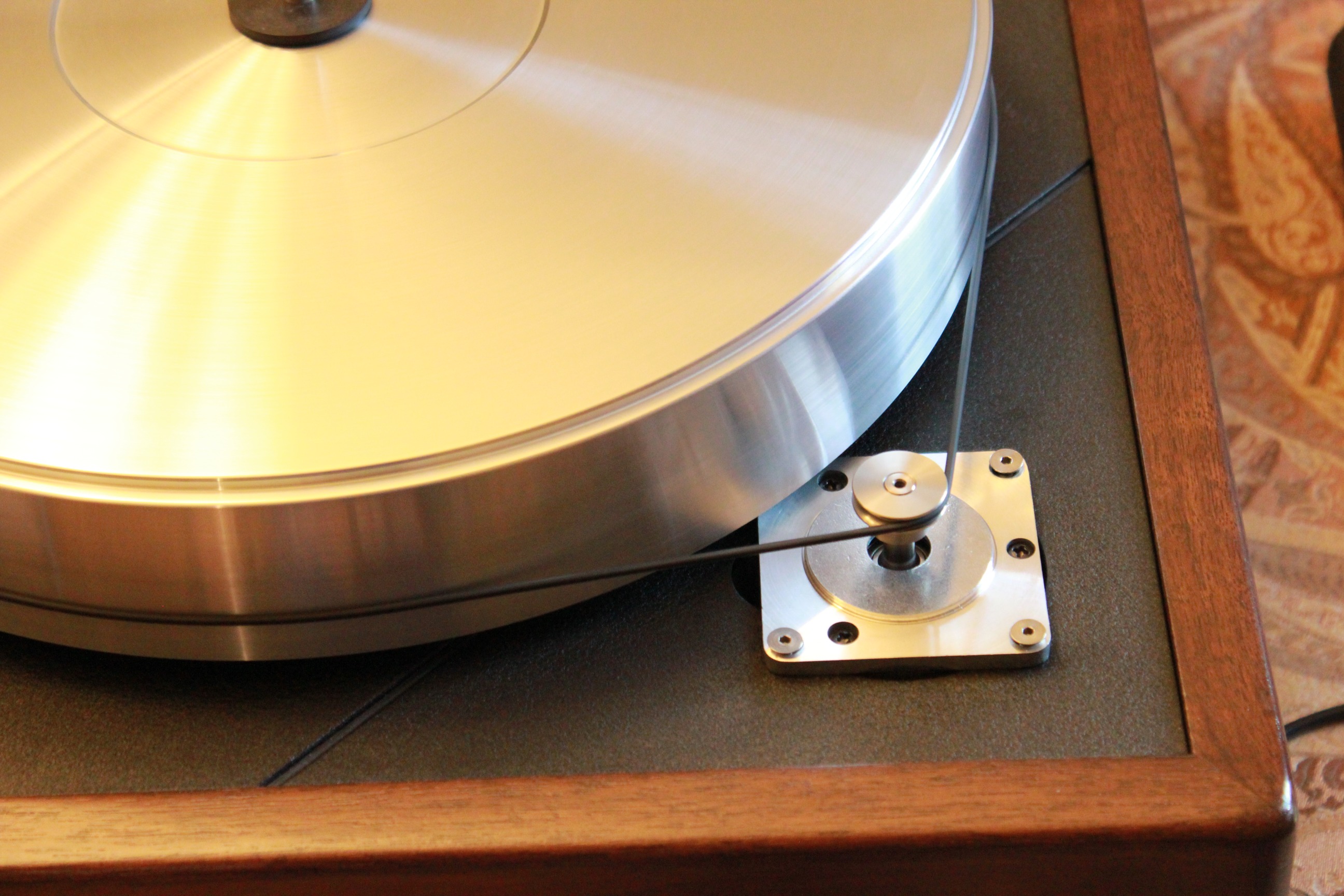

Hello,

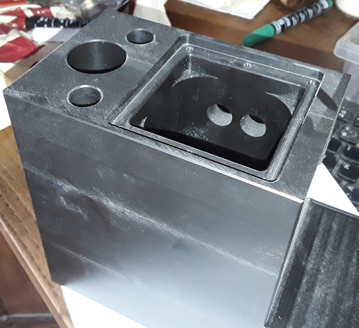

After exchanging knowledge with the respectable member Pyramid here i knew which dimensions to get for my pulley.
At first Sota offered me to machine a special diameter pulley at additional cost because i am using a bigger platter. Because the motor unit came from them my initial thought was to ask them for the pulley to get one with the right tolerance. BUT it took such a long time that they offered a refund.
I worked in '' metal business '' so i should have known that if you ask a well equipped company to make a pulley it would be a piece of cake.
It took some time to find a company in my vicinity willing to make two slightly different diameter pulleys because usually they are making bigger series.
The idea of making a hole in the center and use a little screw to secure the pulley to the motor ax was quickly abandoned .
My idea was to go for a tight fit ( not one that will need force to install it!) because i choose to get one pulley for a rubber belt and one for a mylar tape.
Because the contact area between ax and pulley is 6.35 mm diameter and 19 mm long there is no need for a strong bonding agent. I have one product so far that i wanna try. I think it should be as liquid as sewing machine oil to get a uniform thickness allover the contact area. On the upper side of the pulley there is an M5 threaded hole to be able to use a M5 bolt to '' break '' the connection between ax and pulley.
Of course using '' real glue '' would give to much grip!!

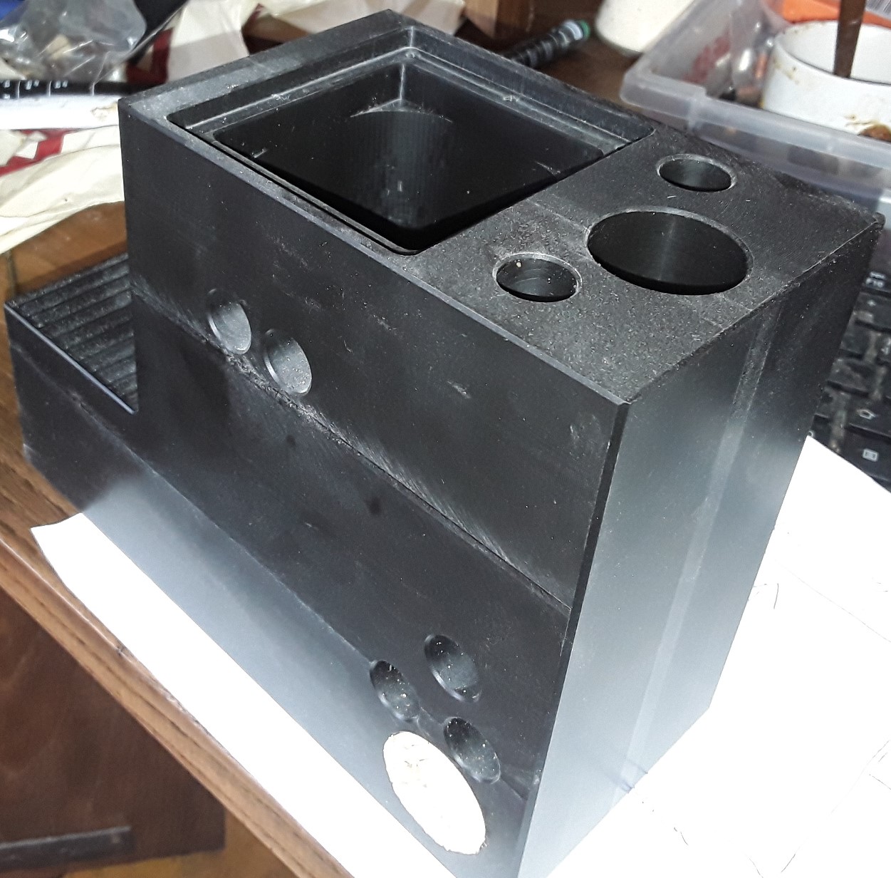

On the photos you can also see my POM material motor housing. Under the motor itself there is a big cavity filled with lead shot.
There are some round deep cavities filled with lead shot too and closed with some foam because POM is almost impossible to glue.
Greetings, Eduard

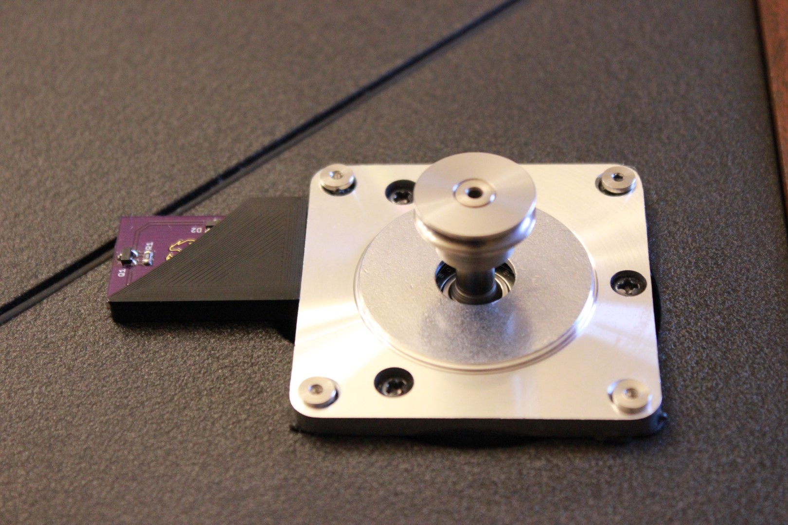

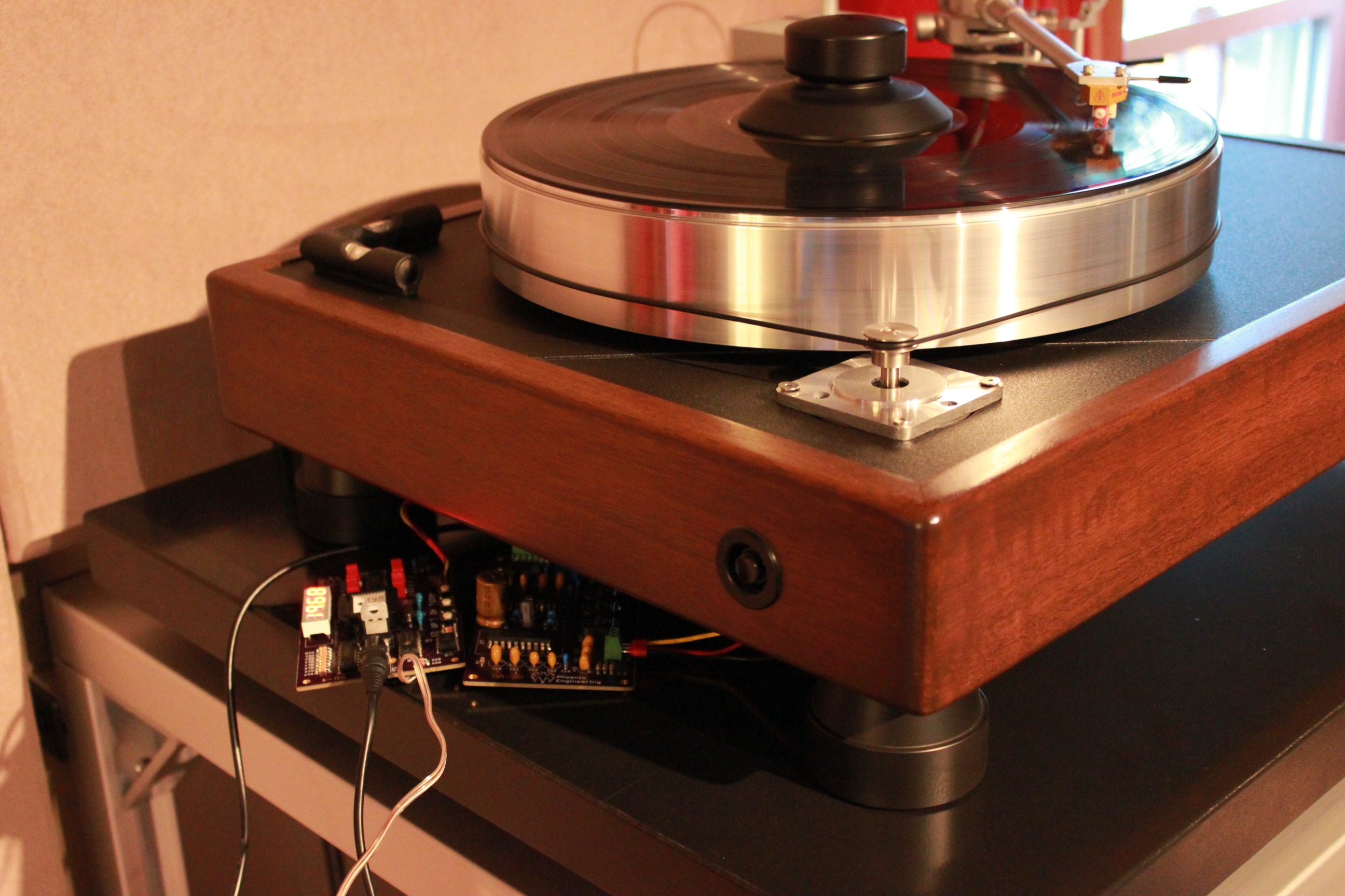

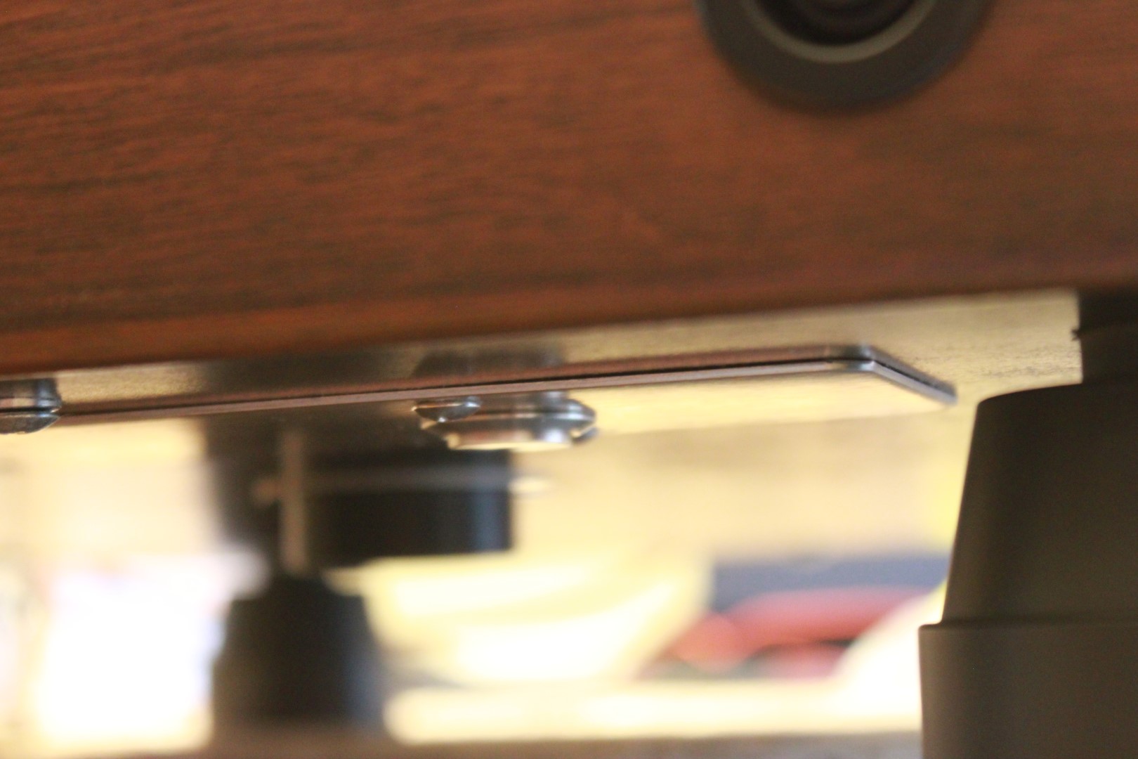

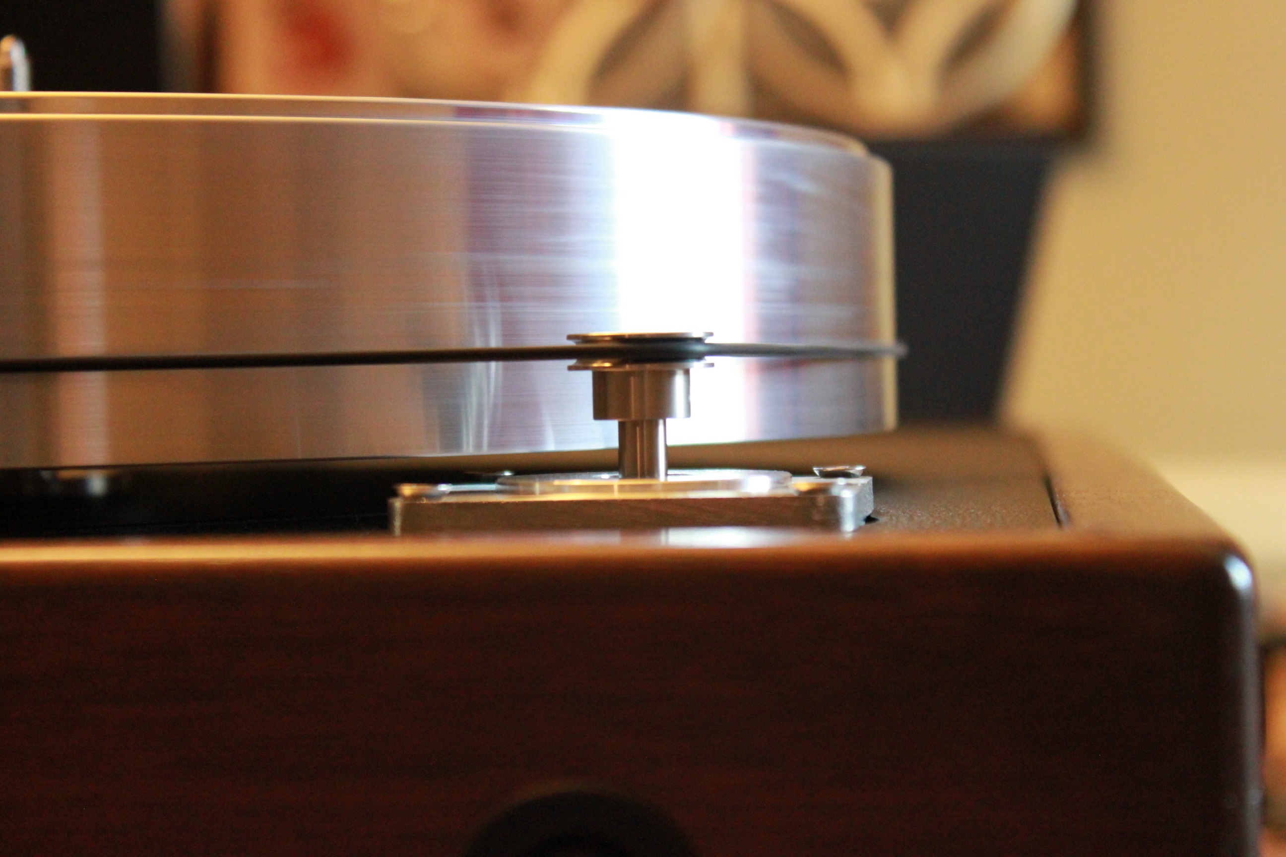

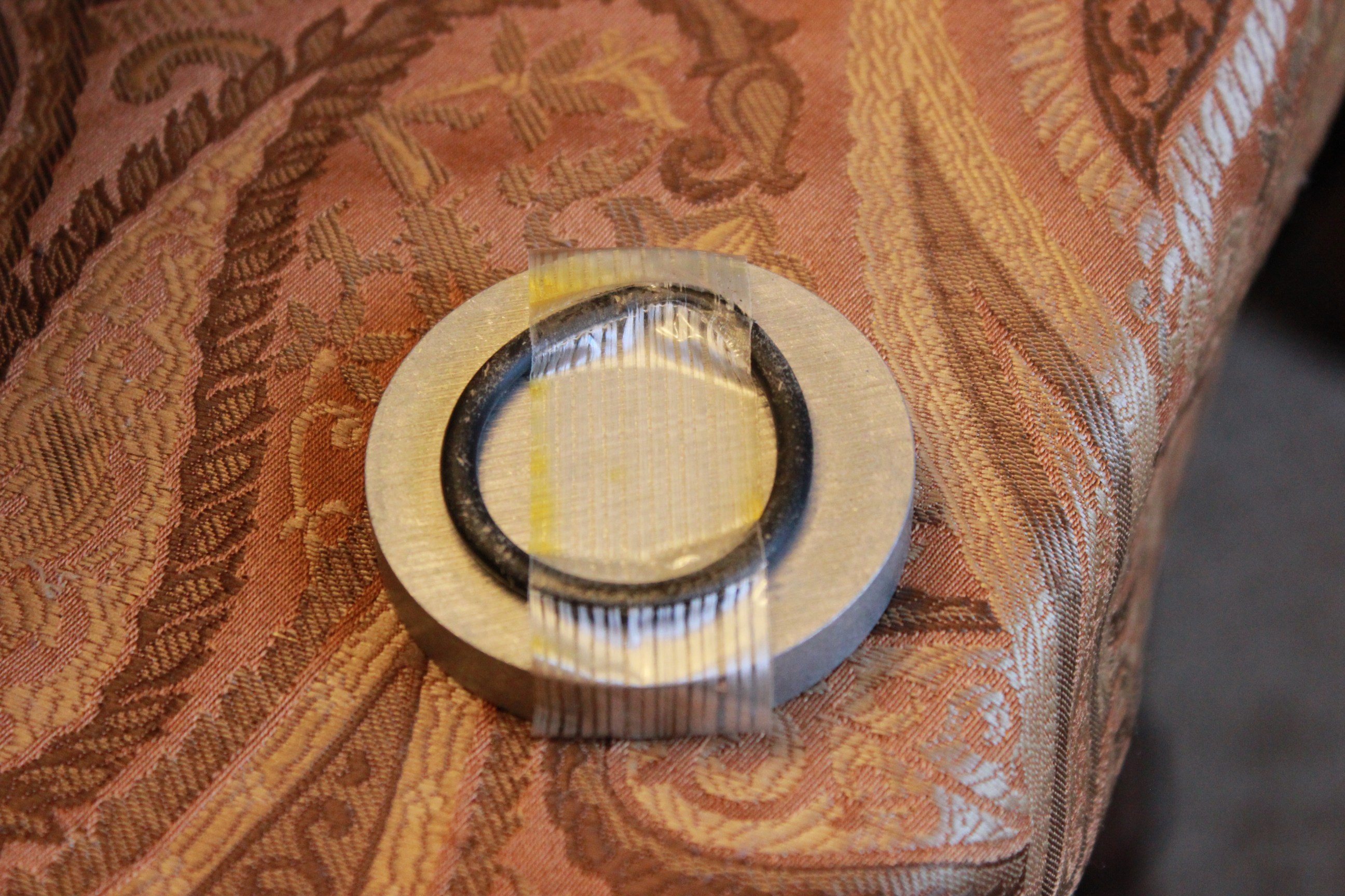

Had a little time this weekend so I test fit the motor into the VPI Classic. Have not seen any pictures of the Classic, so figured I'd share.
Few Notes:
- This is the 0.75” pulley from sdp-si, fits the motor shaft perfectly.
- Just a test fit with the screws, but you can see the slight difference in hole pattern. Will either pickup some other 6-32 low profile screws or attempt to counter sink/bore for final mounting. Maybe try to come up with an alternative trim ring once I finalize the tach mounting.
Question:
1 - This is mounted direct to the deck, as was the Hurst motor with the little trim ring. The hurst motor also had this little spacer with o-ring (see pic) below it. Any recommendations on further damping between the motor/deck? I don't have any vibration instrumentation, but put the needle on the table/album without the belt attached, but motor running and could not perceive any difference in sound.

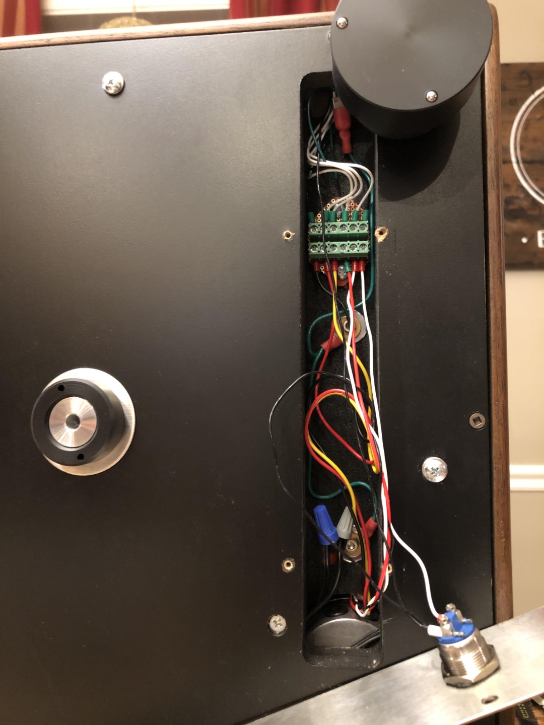

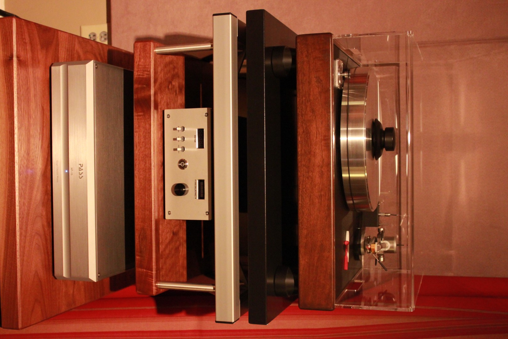

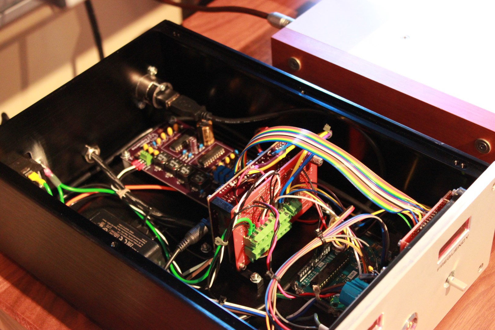

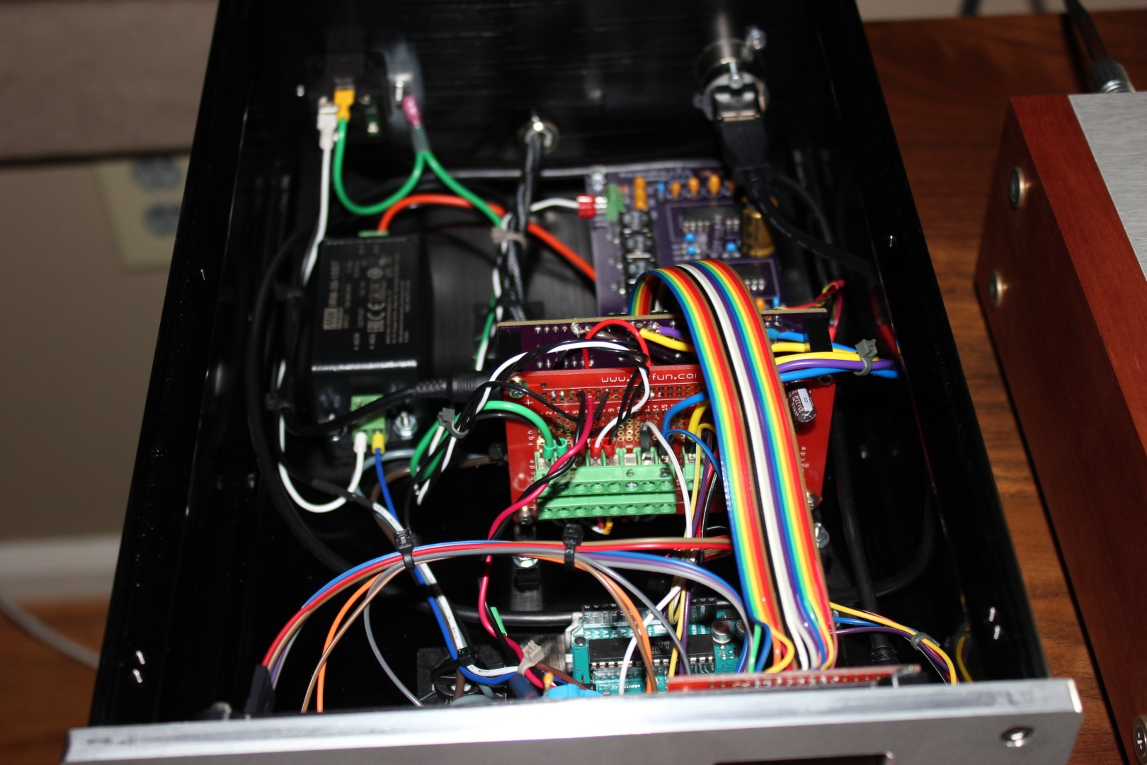

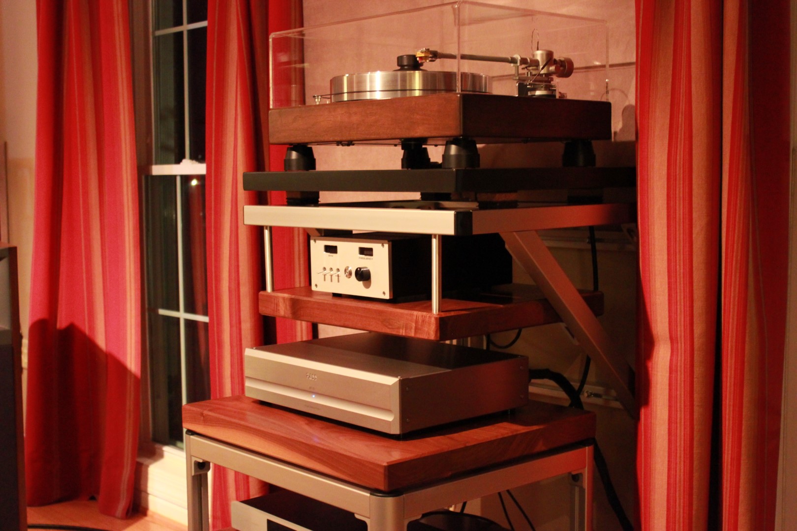

Successful Build!

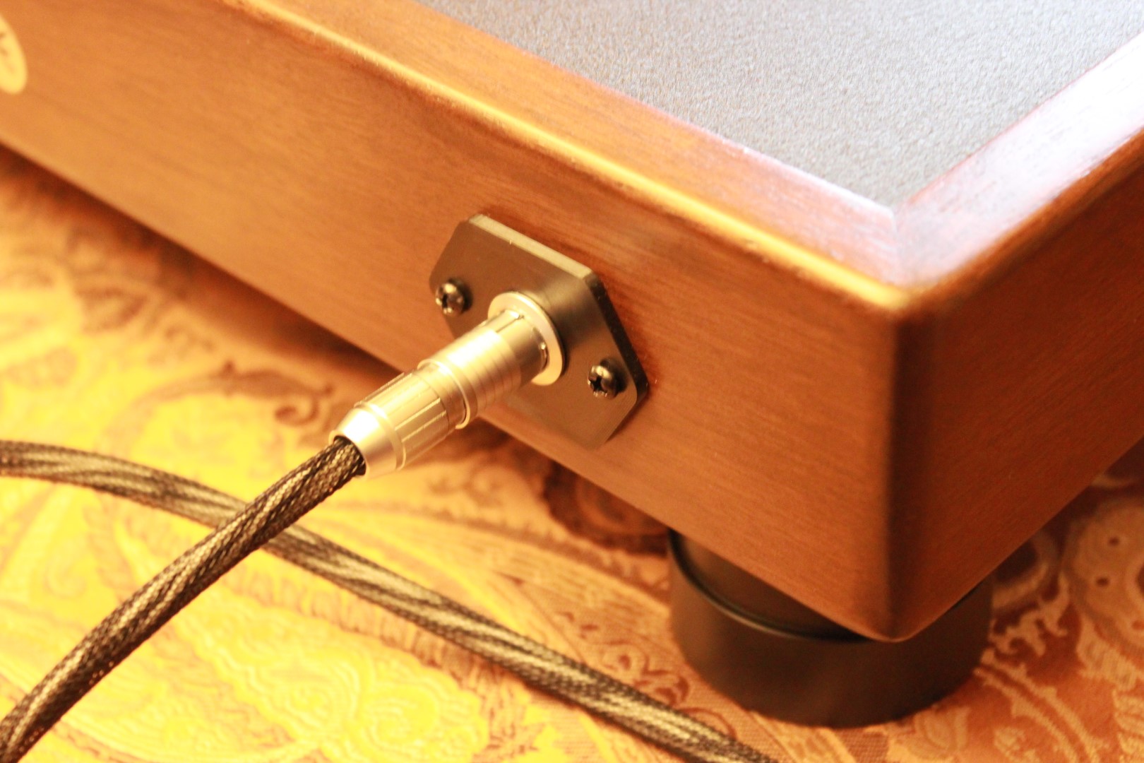

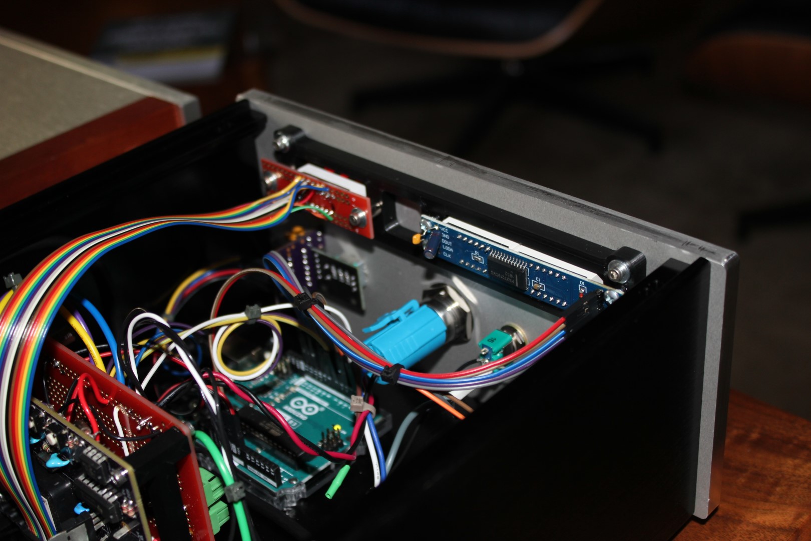

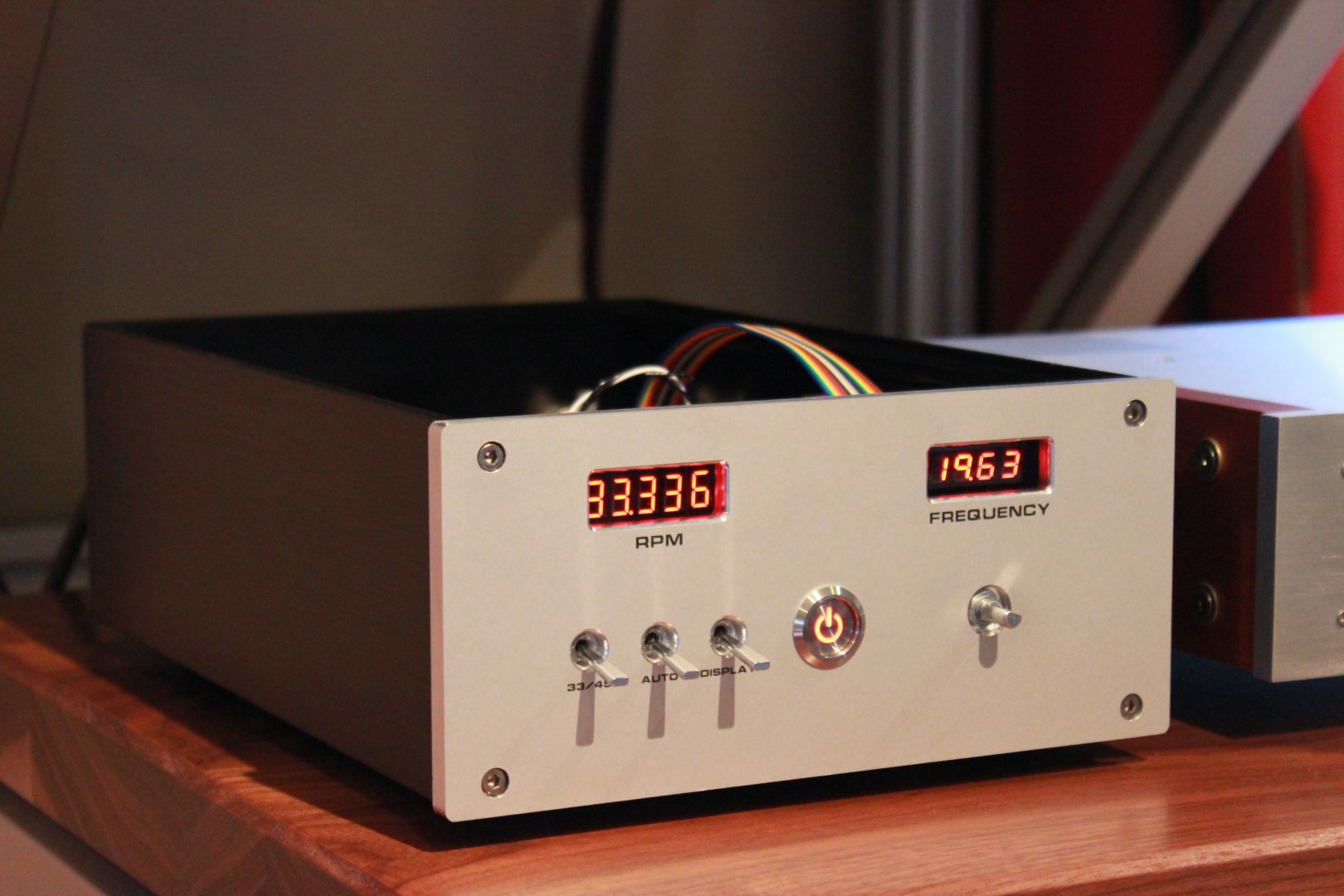

First of all, huge thank you to Pyramid and Seth Hensel for making this project available to our DIYAudio community. I just completed a build using the SG4 and MA-3D to drive an AA BLWR motor and had zero issues. The BLWR motor had a VERY small amount of vibration that I was able to reduce even further by holding the motor in my hand and adjusting phase with the SG4 as well as very small tweaks using the trim pots on the MA-3D.
I also designed and 3D printed a quick PCB mount for both the SG4 and MA-3D I thought I'd share with you guys as well. My intent is to hot glue the printed PCB mount into the enclosure I'm working on but the boards are fastened with some tiny 1-64 screws I had laying around from some other Arduino project.
You can print this and then drill out the holes for whatever size screw you have around. Hope this tiny contribution to this project helps!
