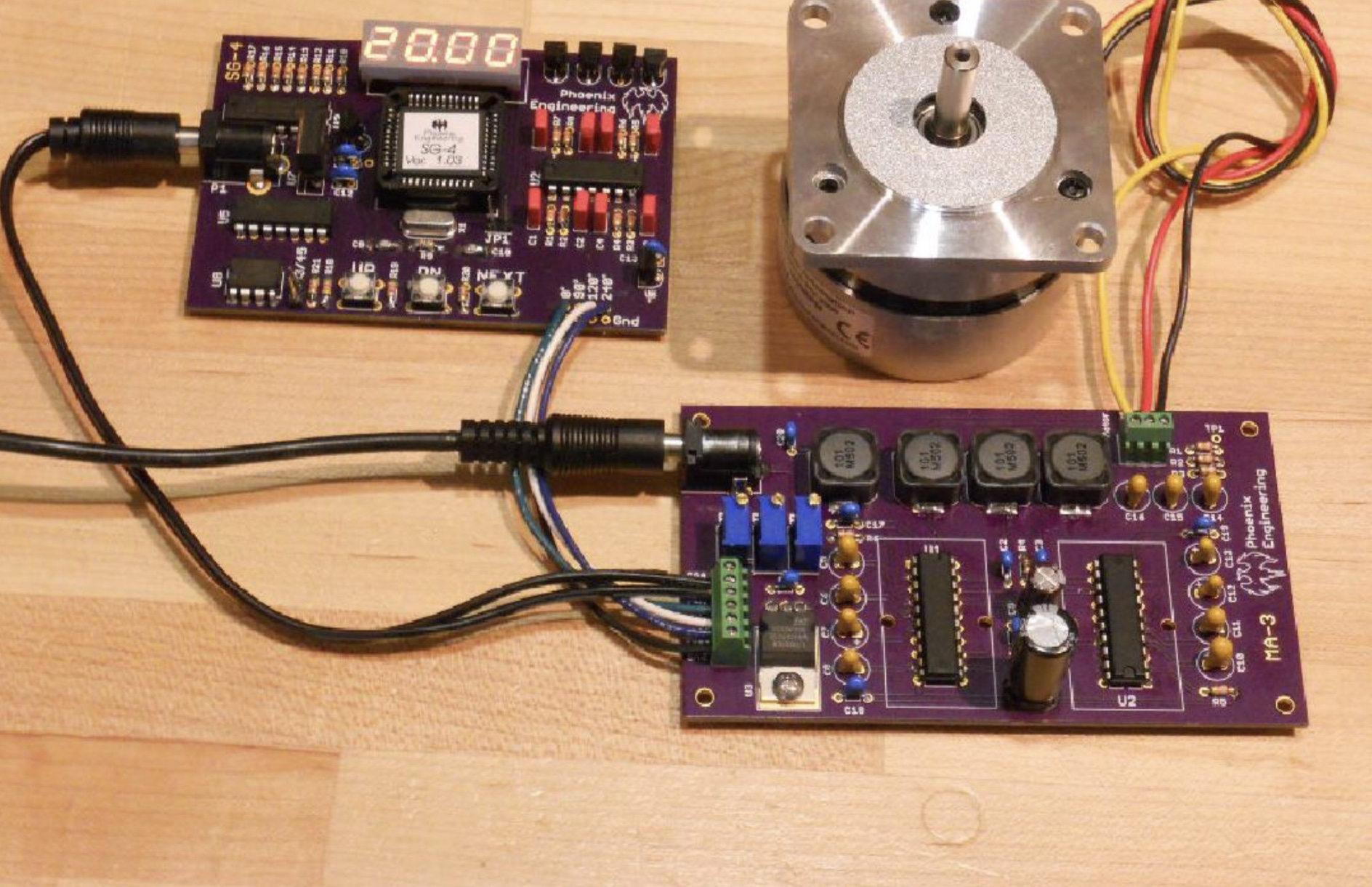

I found needed answers in this thread, but I have final voltage imbalance between phases, same as indicated by someone here on thread.
I have little differences in voltages on 3 sinuses after null sum of all 3. TP1 vs. GND set to 20mV as min. I assume it is expected some deltas there since we set 3 VRs to get identical voltage on 3 phases first and then we tweaked same VRs to set balance and to null the sum.
Is this correct statement?
Yes, you will never get zero volts at TP1; just tune for minimum.
Thank you for clarification. How about 0.1 VAC RMS differences between phases in final step? Is it critical? I do see some guys claimed about same aspect here.
I see. Thank you.
You have that much difference between phases when TP1 is minimum?
A: Yes, it is. These differences are when TP1 voltage is set to its min.
Are you measuring from each phase to ground?
A: Yes. Is any other way to measure each phase voltage?

Connecting the supply ground to earth is never a bad idea, unless it introduces a hum. At these low voltages, a safety ground is not mandatory.
The extra ground connections should not create a difference in potential; at the low gain of the amp, even if they did, they would be insignificant. If you want, you can eliminate one.

Got my motor connected today. Dilemma is about speed. Since I’m moving sub-platter (about 160mm), my pulley for 600RPM motor should be close to 0.9mm. It is too small to make good belt grip even with two belts to be used. What is the bad side of 300RPM to use with our BLWR? 300RPM will solve all my issues with pulley.
Another thing is related to motor temperature. I tested it with 20Hz and waited about 25 min. It is no vibration, but motor is quite hot. Is it normal?

Last first: If you are looking at the output to the motor, then AC measurement is correct. Supply voltage will be with DC. You may also want to ensure the DC voltage at the output to the motor is ~VCC/2 on each output.
Temp: 45°C = ~113°F. This is normal and is not hot. The motors are rated to 80°C. It will run cooler with a metal case. One of the reasons these motors feel warmer, the stator coils are mounted on the case so the heat conduction is much better than most AC synch motors; they dissipate heat better than the Hurst motors so they feel warmer. Hurst rate their motors at 30°C temp increase during operation, so the coils operate at ~52°C (126°F).
Something is not right with your numbers. The BLWR motor will run at 300 RPM with 20Hz, not 600 RPM. For 33.333 RPM the subplatter-pulley ratio should be 9:1, so 160:17.778mm not 9mm. 17.778 mm is ~0.7" and should work with round or flat belts.

Yes, and 20Hz is for 300RPM when 40Hz is for 600RPM. My question was related to benefits and disadvantages of these two settings. 300RPM is easier for my setup due to larger pulley dia. 600RPM is doable too, but pulley will be 8.889mm vs. 17.778mm for 300RPM. As I mentioned, 300RPM pulley will use a better grip, however I would like to hear your opinion about 600 vs. 300RPM preferences.
