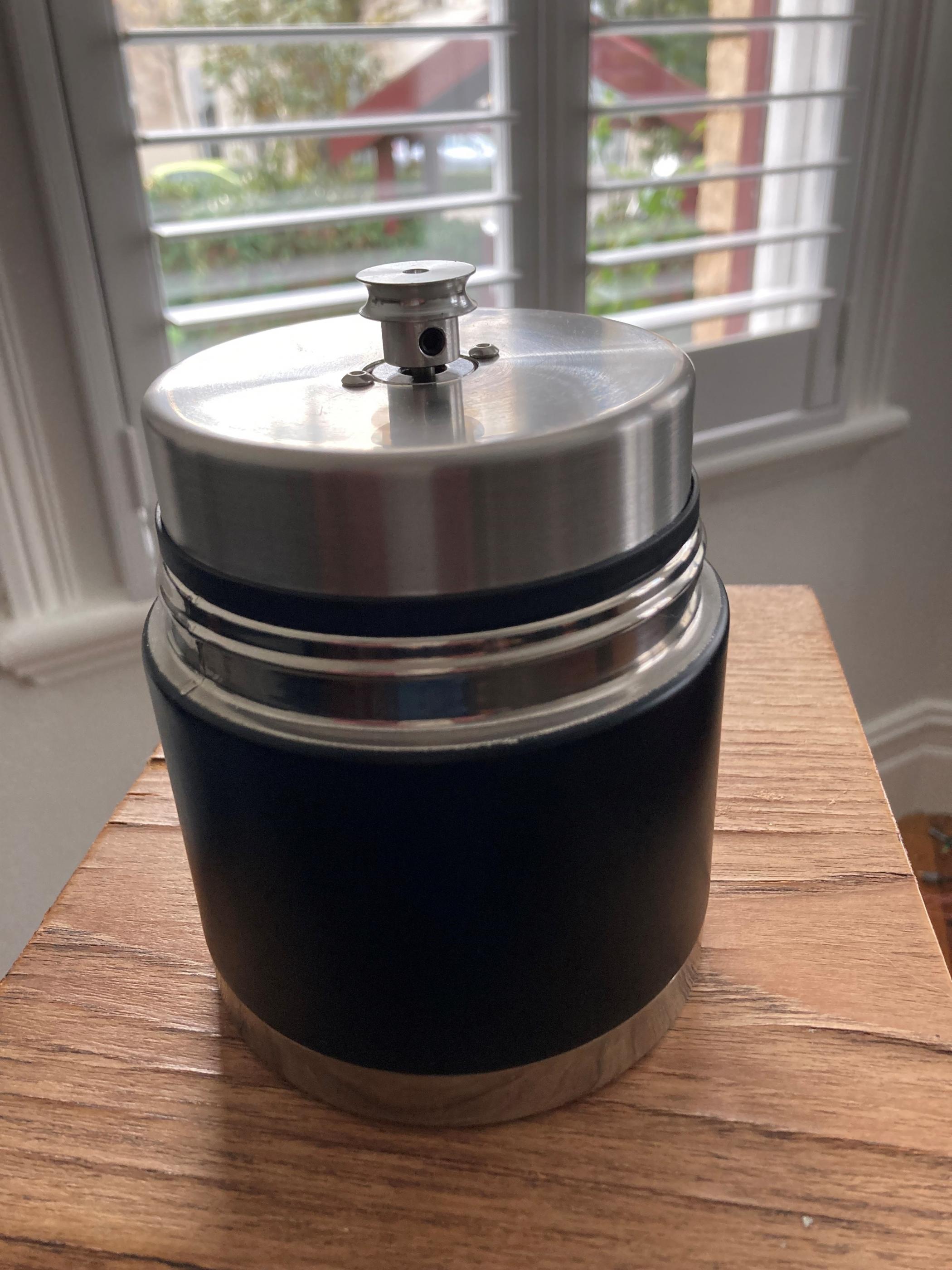

Guess the motor housing?
Here it is

For mounting - of course, this is not attached to the plinth or top plate - I am waiting for this heatsink to arrive
I figure I will place this within a length of aluminum channel - have to get the heat sink to know what size would work best and which way to orient the channel. Plenty easy to do.
You got those pulleys faster than I - I assume you discovered them for yourself well before I made my post.
I do not recognize what you are using for a housing.

Got my heat sink in today and it is nicely done - and got the pulleys. I got three in case there was any variation in them Left the motor at home so am not able to play around with it, yet.
Everyday I look at my DIYAudio message box in hopes of seeing a note from the EPROM fellow.
The heat sink slips over the motor. It is only slightly longer than the motor. The part where the fan was will be on the bottom.
I had to bend it a bit to get it tight - I will use some thermal goo when I mate them for final assembly.

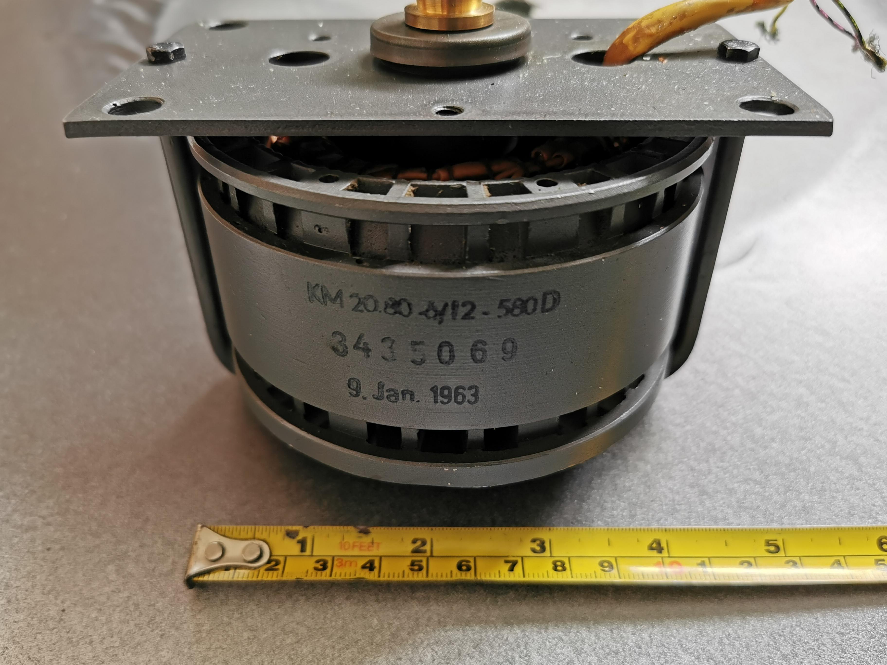

The new issue of STEREOPHILE has an extraordinary turntable reviewed - a $450,000 dollars table that can cost over one-half million dollars if you add a few extras.
Thought it was interesting in that it is using what the manufacturer believes are the last forty NOS PAPST motors that I presume were the ones mentioned early on in this thread. Used for REVOX capstan motors - though i wondered if Fremer meant to say STUDER. In case anyone is wondering where the last few went ...
