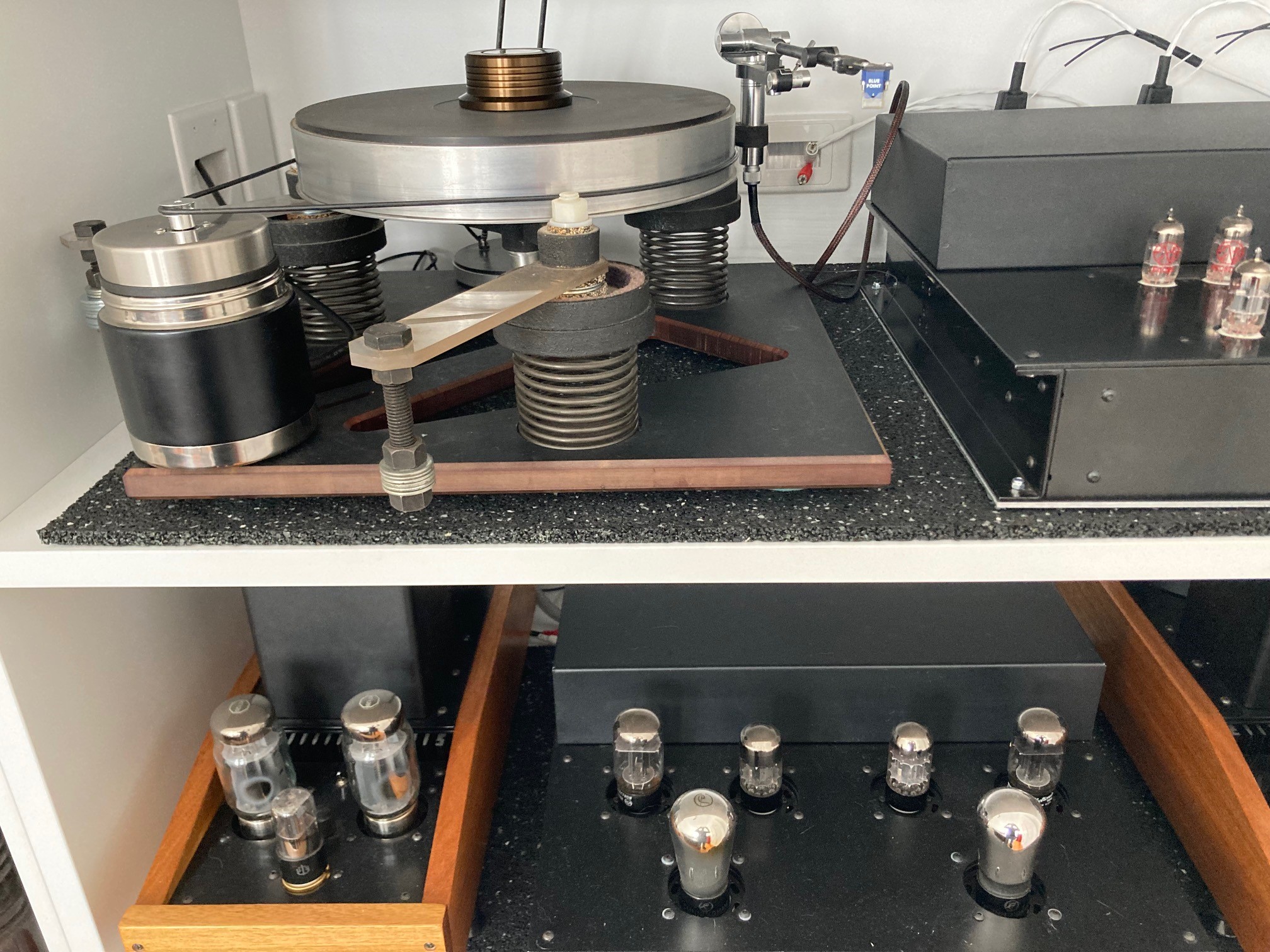

Another SG-4 MA-3G Joins the fold
A big thanks to Pyramid for designing and sharing this project and to Ralph for being super supportive re the uP supply
My main TT is a reworked Orpheus Silex.
Unfortunately the rubber surround on the idler is worn, so a new motor system seemed the right way forward.
I'm quite stunned by the improvement, on what I considered was already a great sounding player.
The background is noticeably clearer with a nothingness between the instruments.
Bass is tighter and clearer and the overall rhythm/groove of all music is compelling.
Mids & Treble are just wonderful now - the improvement in detail and timbre is huge. Larry Carlton's album; Last Nite is a cymbol nuance fest and is a goto record whenever I am evaluating change - It is stunning
Imaging and depth was always a strong point on this TT, but is pinpoint focussed now.
Very happy,
@rickmcinnis The 4mm bore 16mm pully runs smoothly and induces with no visible vibrations/oscillations on the platter. This is something that is visibly very evident on my TT because of the floating/sprung system.
I would love to try a multigroove pulley though

reubster346, I use springs between my platform and the plinth but I have never seen springs like those. I like that large diameter - extremely long torsion arm! Where did you find those? I would like to use something like that but would need them able to support a much heavier load.
Hi Rick
I built this TT back in the early 1990's. At that time a friend had built something similar. He had specified & custom ordered the springs (IIRC) from a company in Germany and had a few spares which he sold to me
The springs were designed with the weight of platter + tonearm in mind, to tune the vibration to about 1Hz. It works well, you can give the platter a gentle nudge and see it bounce at ~ 1Hz without hearing anything audible effect.
The torsion arms (2) were my idea. They are 5mm perspex strips with bolt+washer counterweights. You can easily swing their positions to get the platter perfectly level. This is something I need to do to compensate for belt tension changes.
reubster346,
I meant how springs are basically torsion bars wound - so your springs are very long torsion bars. To be honest i could not figure out just what you are doing! You are not following the crowd. As Sherlock Holmes would say yours is a singular effort!
