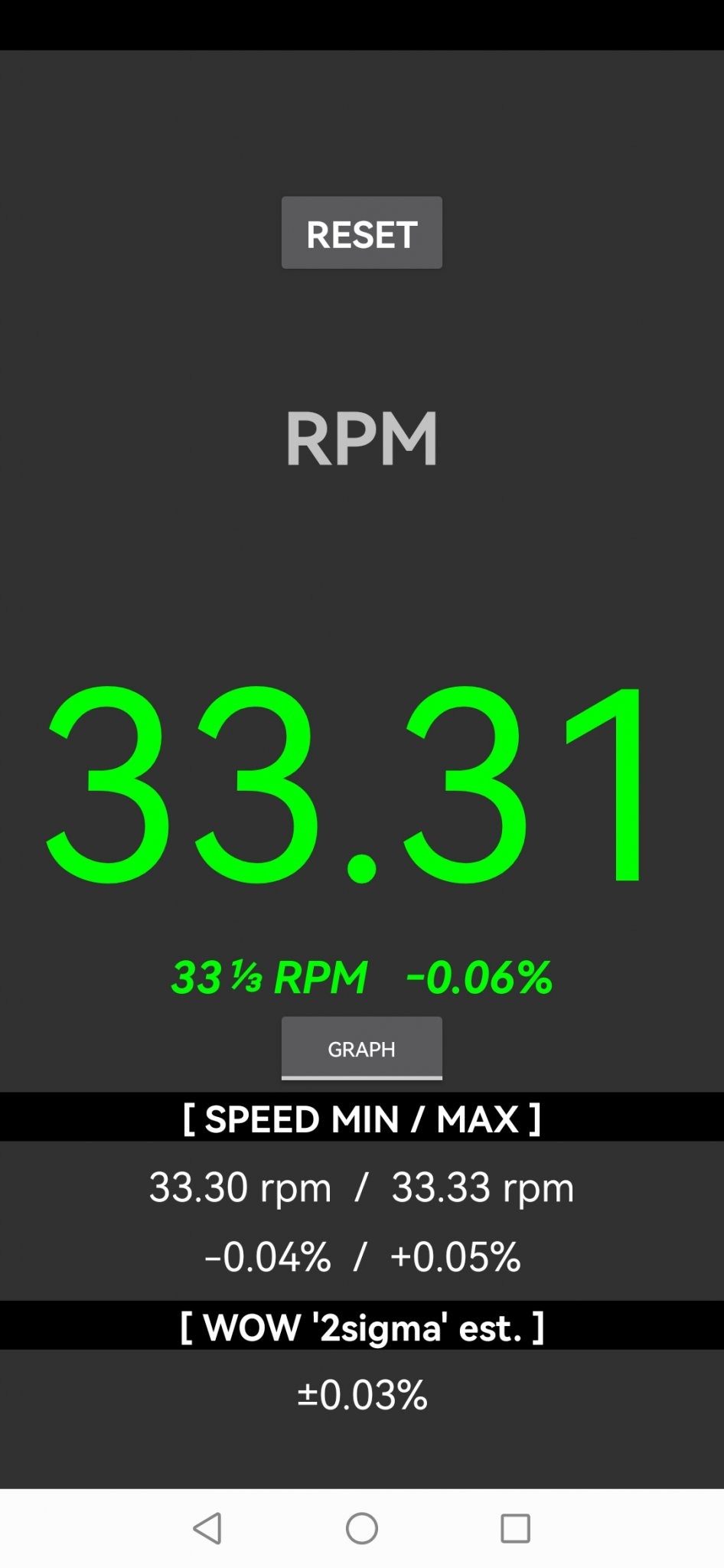

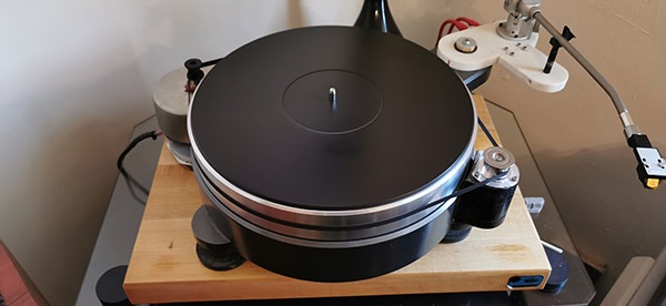

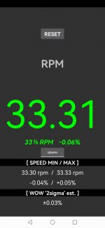

Here's the result of my test; not as good as my Technics SP10 mk II (0.02%), but pretty good for a belt drive
