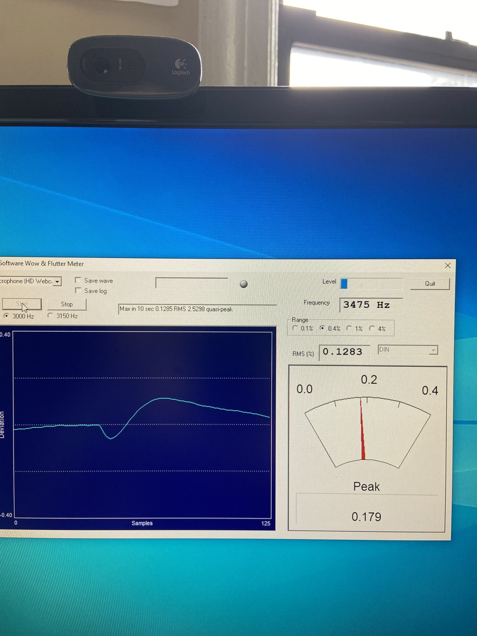

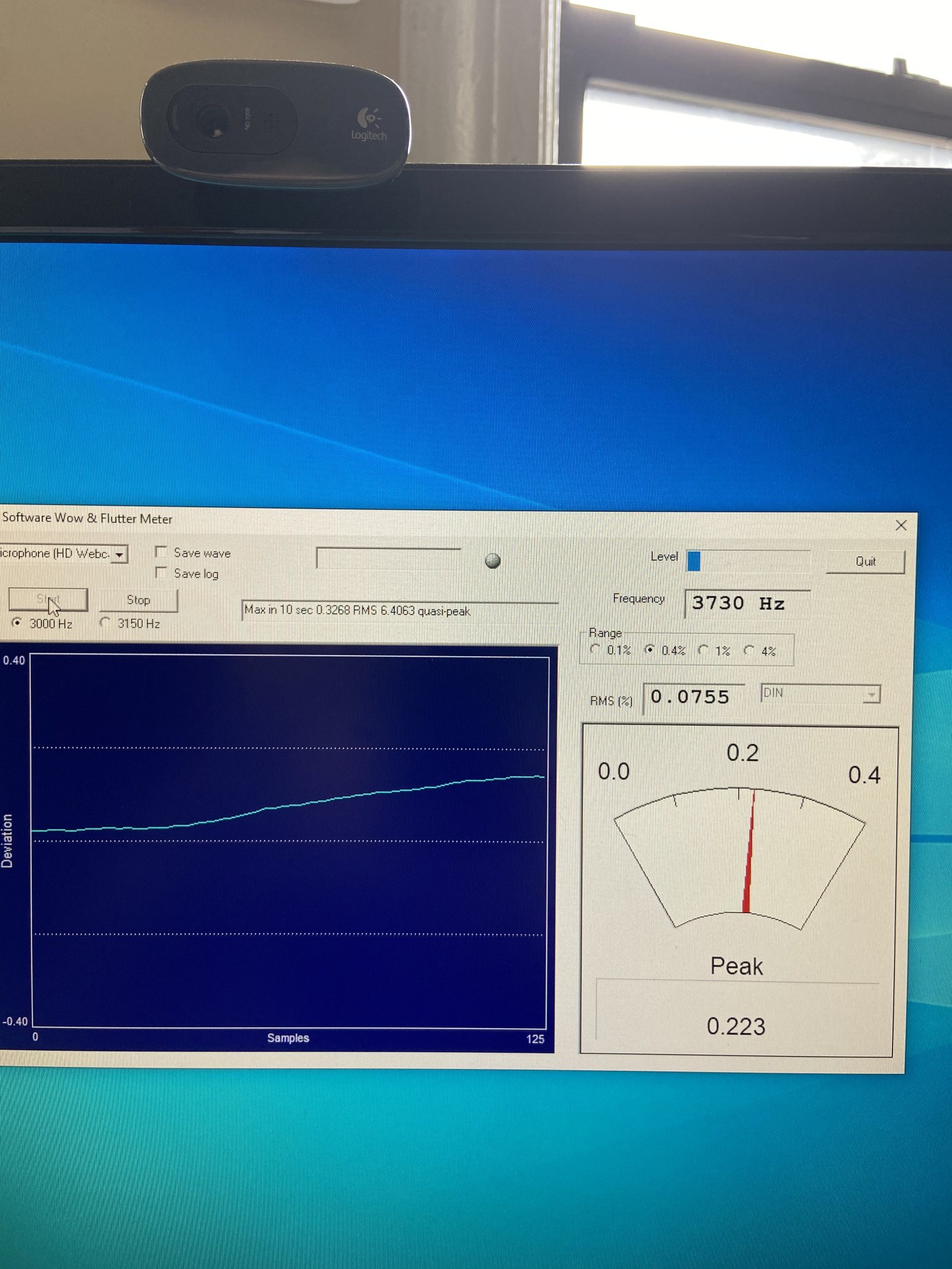

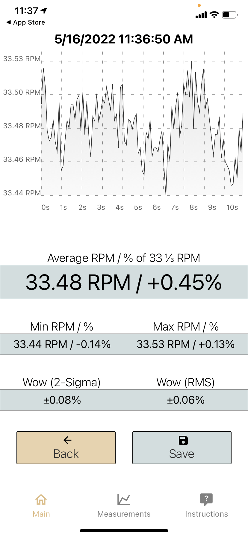

I just checked the speed/wow/flutter with a real test record and a computer program. Seems that the “yellow” ios RPM app is lying. It’s reading too high. The “blue” app is a lot closer to truth. And there’s a new app which reads decent RMS, so this table isn’t horrible. I have to find what is causing high peaks every revolution. Rms seems to be in 0.05 - 0.07 area, not bad. Most peaks hit 0.12

Great results. Here’s mine:Here's the result of my test; not as good as my Technics SP10 mk II (0.02%), but pretty good for a belt drive

If you send me a file with that recording, I'll test on my FL140.Thank you. I’ve tried different belts. I’ve recorded a 3000 hz test time of of my test record. It’s about 3 min long, 1.4 Mb. If anyone can use this recording to measure w/f I’d really appreciate it.

Thank you very much! I will need your email I guess, the file is 1.4 MbIf you send me a file with that recording, I'll test on my FL140.

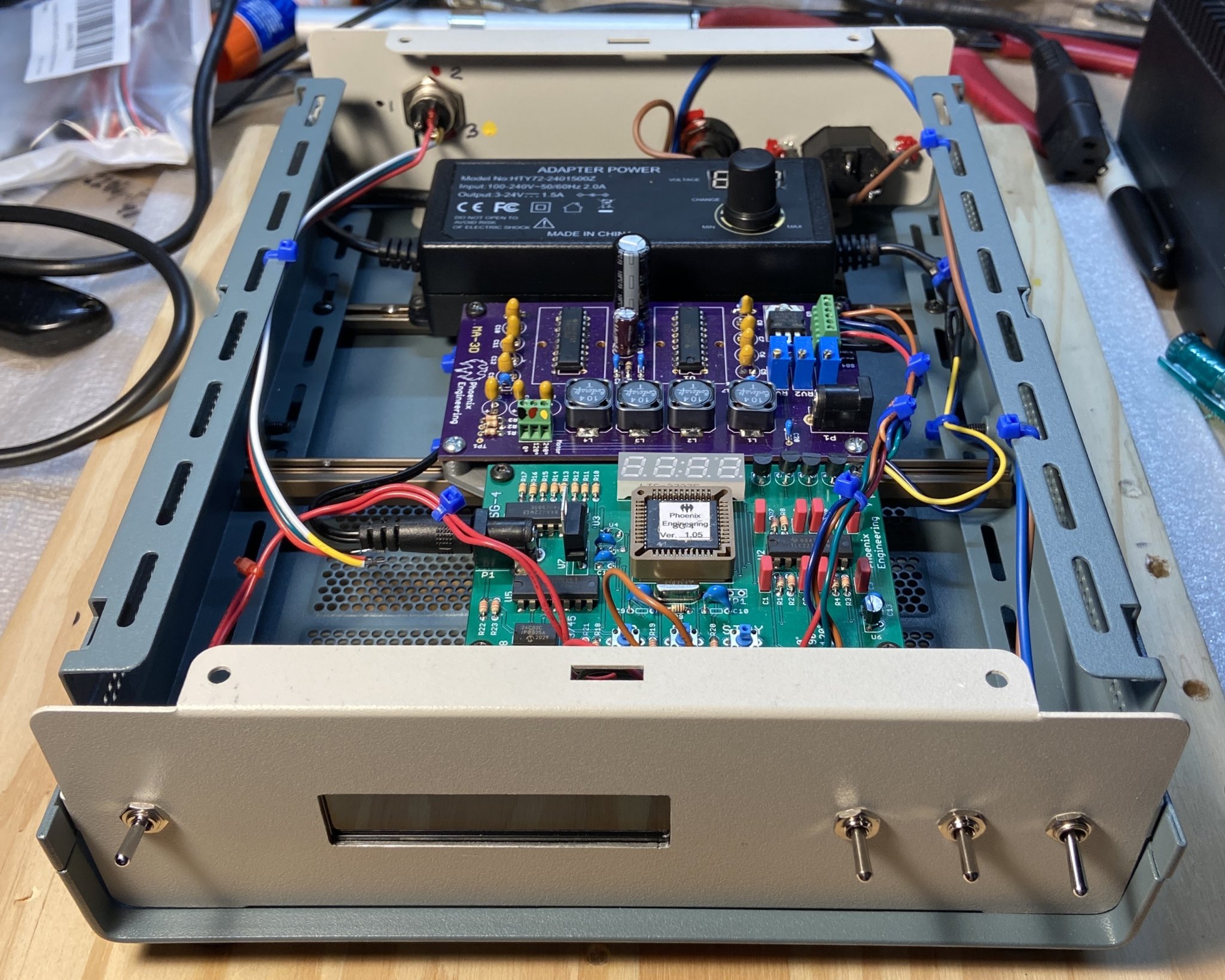

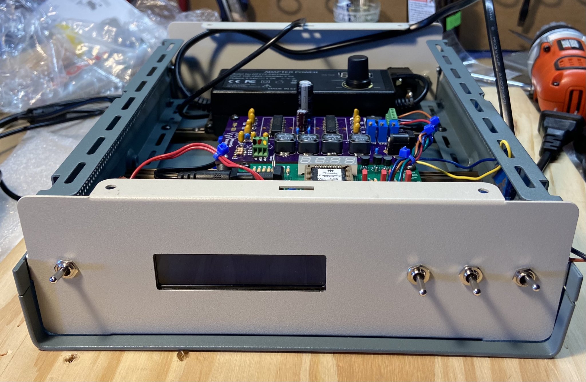

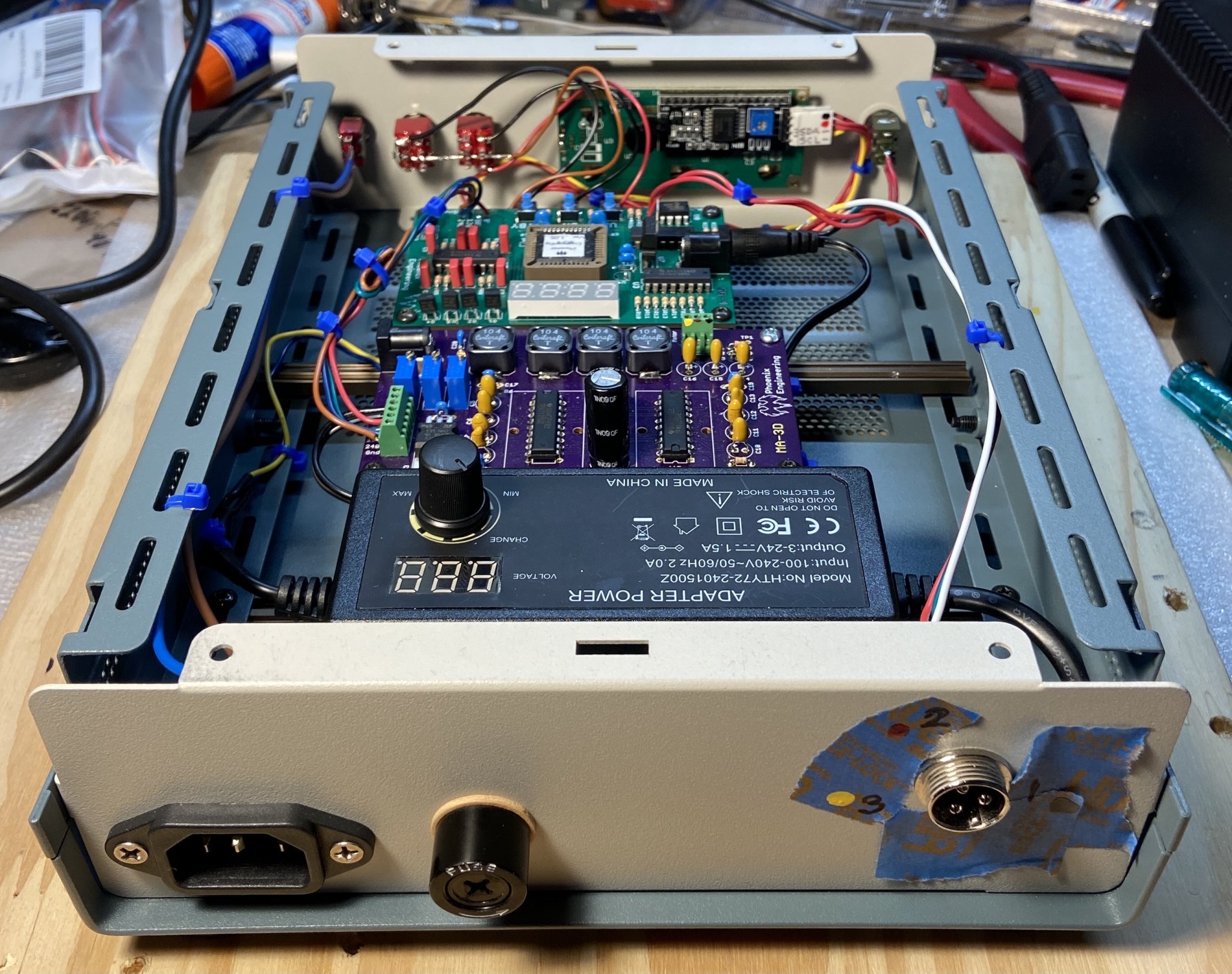

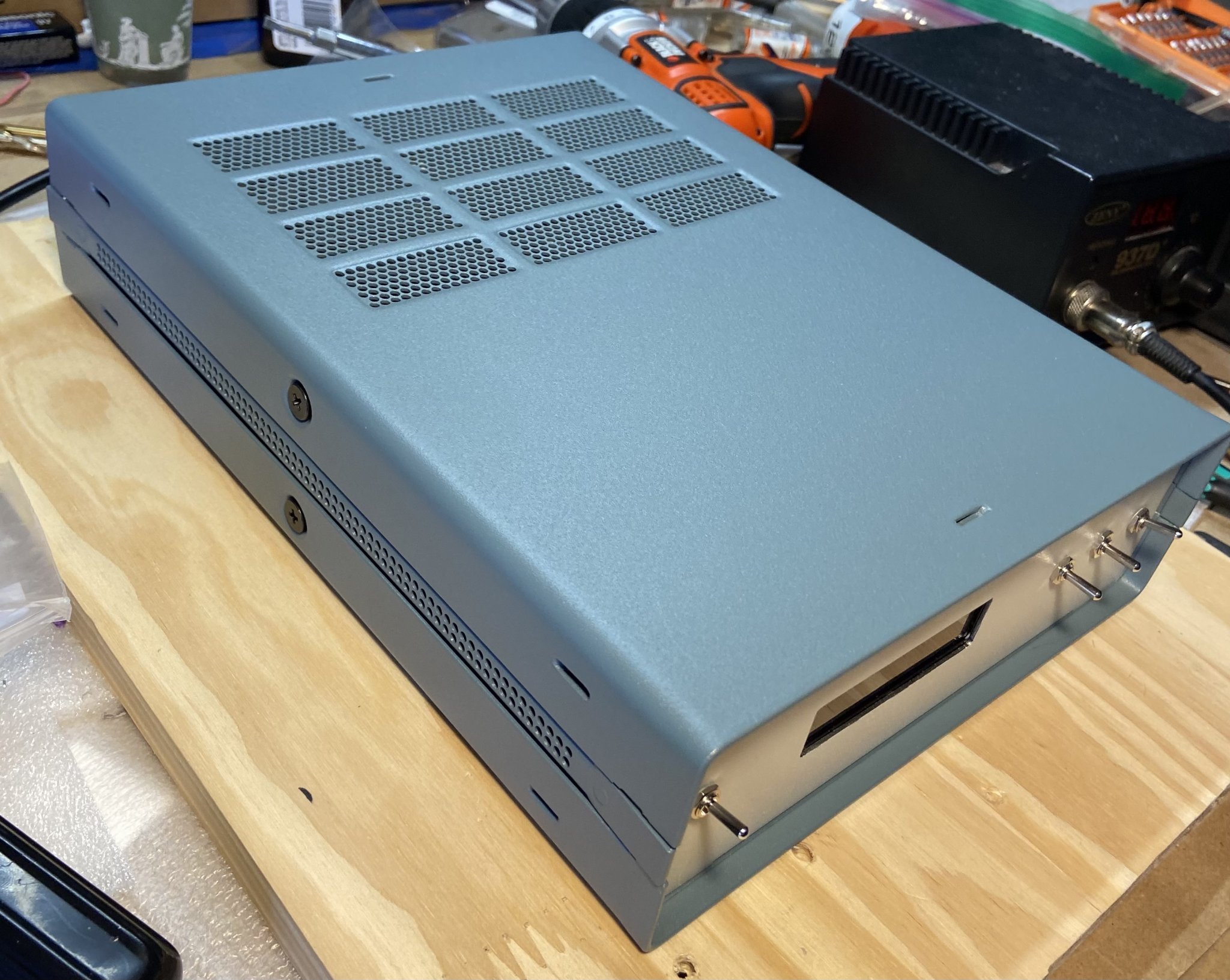

Thx to all on this thread, especially Pyramid! Build complete. I may change to pusg-buttons later.
Hi all. A minor problem (I think): when I press “start”, for the guest sending I can hear the belt slipping on pulley, until platter catches up. It’s a factory Sota pulley and belt. I remember reading somewhere in the threads, that motor should start at only 5v, preventing belt wear. I can see by the current draw that motor pulls about 800 ma at start, and after a second or two it drops to 340 ma. Is anything wrong with my build?
Will do. Platter is heavy, so motor is “spinning wheels” ))). Anyway to make it start slower?Starting torque...give a push with your hand at start, see what happens.
I used a non-factory larger diameter pulley with a round belt before, and it was better. So this may be a temporary solution for now.You need a high current soft starter type device...read about those, and modify your circuit.
Btw, to all who are looking for a pulley: Donna at Sota will graciously sell their factory Eclipse pulley, designed for 1/4” shaft, flat belt, and 12” platter. It is aluminum and has two securing bolts. I have her permission to publish this info.
That’s what I thought )))1 - 2 seconds is not worth the hassle, just keep a spare belt around.
