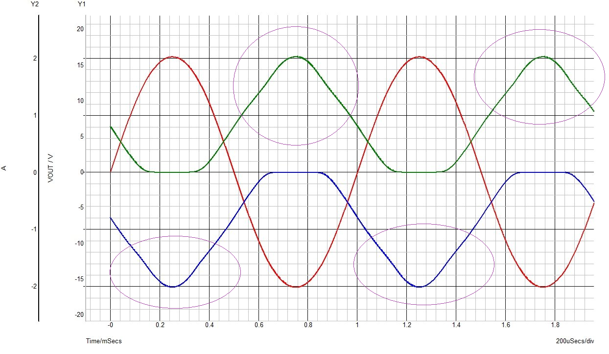

Absolutely correct and MC12 is kind enough to let us know the actual border of the tolerable maximum modulation swing / range of excursion.Beside, the famous 1st watt is a wrong conception as it imply that dynamic range is very limited, as well as homogenous
speakers efficency, a better basis is the DIN 45500 2 x 6W RMS, and that was still with reduced dynamic ranges of the time.
At this limit, you can see what delta the BIAS miracle really delivers before it switches to AB-B operation.
And that is not Iq + Iq = 2 times Iq, but 808mA plus 324mA = 1.132A ... I leave it to the reader to decide whether this is 10.25W or 5.13W.
In any case, this simulator reveals in the most diverse ways what everyone actually knows. But marketing people are beating about the bush, till today.
However, we should also point out that the MF-A1 naturally complies with the old hi-fi standard.

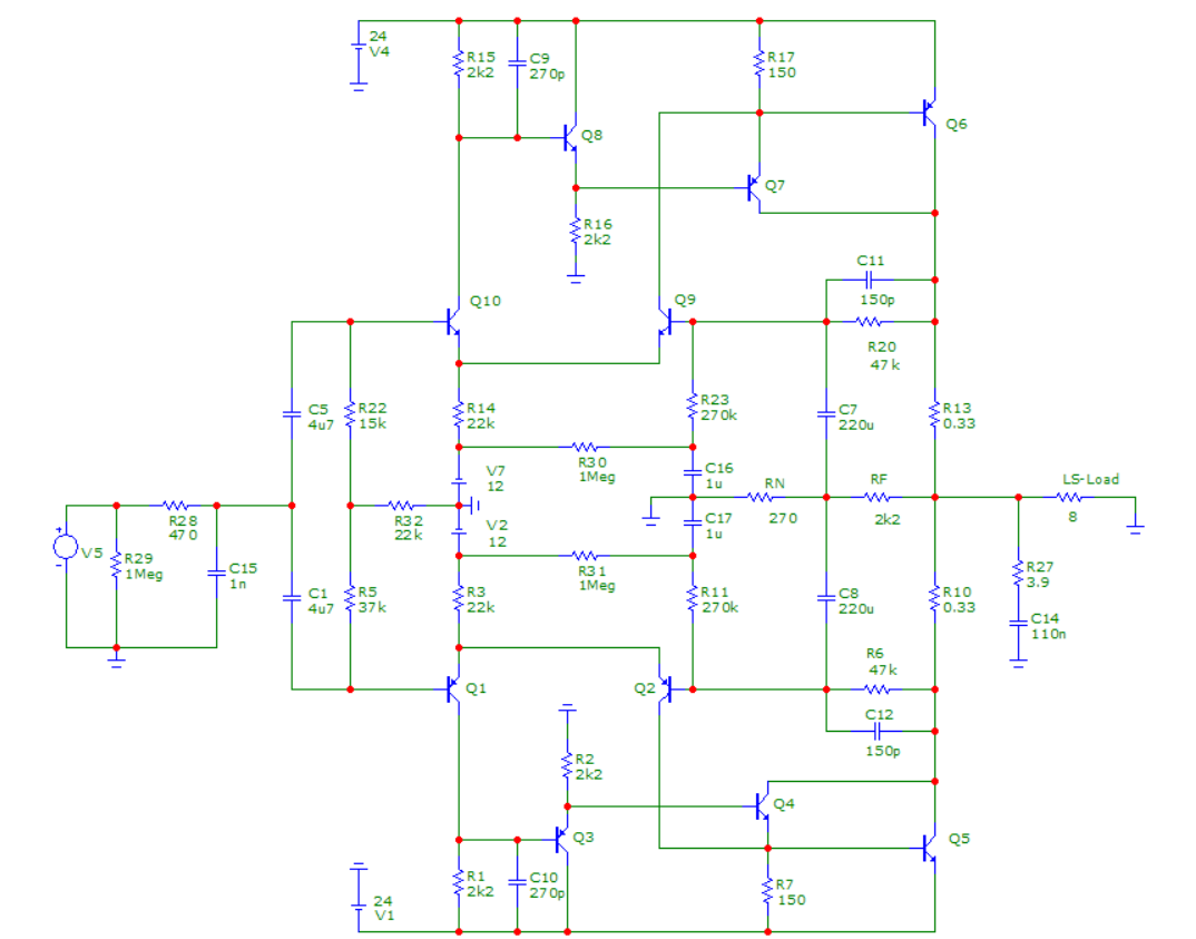

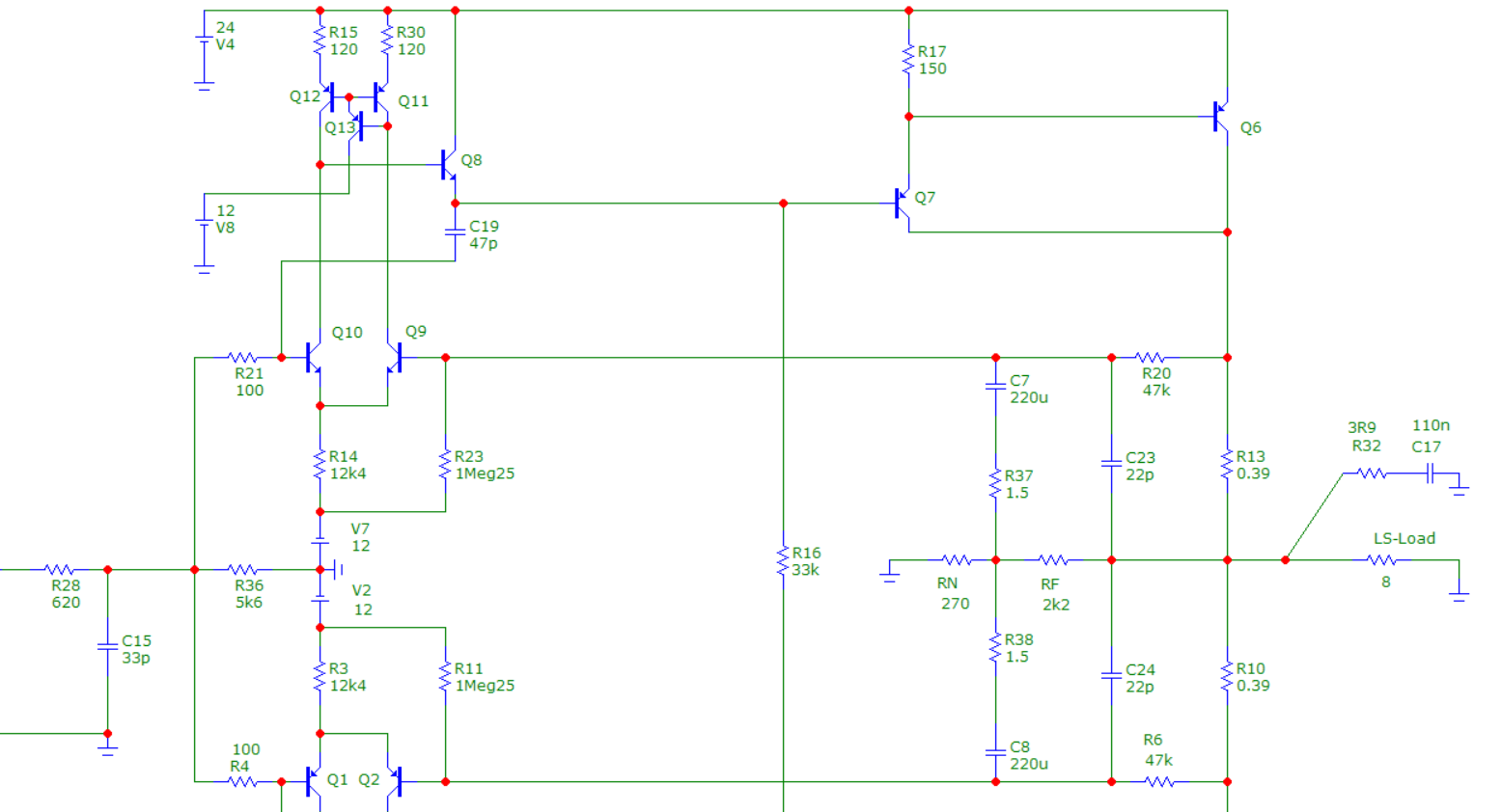

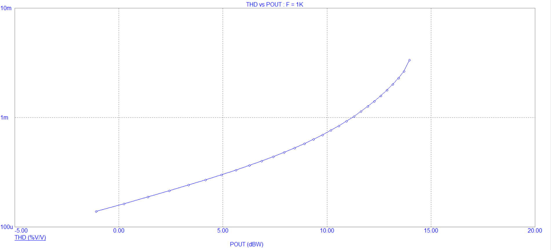

The schematic I used for the latest PCB is this:

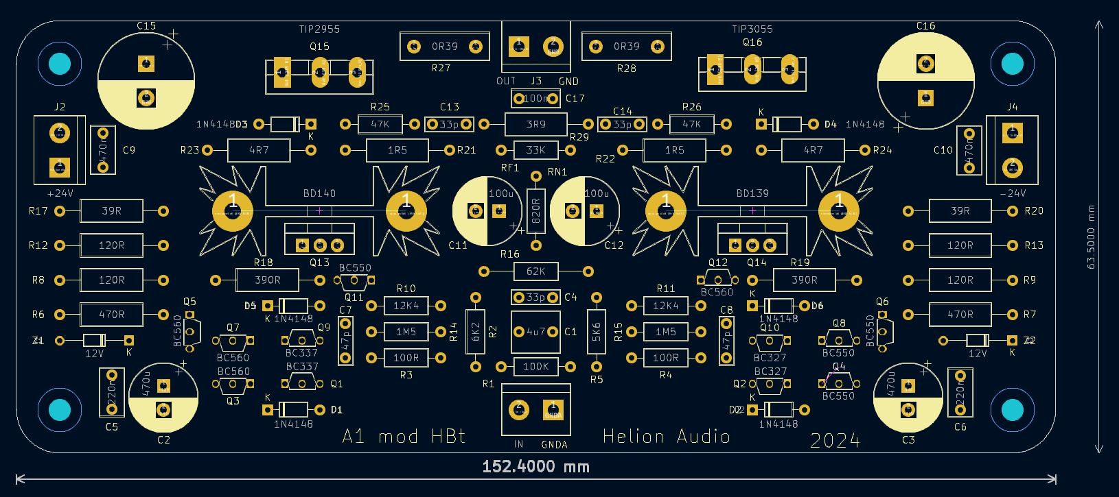

Today's PCB:

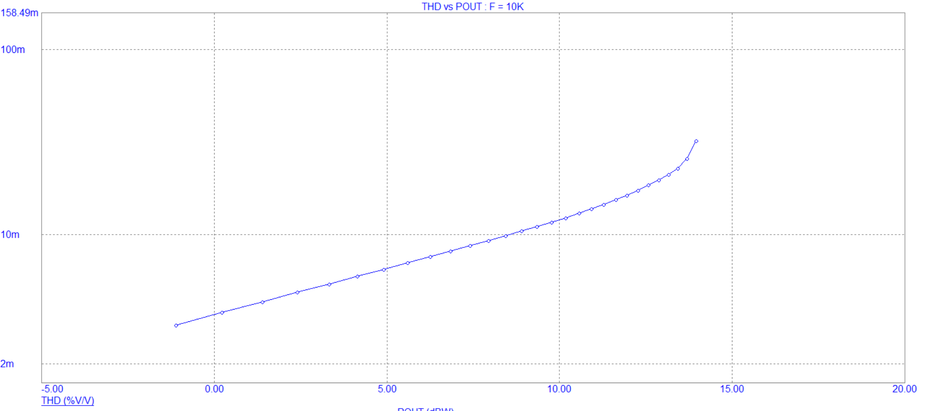

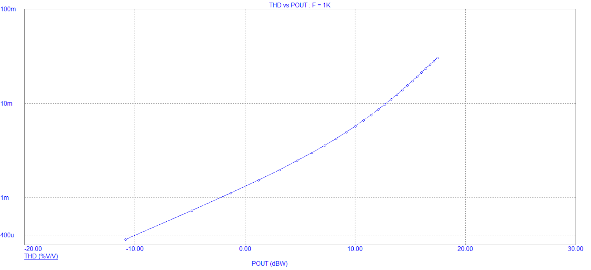

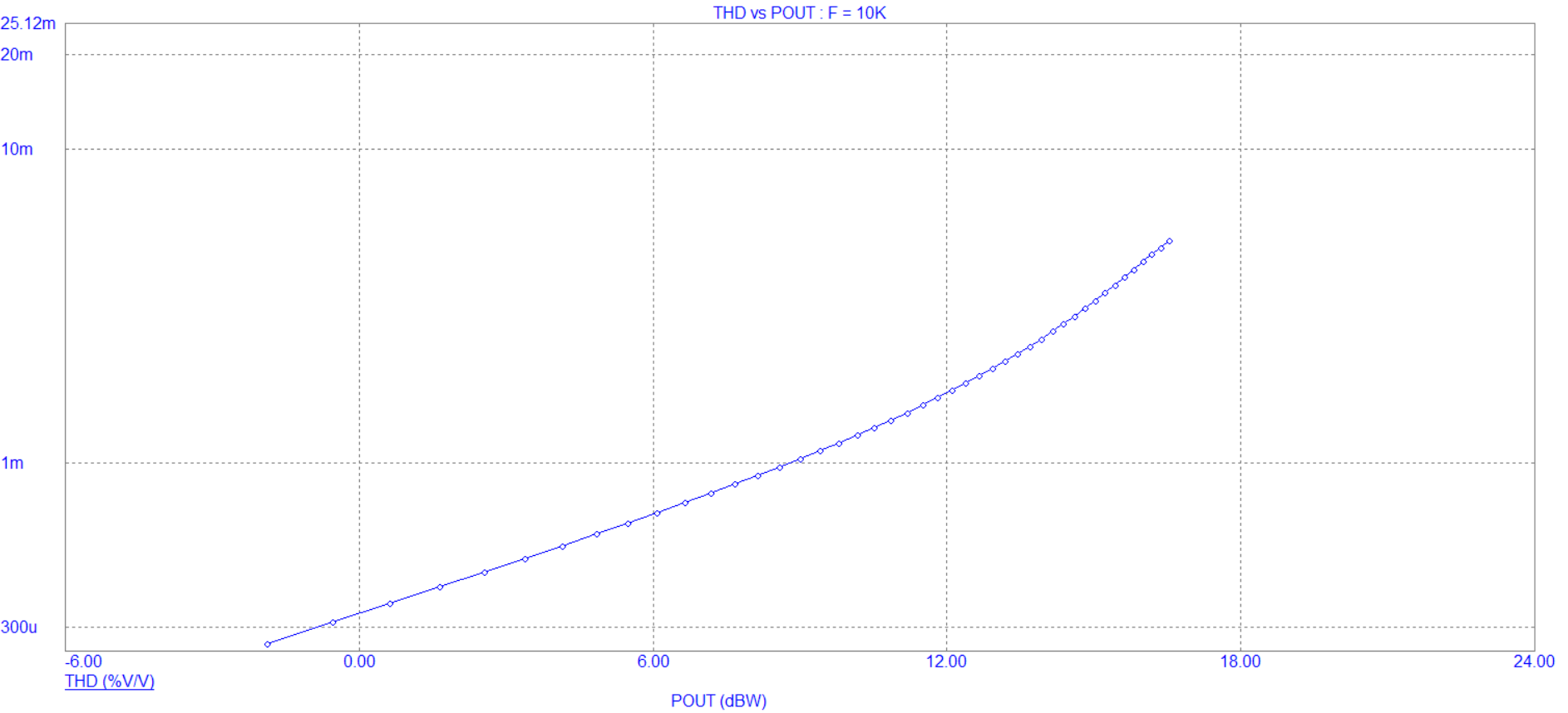

THD_10k
looks the same as THD_1k
0.006% _ 10W
0.03% _ 17W
Use R23 to set the positive DC offset of the upper half and R11 to set the negative DC offset of the lower half of the circuit. R22 and R5 are the same size for this purpose at 15k each. After R13 & R10 now connect the halves, this should result in an Iq of <1.3A but >1.1A. Only now do you increase R5 until the output node is set almost exactly to zero volts.
Genuine class A operation is now guaranteed up to 7W, as a push pull A interpretation it is more than 15W ... one can explore this vague definition even further.
But, as @wahab rightly pointed out, A is not necessarily the golden seal of quality.
I think this very simple modification of the forefather is quite respectable - and that with only 4 BJTs "in the signal path" and the frowned upon VA-OS.
HBt.

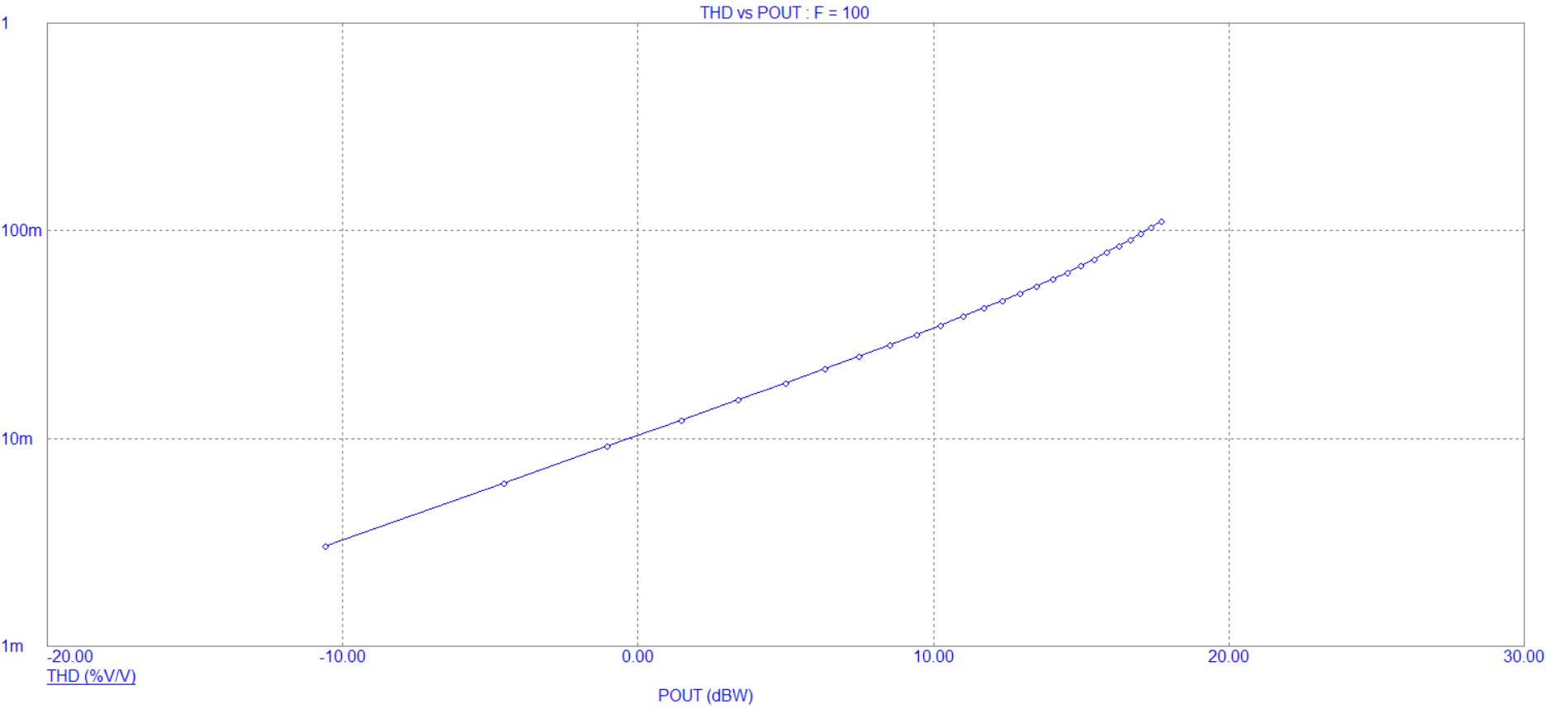

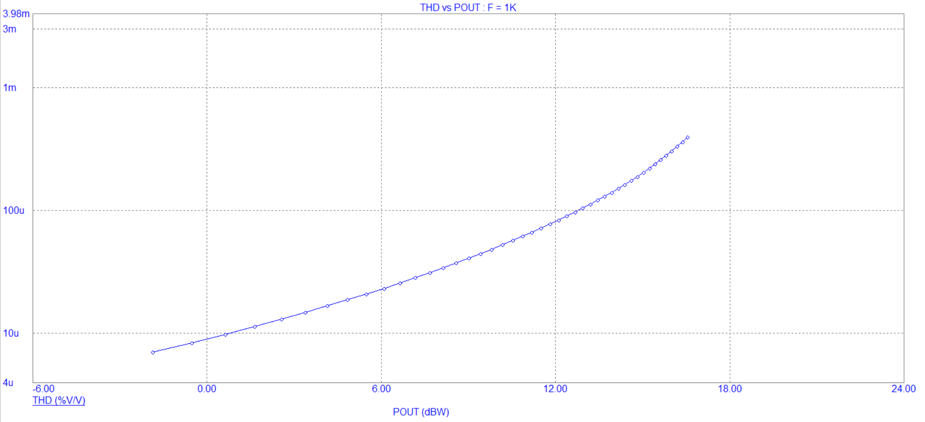

THD:
10 W(rms, 8R)
-84.4dB
1 W(rms, 8R)
-96.5dB
Bandwith:
delta_f > 200kHz
These specifications meet every conceivable HiFi standard. There is also sufficient dynamics, even for a small party. The schematic from posting #68 would then be my next reboot of the A1, v2.1 !

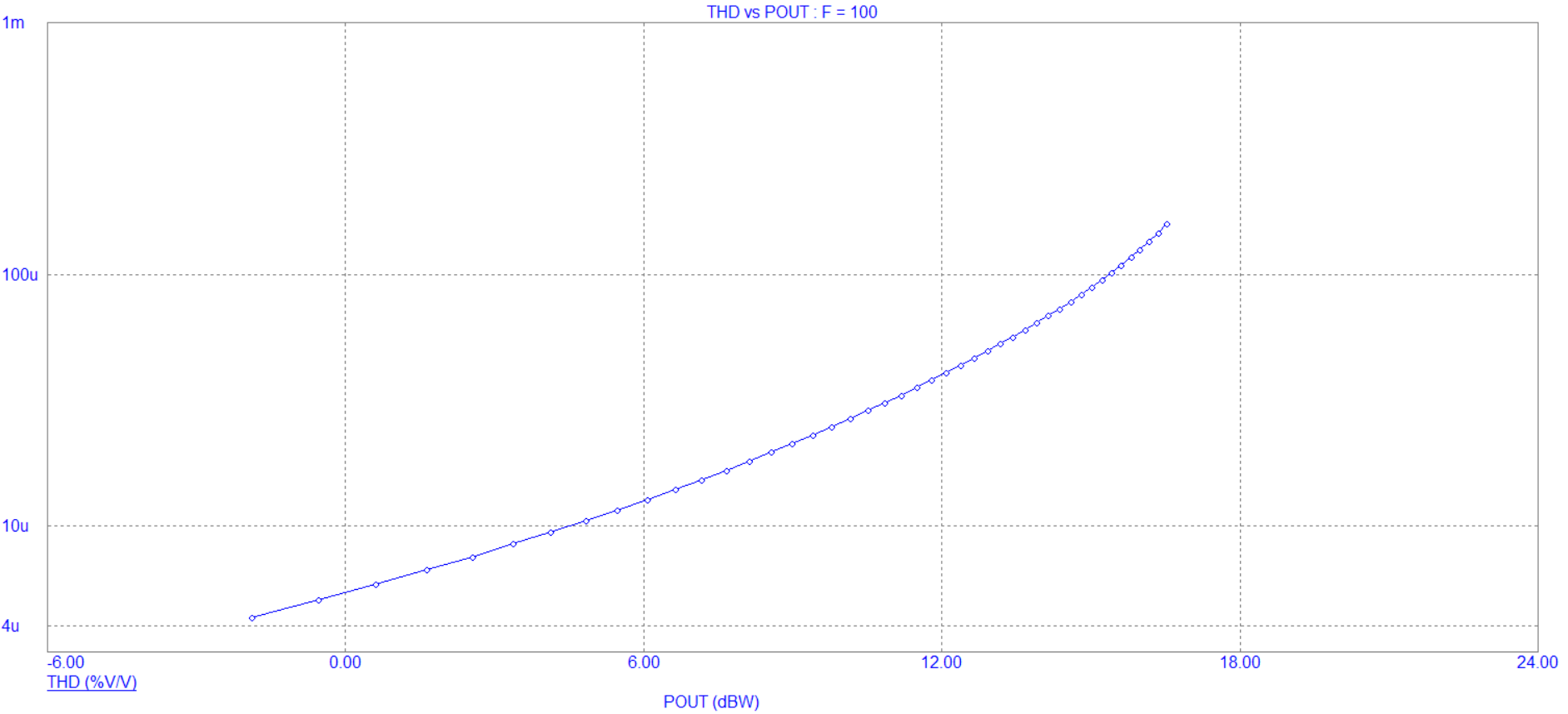

THD_100Hz:
Consists solely of H2, 0.01%_1W & 0.035%_10W. Could one wish for a more beautiful brushstroke in an acoustic picture?
Version 1.1 is competing to claim the "utopian THD" for itself, v2.1 does not.

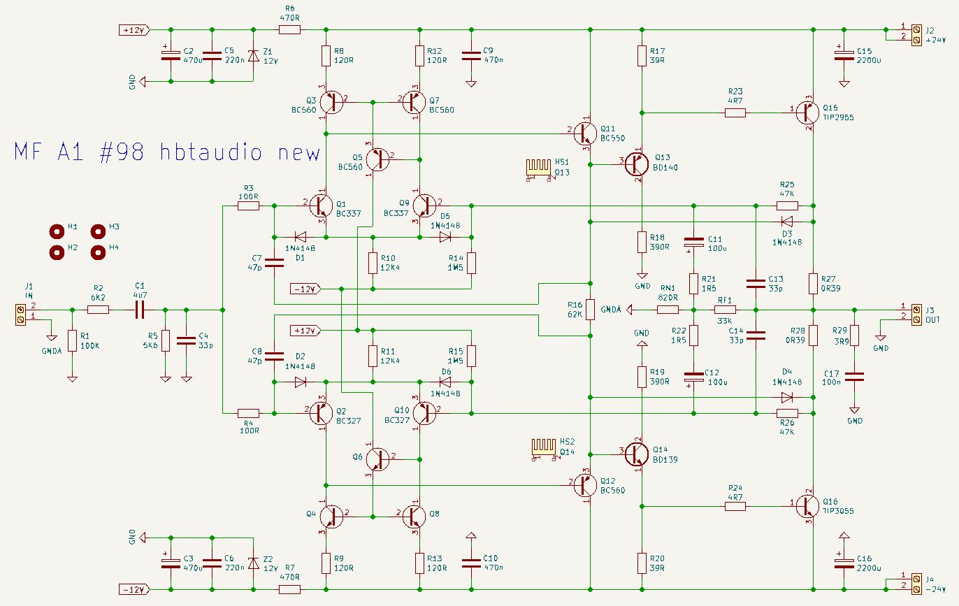

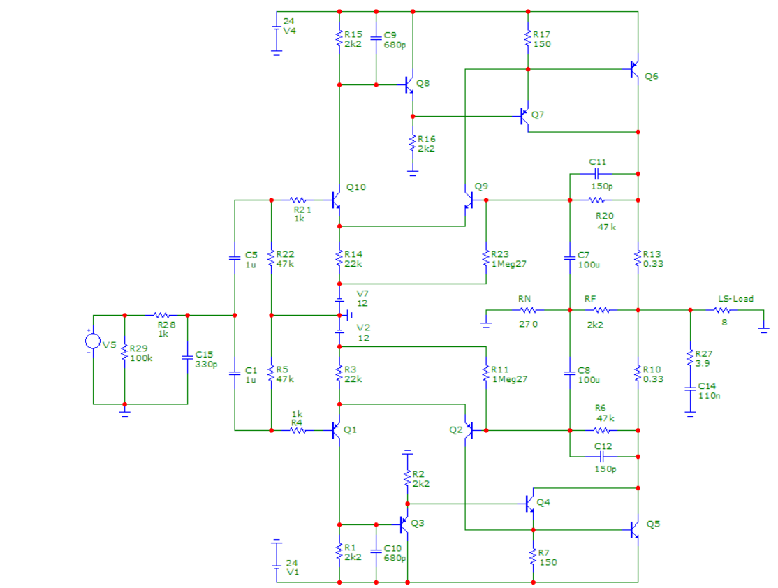

Which of my schematics is "Mod 1, as version 1.1"?
If I know, I will make PCBs
That's V1.1 the 3/4 + 3/4 Amp.schematic I used for the latest PCB is this:
TypoThese specifications meet every conceivable HiFi standard. There is also sufficient dynamics, even for a small party. The schematic from posting #68 would then be my next reboot of the A1, v2.1 !
the mentioned schematic is in post 65 (not 68). 65 is version 2.1.
@m0rten
device of R29 is min 1W type -> the same as R28 & R27. Maybe someone can willingly give valuable tips for the pcb layout. Where has Nico Ras gone?
THD_100Hz
THD_1kHz
THD_10kHz
Mission "utopian THD" has been fulfilled.

I still don't know if any of the PCBs are reaady for production and I don't know if any of them would make a decent amplifier.
I still call this PCB/schematic combo for #98 (old thread). Is this design still in debate? Is it good? (on paper, I know...)
Will there be more changes in the near future?
If yes, I will come back and check later.

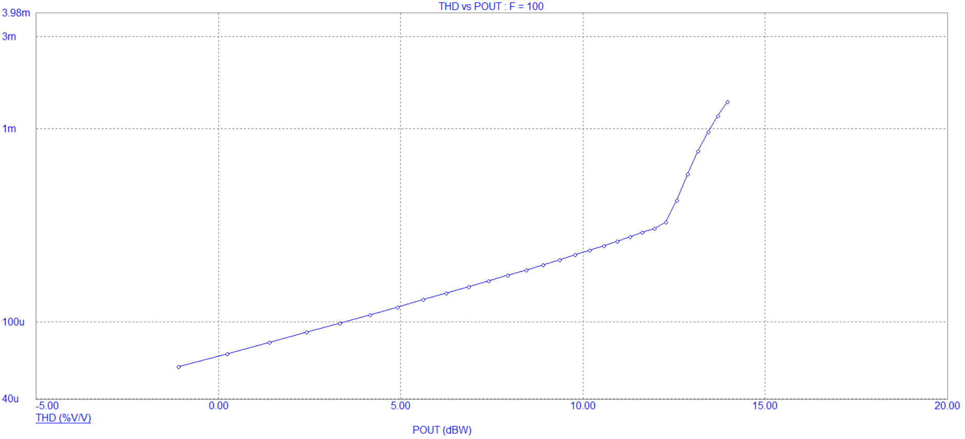

just combine the findings ...
THD_1k, 10W -> -126dB
THD_10k, 10W -> -98.4dB
THD_100Hz, 10W -> -132dB
So there really is a winner in the game of optimal dimensioning.
