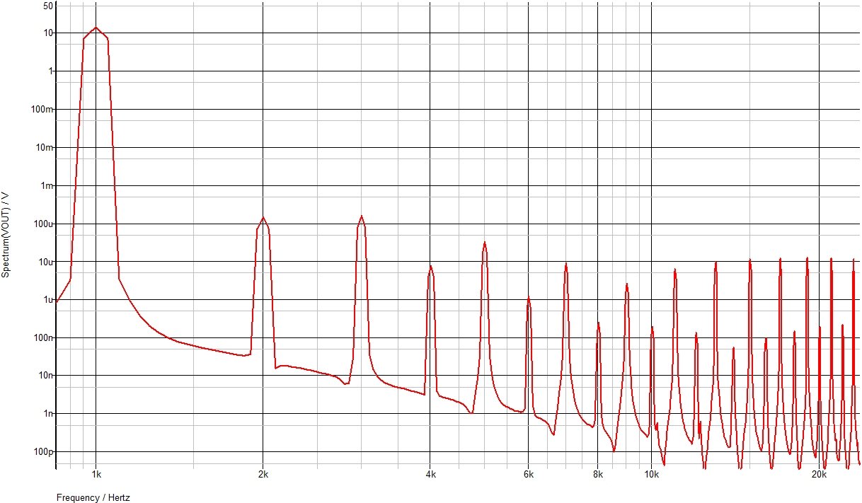

A1 vs. Class B blameless design:
0.2% worstcase at 10W
-40dB thd means now 0.002%
As i wrote it not even a blameless but a symmetrical differentals with same transistors count and quite less components overall
than the MFA1, the one below, let alone if it was a blameless or a refined symmetrical :

In the FFT i posted the main signal and the higher harmonics, H2 and H3, are 100dB apart, that s 40dB lower than the MFA1
that manage hardly -60db THD at 10W, beside that s at 55mA Iq.

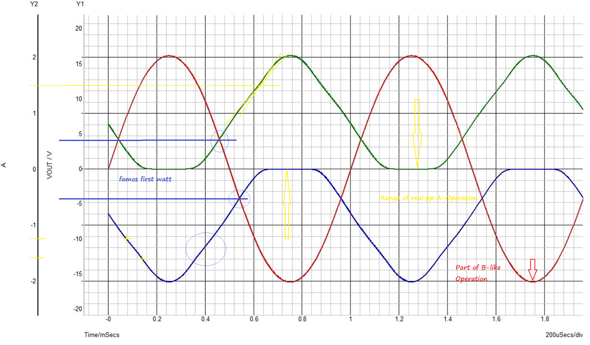

At 0.8A bias the OS largely switch off for 2A pk output current, unless one consider 70uA residual current
as being still switched on, we can see that switch off occur at 1.6A, wich is exactly 2 x the bias Iq and 10W RMS.
The deformations on the signal edges (and also the points in time) before the addition at the output node can be seen very clearly.
I took the liberty of doodling around a little in the graphic.
The famous first watt is flawless. Up to five real class A watts, it also remains largely flawless.

My final side note on the original:
I'm starting to get excited about MC12 after all, because this tool is very powerful in a simple way. It lets us find the exact limit of A operation of an MF-A1 and this is at an initial DC quiescent current of 808mA at 8.23W rms at a static load of constant 8 ohms. According to my simulation with MC12.
Who would have thought it?
Obviously, the disguised autobias is not really a brilliant idea after all. Or perhaps the dimensions of the bridge elements Z1, Z2, Z3, Z4 and Z5 are not optimal.
Whether 3/4 + 3/4 will perform better 😉 ?!
There s actualy no image deformation, that s due to the jpeg image converter as the original pic format
is not supported by DIY Audio images storage.
