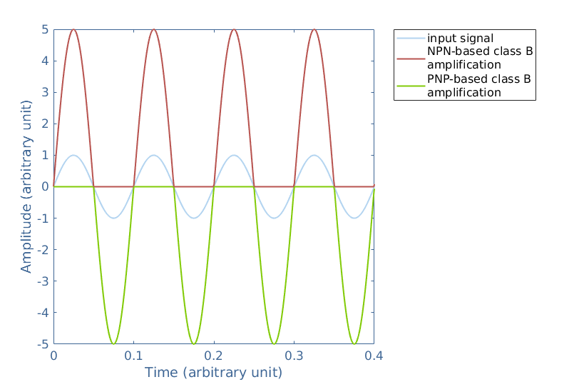

As I mentioned, the bias point drops when it is driven to Class B.
Assuming it drops to near 0 current at full load, at that point, the amp is working at pure class B.
A full load Class B amp, 20Vp into 8 Ohm, that means 2.5A at peak.
If you take the average of the absolute value of the current, it is about 1.6A in average. For push pull, you only need 800ma bias to provide 1.6A
That means if you give 800ma bias at idle, at full load 20Vpk into 8Ohm, it could still keep the output stage slightly biased. That help you minimize the distortion.
Thus, 800mA is the magic bias current for the A1.

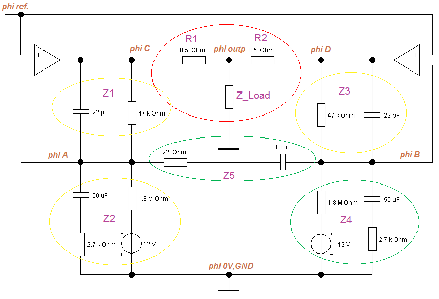

There is still the question of “when does the MF-A1 switch to AB operating mode” - “when” refers to u(t), to a very specific instantaneous value of the voltage.
And Z5 -
and any connection with Z5 itself is still unanswered ..!

The voltage on the current sensing resistors never go below zero.
There is RC network in the feedback network.
What I tried to say is.
For a pure class B with 0 bias, 20Vpk output into 8 Ohm, is 2.5A peak, 1.6A in average. Because of class B, the current is always provided by one of the sensing resistors. Let’s say 0.5 Ohm each. The average voltage crossing 2 sensing resistors in total is 0.5x1.6=0.8v.
Then, you remove the signal and short it to ground. As A1 has NFB around the sensing resistors and try to keep the total voltage the same, that is still 0.8V but crossing 2 0.5 Ohm resistors. That is 800mA.
That means 800mA is the minimum bias current to get full 20Vpk output into 8Ohm. Below that, it is not even able to maintain the minimum class B operation point at full load.

Honestly, the matter is actually quite simple - and yet I can't quite follow your last post at the moment.
Let's just look at the common input of an A1 not in terms of ac, but in terms of dc and apply various DC voltage values to it - in the picture the potential (and node) called phi ref.

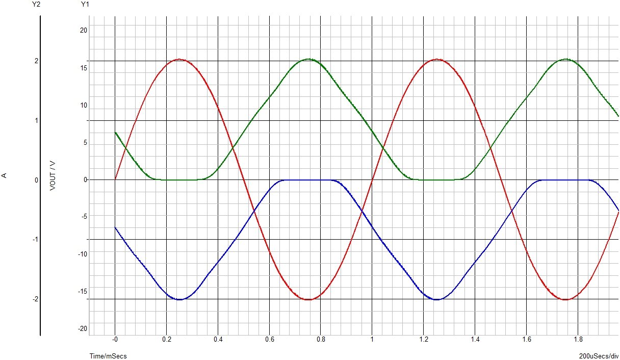

At 0.8A bias the OS largely switch off for 2A pk output current, unless one consider 70uA residual current
as being still switched on, we can see that switch off occur at 1.6A, wich is exactly 2 x the bias Iq and 10W RMS.

At 0.8A bias the OS largely switch off for 2A pk output current, (...)
(2A)^2 * 8 [V/A] = 32W_peak
This corresponds exactly to the metrological reality! And the MF company under Austrian management also states this value in exactly the same way, at least I think so 😉.
But we all want to know, and finally definitively, when the electric heating surface leaves real A mode.
It is class A up to 1.6A pk, that is, (RL x 1.6^2)/2 = 10.24W RMS, with 0.7A Iq that makes barely 8W RMS,
