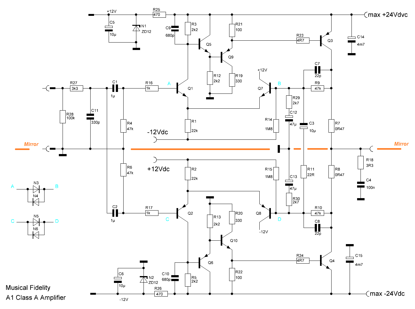

Dear @StevieK
this one is the original, the real Musical Fidelity A1:

Yes Morten, there is an ulterior motive in this selection - and if possible you should select and mate exactly this type.
Although all AF transistors of this Siemens / Philips series are similar and it could perhaps also work safely with BC556B /546B at this point - but whether the unusual type of frequency response compensation (acting on the input capacitance and with it) will only become apparent at the end.
But now you're going the whole hog Morten!
greetings,
HBt.

I cannot directly understand the TRANSNOVA insertion. I do not yet recognize a connection with the MF-A1 and its derivatives.
The current model (version 2023) uses the inexpensive and robust TIP35 & TIP36 pair. In this model, it is mainly the completely undersized mains transformer that is cooking!

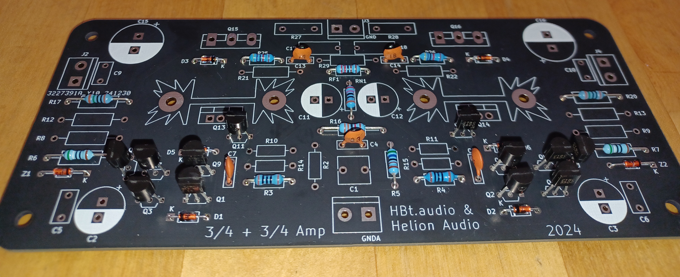

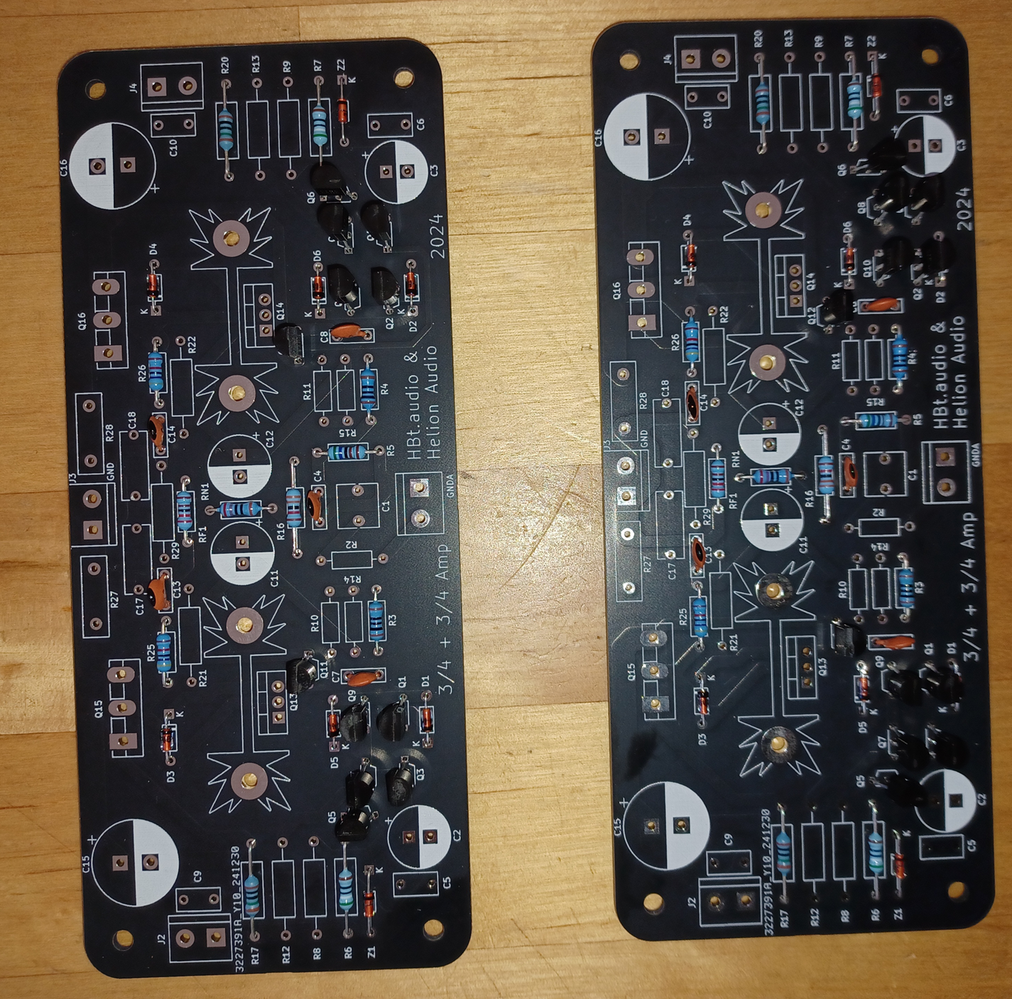

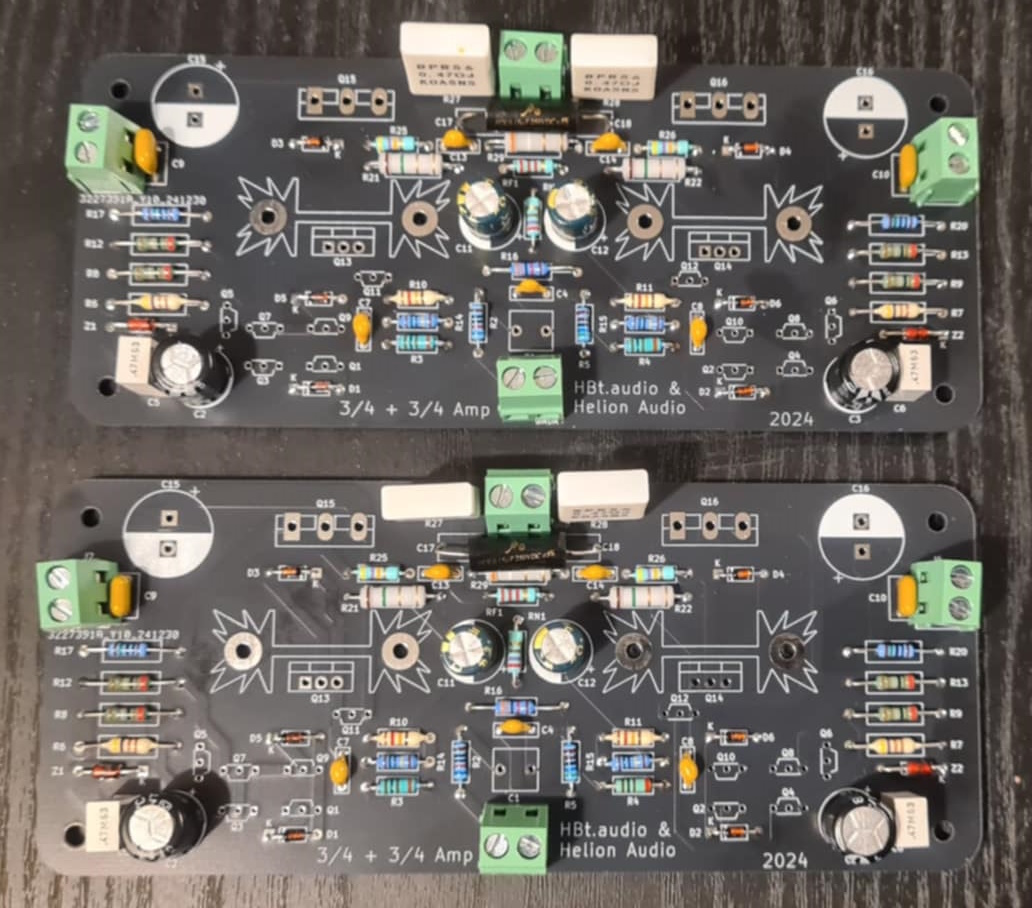

6, 5, 4, 3
I'm actually missing some resistor values, it's always the same - you think you have everything in your own stock, but there's always a component missing and so the stock keeps growing.
In any case, the tension is rising ...
