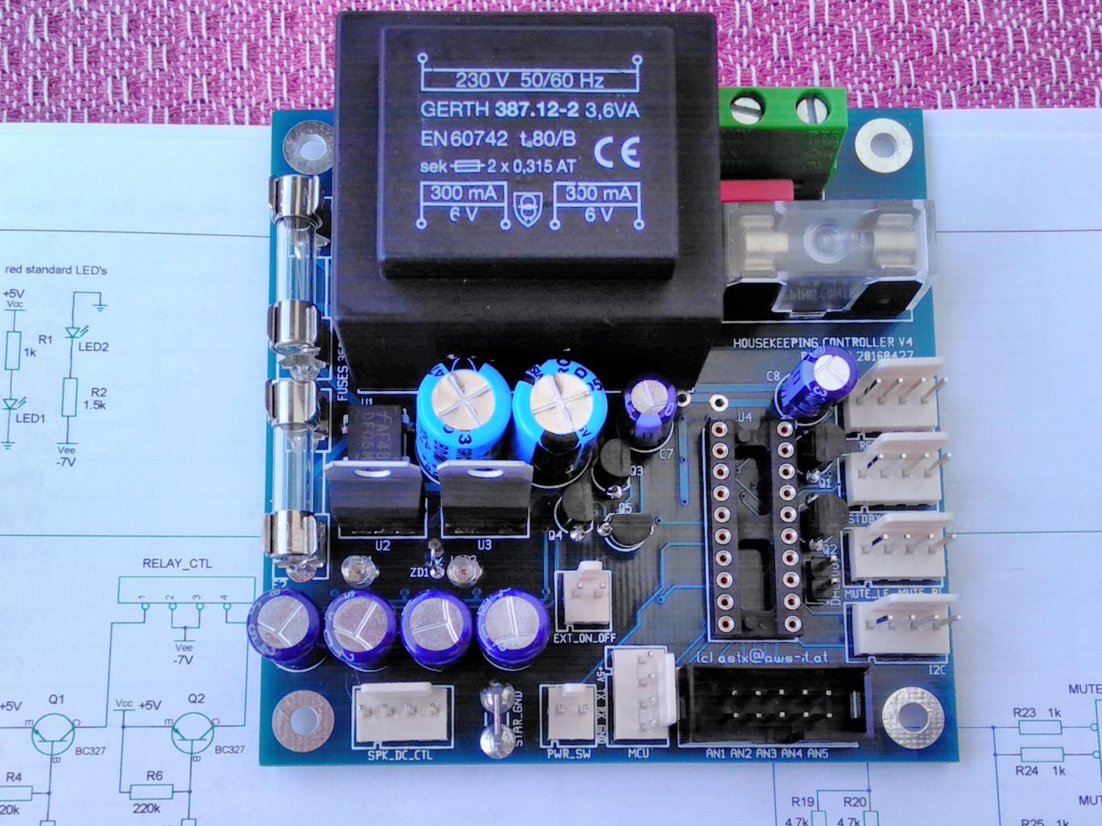

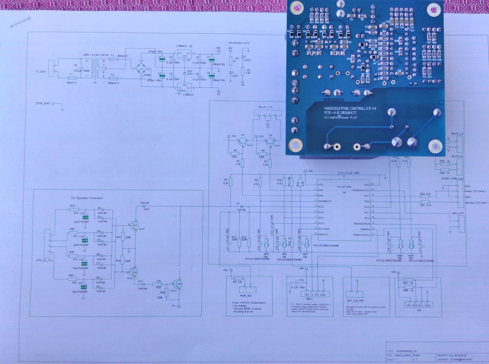

housekeeping circuits - new hardware version 4
... more SMD parts ...
... prototype board ready for programming...
Have fun, Toni

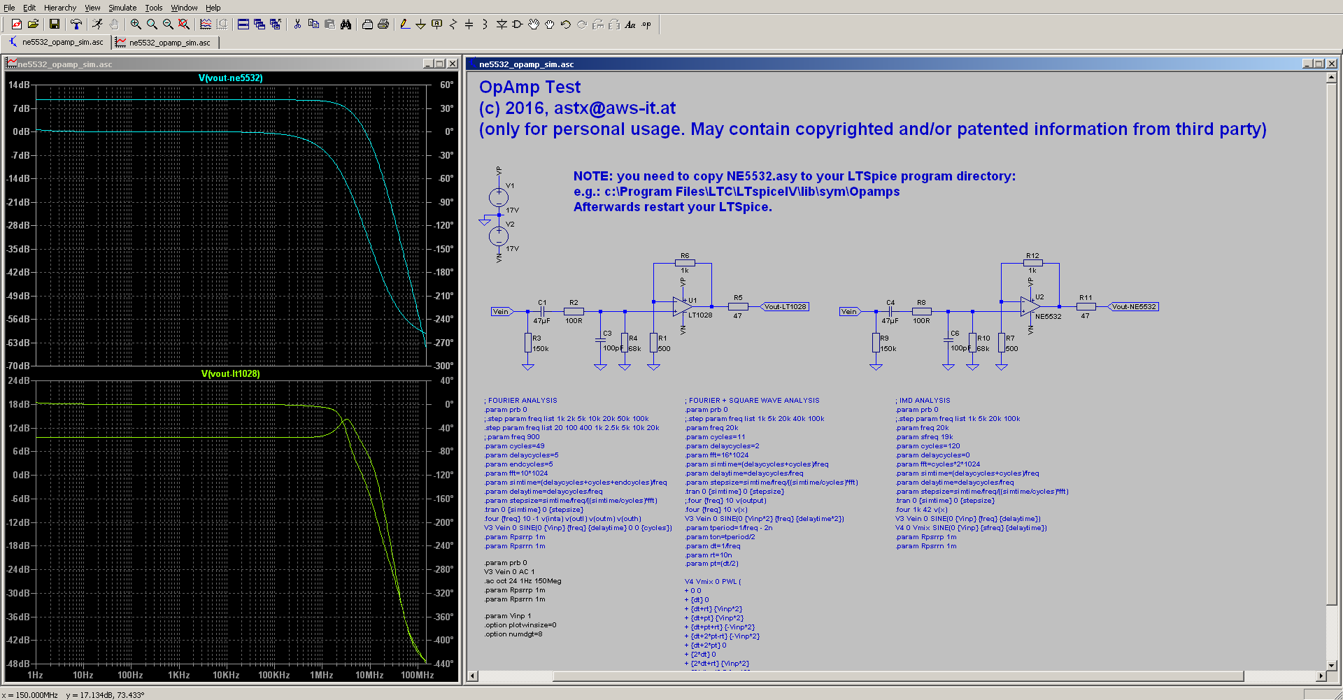

can u help me to add ne5532 to ltspice model please.
thank you
Your question is a bit out of topic ...
  • Extract attached zip file.
  • Copy "NE5532.asy" to your LTSpice symbol directory (e.g. c:\Program Files\LTC\LTspiceIV\lib\sym\Opamps)
  • Start recent version of LTSpice and load the attached asc file "ne5532_opamp_sim.asc".
  • Run simulation
How to add your own symbols/models: Adding a permanent component to LTspice - LTwiki-Wiki for LTspice
More libraries can be found at LTspiceIV-library Library Listing Expanded - LTwiki-Wiki for LTspice
BR, Toni

Nice and compact design!
Thanks!

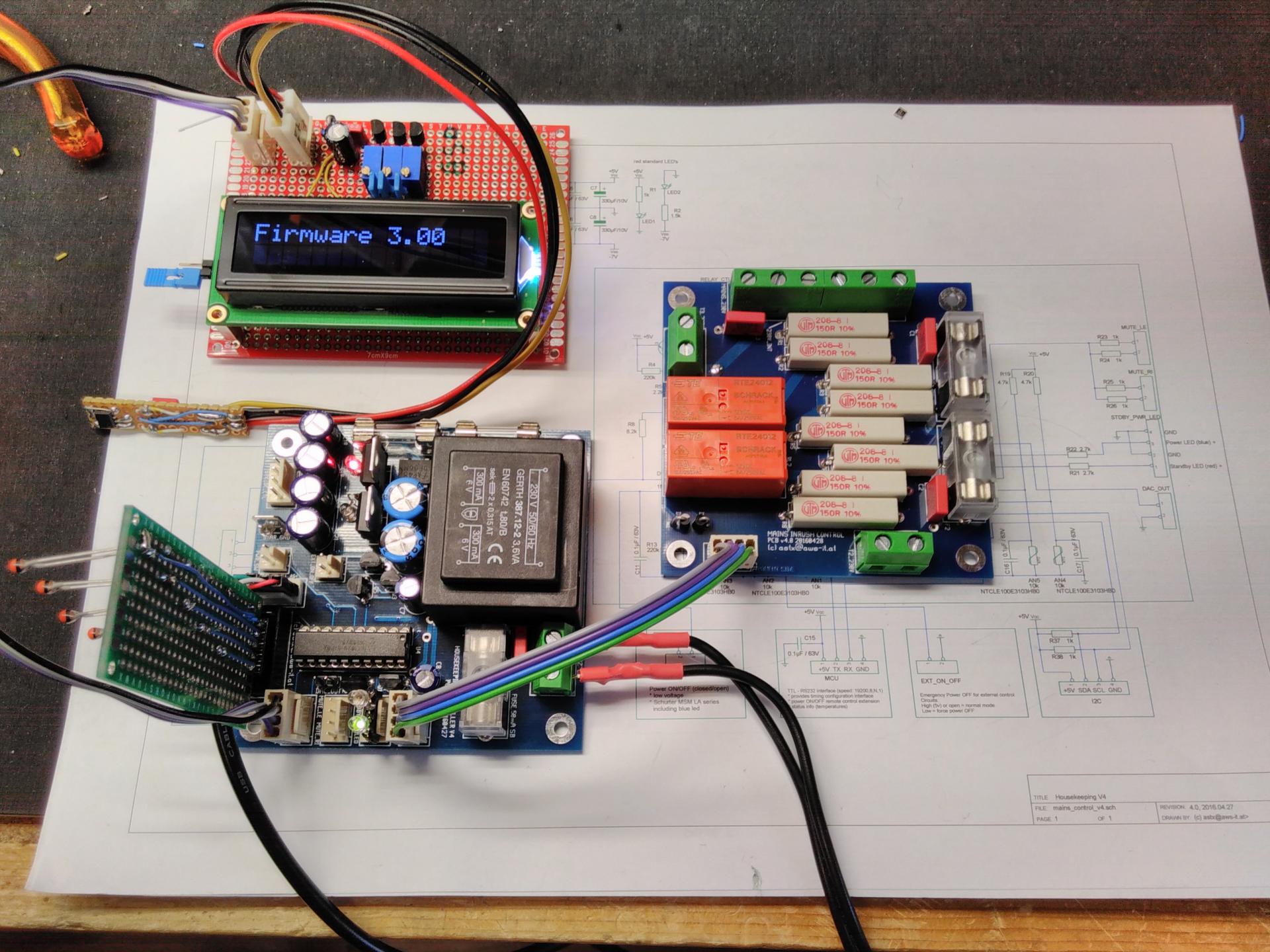

New "mains inrush control" pcb: I2C library ported to pic16f1829.
Prototype is working:
  • able to detect and feed data to LCD display
  • able to detect and read up to 8 additional LM75 temperature sensors
  • WIP for MCP23008 and MCP23016 port expanders
BR, Toni

Very cool!
Thanks!
