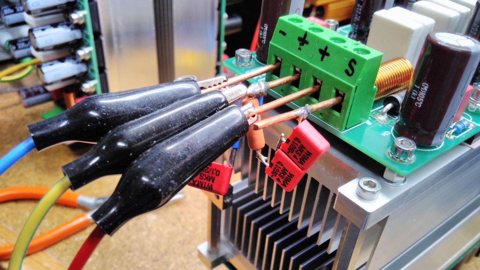

I have seen many Mambers testing their amplifiers with 20kHz and higher squarewaves. Some even use 100kHz and 200kHz squarewaves.
The HF content of a squarewave heats up the esr of the Output Zobel.Yes, the operator !
Far be4 the cap heats up the resistors produce holy smoke ...😉
I've done extensible full power tests using 20k, 50k, 100k and even 200k square and sinus ... needed a lot of new zobel resistors but never a fresh capacitor ...

Me too.Far be4 the cap heats up the resistors produce holy smoke ...😉
Always smoke the zobel resistors(testing conditions,only)!
Never a burned capasitor.

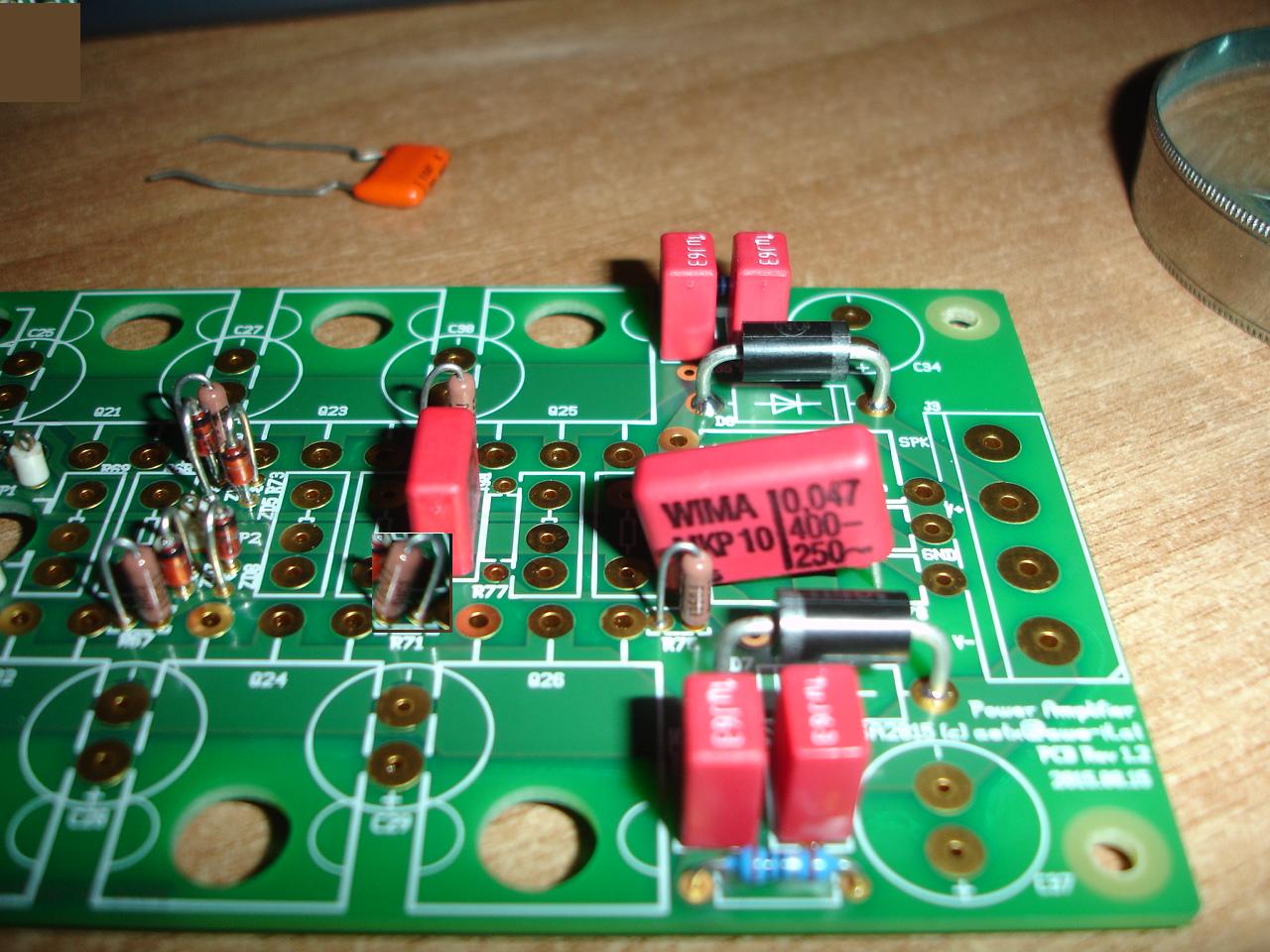

Sorry - my fault. You can recycle the MKP10 for the zobel directly mounted at speaker terminals.
It doesn't matter, i can solve this easy.🙂
Reverse R67, R71, R75 => the mosfet gate stopper resistors need to be soldered the other way round to keep the wire-inductivity to gate as short as possible. 😱
R66, R70, R74 orientation looks OK.
BR, Toni
Exactly!like this?
R38 is a zero ohm resistor? If have soldered a piece of short circuit wire instead of R38 ...
Yes it is.Exactly!

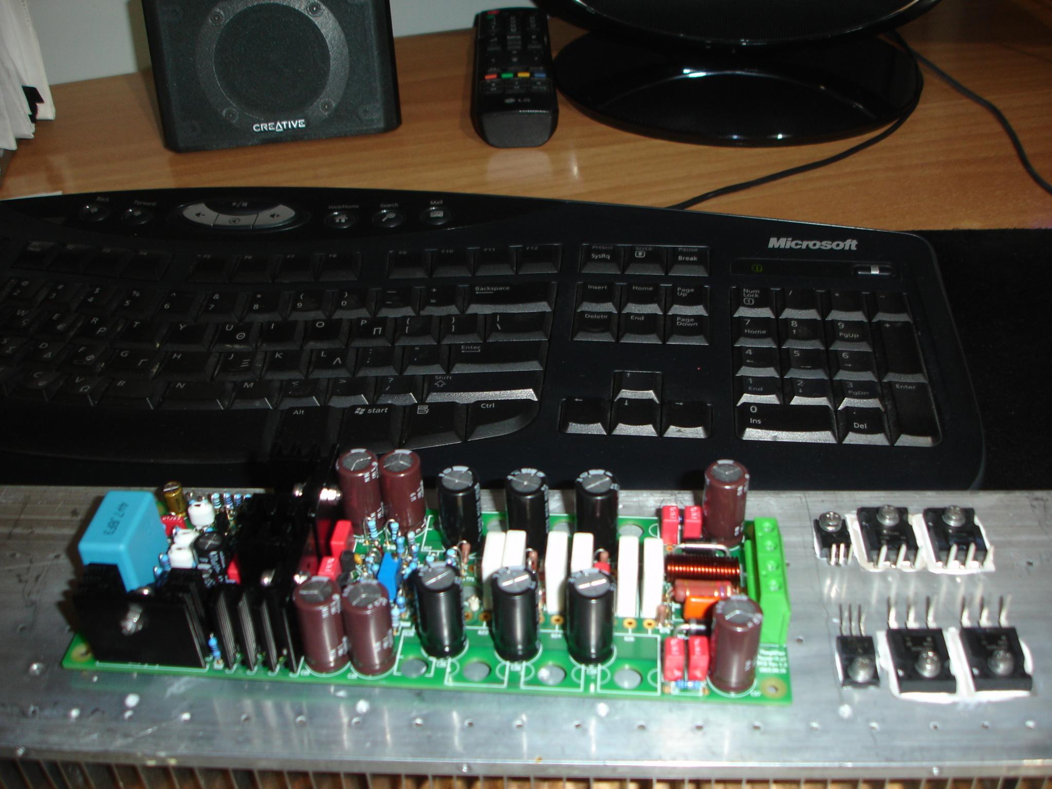

Toni my plan is to use one pair output transistor for first time
(soft) test.😉
Do you see any disadvantage in this practice?
(soft) test.😉
SA2015 first powering after assembling
Better to test fully assembled after double check all values. Diode orientations! Be carefully during MOSFET mounting! Use ESD equipment/procedures! Your MOSFETs triples are matched so don't mix them up.
(soft) test.😉

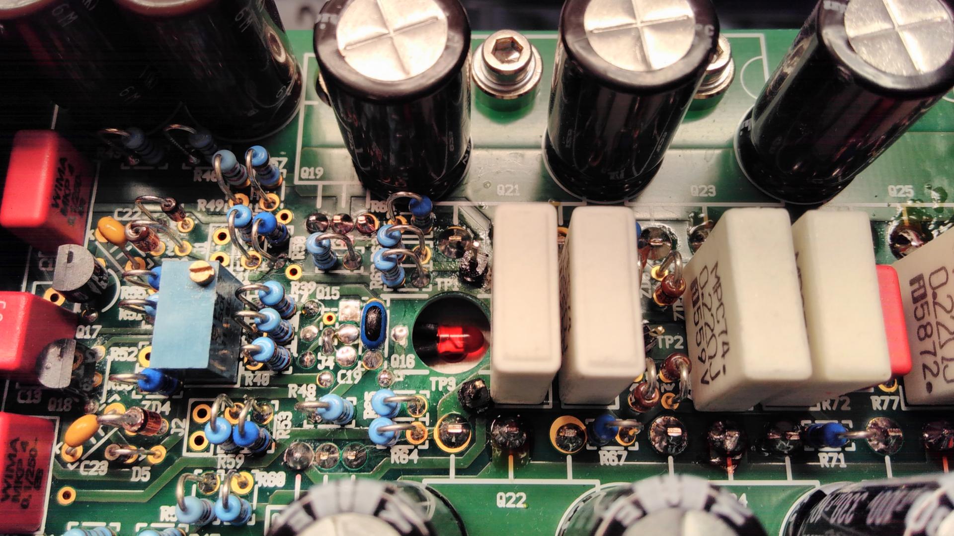

I don't want to put on risk 6 matched trans.
I have two other pairs and i will try with these first.
I'm confused a little in Vbe multiplier.
Is it this way as photo?
Should work stable even with a single pair OPS MOSFETs. Use the same startup procedure as described for 3 pairs except final max. bias current.
If you afterwards mount the matched 3 pairs don't forget to repeat the complete "first startup" procedure.
Bias generator parts mounting looks good so far compared to post #1408 and post #1422.
Mounting bias temp sensor parts is a bit tricky, but the pcb is held universal to allow different IPS and OPS variants.
BR, Toni

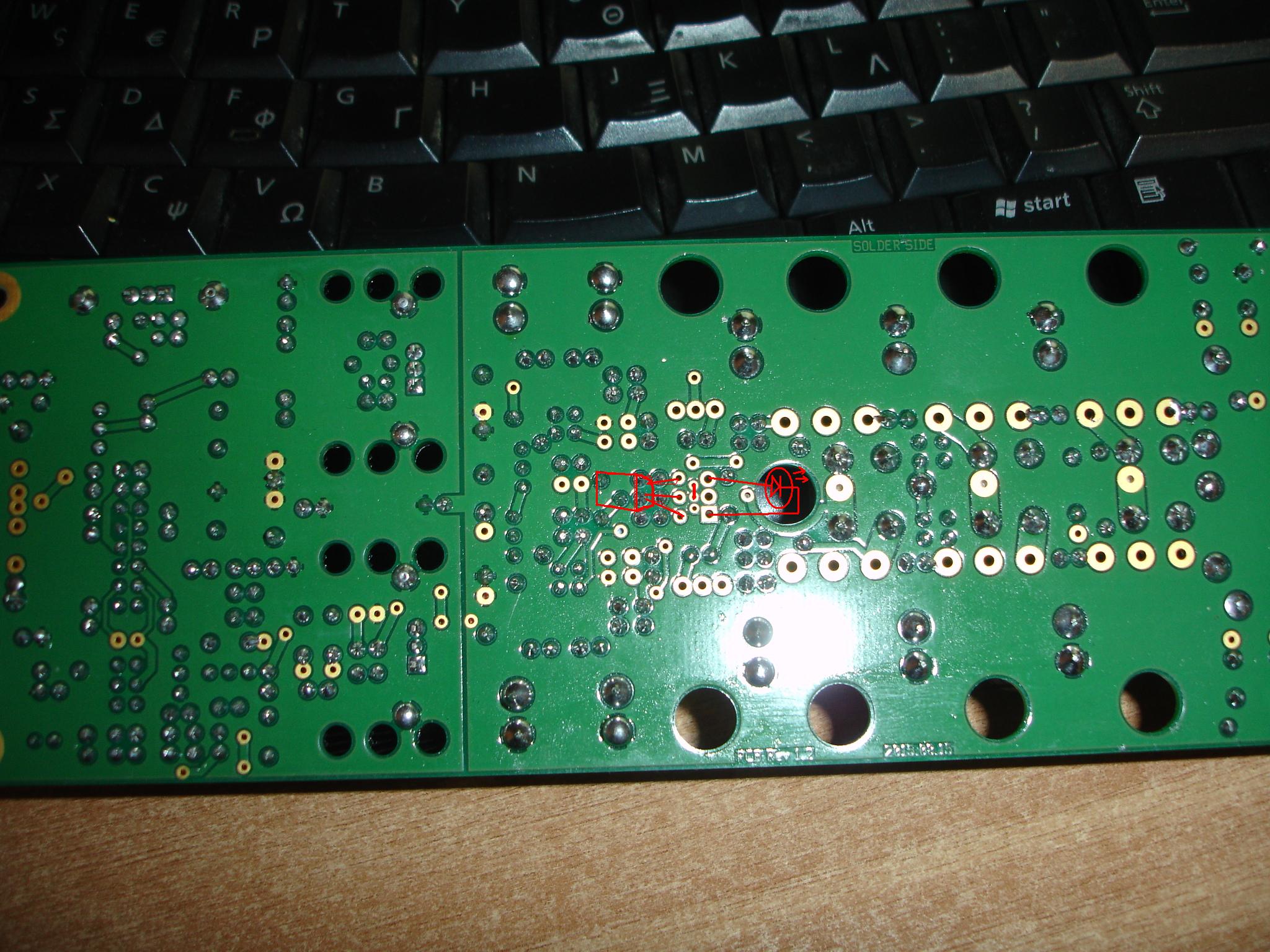

Thanks ,i see the post you mention but i can't see the link in jp4(between trans. and led) clear.Should work stable even with a single pair OPS MOSFETs. Use the same startup procedure as described for 3 pairs except final max. bias current.
BR, Toni
BTW the multiplier emitter connected to led anode.
This way the Vbe trans. and led just touch the heatsink. Why do not use a BD139 screw firmly on the heatsink?
Ok,now is clearly visible.🙂Here a bias jumper J4 / led detail ...
